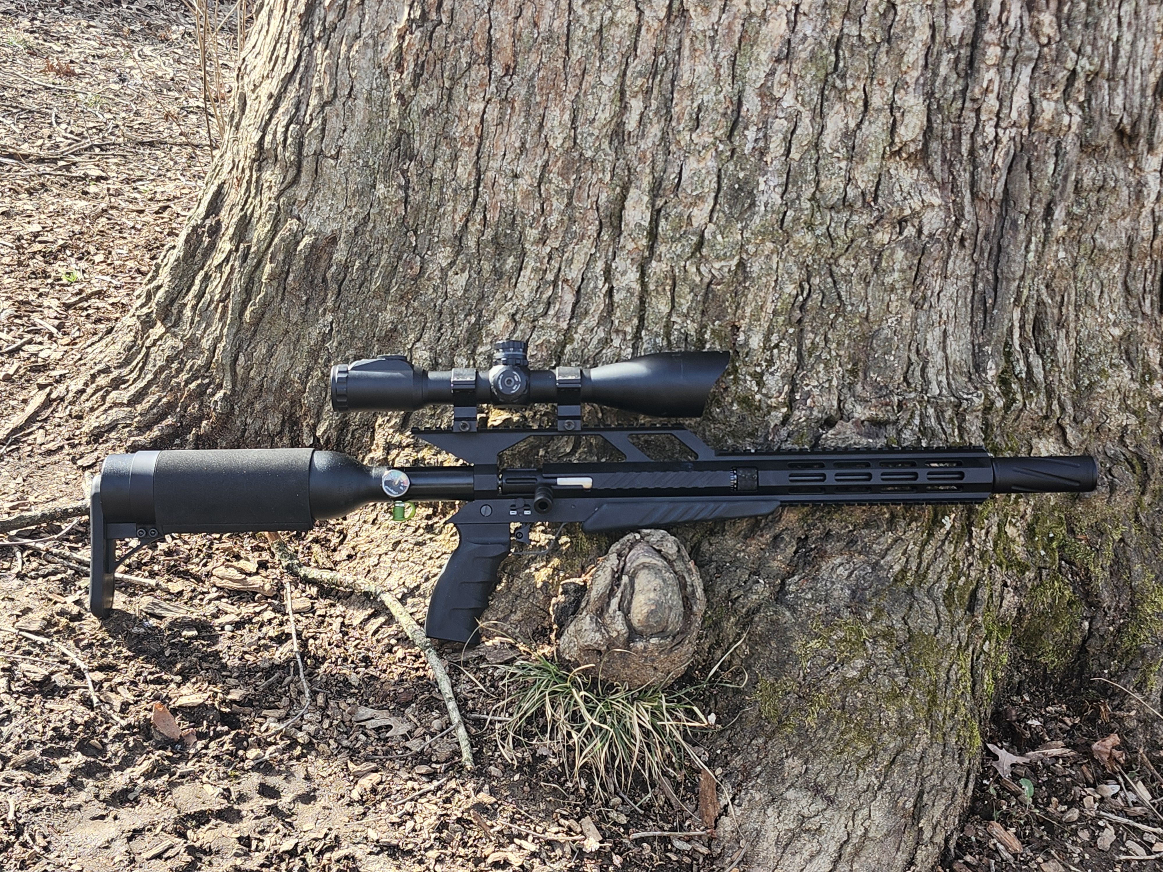

UTG Swat 10x50 fixed. Looks the part. One issue in the firing cycle. Once I can film it I'll post it. Not a huge issue with the consistency it's already getting but I think there is definitely more to be had with very little work.

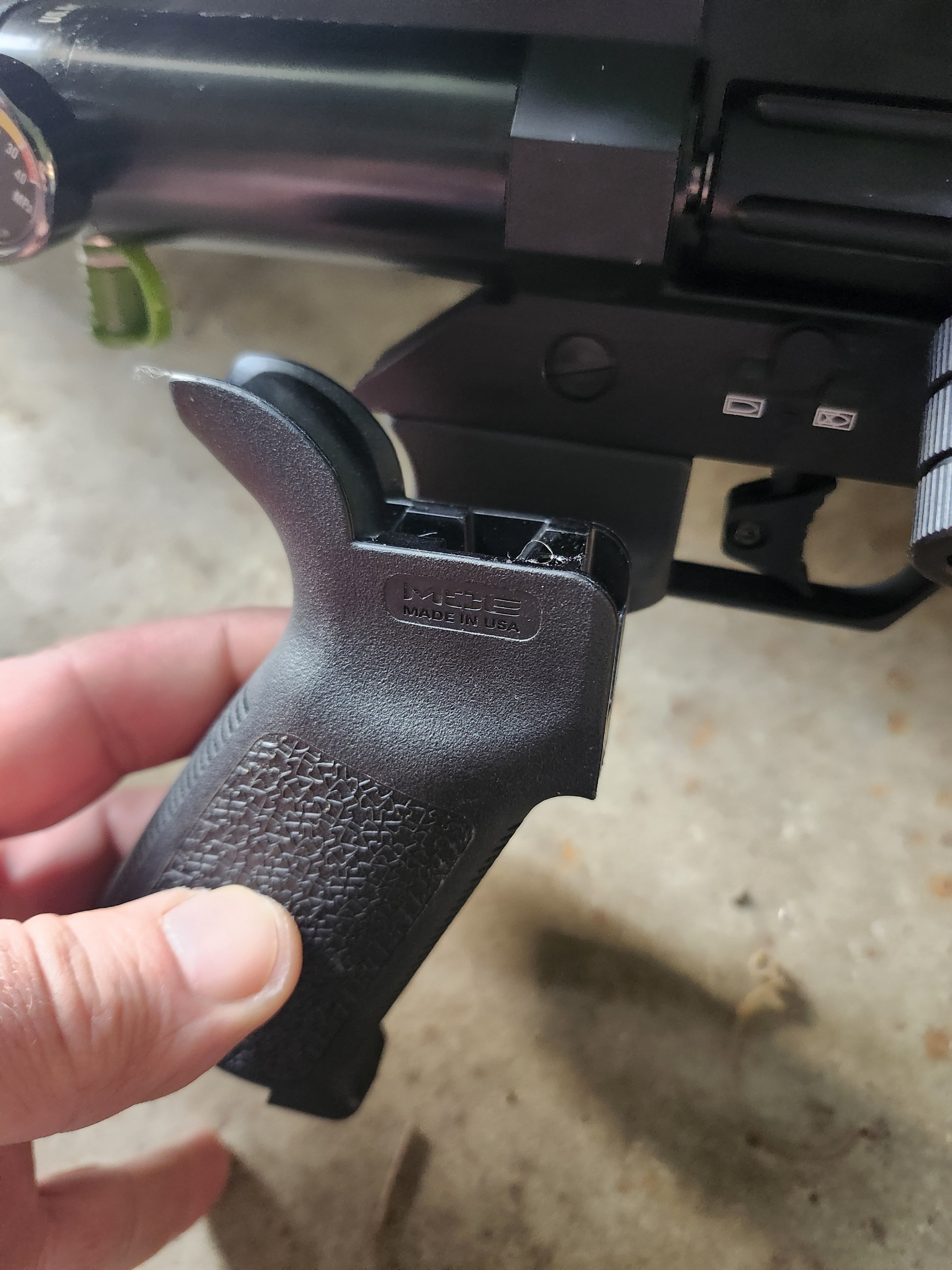

@thammer, does the grip look like it'd accept a standard AR grip, or is it proprietary?

My only AR grip is a Magpul off my UX Hammer and it does not come close to fitting. Possible with out the rear section on the Magpul. Holes do look like it's possible to fit.

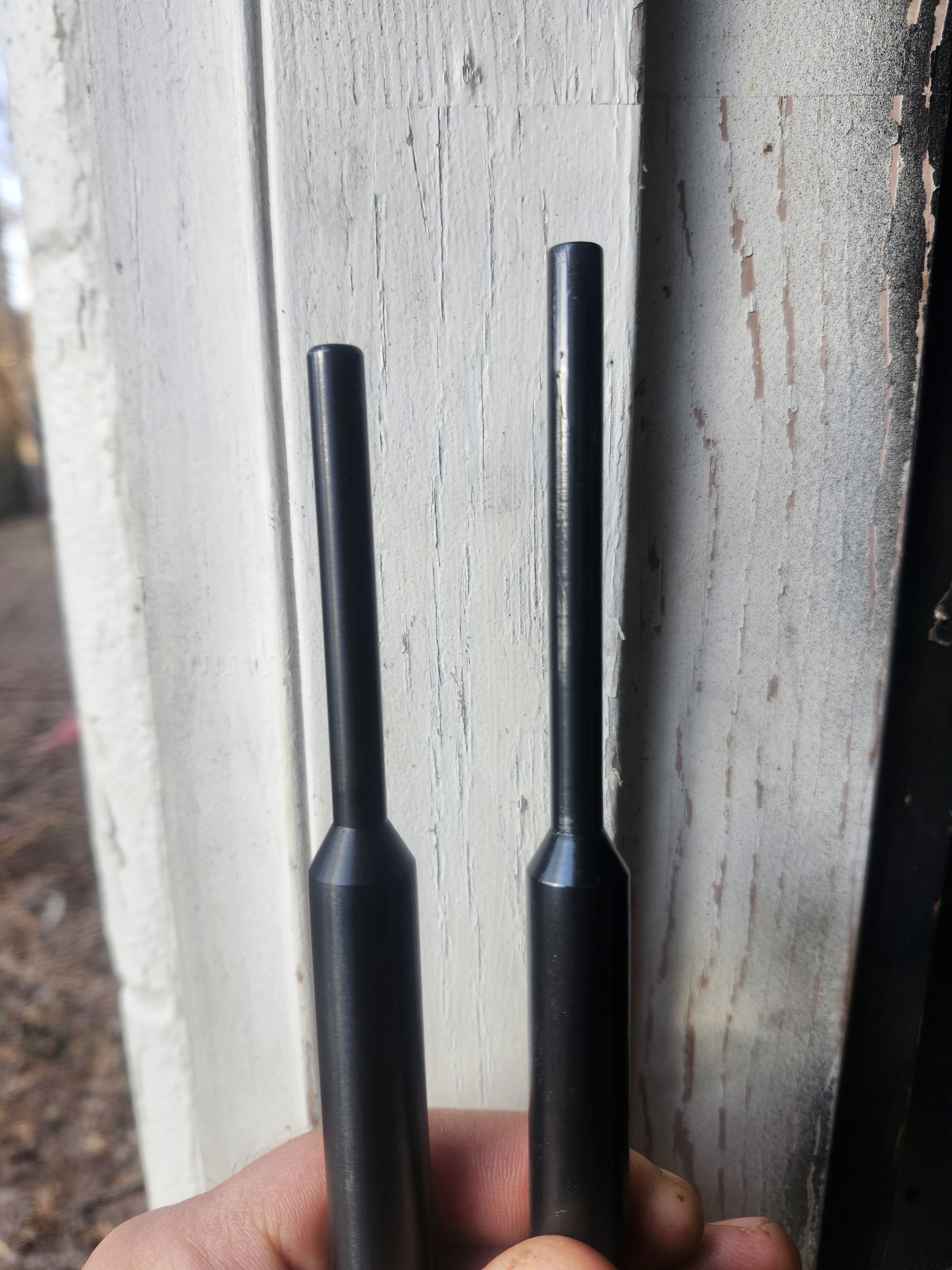

Factory AF on the left so won't swap without machining.

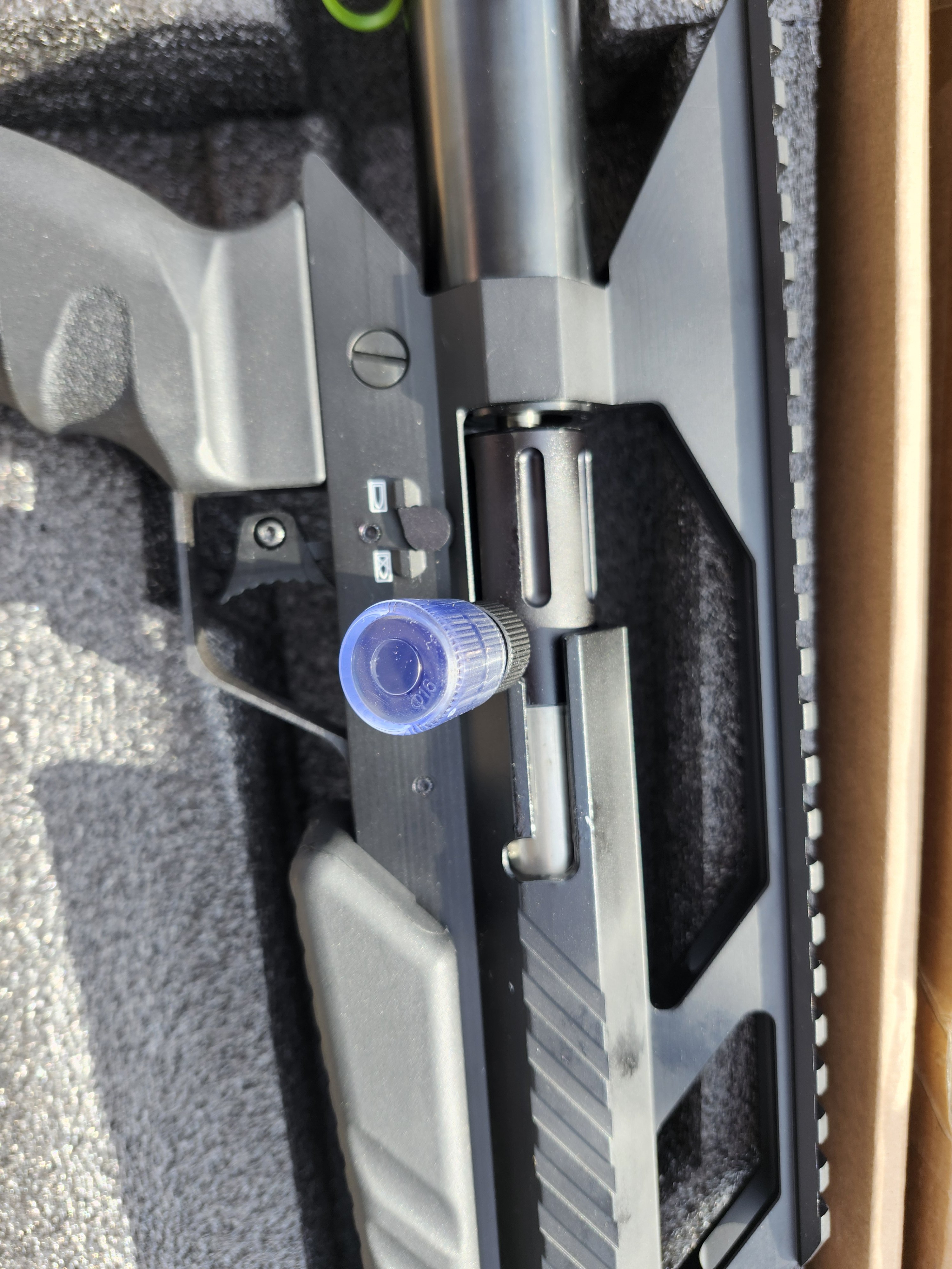

No cocking issues at all. Super smooth. It's possible at a lower power wheel setting it's still at that same level. I just maxed it on purpose to see what that was.

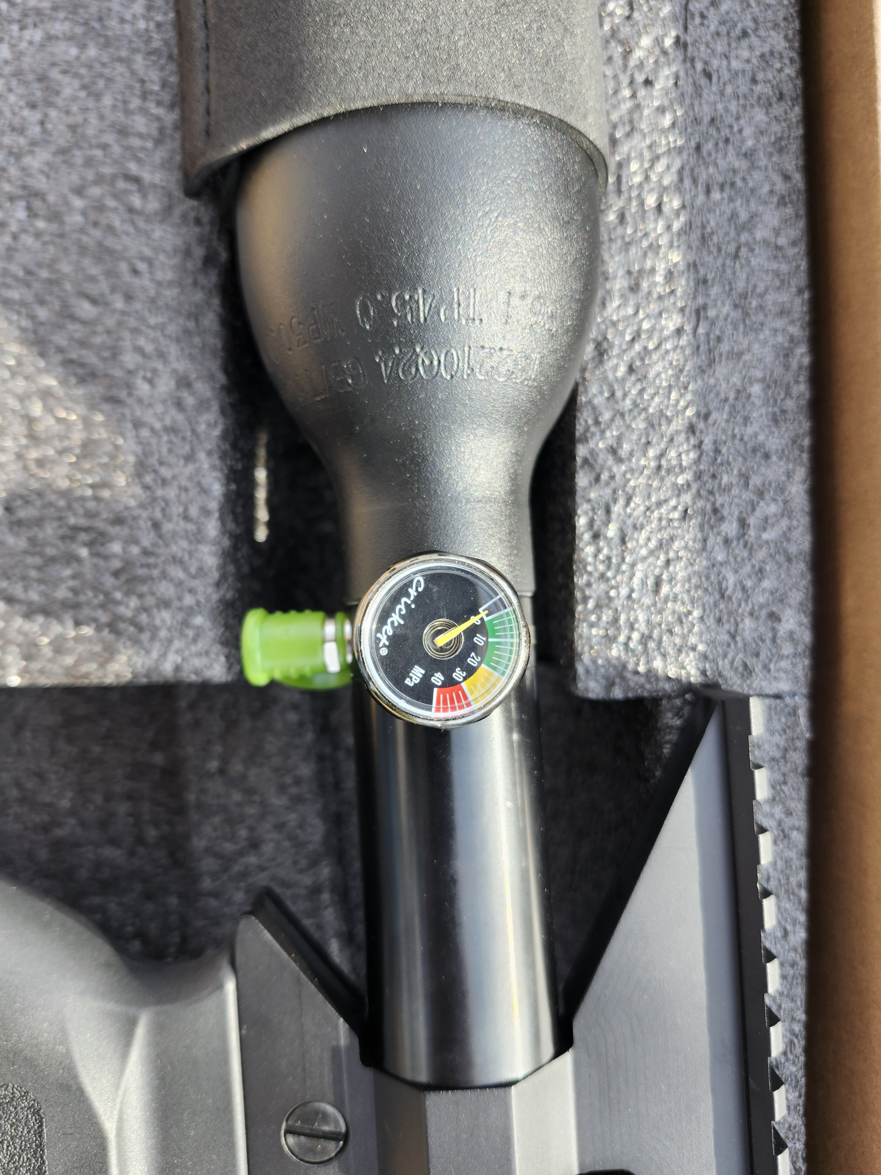

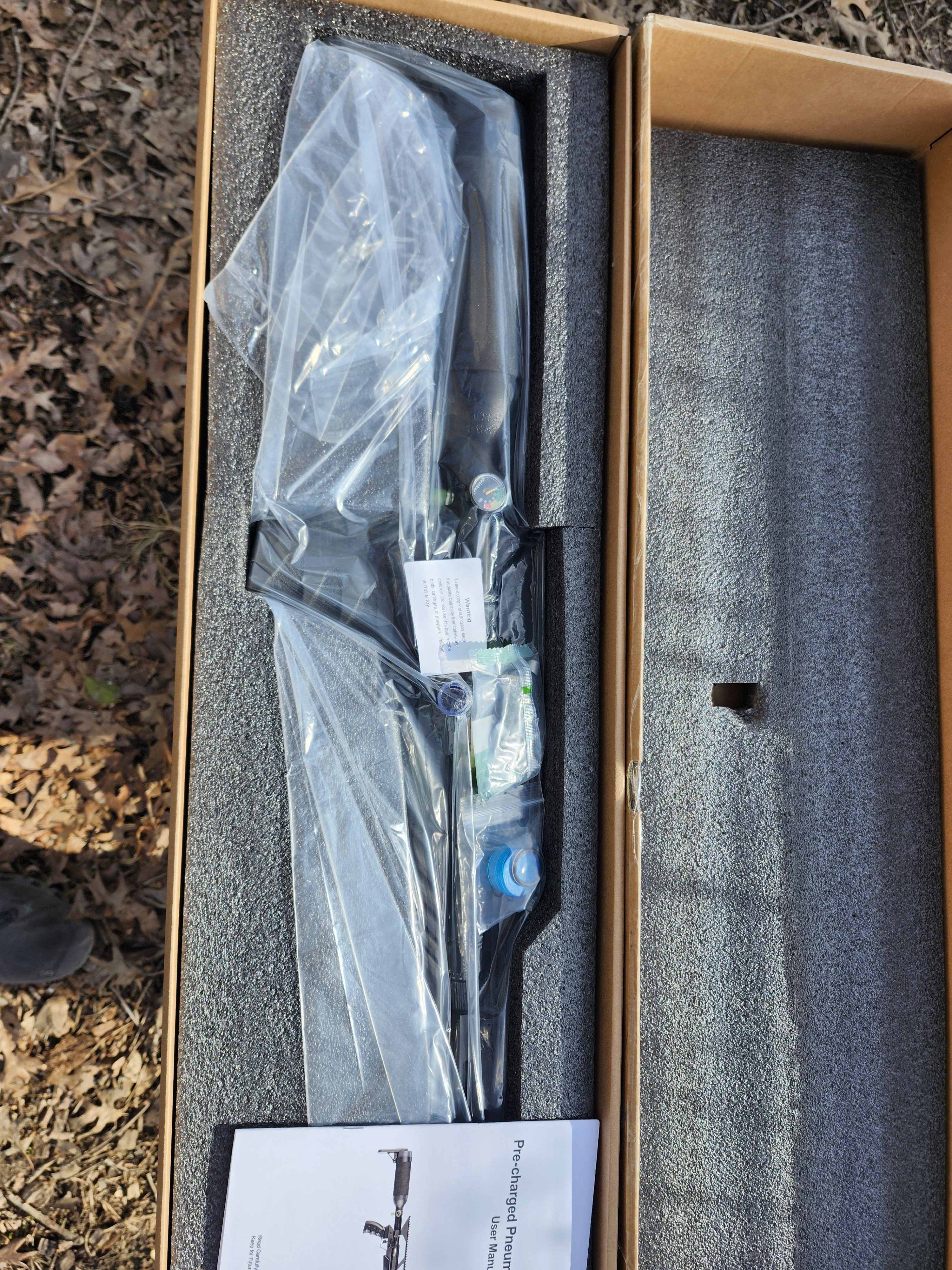

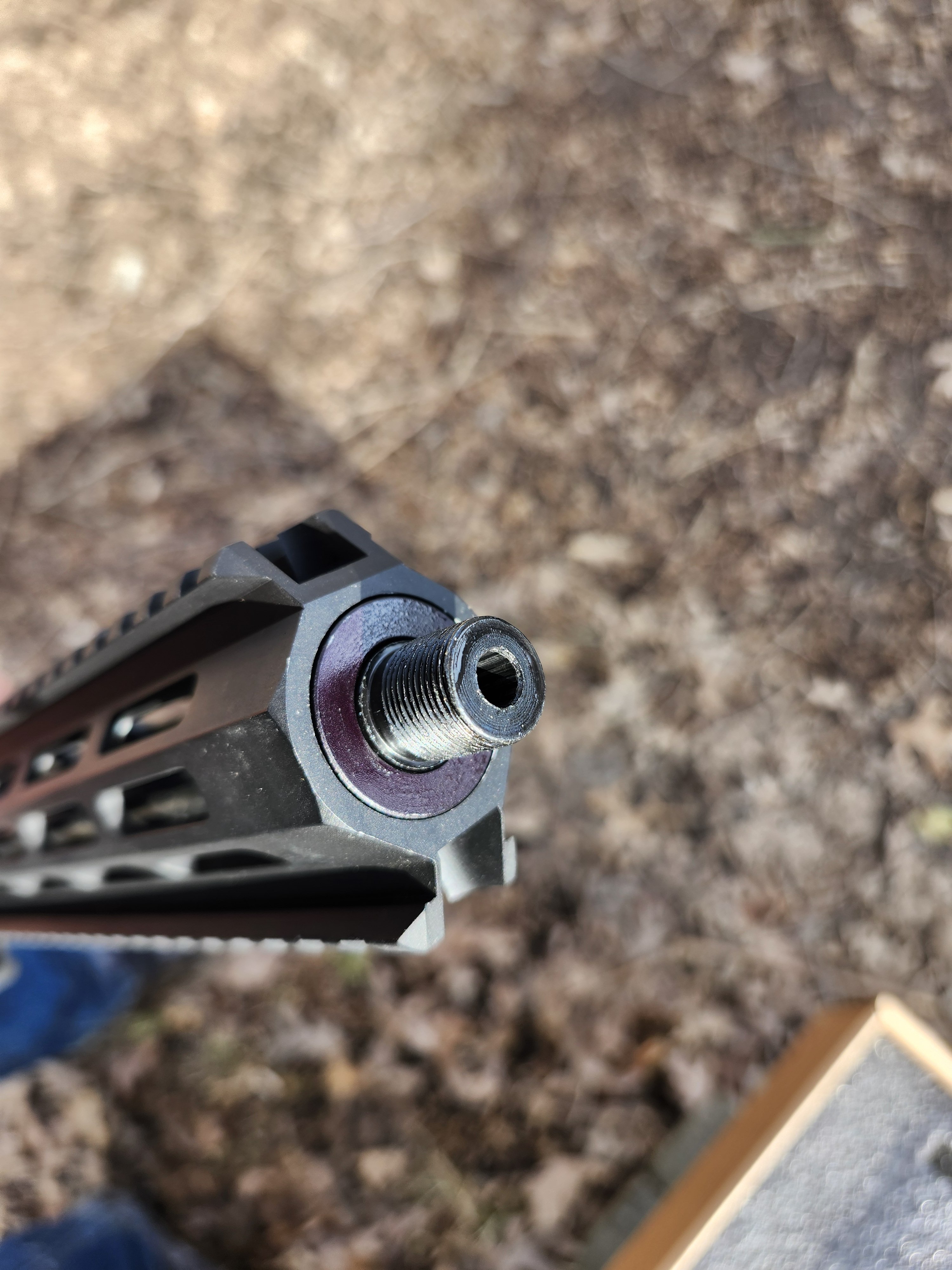

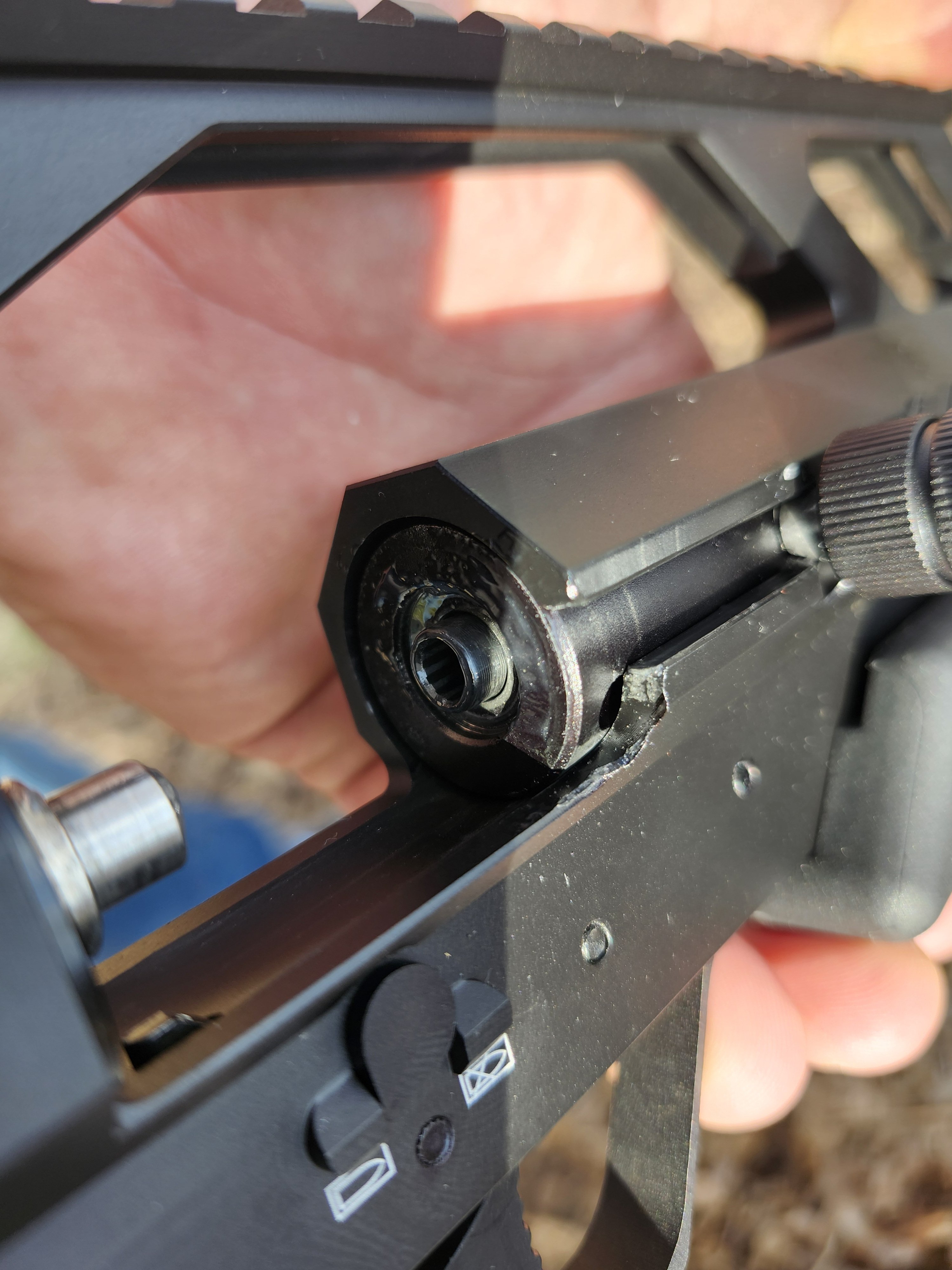

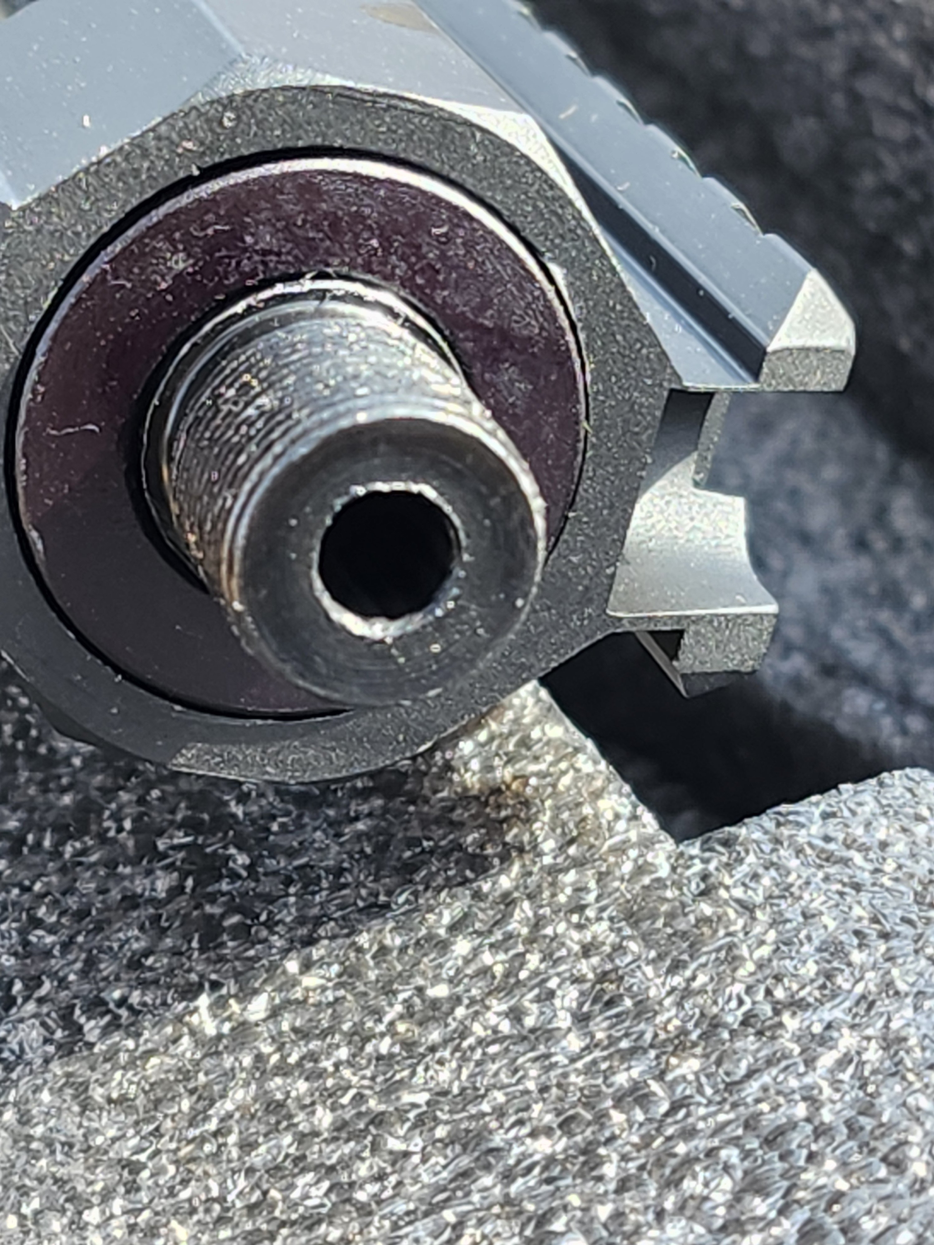

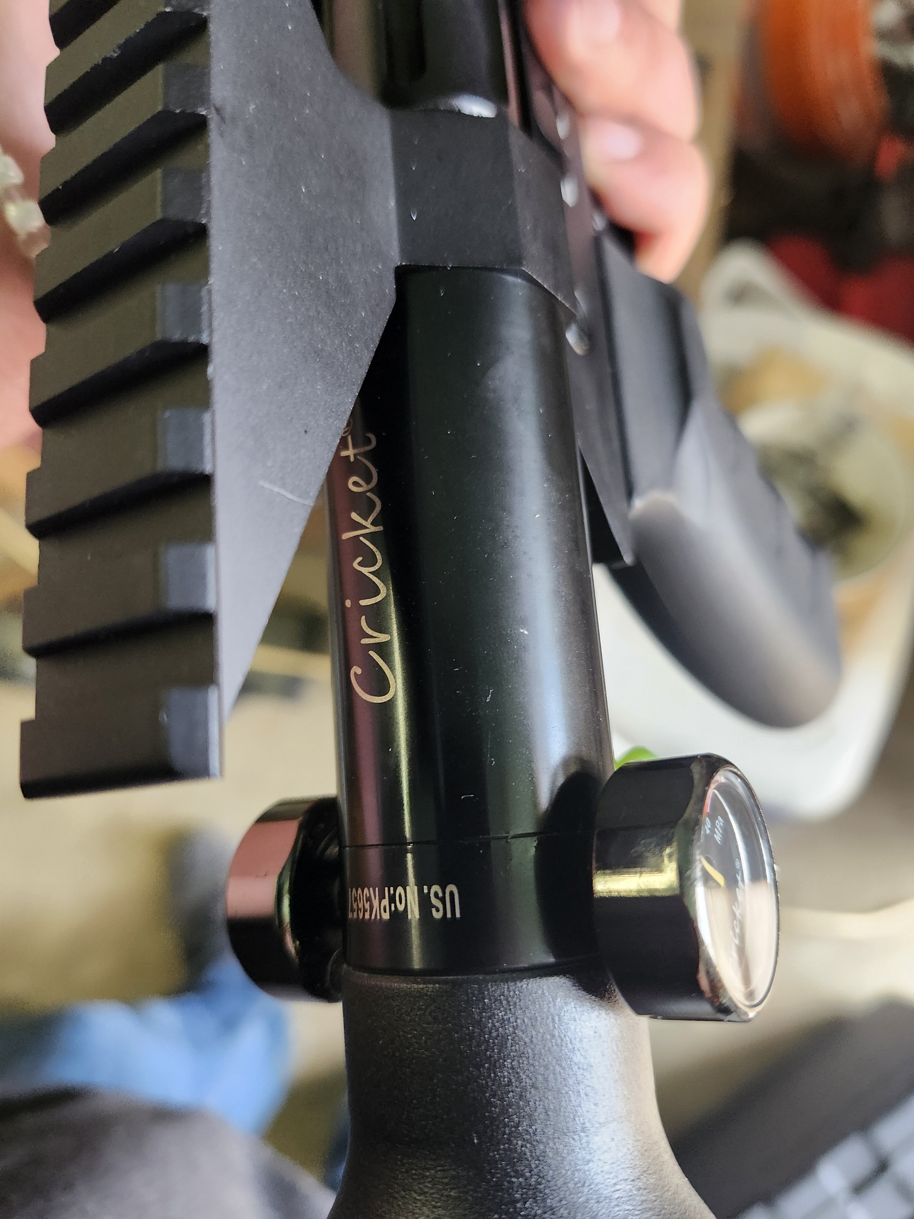

Single boxed. Minor box damage from the cocking Lever getting pushed through but zero damage to the actual rifle. Cocks extremely smooth but first look at the barrel doesn't give me high hopes for accuracy. A new leade and crown are likely needed but we'll test as is prior to any mods. It has Cricket gauges and reg but a Huben reseal kit? View attachment 535357View attachment 535358View attachment 535359View attachment 535360View attachment 535361View attachment 535362View attachment 535363View attachment 535364View attachment 535372
Typical looking at both ends. They must have a turbo mounted to their cross slide. Good pics.

The thin part of the barrel is what the breech cylinder slides on, and is longer on the Clone than the AF, but will that actually affect anything? As I understand it on the AF version, the breech end is indexed to the breech slide by the 2 bushings on the barrel, not where the thick barrel becomes narrower. Will the AF barrel work if it is indexed properly, or is there enough room for the breech to slide?

Received my rifle today empty of air. Aired up to 3600 psi- looks like reg at 13.5 bar. Power wheel set at lowest setting . Shoots 14.3 pellets at average of 950 fpe for 5 shots. Will let it sit to make sure no leaks before more testing and adjusting.
No leaking on mine after 2 days. I had bumped mine down to PW2 with no change in velocity. Your reg seems close to where mine is. I just noted the 3600psi fill. I had been filling to 3000 because I failed to read the manual.
With the way that works you can't get the AF barrel far enough in. The cocking slide and hammer I believe are too far back. I can try but I doubt it works.
Lots of work to catch up on so it will probably be several days before I can get back to this. I have limited time at the 100 yard indoor range down the street so I went ahead and re-crowed the barrel and turned down the M14x1mm thread and used a die to convert it to a standard 1/2x20 that way I wouldn't be limited on the Mod I used on it.
