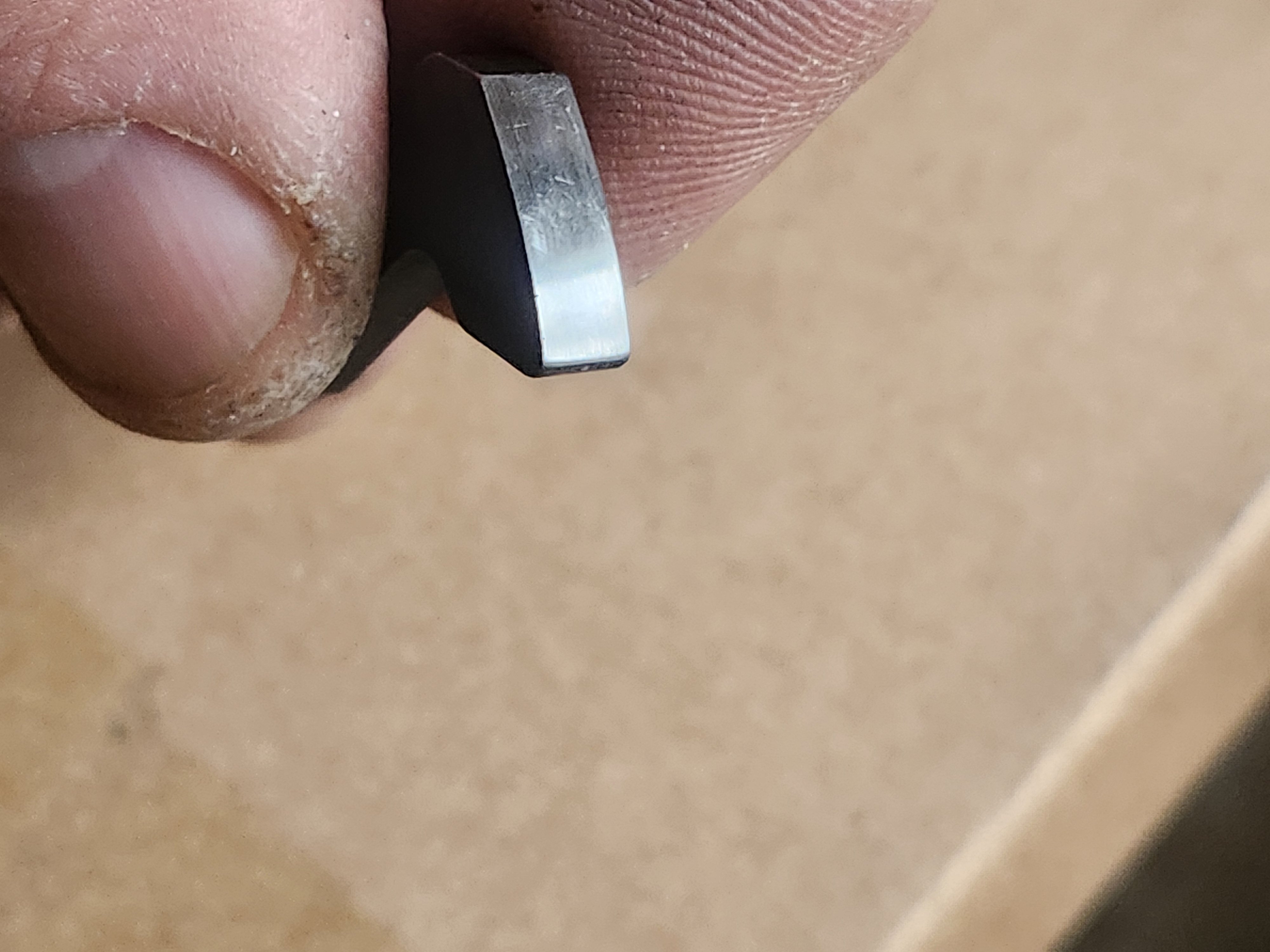

Not just a polish. I reshaped the actual sear. When you pull the trigger it is pushing the hammer forward against the hammer spring before releasing. That's why they are so heavy. I did what we always did to the original Kral guns because they had that same issue before they switched to the new trigger design they use now.

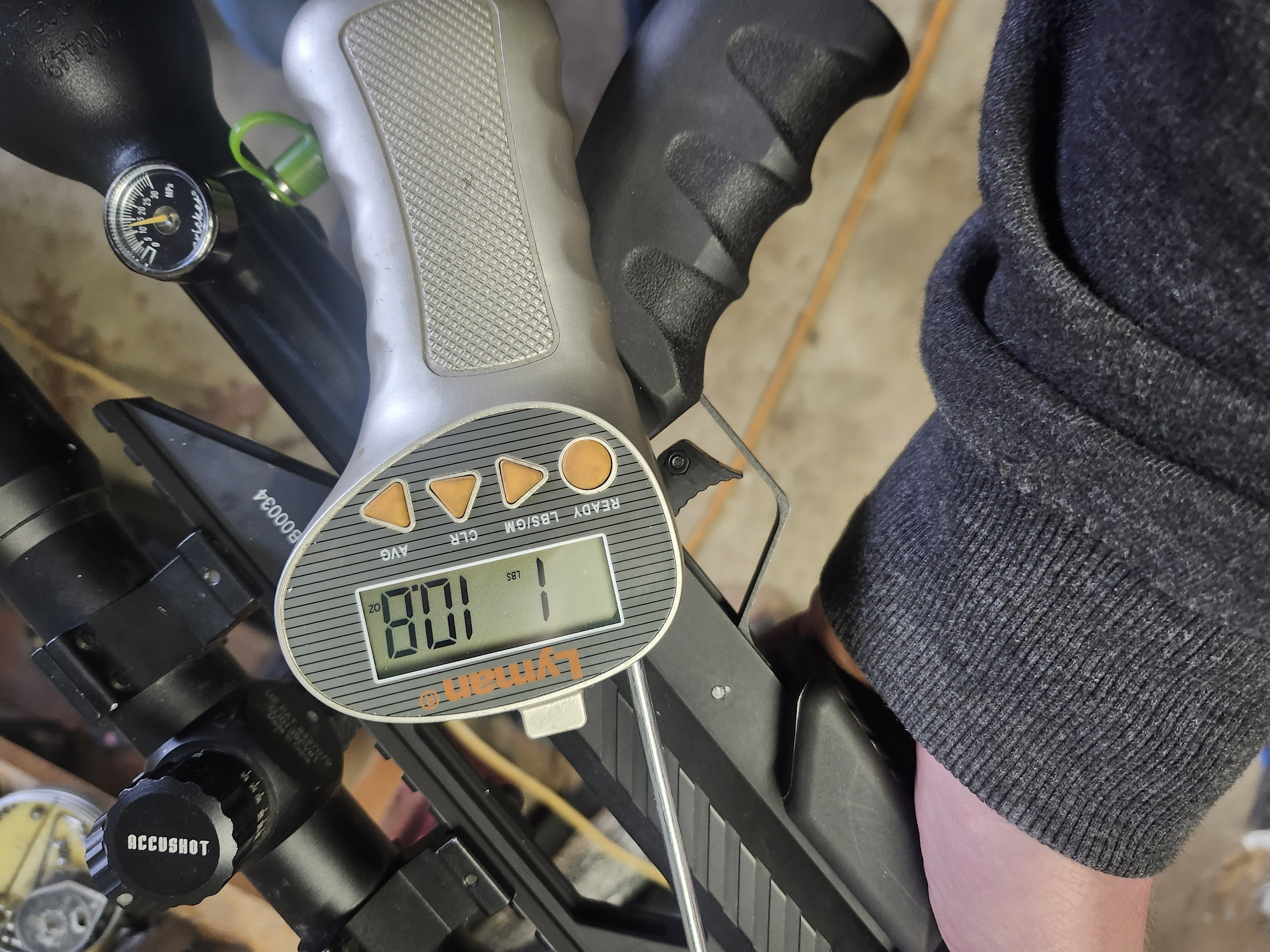

Polished the hammer where the sear engaged. Profiled the sear and polished. Both polished to 1000grit. Sear was completely flat causing the trigger pull to overcome friction and push the hammer forward adding the hammer spring weight to the pull as well. Here are my results after the mod. It's still a rather long travel but I prefer that over a safety issue shortening the engagement.
