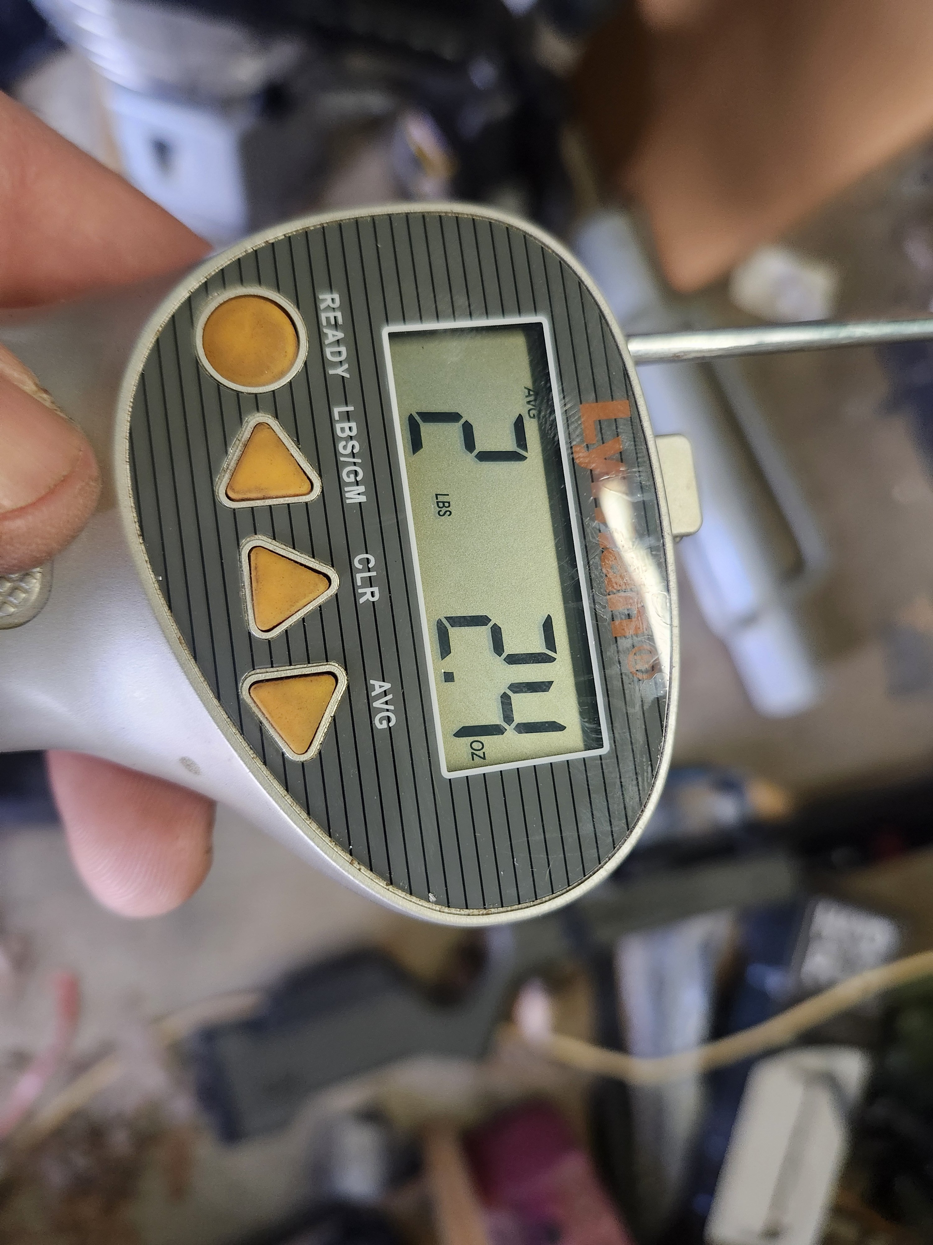

Average of 5 trigger pulls. Travel cut down by about 70%. Still a single stage but very predictable now.

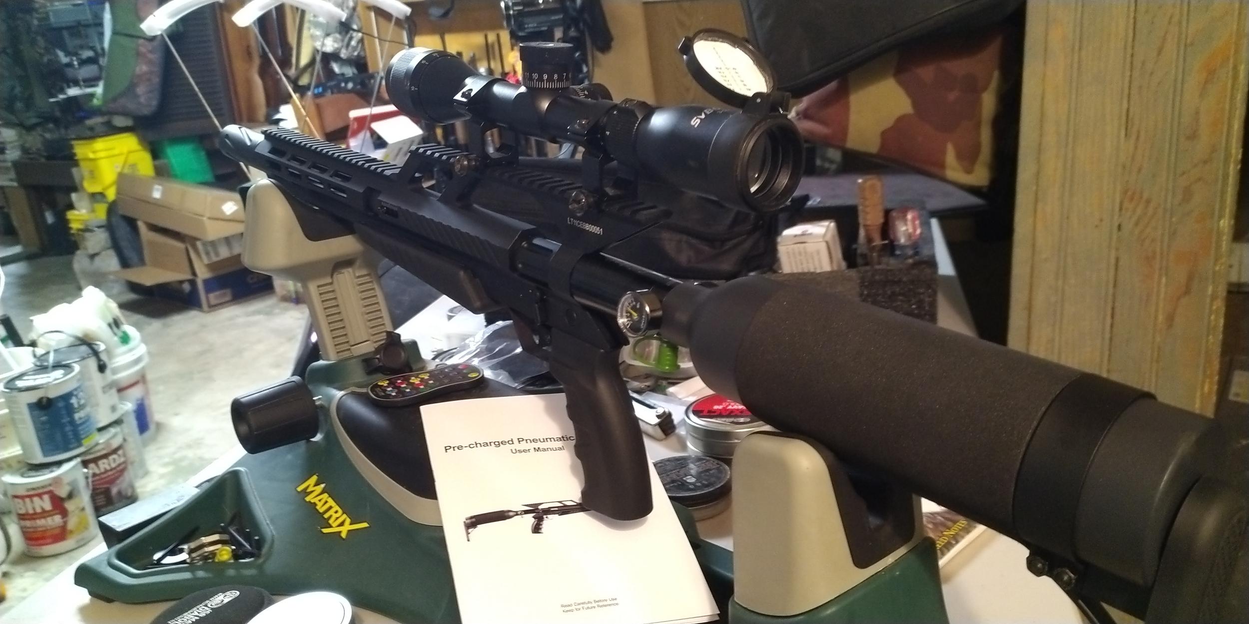

Well mine may need some exploratory surgery. Mounted scope and gassed her up. Bolt is very difficult to get forward and back and in to battery, just stops dead. Feels like too much slop in the mechanism, if I put pressure on the tube to straighten it out it works. Might be a break in thing, but I do not think so. Feels like too much slop between the parts. It does seem to be holding air. I think the metal tube may have something to do with my issue, it looks like the tube in the breech. I sent an email to Pinty for next steps, we shall see how the response is. The trigger is heavy. I like the weight and the scope mounting went smoothly. While lightweight other than the slop in the bolt the gun feels and looks good. I'll see what Pinty has to say I do wish they had a parts breakdown in the manual.
Mine made it today fired it 2 times, it works, so I mounted a scope and check for leaks. I did find a bit more play in the bolt than nessary will look into that deeper, though if one pays attention and lines it up gently, it does work LOL
