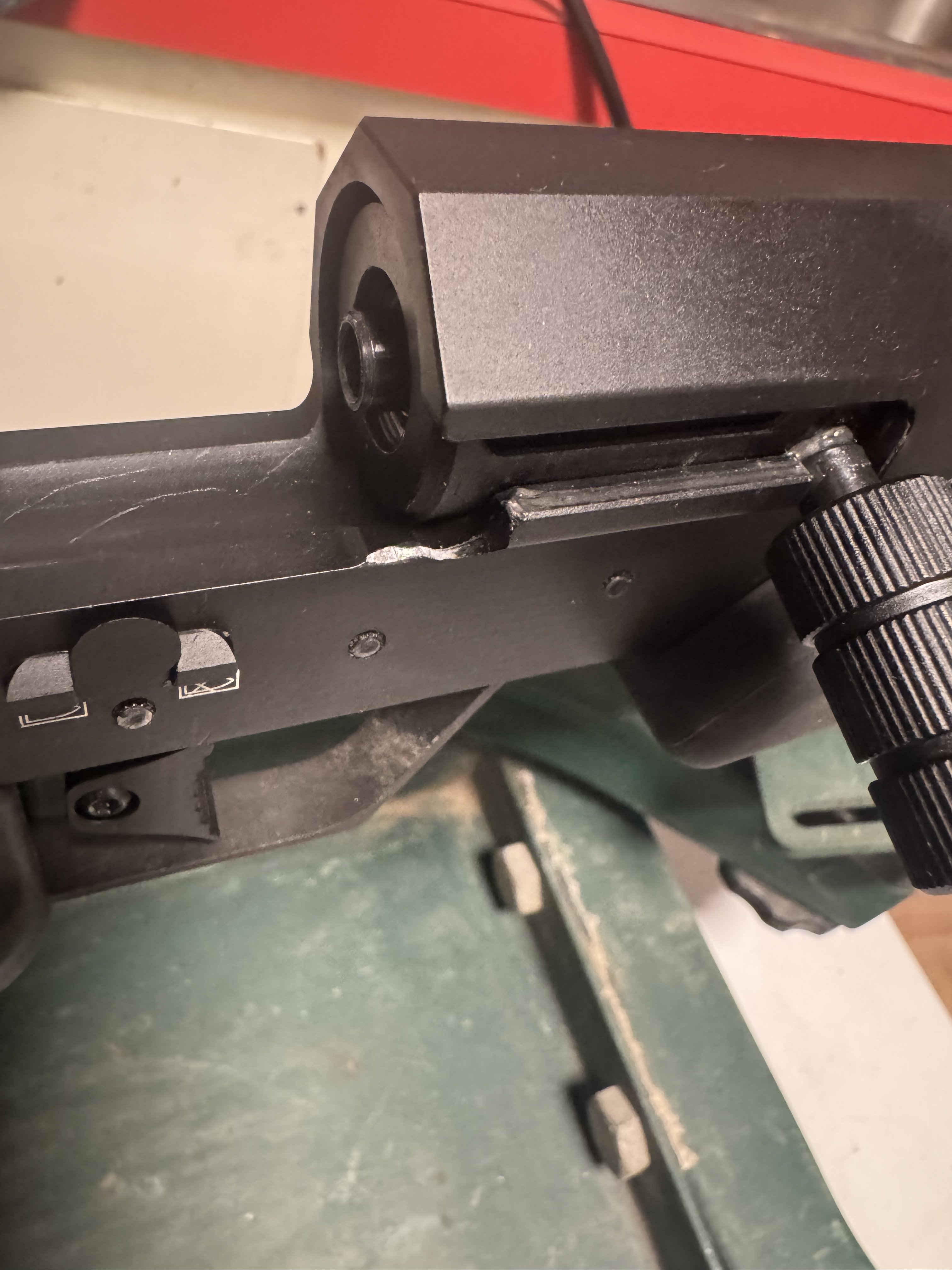

I will get a video off to Pinty today. The video here details my issue very nicely. The fit of the bolt body to the bore is "rather casual" not quite hammer handle in a bucket but sloppy enough that it jams hard unless guided. Other than that issue? A tray for loading would be most welcome, a tray is not compatible with the design. A device like a snail style capper as used for muzzleloaders would be most welcome.

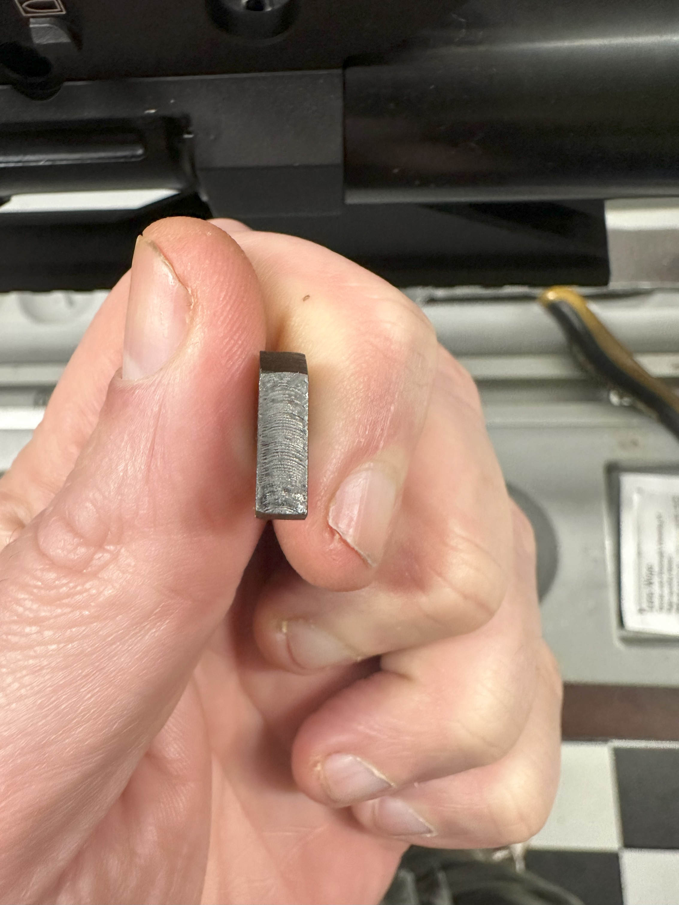

There is a bit of slop for sure. Maybe delrin spacers or similar. Still, the slop in mine isnt bad enough to warrant much fuss. Did a recrown on the barrel and tinkered with the trigger some. The machining on the sear engagement was quite bad.
So cleaned that up a bit and profiled it slightly. I think the hammer face will need to be profiled as well (per @thammer pics earlier in this thread). I'm just not comfortable with doing it.
Still, it wasnt grouping badly in my preliminary testing (pics earlier in this thread).
I did try a stock AF hammer and it worked, but was significantly lighter than the PForce hammer and I was getting much lower velocities. I may try a stock hammer with the Condor extra hammer weight today and see how that goes.
It may be my imagination, but the trigger seemed a bit lighter with the AF hammer, possibly because it wasnt just a flat end for the sear to catch on.

Well I'm going to hold off "fixing" my brand new freight damaged gun. I can get it to work manipulating the bolt just so, it is sloppy fit and I can see damage to the receiver tube from the root of the bolt. The bolt handle made it all the way out evidenced by the size of the hole in the box. I expect to hear back from Pinty tomorrow or Tuesday. Resolve the bolt issue, fix the atrocious trigger (thanks thammer) and this is a hell of a gun for the money. Really enjoy the light weight, yet the gun does not feel cheap. Now if I can get the takedown lever back in my 1911 all will be semi right with the world. No idiot marks allowed.

I'm willing to give them opportunity to resolve, with the damage I'd like to see mine replaced. Not ready for prime time! Seems the hole in the box and needing to guide the bolt home are related issues. Fix that and fix the trigger? The gun has a great feel to it the few shots I have been able to fire. Very consistent I think it is accurate but the trigger makes that tough. I hope to be pleased by Pinty's customer service.
