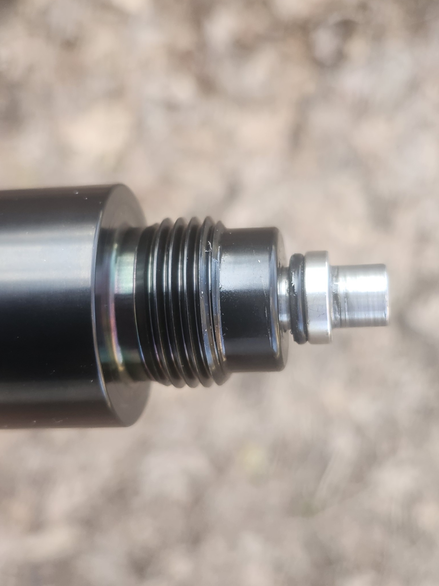

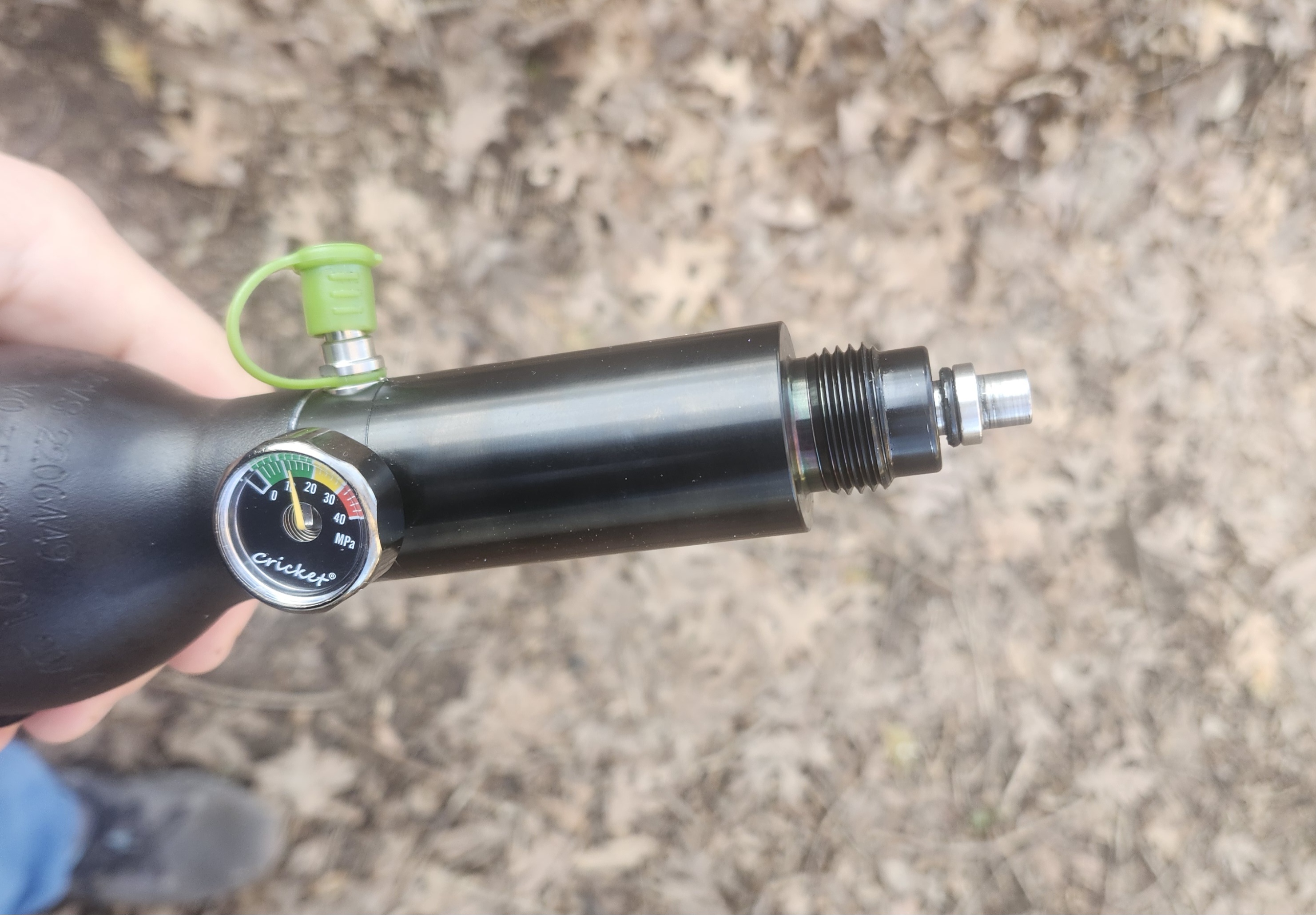

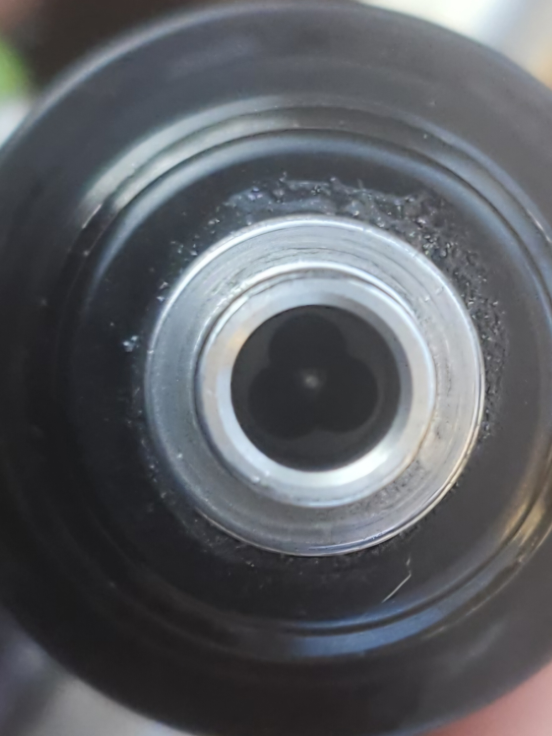

Tank and valve will unscrew without tools. Just twist off. Here's the valve. I've not gotten into the guts yet but looks very similar to an AF style. I added that o'ring behind the tophat to see if it helped with efficiency. I've seen it before from others on the AF guns.
Reactions: markhooper
From the picture the body seems longer than an AF valve which given the "guts" of an AF valve would mean several CC of plenum.
I literally was thinking yesterday that a longer body valve would be a good thing and how to go about testing that. Easiest would be a 6061 M18 threaded extension. Alternative is manufacture a Valve body threaded m18 male one one end and the female valve threading on the other end.
Plenum are a very good thing. The 50CC on the Huben Power Cricket Max-ATH makes a very big difference on my Talon SS with the high flow valve. The 20CC on the Cricket Z-valve less so but still better than without.
