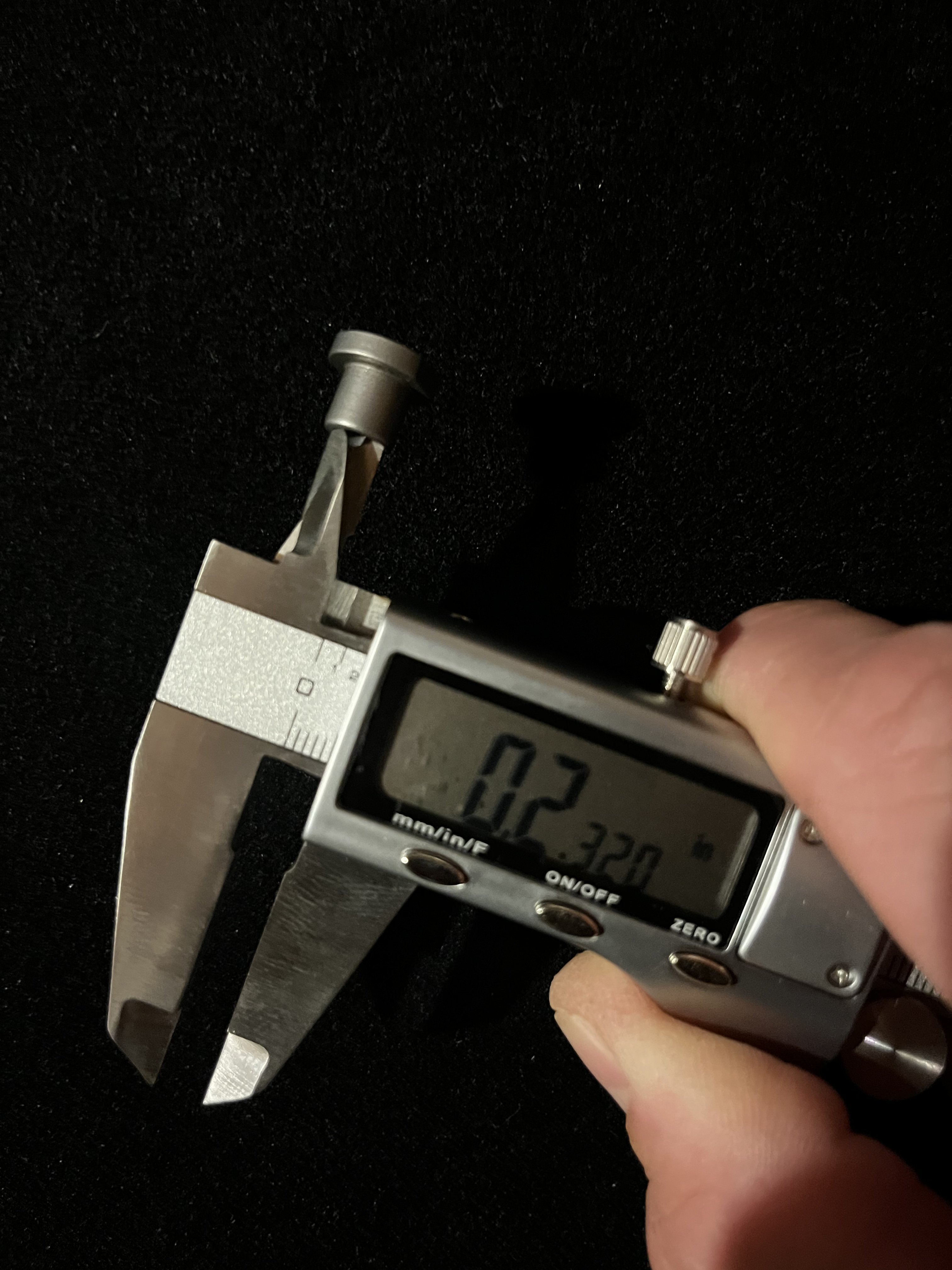

I have a newer Condor SS purchased 10/23. I just measured the inner diameter of my valve cap and it’s .232in, the same spec as the largest profile in the Ring-Loc kit description.
“The Ring-Loc™ Valve Pin Kit includes multiple valve cap orifice sizes in .232, .166, .145, .123 and an .070 that shooters can modify themselves for their own energy level setting.”
I guess there is no point ordering this kit for mine unless I want to tune down.
