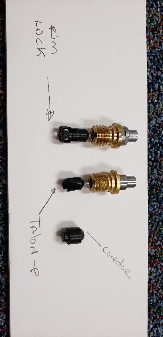

Tony has very good male foster fittings. He has O ring kits for the valve and 90D O rings for the breach in the kit. There is a O ring under the brass piece in the picture that is a common leaker and I would replace it while you have the tank empty. I have three Condors and all of them needed those O rings and foster fittings fixed after a few years. Tony also has gauges that are dead on, not like the junk gauges that come with the guns.
