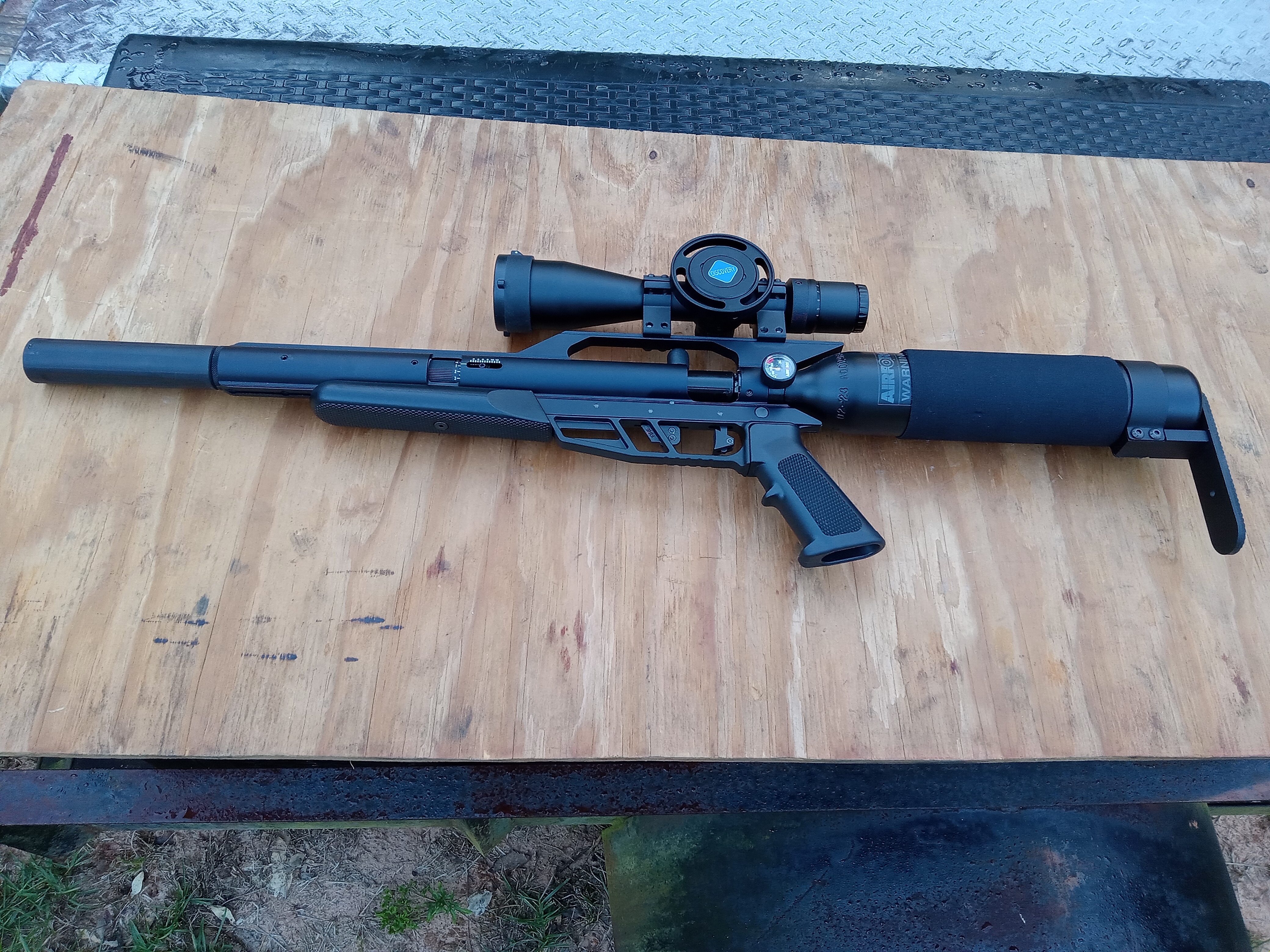

sometimes if the safety won't disengage its because you didn't cock it all the way, I did that a couple times. try pushing the bolt handle forward a bit more and see how that goes. but as far as the slot not being numbered....yeah I don't know how that would have happened, I would definitely send it in for repairs at least. they are great guns, but that power wheel is part of the Airforce charm.yeah the slot is completely blank... i have numbers on the wheel..sending it back to airforce two shots of the brand new gun and safety stock on engaged
Waiting on my new replacement those guys took care of me right away no questions asked.sometimes if the safety won't disengage its because you didn't cock it all the way, I did that a couple times. try pushing the bolt handle forward a bit more and see how that goes. but as far as the slot not being numbered....yeah I don't know how that would have happened, I would definitely send it in for repairs at least. they are great guns, but that power wheel is part of the Airforce charm.
