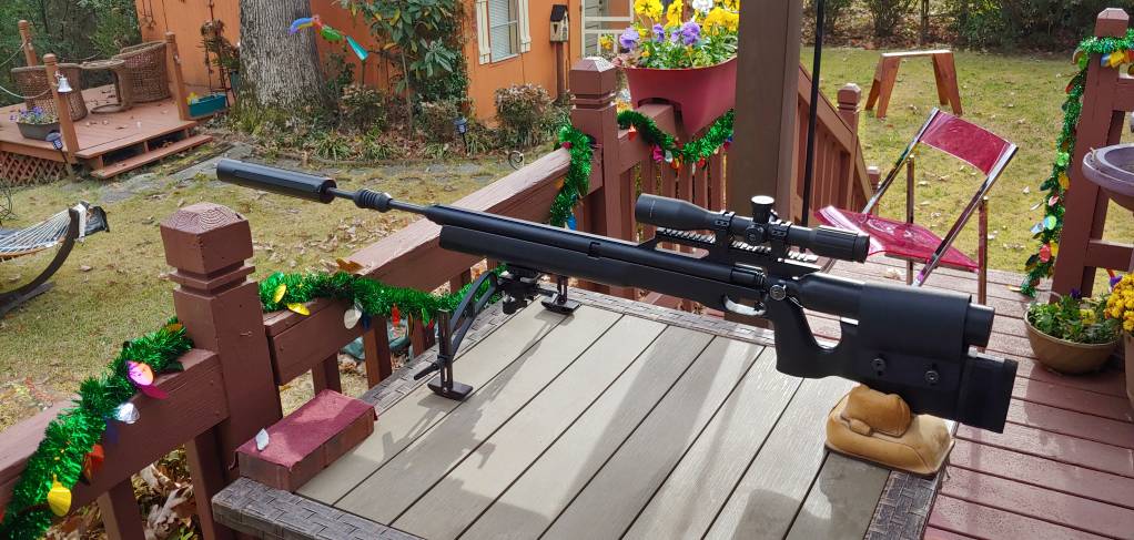

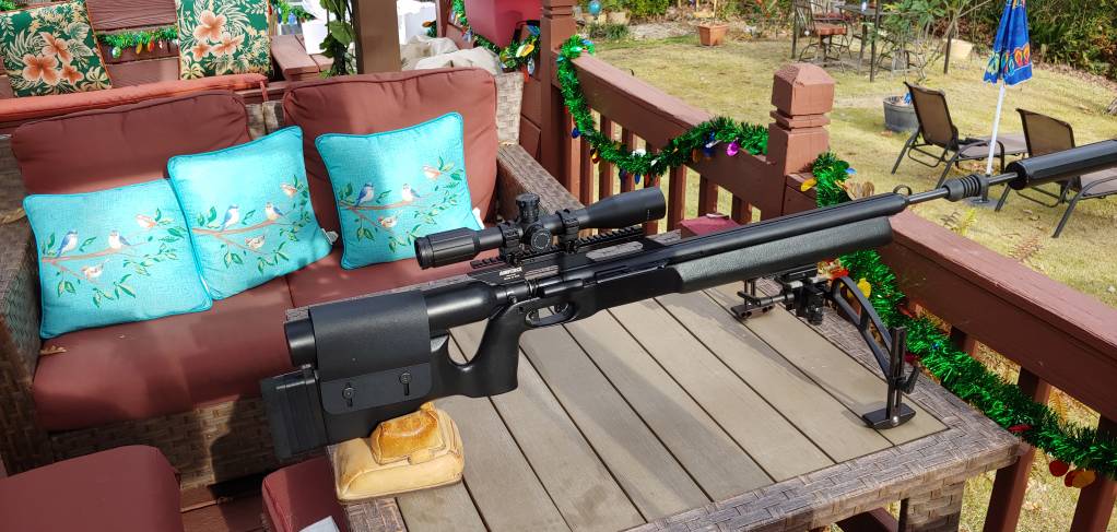

The best cure for frame flex in Air force guns that cause the bottle to come loose is a good support system. The Maddog stock is the answer.
