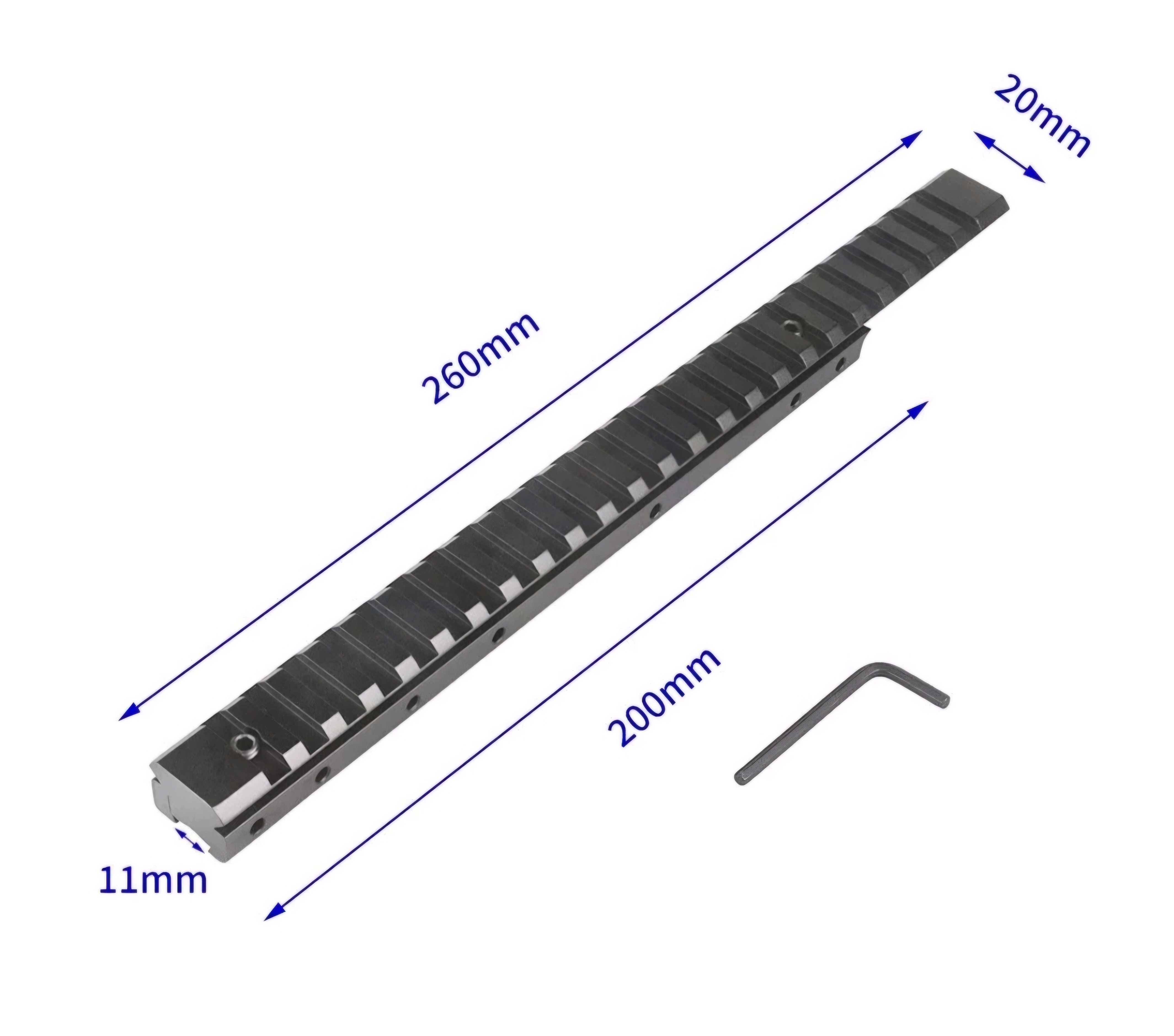

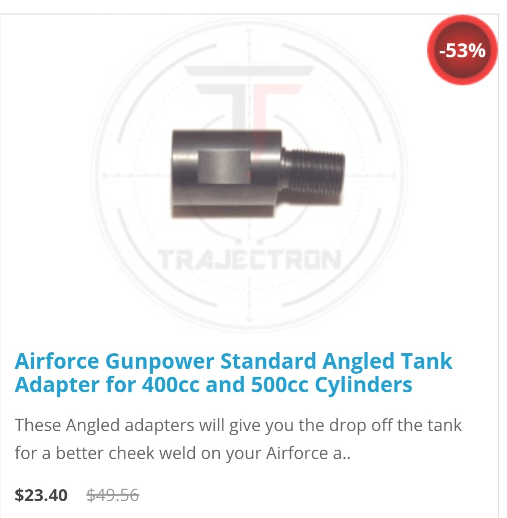

If you have one of the older frames you could use a workguard and install the grip of your preference. Me personally could not use a AF without it.. I had 2 Texans and I installed on both.. trajectron sells a bottle drop adapter that will inclined the bottle just enough to be able to use low rings..buy the one for the standard bottle.. the one for the big bottle the incline is to much.. n ebay has a 260mm picatinny rail that uses like 8 screws n is as long as the texan rail..
