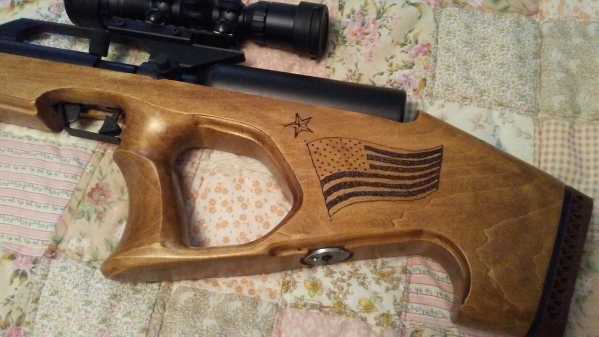

Hi,

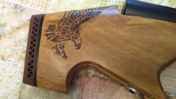

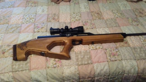

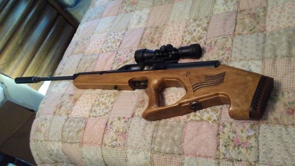

I bought an A.F. Talon P a while back and after shooting it a bit, decided it needed a stock to hang on to. I picked up a 2.5x12" plank of basswood and laid out a stock, using the gun as a template. Basswood works like Styrofoam, so cutting and shaping went quickly. For finish I used light walnut stain and Varathane as a final finish. The eagle and flag were done with a woodburning pencil before finishing.
Since basswood is very lightweight, the pistol now turned rifle carries easily. I've recently swapped a 24 inch barrel for the original 12 inch tube. One of the great things about the Air Force guns is they are easily customized to the owner's preferences. Now I need to decide what to build with the leftover 12 barrel.
Howard

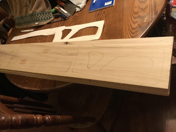

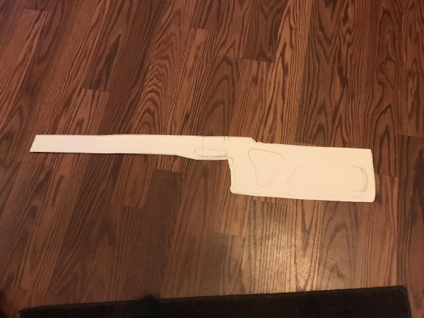

Slowly but surely I’m getting closer to outlining mine on my blank Loren. I’m going to go with more of a skeleton butt stock area, kinda on the lines of the Wildcat. I still need to go thru my router bits but I think I have what I need, I’ll probably get the bulk stock cut out tonight on the bandsaw and then go from there. I kinda a have a few things going on so it’s hard to just focus on one thing right now. This is what I’ll cut out of the blank and go from there.
