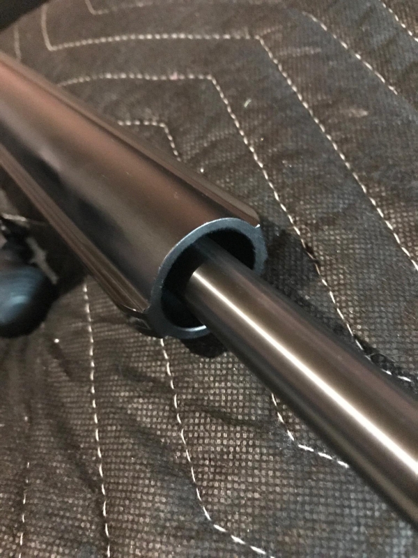

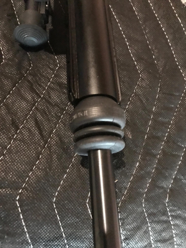

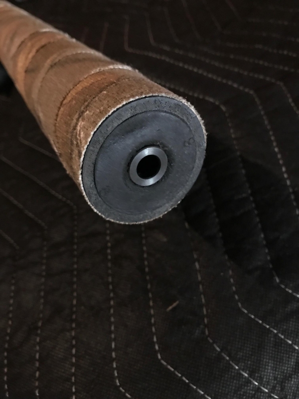

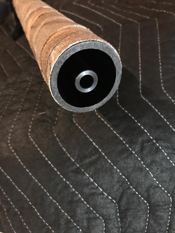

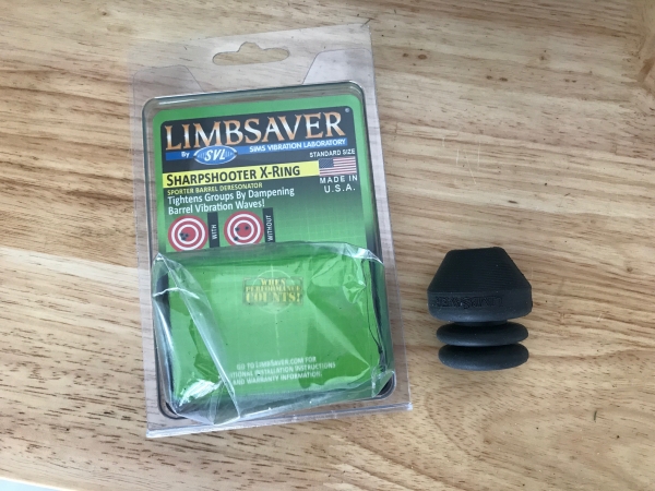

Another HOLE-IN-ONE BABY! .357 Big Bore AirForce Texan with 128 Gr. Aeromagnum rounds. Out of the box, the .357 Texan really isn't all that accurate. I have been tinkering with different pellet weights and shapes. It really likes Neilson Specialty .357 Ammo 180 gr. cast bullets at 50 yards and will be my hunting round for this year's deer season (.35 cal air rifle and up is now legal in Michigan - woohoo!). What helped the most to tighten up groups was this x-ring barrel harmomic tuner to replace the factory end cap and then I have a 1.5 inch plastic ABS homemade shroud with a rubber plug to also dampen the harmonics at the muzzle.

Hmmmm..... Might be time to pull out the AirForce Texan .357 with FX No Limits rings! She has been a bit of a temperamental B%*$&TCH though since I got her from AGN. Tried ammo from 81 gr. to 180 gr. and about 4 different sizes in between. Pellets - hollowpoint - spires - I couldn't get ANYTHING to group better than 2 to 2.5 inches at 50 yards. So I started doing some homework and watched what David Williams, founder of Hunters Supply, was cooking up with their Texan tune services. If you look REALLY closely at everything he is doing with his tuning services - I am seeing him tinker a lot with barrel harmonic tuners (barrel donuts) in the videos posted and in the photos on his website. Check out his World Record .308 Texan photo on his homepage. Do you see that rubber thing about halfway down his barrel.
Well come to find out - that rubber thing is the secret sauce. Nick from Neilson Specialty Ammo also dropped a hint that the Texan has REALLY BAD harmonics. Well - there is somewhat of a fix for that and it is that ugly rubber donut. So I took it a step further - I added one of those barrel tuners replacing the factory cap (actually called a x-ring de-resonator from Limbsaver) and also added a homemade shroud to give the barrel some rigidity all the way to the muzzle and added a second tuner rubber end cap at the muzzle.

So how did I pull this all together in a short amount of time. Pure obsession and a crazy amount of networking within the airgun community. It is the spirit of shared knowledge that made this 350 yards shot possible. I just absorbed as much info from all the subject matter experts that I could - lined up the cross hairs and squeezed the trigger. As far as learning about the .357 Texan - I have been chatting with Jimmy (the guy who won the AGD Texan Give Away) and learned a lot from him. Through Jimmy I met Nick Neilson of Neilson Specialty Ammo who has been on a war path about the harmonics and twist rate concerns he has about the Airforce Texan series. Learned A TON from his posts on other forums and hypothesized what tweaks I needed to make even before the rifle arrived. From that info I was able to reverse engineered (at least some) of what the folks over at Hunters Supply are doing in their tuning services to turn the Texan to a real long range rifle. It was from Hunters Supply photo and video research that I realized that this barrel was going to need some major harmonics and rigidity help (thus the de-resonator donut and homemade ABS plastic shroud). Here are the photos of what's under my DIY barrel shroud. This thing made a HUGE difference!
