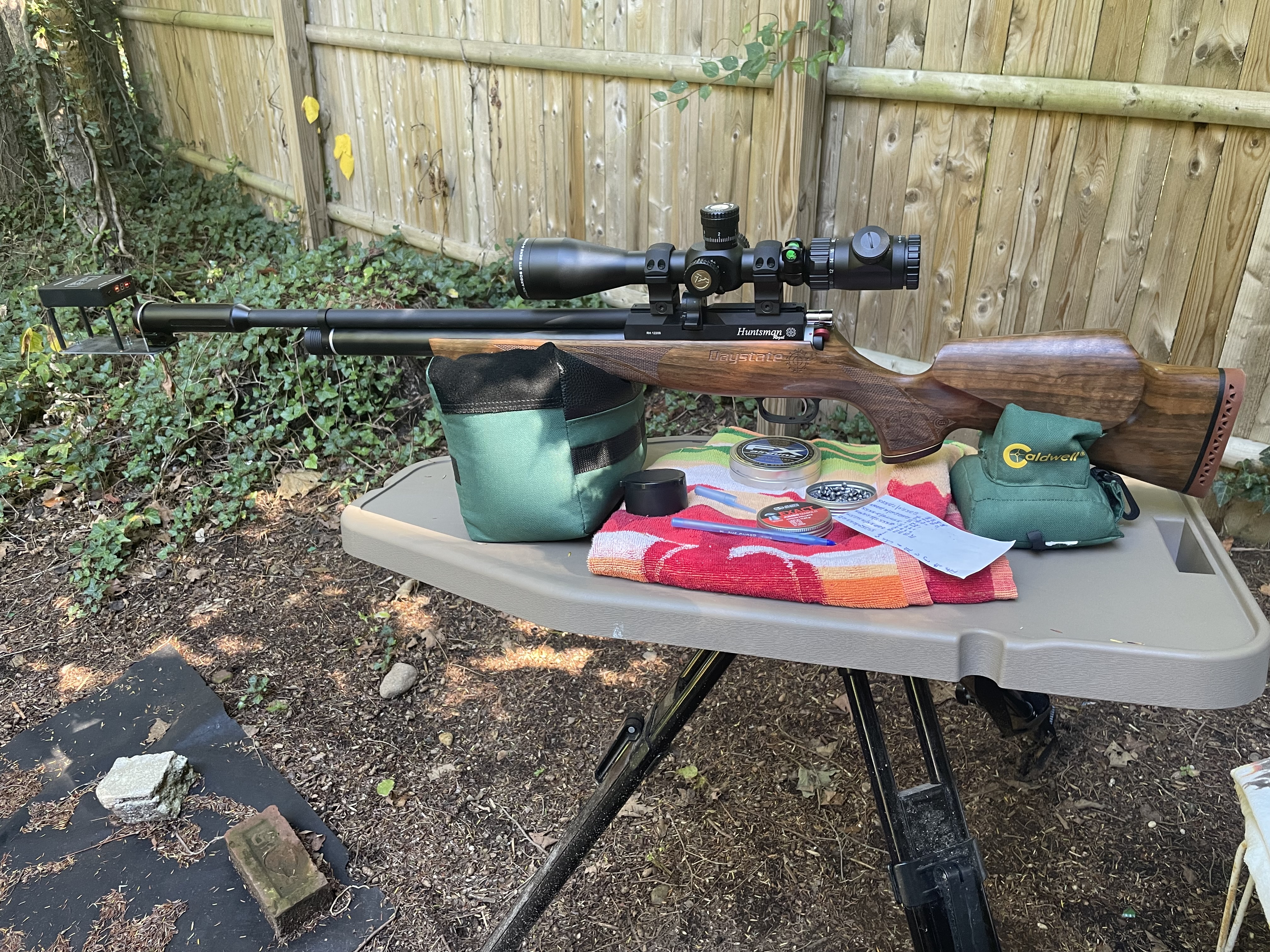

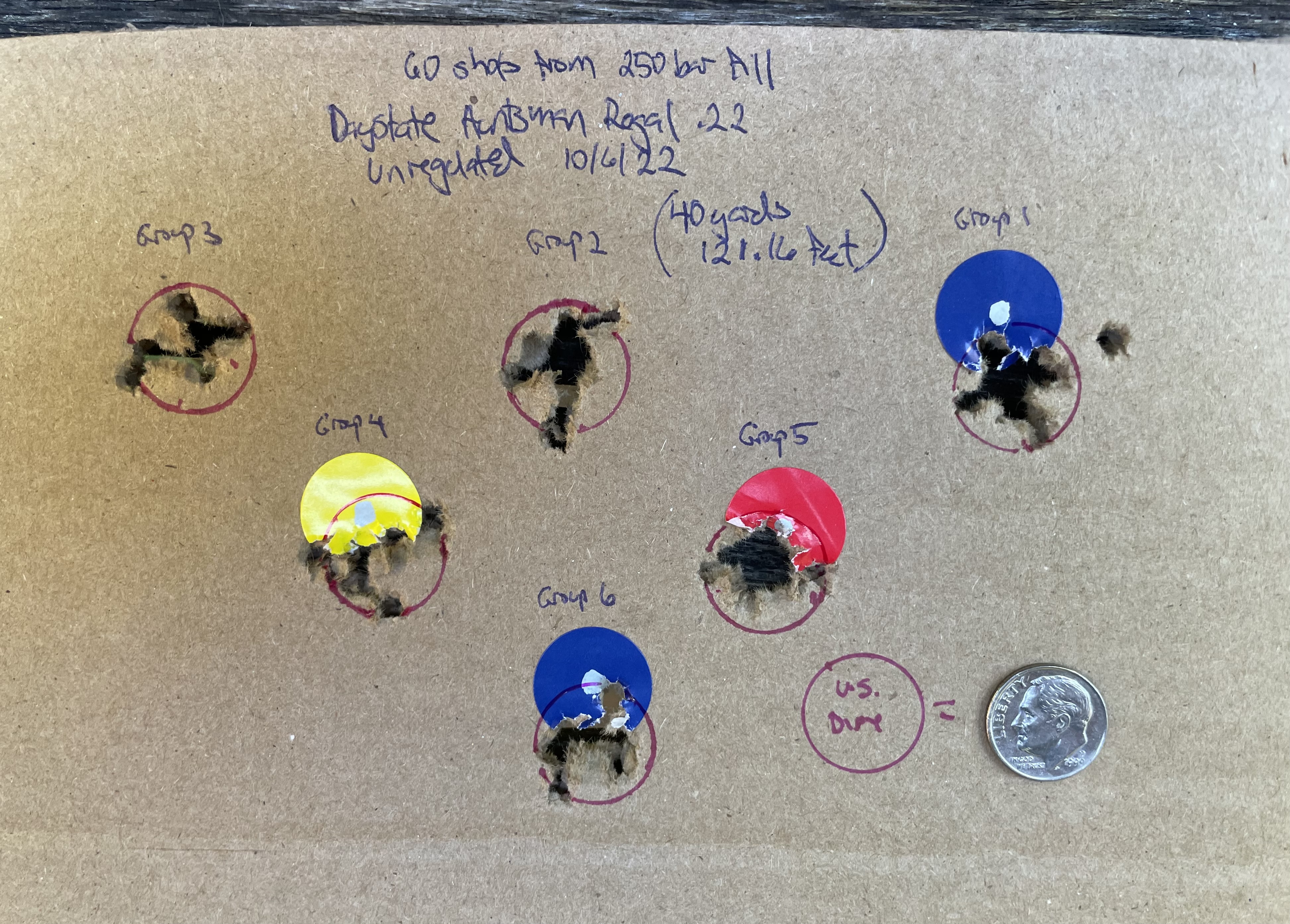

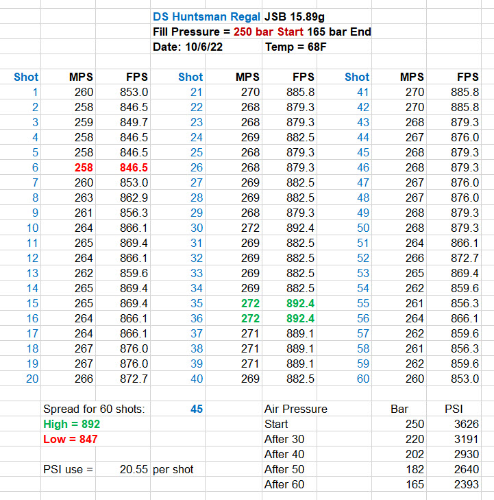

Yesterday, I filled her to 250 bar and fired off 60 shots. Attached are the shot string and picture of the 6 ten-shot groups.

You will note that at 40 yards distance (121.16 feet - measured with a green laser accurate within 2 millimeters @ 100 yards), all ten-shot groups fit within a US dime (I pulled one shot) - and I’m just firing off groups, not “super aiming”, lol. Pellets are not weighed - straight from the tin. These 6 groups are typical - I’ve had some outstanding ones in the past - but these are typical of how the gun always shoots.
You will also note that at 40 yards, the point of impact did not change over the 45 fps spread of the unregulated shot string. I didn’t touch the scope or change my point of aim between shots/groups. Notice that PoI did not rise or drop noticeably over the 60 shots at 40 yards.
The Huntsman is only 42” long - WITH the moderator. It has a shrouded barrel and is backyard quiet with a small moderator. It is shooting with 27-28 foot pounds of power. This is enough to shoot any bird, rat, squirrel, rabbit, groundhog or skunk. The nice size, weight and ergonomics make it an easy gun to shoot accurately.
