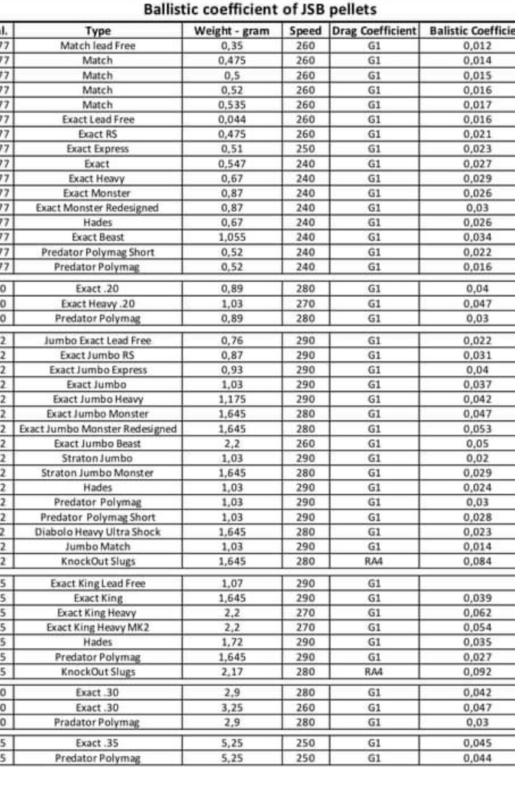

Which pellets are you shooting? Downrange velocity would be critical for calculating BC but if you post what you're shooting it's possible someone will have a source for that info.
JSB King Heavy MkI and MkII. At least that's what I wanted to shoot tonight, but I'm debating on resting or maybe just shooting in my yard.

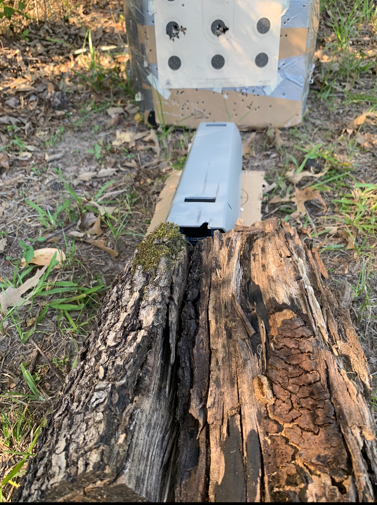

When all I had were optical chronographs, and I wanted to check the far distance velocity, I would place a brick or something in front of the chronograph screen to protect the vitals. I would walk down range after each shot to check the velocity reading. A later chronograph would store shot strings, saving some walks.

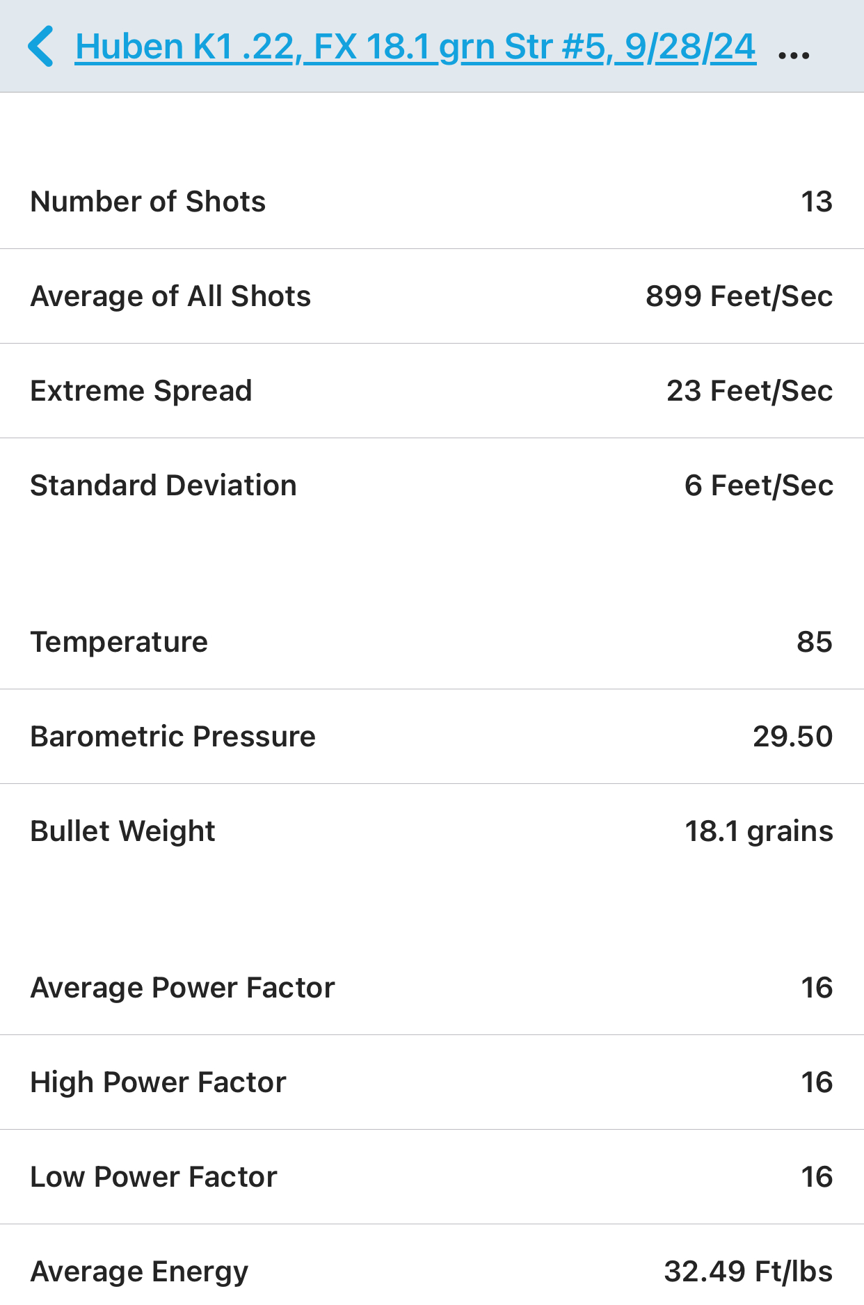

@Scotchmo Good advice. Still working on it. Only read one shot out of the 19-shot string. About to give it a go again. I think my phone was too far away or the wood is obstructing the Wi-Fi signal.
My Competition Electronics Chronograph was communicating with my phone all the way from 80 yards. I was actually amazed that it worked that far away. Maybe it is the log blocking your signal. I didn’t hide mine behind anything so I could actually see that the numbers on the chrony screen were changing with each shot. I was also using the light kit. I find the light kit to be much more reliable than just the ambient light on scene.
