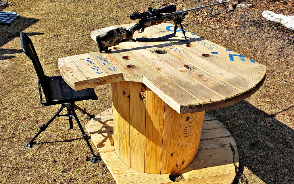

Marine ply is very $$$$$ , i would use 2x6 or 2x8 edged and glued to make a top , then several coats of marine deck varnish OR just had that pic in my file , in reality to heavy . I bought "Used scraps" of Marine ply at a pontoon boat repair place from re-decking jobs 2 ft. x 4ft. pieces for small amount $ . three coats of marine Spar Varnish and 8 years later as row boat seats out in the weather Still holding together .
I love that! Even had a place for a sun umbrella! A little too big for my porch though.

Marine ply is very $$$$$ , i would use 2x6 or 2x8 edged and glued to make a top , then several coats of marine deck varnish ORView attachment 544816
