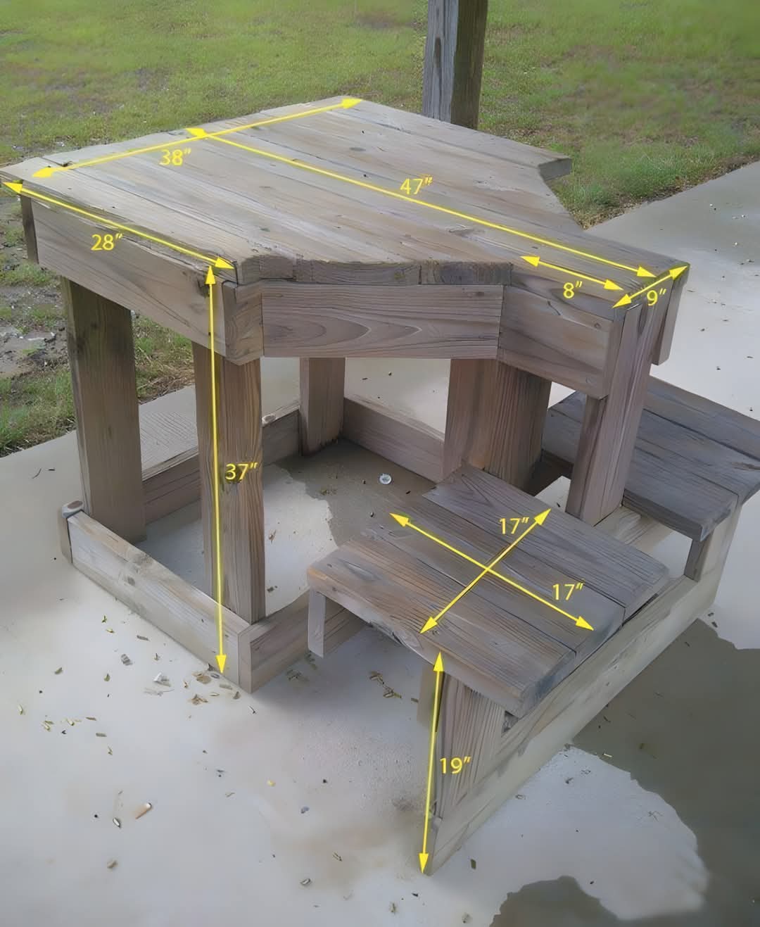

Here's a pattern for one I found a while back.
Hm...many of you guys shooting from a "side" of the gun.
Me personally like to sit "behind" the eye box.
And that makes the top plate shape much different.
If you start from scratch I would advise for a separate sit/piano chair.
Also make sure the top plate doesn't flex no wobble.
You will realize these ones you start shooting with high power scopes... x40 or x50

Agree, your shooting seat should never be attached to the shooting table.

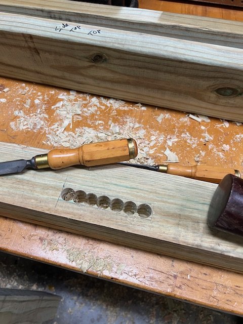

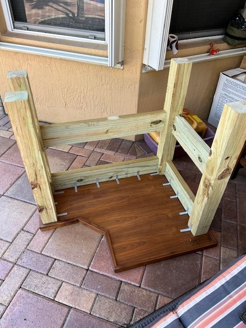

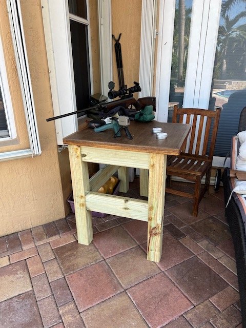

Built a nice shooting table with fold under legs from leftovers around the shop. Loved it until I started trying to hit dots at 30yds. Too wobbly. So just completed a new base out of pressure treated pine. 4x4's and 2x6's. Rock solid and heavy. Tenons on the table saw, old school for the mortices. Pegged with oak dowels since this pine was wet, it'll shrink as it dries. Anyways, no more wobbly bench excuse...
Do you have a link to the thread or pictures. I did something similar when my rear deck had rails. My front porch is close enoughto the ground it's not getting rails. The rear deck has a nice view so it's getting minimal railing that I probably wouldn't anchor a bench to. It's just my wife and I and she shoots too so my tables can be made fixed in both the front and rear. The front and rear tables face west and east respectively to provide proper shade and natural lighting. It's crazy hot in the Arkansas summer sun..
Link:
There are several other projects in there other than mine. I will take more pics and post where I am in the building process. It's almost done. Just in time.

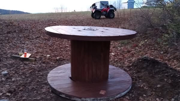

I take it you want to be able to move it? otherwise, I would use cement. I have a table made from a large cable reel; I have a cement poured slab under it. The reel weighs 375lbs i was going to anchor in but that thing isn't moving at all, its' be in place for 2 years now. If you do go with wood just make sure to get a good sealer/ stain. I used Flex seal, or you could use bed liner spray for the top. There are so many great ideas for a great shooting bench. Good luck and please keep us posted please? I found a pic.
