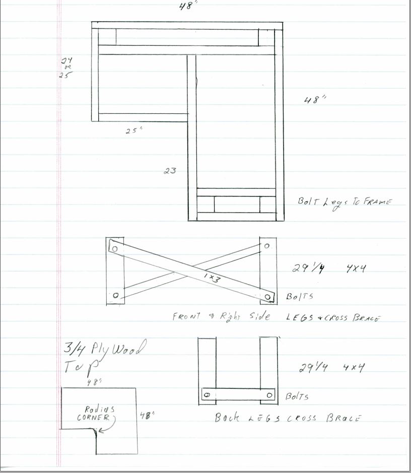

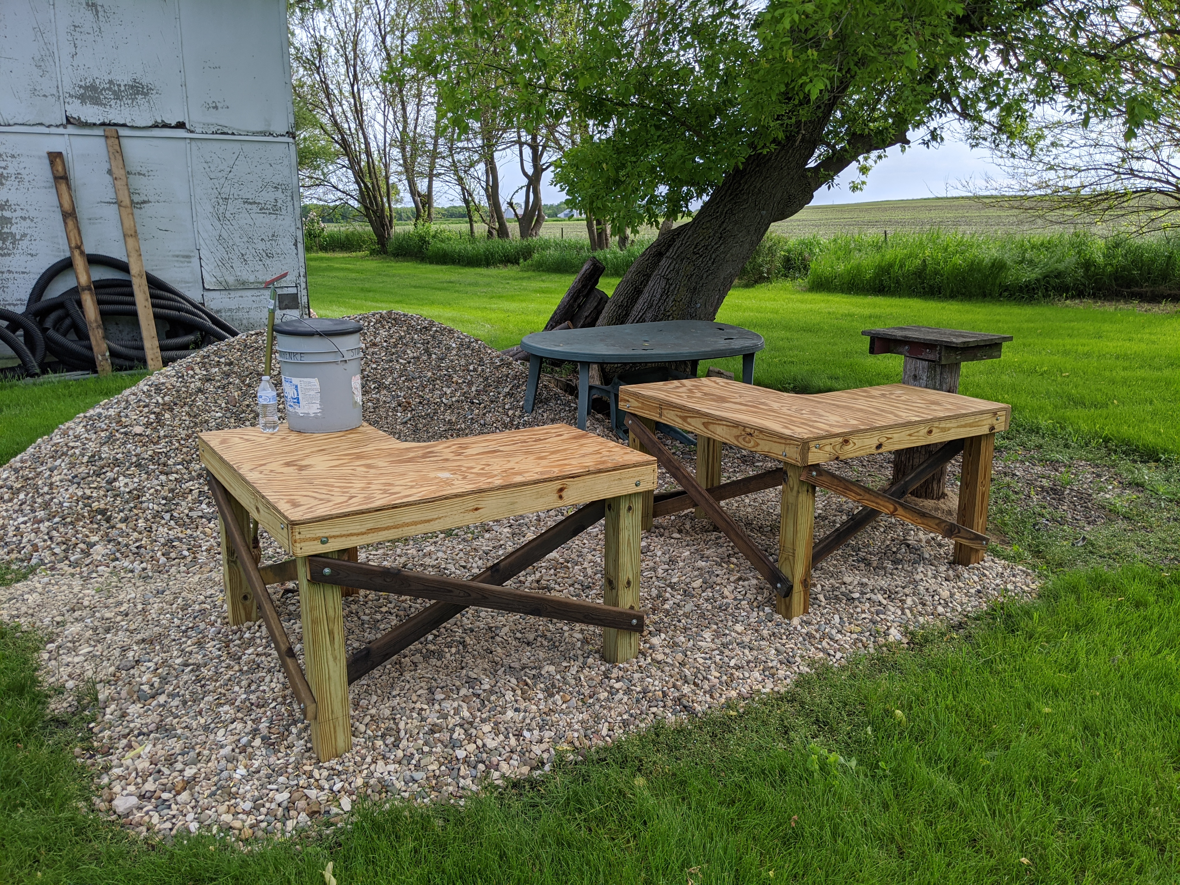

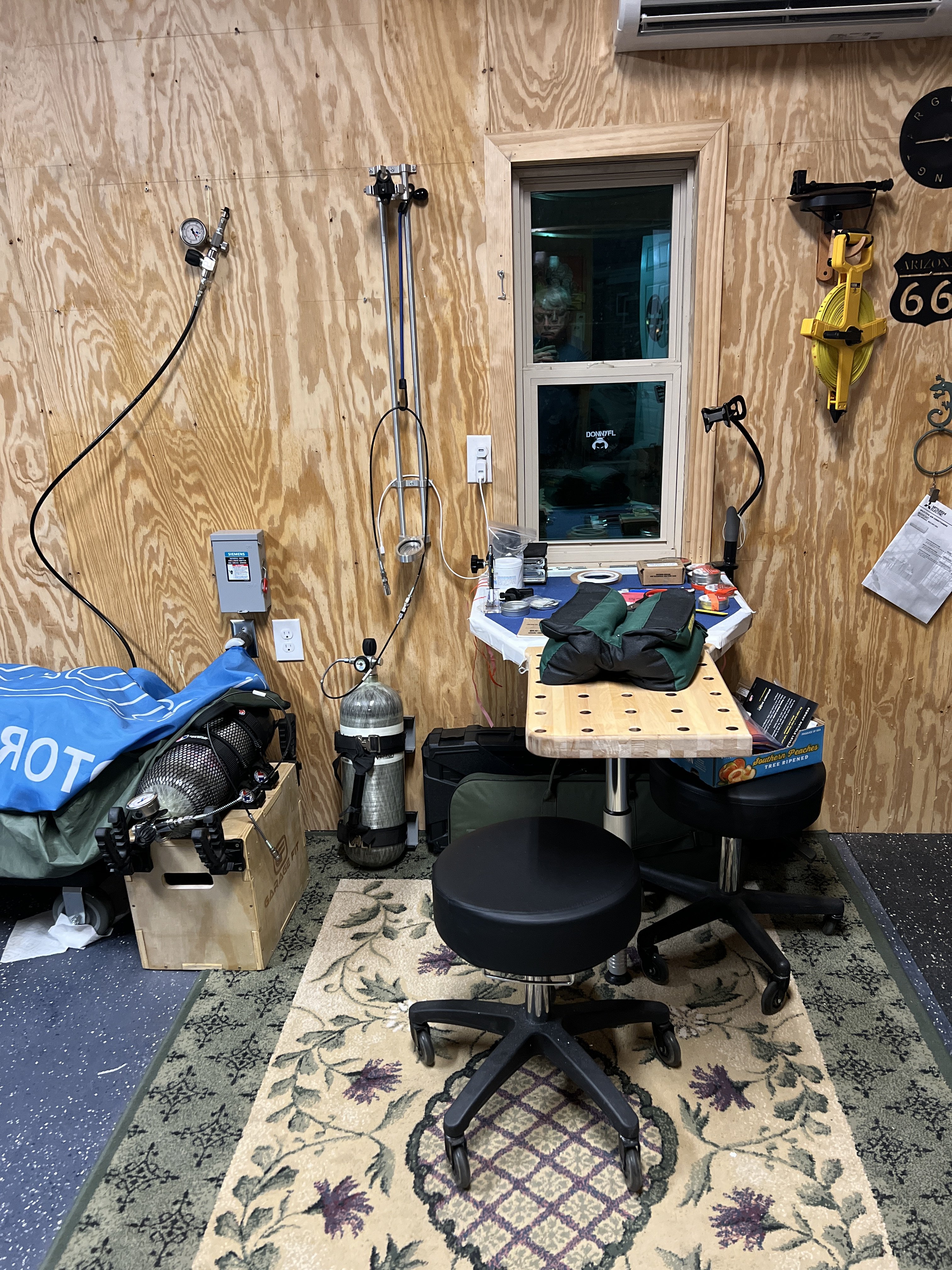

Here are the 2 bench's that I built, had the room so the tops are 48x48x3/4 ply. The bench top is big enough to set all your support gear on it and still have lots of room for your rifle or pistol box. The legs are treated 4x4 bolted to the treated 2x4 frame. The top was then screwed down. The bench doesn't wobble or twist. I did not make the seat part of the bench as I have found that as you move around on it will cause the table to move. The picture was taken before they were painted.
