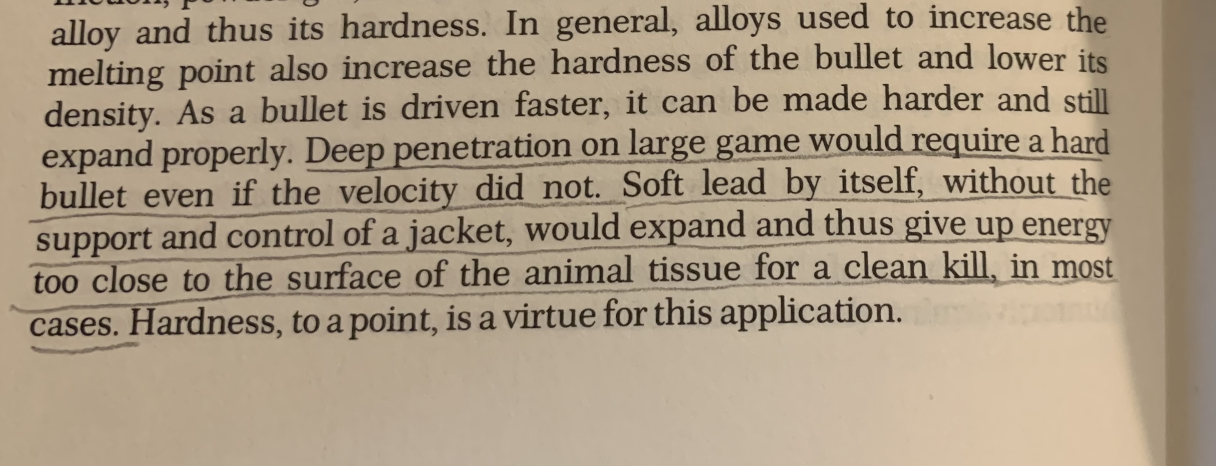

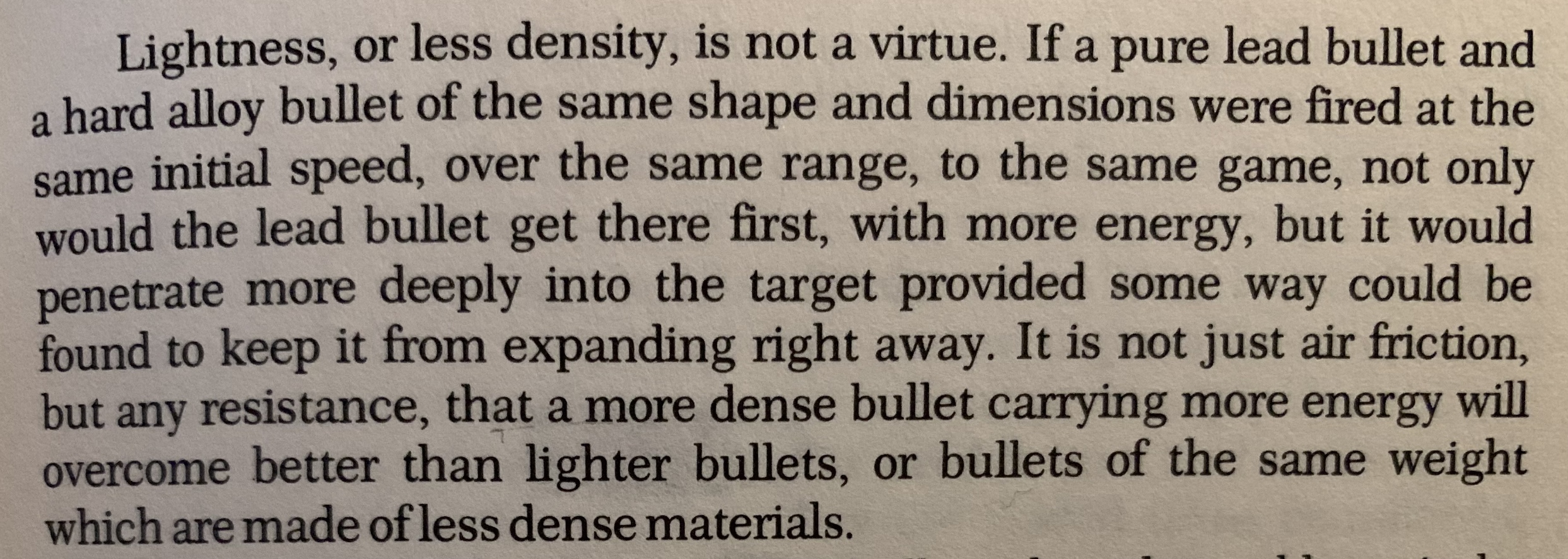

One detail I remember from Bob Sterne's posts: Just like there is a BC or drag number for a projectile going through air — so is there a type of
"flesh BC" — the drag or slipperiness of a projectile going through flesh.
So, if you are afraid you might not get enough penetration — make sure you have a high BC projectile.
But even if you have a semi-wadcutter shape with a pretty bad BC — if it's one of those monster slugs weighing "half a ton" and if your're slinging it at 900fps — then that might not make a difference:
The semi-WC is just going to push through flesh due to it's extremely high energy (momentum).
