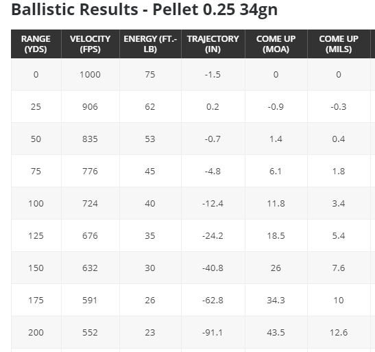

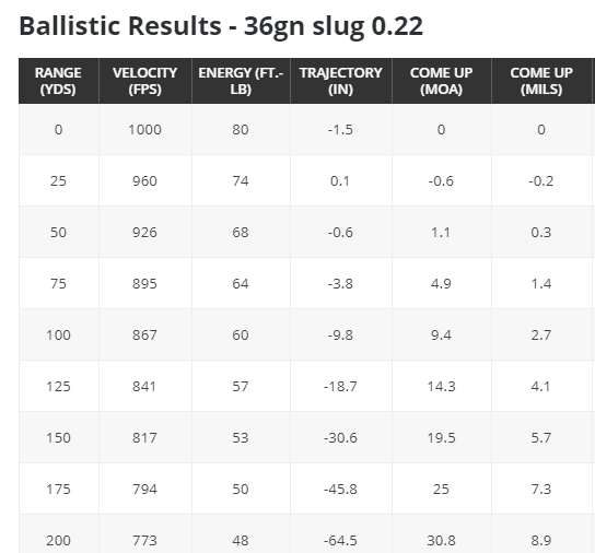

To those thinking slugs are the answer to drop please play around with a trajectory program like Chairgun for realistic projectiles and velocities for your guns. I have and I do not see much drop difference. What is different is wind drift. Close to twice as much. But drop maybe 10-20% less with slugs. I suggest it isn't a huge difference in drop.

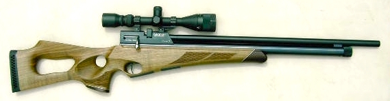

I'd been thinking of trying a .177 bullpup in hunter field target but thanks to Wayne I need to rethink that. I was wondering how close the targets get. A conventional rifle where the scope can be lower may work significantly better. I agree completely that the bullpup with it's high scope pushes out the point where you have to hold over but also makes you shoot really low up close. That would make range estimation critical at close range where a conventional rifle would not be nearly so far off - and thus a range error less of an issue.
