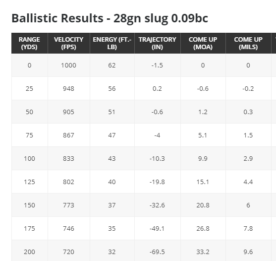

Found the BC of a 28gn 0.22 slug (more common use)
https://www.krale.shop/en/airgun-slugs-nielsen-5-5-mm-28-grain.html
Looks to me like even with the high velocity, high power slugs, that anything in excess of about 125 yards is more like launching a mortar than a shooting a bullet... ;)

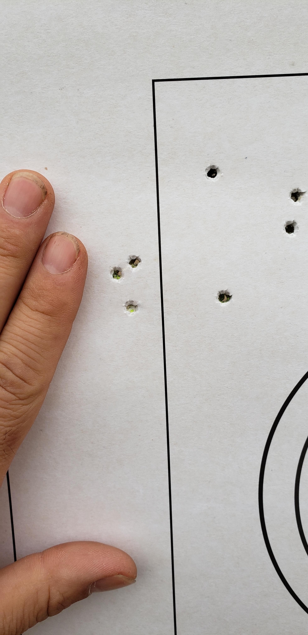

Well, this was a bench shooting (mine) on mid gusty winds (5-10mph) @150m / 165y with a.pellet liner (not even slug liner) shooting ... I´ll take it! (pellet won´t even hit the targets on that changing wind..)
30gn slugs
22.5gn slugs
This weekend I will test shooting with the slugliner over the mk2, will see, probably will get a LOT better
Nothing special IMO (the shooting pics) but considering that is not even a liner made for slugs...is a good start

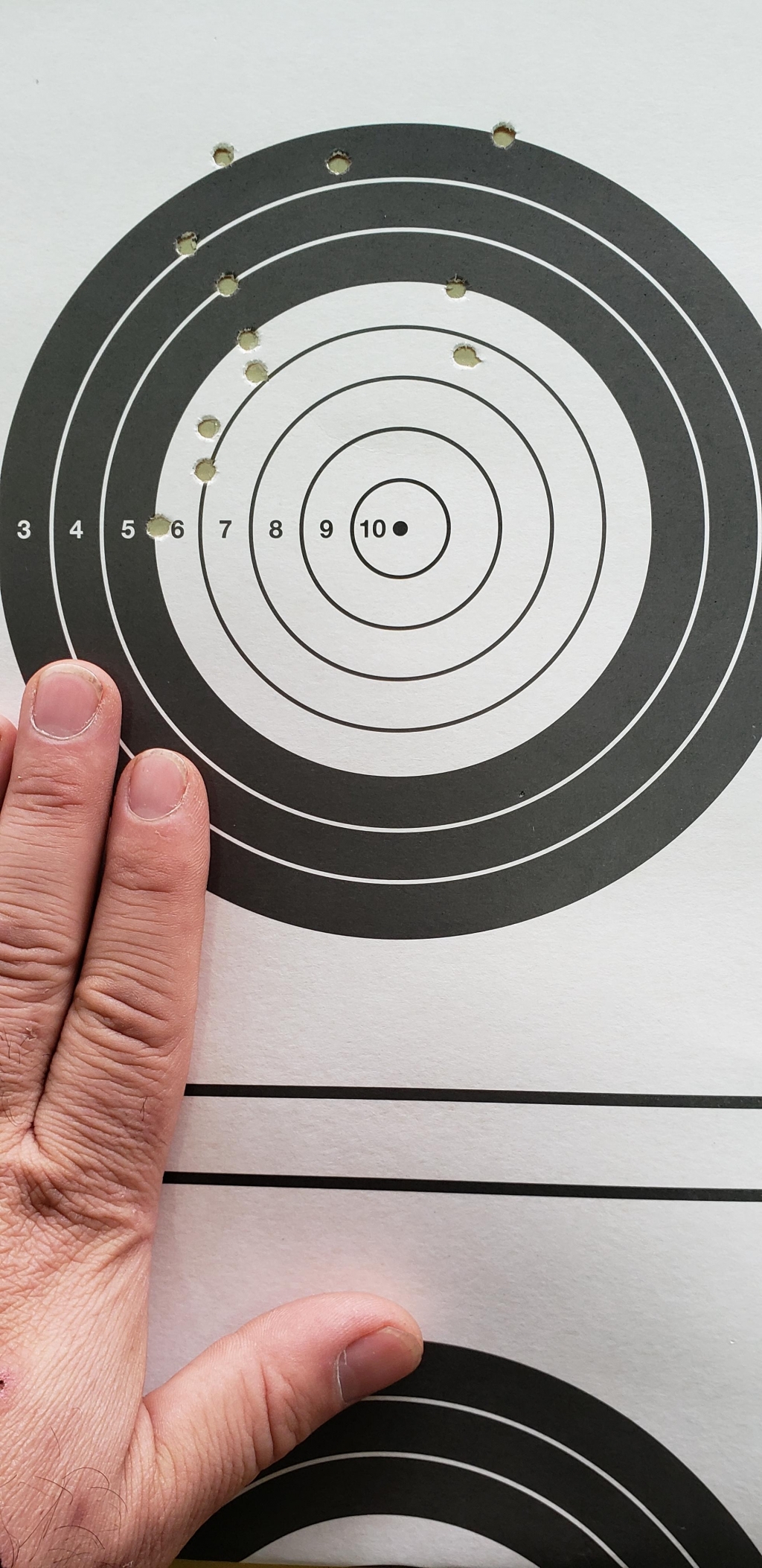

30gn slugs
22.5gn slugs
Those look about like my 150y Leshiy groups with 18gr JSBs in similar wind. How flat were they shooting?
And don't forget that when you get out past 125 yards, you have to consider spindrift. Just like a curveball, spin (imparted by barrel twist) starts to have an effect on the pellet too.
