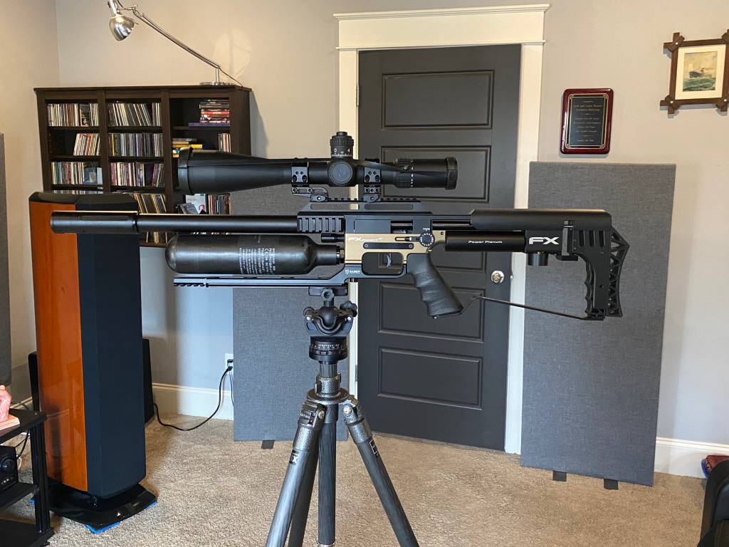

Oh...this is what it looks like mounted up (from the good side:))
