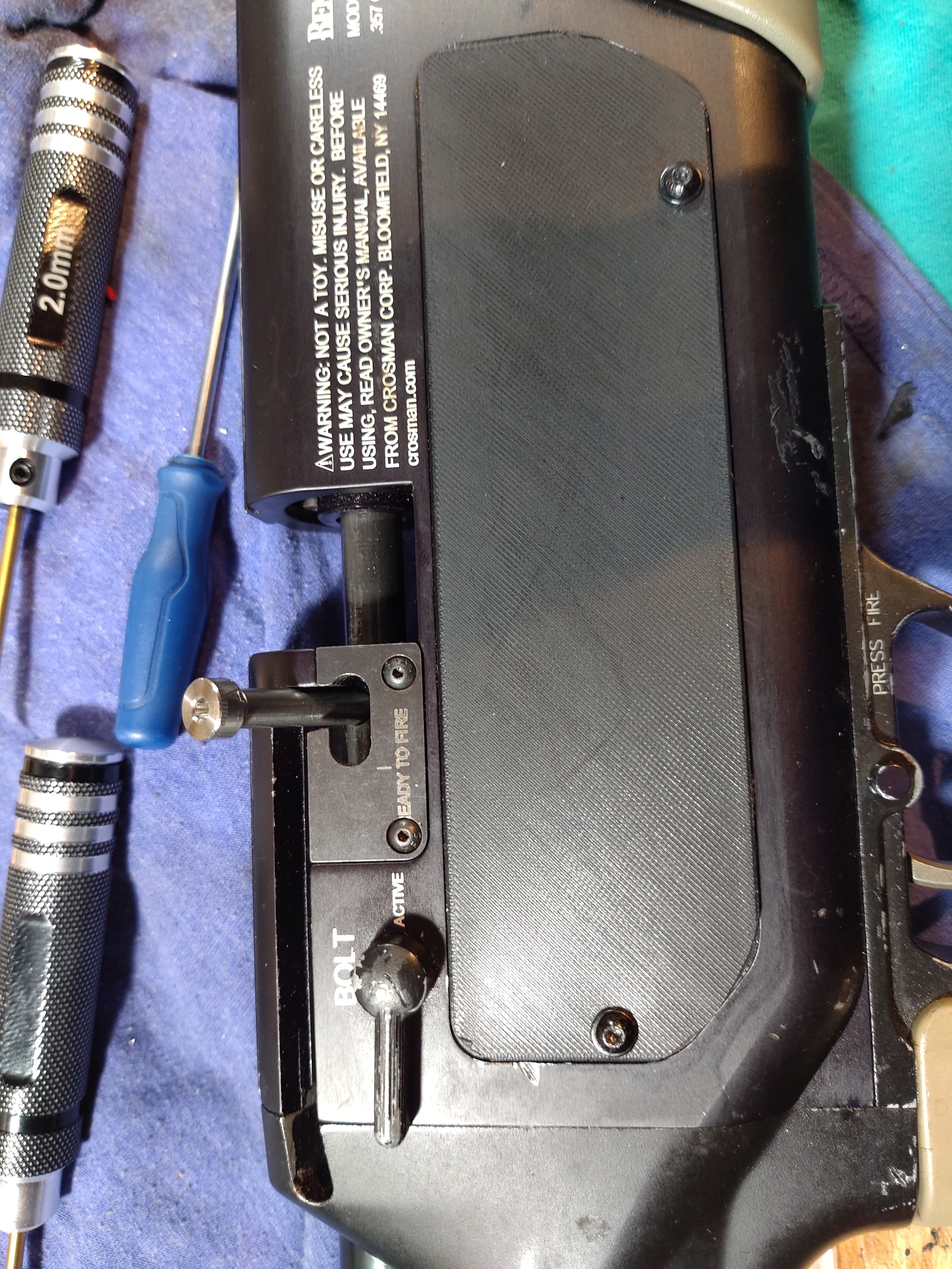

Got a beat up Benjamin Rogue a few months ago. I knew it needed a battery cover so when I got it I spent a few days designing a 3D printed one.
Previous owner drilled out some new holes and I was able to tap them to add screws.

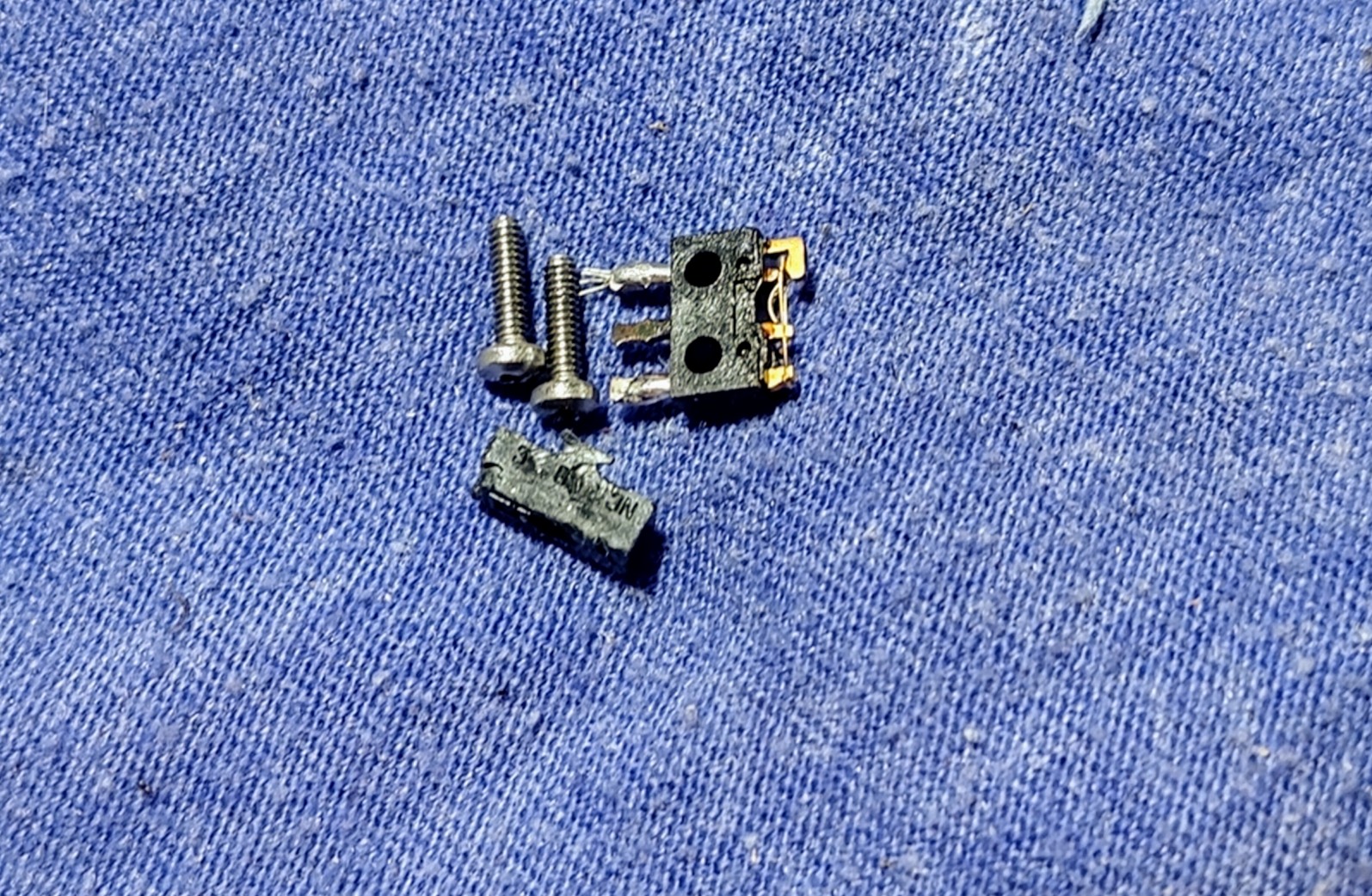

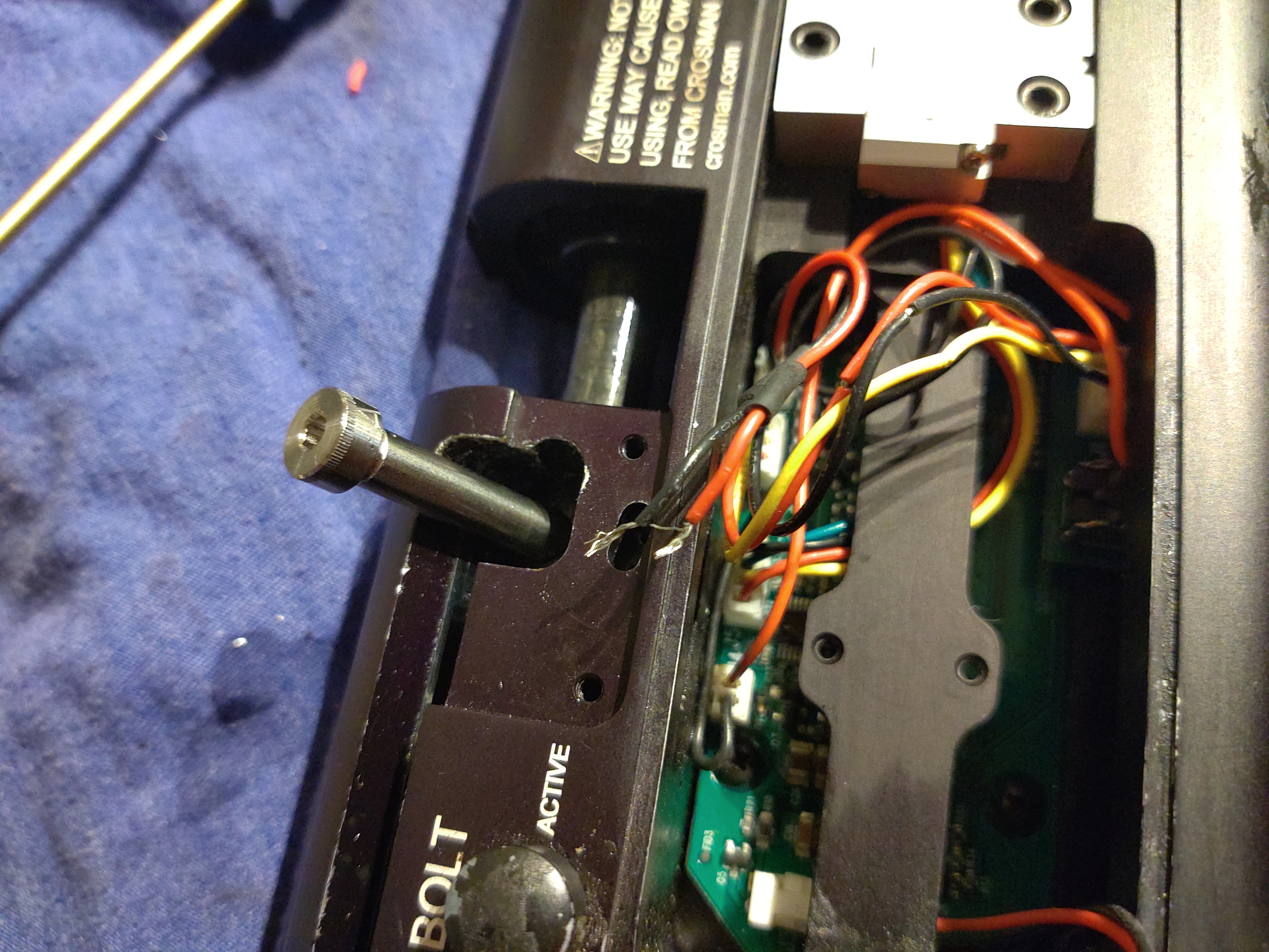

took it out that weekend and Loaded first slug and snap. broke the damn probe handle off and it also broke the trigger micro switch.

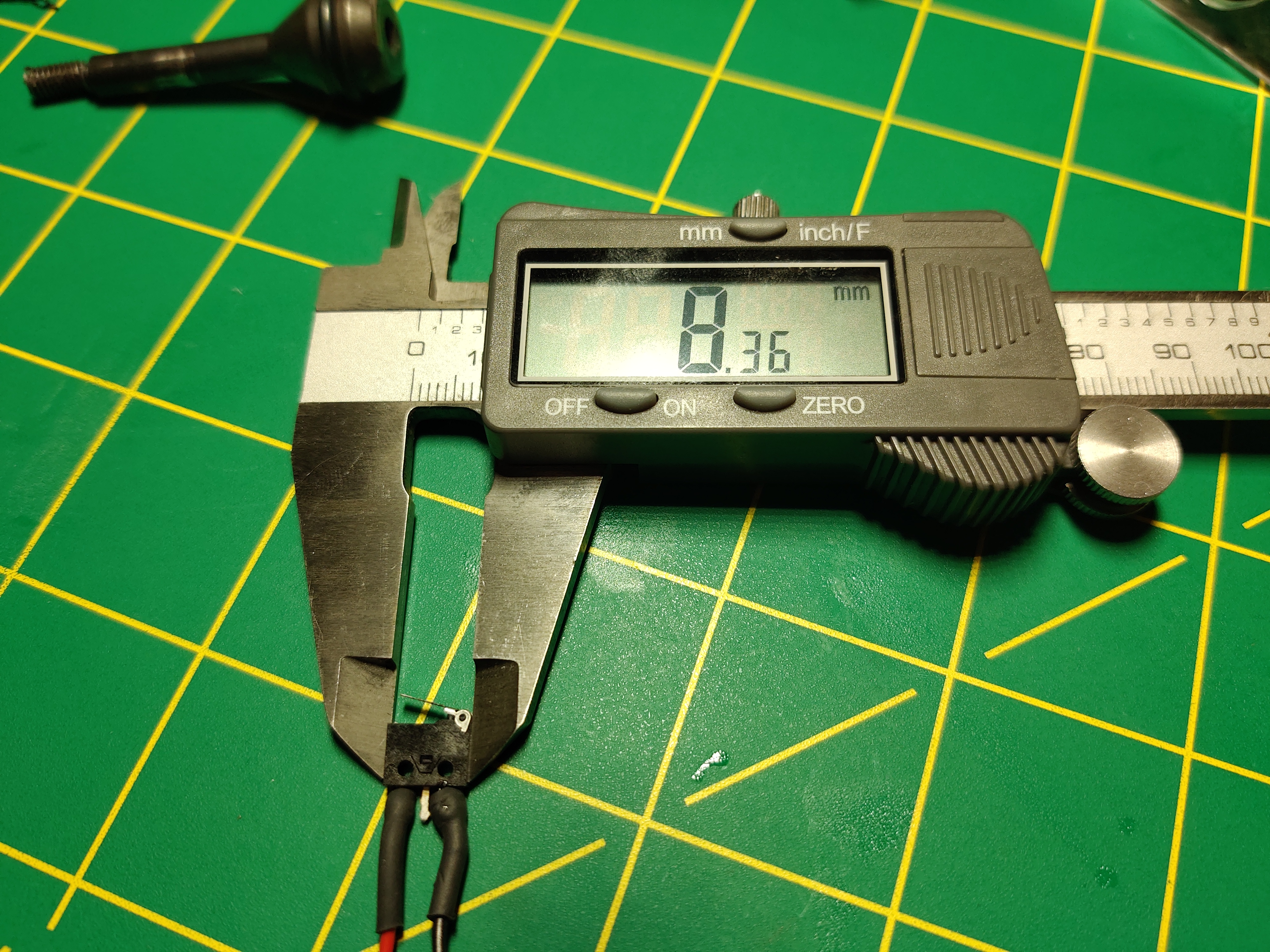

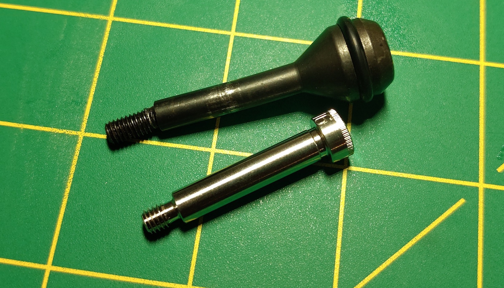

Spent a few days looking up and trying to find the correct micro switch which was a lot of googling but finally tracked something I hoped would work on ebay. while waiting on those to arrive I tried to find a replacement Probe handle with no luck. I then ordered a thread checker kit and got on Mcmaster carr and found a shouldered bolt with correct Diameter, length and thread and ordered that. So after a few weeks and about 40 bucks I got it functional again. Still have not shot it as by the time I got it fixed winter hit.
