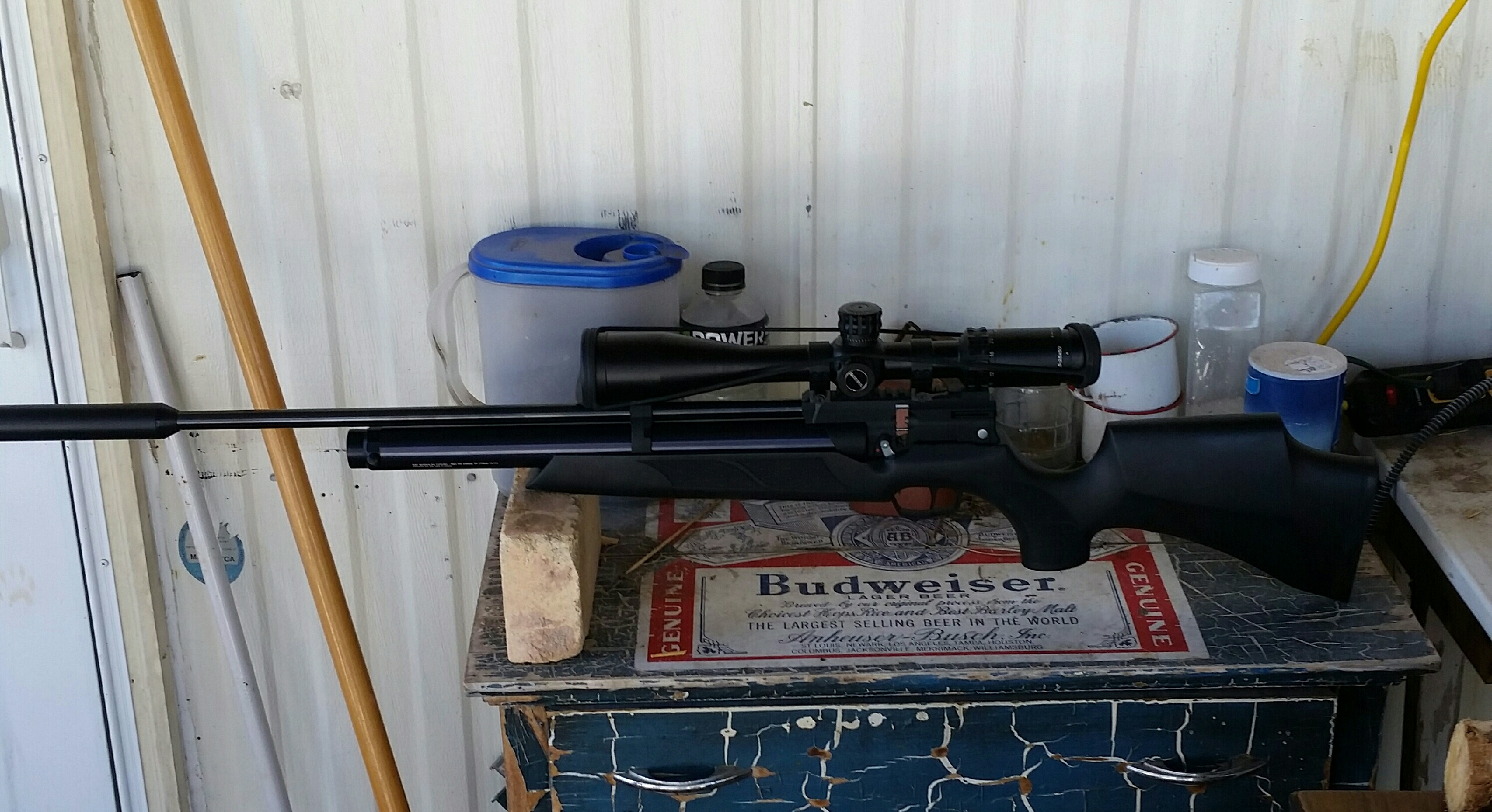

Airgun Spares rings at top, the original rings below
putting a Rat Works air tube with more capacity and lighter weight while I have it apart
