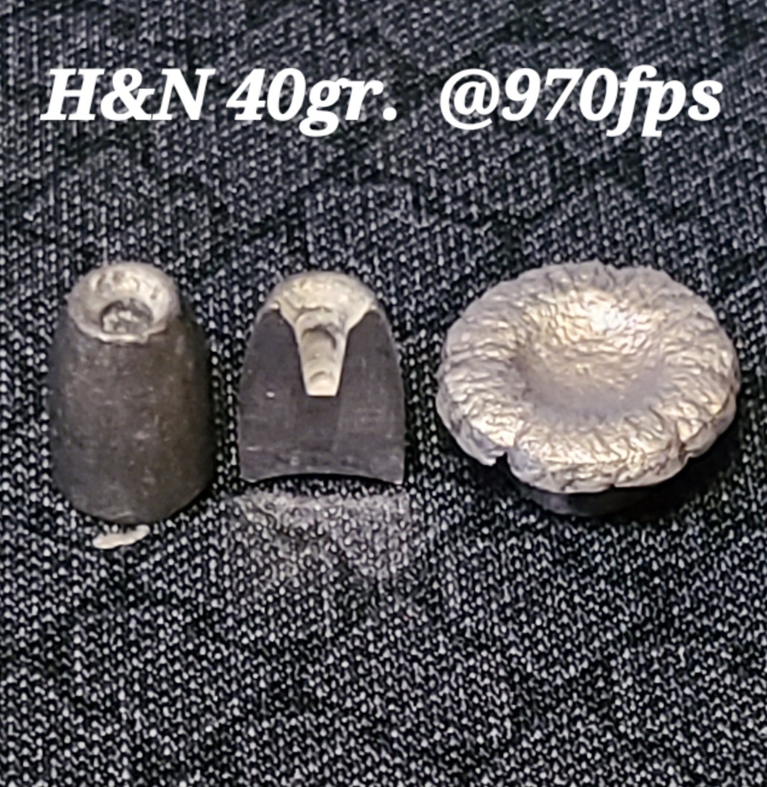

I've been shooting the .25 caliber H&N Heavy slugs for 2 years and I think they are Awesome !
