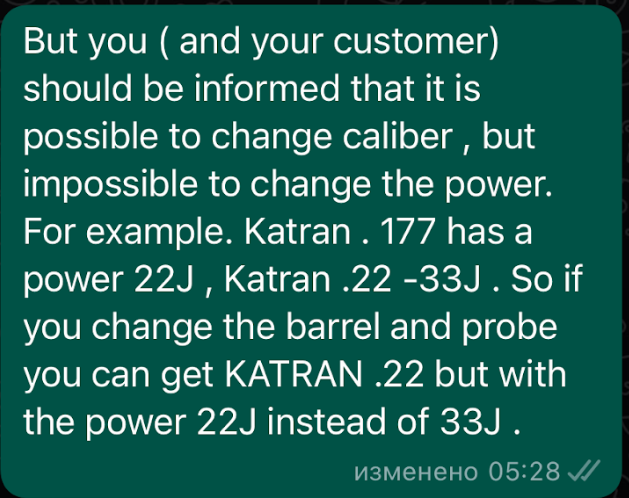

Update: I emailed Mike at UA about this question and like everyone has said, he goes up and beyond. Thank you Mike! He messaged Airmaks and they responded that they DO sell barrel swaps. However, Katran’s are build specific. Meaning, if you purchase a .177 you can swap the barrel to a .22 or .25. BUT, the power output of the regulator stays tuned for the .177 you purchased.

Based on what you shared, I decided to go ahead with the swap from .177 to .25. I reached out to UA to broker it, and AirMaks had a similar reply as last time. With the added disappointing news: a cost of +$500 before shipping.
"Hi Mike . The customers needs buy not only barrel , probe and regulator too . Because regulator has tuned in low power in .177, for .22 and especially for .25 he needs more power. So set barrel +probe + regulator is $519.99 . If you have any questions don’t hesitate to ask me again. Best regards, ..."
The probe too?? Perhaps I am not understanding something?
