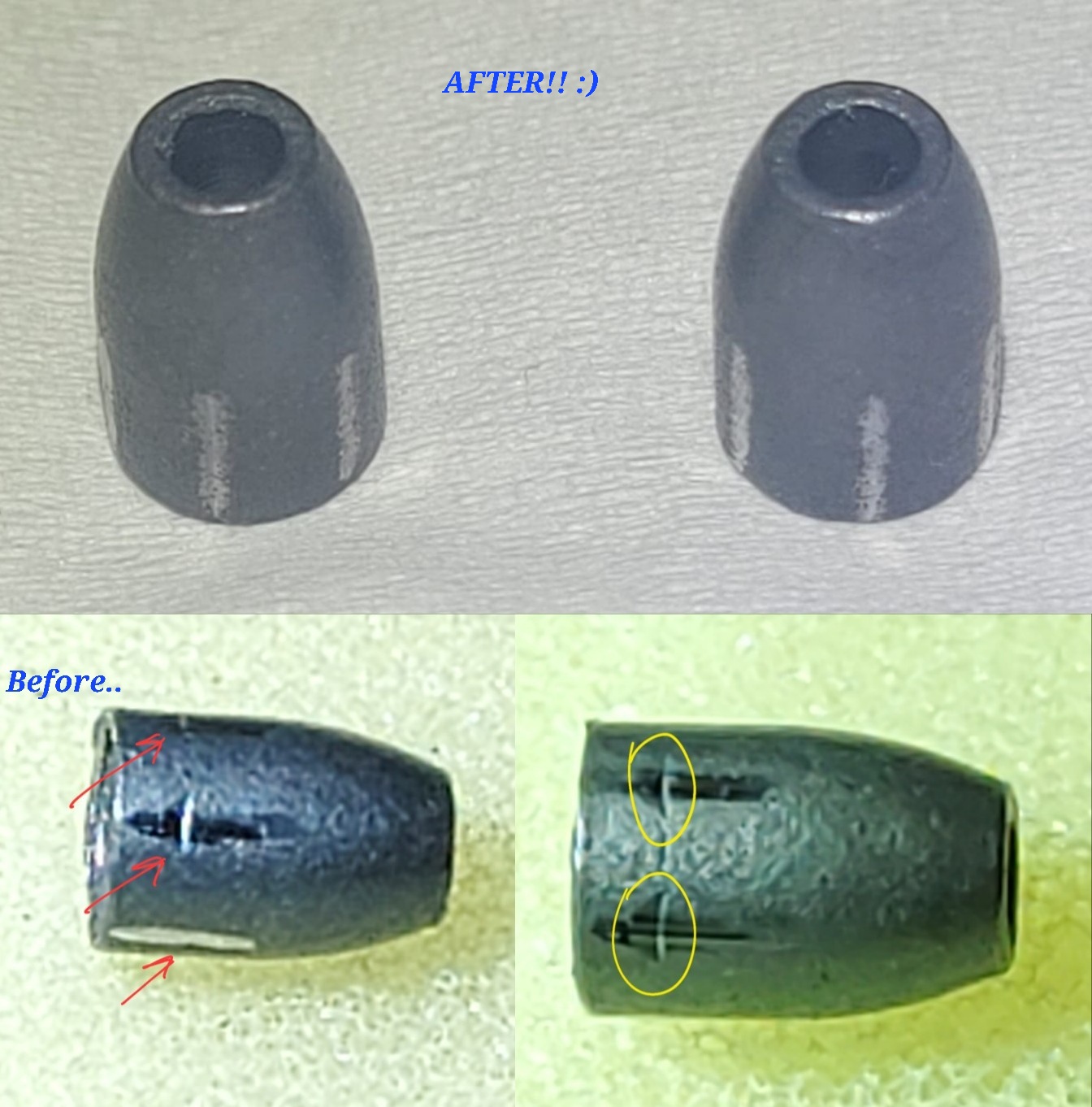

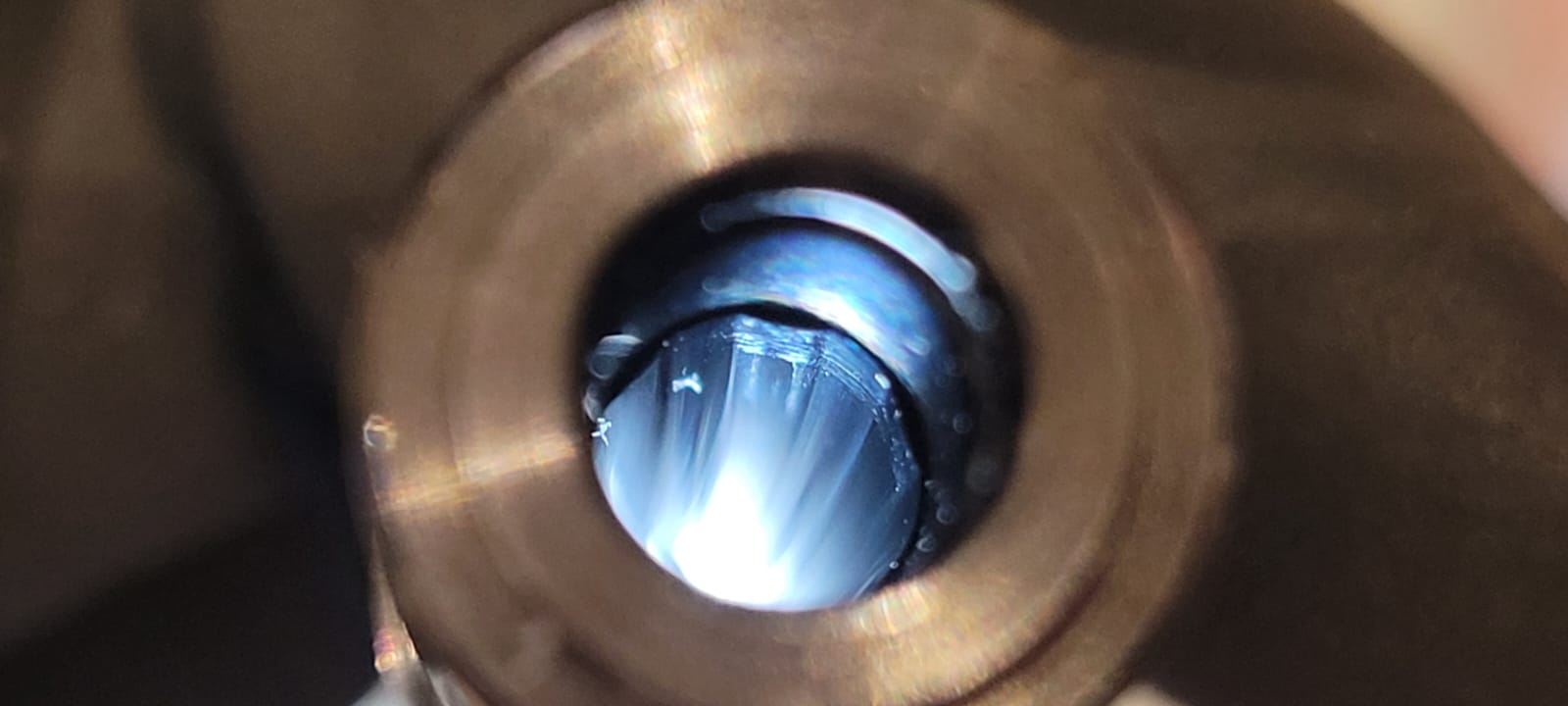

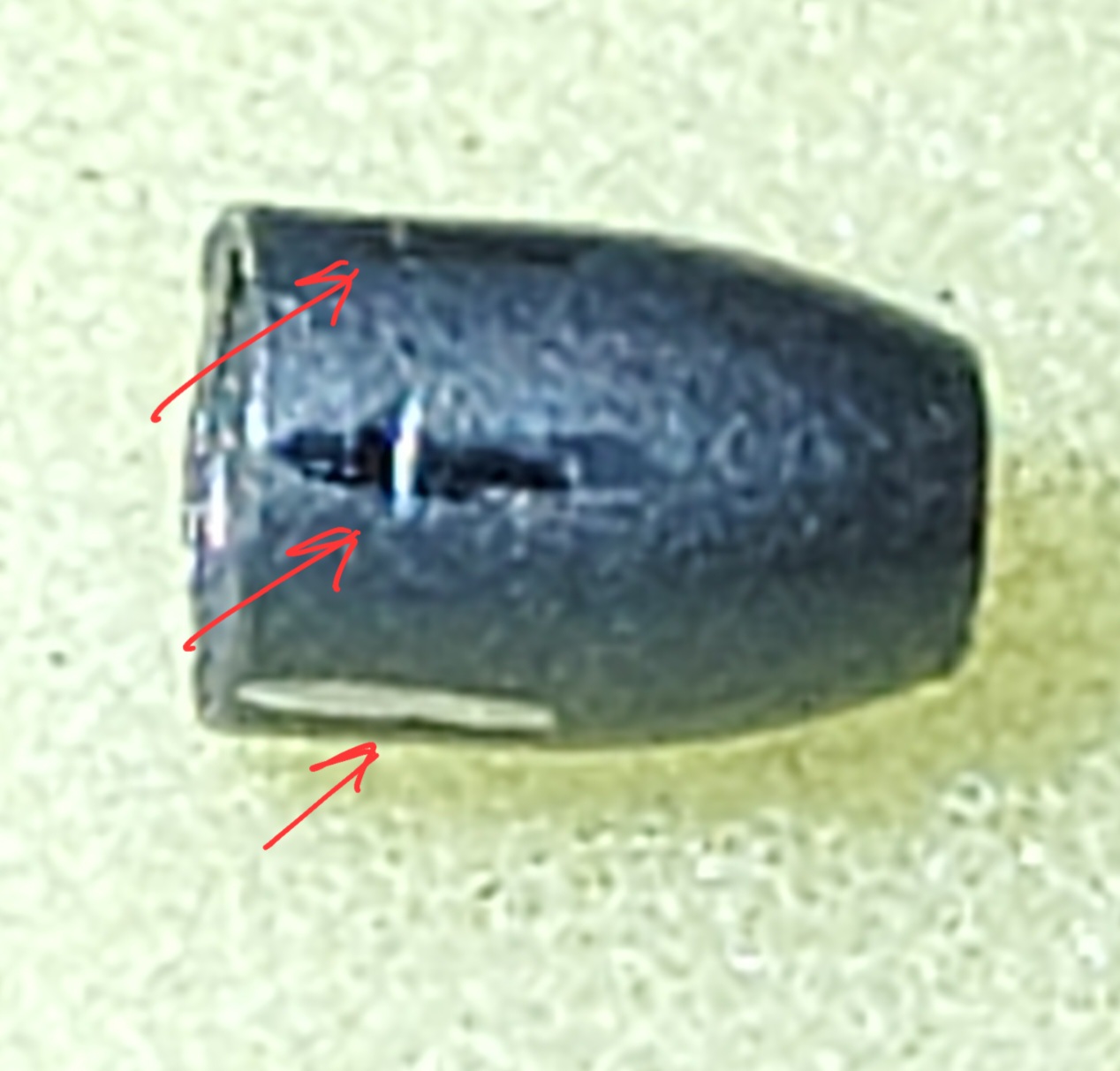

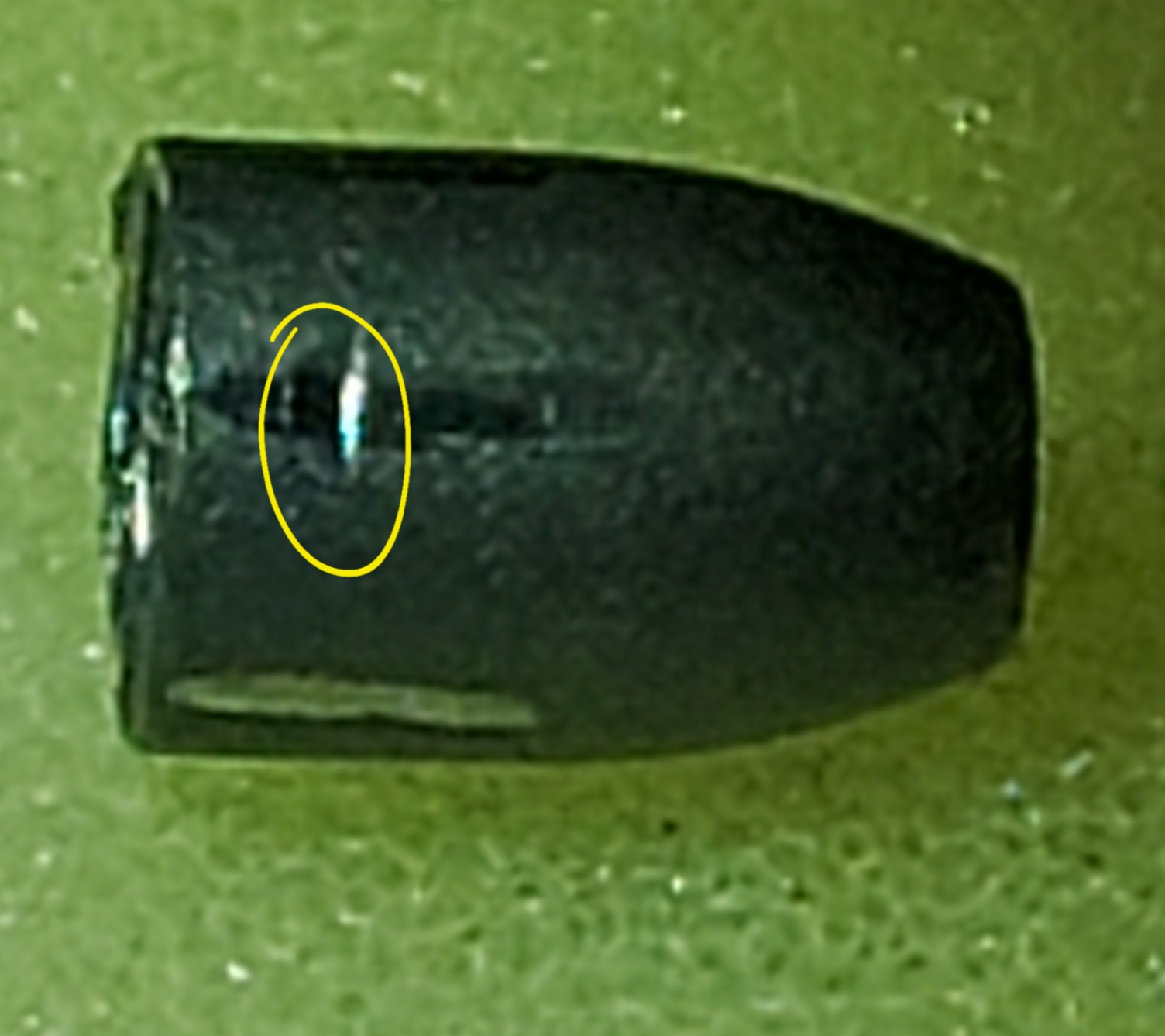

I need help on figuring out how to smooth "chamfer" the breach in the Krait HP barrel!? i noticed that ledge and how it cliped the slugs on their way to seat in.
i think it might fix its accuracy issues! or at least would roll out one issue!
also, i noticed 2 spots in the barrel that bite on the slugs what ever their cal. may be " i tried .216, .217 and .218" in the first inch after the transfer port and the last inch and half before the exit. polishing may fix that?! idk!? FYI all HP barrels have no choke.

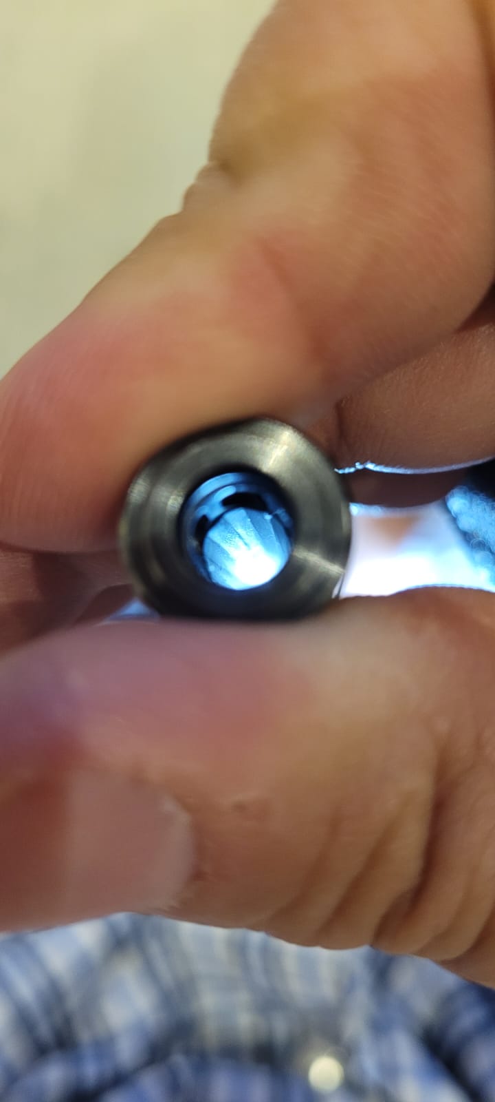

i have 2 barrels from AirMaks, both are HP one for L modle "540mm" and the other for the X model "700mm" and both have the same cut out on the breach and the rifling.

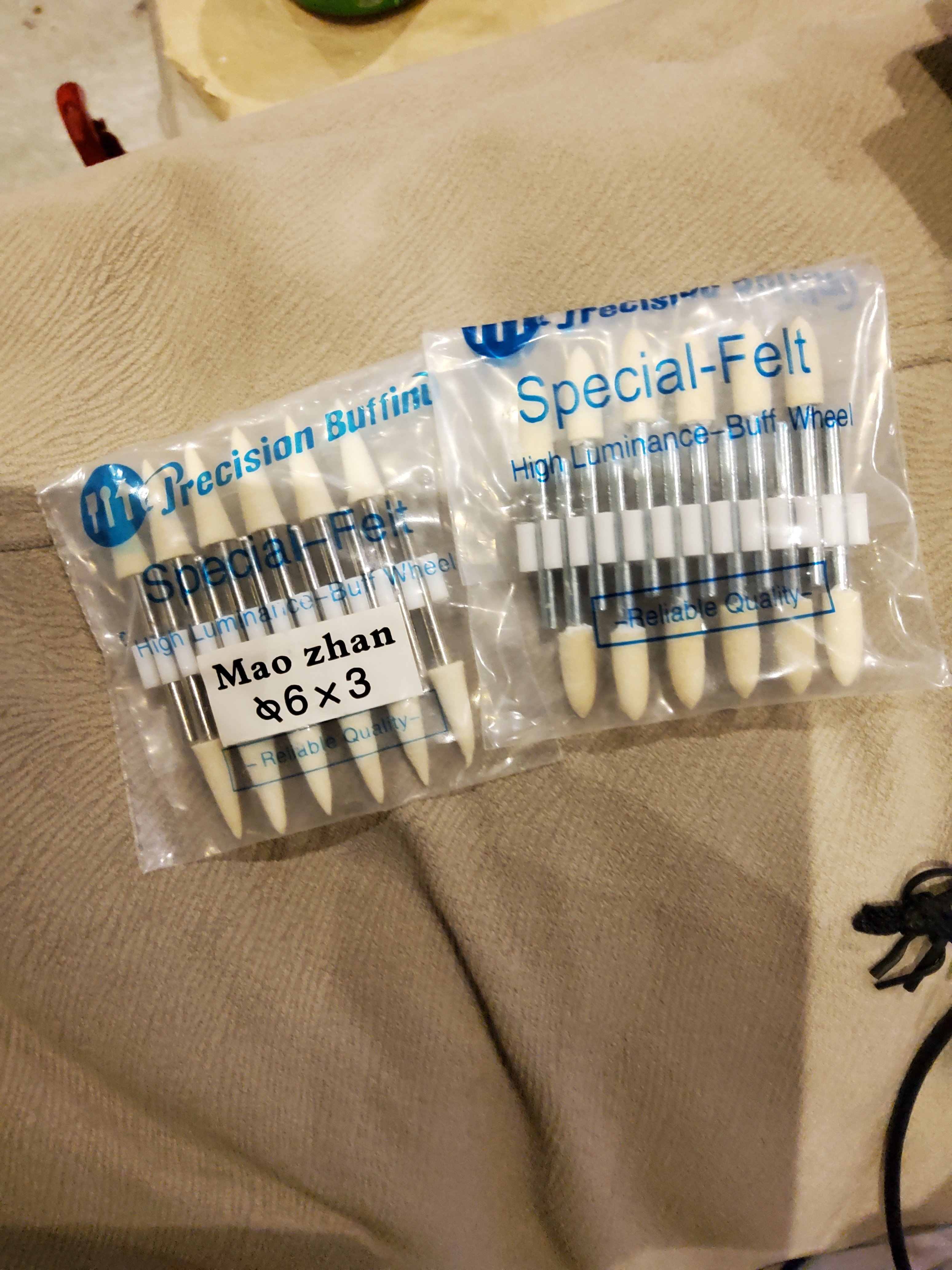

i bought few dremel tips to get in there. but i'm still going back and forth thinking about it! i don't want to screw it up! 😅

So, I went to town with those Dremel tips and i think the picture will speak for it self! 😅
** unfortunatlly i didn't take any pictures of the barrel! 🤦‍♂️ was so excited to intall it on the gun! any how i have a bore cam on its way by mail, so i will take better pictures of the bore in near future.

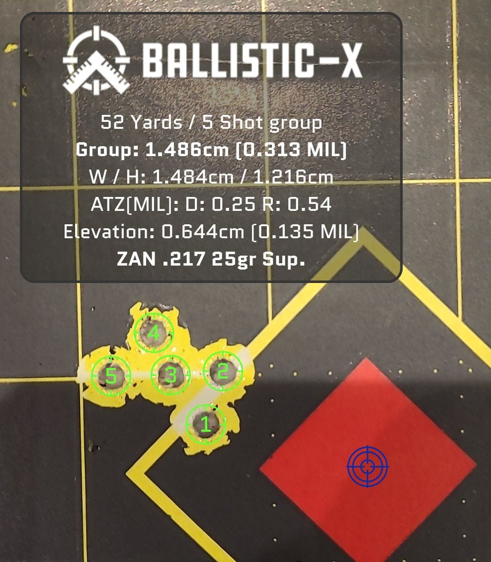

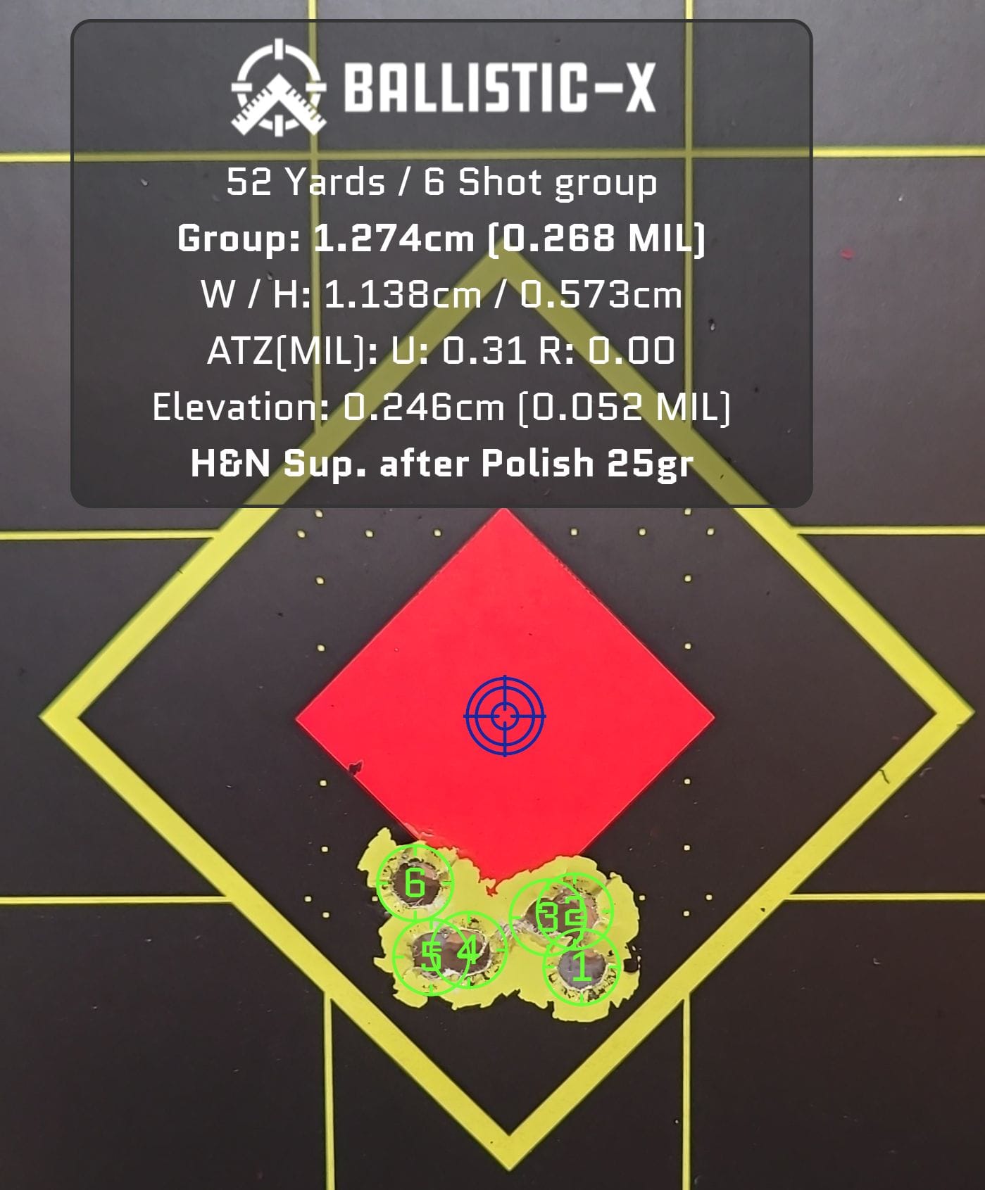

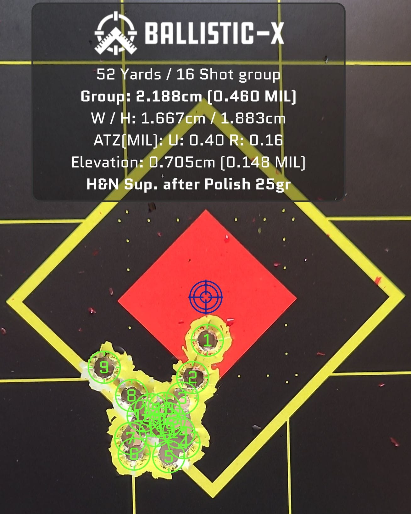

Seems ELBOW GREASE has paid off! 😅 these are some 5 shot groups at 52.6 Yrds. after polishing the barrel. Also as of now the only caliber that works for me is 0.217 .. i tried ZAN and H&N "washed and lightly oiled".
@50Yrds give or take, reduced the group size from 2inchs to less than an inch "almost half an inch!!".
Also, you may noticed the group are spread side ways! thats because when ever any of the other shooting lanes send or retract their targets, my target sway side ways like a belly dancer! 💃
Your thoughts and comments are welcome guys 😅
Well for about 50 yards i am not super duper impressed, when my Maverick .177 was best though horrible slow shooting ) 280 FPS ) i was almost putting pellet on pellet at 50 Meters.
These days shooting almost 2 X faster i have not yet gotten the maverick to do that again, but i am also generally shooting 75 meters, but there i can hold my shots on a 2" target.
Going shooting again today ( just about 3 AM here ) so after sleeping 2-3-4 hours around noon i will be slinging lead again,,,,, i do go to bed after this post though, but i am used to spend at least 5 hours in bed not sleeping before my grey goo grant me access to Zzzzz land.
I hope, some times i lie 10 hours in bed before i fall asleep, some times after 6-7 hours of trying i just give up and get out of bed, its a mess here :)
Mind you your groups have a nice consistency to them, so i am sure they can get even better as is.
For sure i would try this for a while, maybe experiment a little with speed.
Reactions: Fire012
Like Pea said, your groups don’t have fliers. At least not at 50 yards. You’re over the first hurdle. You can either try to tighten things up now or just test them at your maximum range. If they don’t open up much it will be up to you if you call it a day.
Ooh i had some fliers. I tried H&N 34gr. 0.218 and JSB K.O. 25gr 0.217 & 0.216. The 0.216 were the worst by far! so i won't waste my money on 0.216's what ever the brand may be.
H&N Heavies "34gr." gave me some wiered groups! super tight on the first three shots then 2 fliers 3" apart from where my POA! i was lucky to hit the paper tbh! 😅
On the chopping block, Javlins and NSA's next. after finding the ones that she likes, then i will streach the distance.
Any way thanks for your inputs 🍻 and welcome for any more!

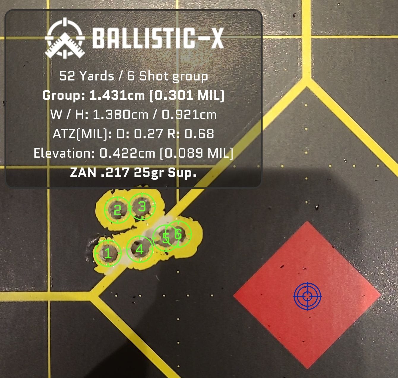

just to compare..
