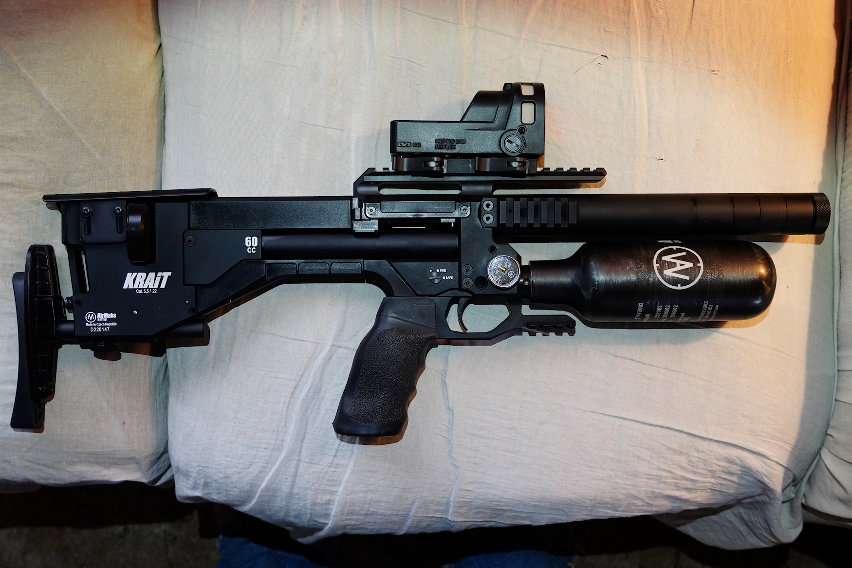

Krait .25 owner here ('L' model, 700mm barrel, with air tube). I haven't shot the gun much (too many airguns), but so far I have been impressed (as received and as tuned by UA. Although it was likely tuned for slugs and I shoot pellets).
With this gun it seems like 50 yards is just the starting point, and it really wants to stretch its legs further. I've played just a little with the hammer spring tension, and got the speed of FX 25.4 pellets down from the out-of-the-box 1,054 fps (with good accuracy) to 1,020 fps with great accuracy. Seems to like shooting those a little better than the heavy 33.95's. But then I haven't really taken any time tuning the heavies (at current tune they are running 922 fps).
So the Krait definitely doesn't lack for power in .25 cal (at least with the 700mm barrel), and is really rather nice to shoot.
