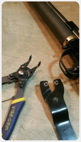

Do you have either these tools? If replacing the o-ring doesn't do it then this the worst case scenario you will need one of these. Degass the gun empty then tighten that valve face the silver round piece the hammer strikes the pin there are 4 holes you see them tighten clockwise but gun must be degassed all of the air gone first.
