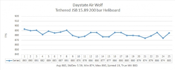

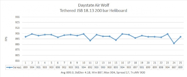

I put a Heliboard in my Air Wolf to get the pellets to the right speed to tighten up. I'm shooting at 50 yards tethered at 200 bar. The top 5 in a row were the 16s and the bottom 5 in a row were the 18s. The X out area was sighters for power change and scope adjustments. What surprised me is that the scope needed just a click or two from one pellet to another.
Here is what I used for power and speed. JSB 16 FPS Average 883 and JSB 18 average 900 FPS. The 16's shot a tighter group. For the 16's I used power 9 and the 18's I used power 11.
The 18's tended to have a flyer or two.
Overall the Heliboard is a great addition to the Air Wolf. You really can fine tune it better than any other rifle out there.
"AR"Did you find 883 to be the most accurate speed?
I went out yesterday and shot again (883). At 50 yards it is just accurate. I can't ask the gun to do more. The 18's were also good again at 900. But again It would produce a flyer here or there. When I say flyer I mean it throws a pellet about a half inch out of the group. I may play with the power on the 18s a bit more. I guess that is the beauty of the Heliboard. One of those purchases I don't regret.
