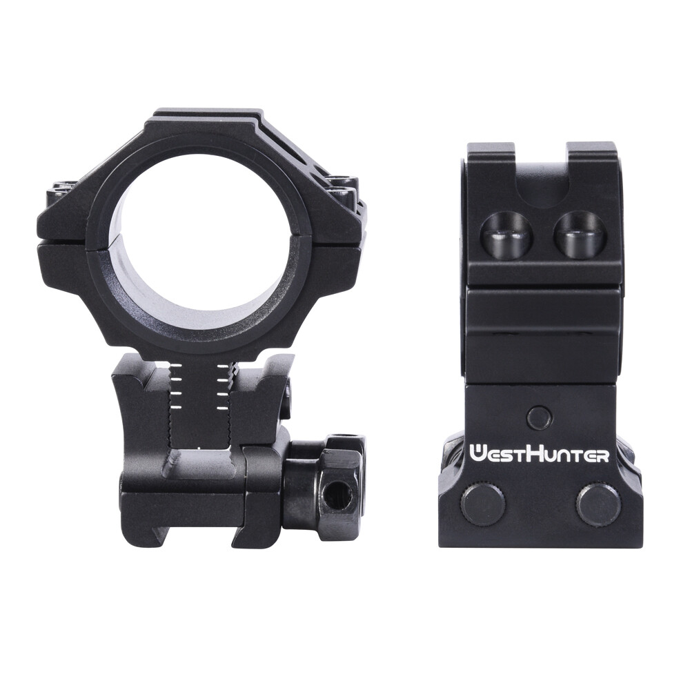

Hi.
I got westhunter adjustable mounts (photo attached)
There is 4 white lines .
How many lines should I go up to get 20moa?
Hi.

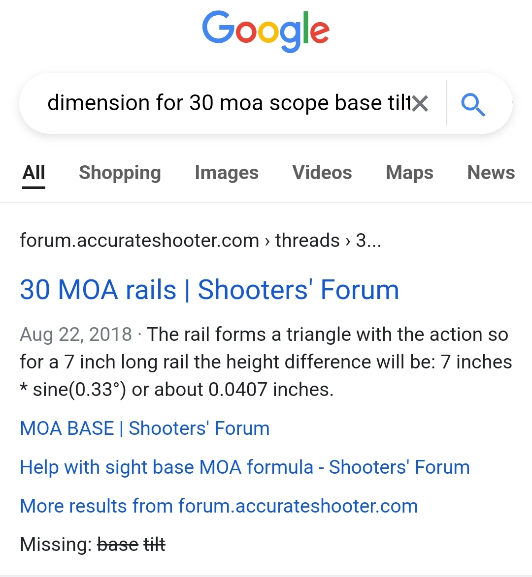

I hope you understand what I mean about moving the rings to where it shoots to save you room to zero(or for the chip) to adjust to where you want to be. Pic related, if it's too much and you want to just try calipers first.
These rings do not allow you to adjust for moa, they are simply height adjustable rings.
These are the scope rings I suggest you get that will allow you to get whatever MOA you need.
I also recommend these which already have 20MOA built in.
I have eagle vision rings that have a single clamping bolt and pulled off a tilt with it rather effectively. The design and tolerances allowed me to add 10 more moa to my impact prior to getting a 30 moa rail and would likely allow for more. Op seems like he should be able to use those rings for his end goal I think. If its plug and play and no experimentation he's after, I 100% agree with your suggestion too.
