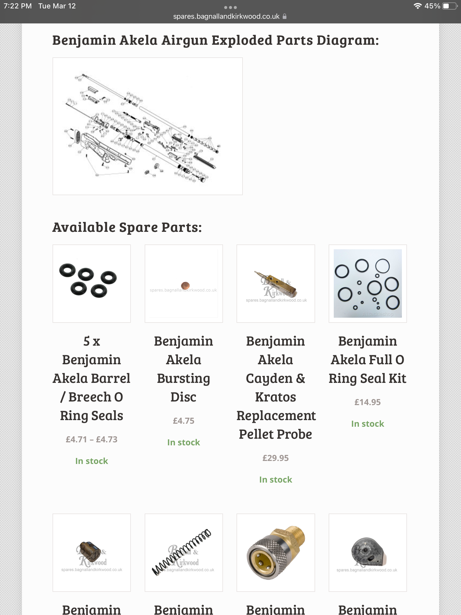

Would anybody have a list of all of the o-rings to the 177 caliber Akela ? Seems that Crosman does not list them and I didn't even see a PDF site like they had before for any of their guns. I also did a search on AGN and GTA. Would like to buy them in bulk and not in a kit before or when I have a problem with the gun. I know my last resort is to take it apart and measure them. Someone, anybody ? Thanks in advance Darell
This UK store has the best organized selection of parts and seals that I’ve seen for the Craftsman Series (Akela, Cayden, Kratos). Valves, complete seal kits, hammer springs, etc.

I know you said that you would rather buy O rings in bulk, I can only offer that a seal kit will give you all the O rings you need for your rifle plus some offer the plunger pellet probe as well. If you do decide to get a seal kit, give airgun revisions a look.
Todd I tried his site but couldn't get thru it kept saying my email was not correct on my order so I gave up. I did talk to Crosman with a different outcome though see below the next post.
I completely forgot about that UK store thanks
Well after days of research I called Crosman, they sent me a diagram and parts list for the 22 cal. after another call for the 177 cal. come to find out it is out of production, because of not much interest. No diagrams nor parts list. The 22 cal. is still in production for awhile but not sure of the future of that gun either. The good part of the story is they are swapping my 177. for a 22 cal. due to warranty. So I do have a list of those o-rings and the (sizes) which are listed on there site.
