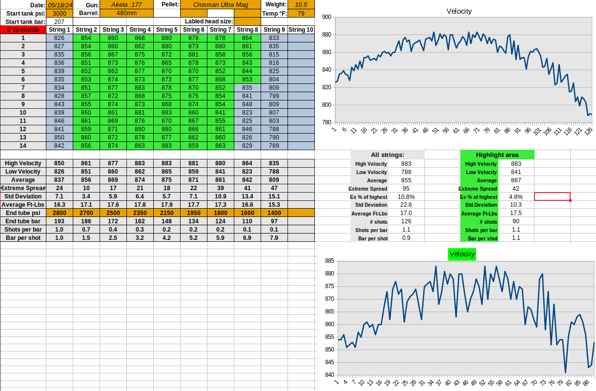

Last weekend I wanted to test the shot count with the modified spring, so I ran CPUM 10.5gr over the chronograph (no accuracy testing). I ran nine, 14-round mags from 3000psi down to 1400. Before shortening the spring, 5 test shots of CPUM averaged 1035fps, 25 ft-pounds. This time I got 855fps average over the 126 shots, at 17ft-pounds. Trimming down to about a 40 fps spread (actually 42fps) I got 90 shots, 867fps average at 17.5ft-pounds. I think I'll try Airgun Revisions spring kit sometime, just to compare.
The entire run (blue & green cells) are reflected in the upper velocity chart, while the 42fps sub-group (green cells) are in the lower velocity chart. I *think* my formulas are all good.

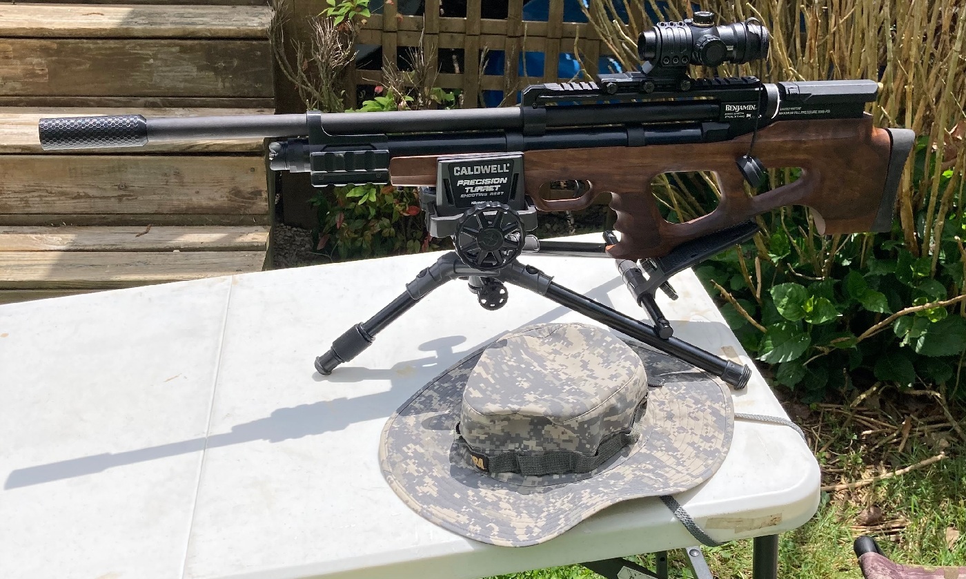

I'm really pleased how nice this gun is - makes me appreciate .177 a little more. And, the gun was only $330 during a sale in 2022. The stock is gorgeous, especially after 4 rubbed-in coats of Howard Feed-N-Wax. You'll note in the photo below I had just put the stock back on the gun, and forgot to fully screw the butt pad on. It's got a Buck Rail moderator, and Immersive Optics 5x30 scope.
