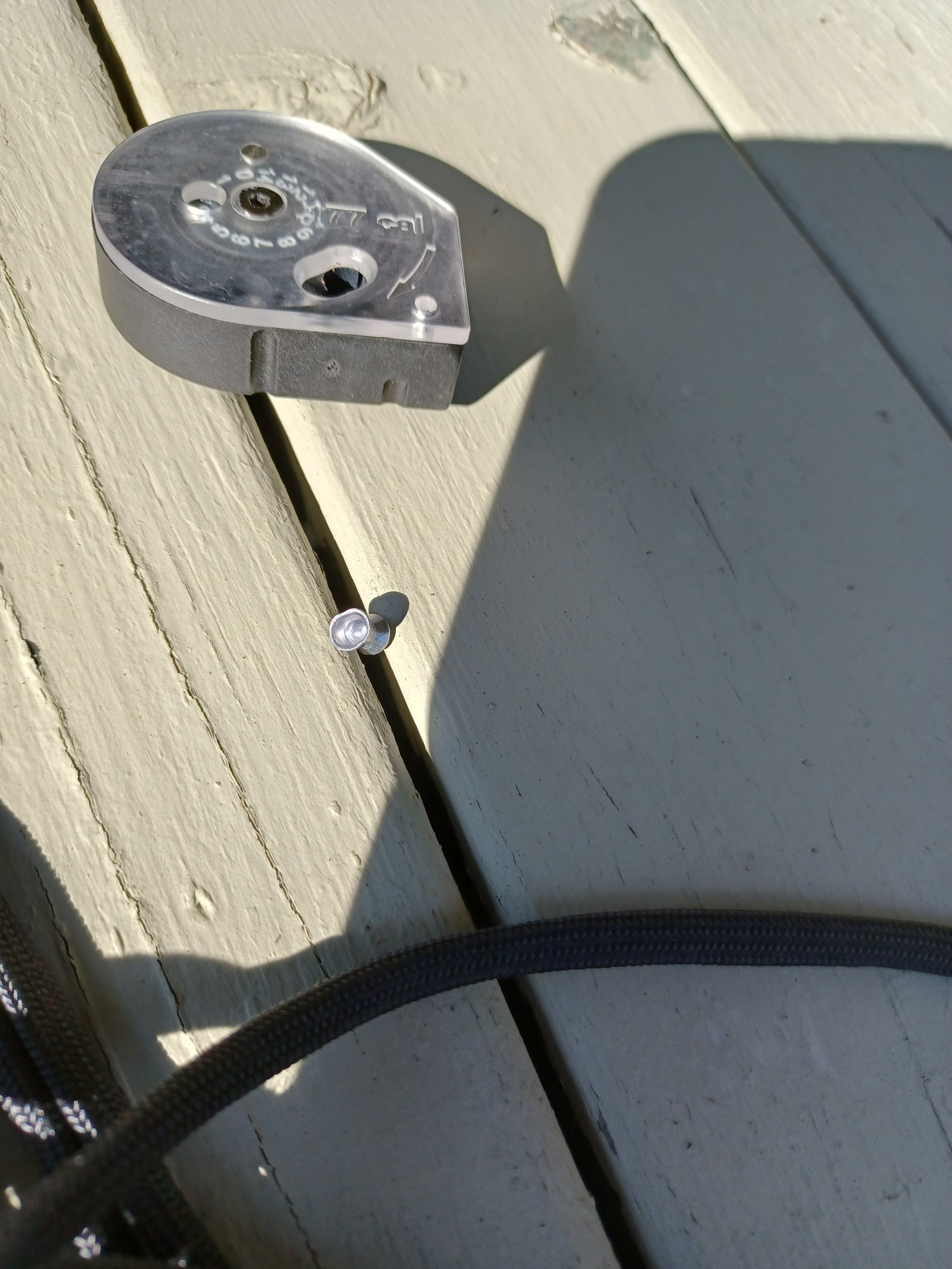

I did play with the mag again and did make some progress, comparing it crosman mag it has less contact area which tends to bite the pellet, yikes, thinking i should work with the barrel to shoot harder pellets more accurately.

Just realized why my new Akela shoots cheap hard pellets more accurately than soft expensive, the magazine deforms the skirts , they get pinched from rotation , i lightened spring tension in mag but didn't help much. Does anybody know of any cures for this issue other than single feed.
Not a lot you can do with a spring loaded self-indexing mag. I really don't think that bent skirt will matter much. The instant the air from the shot hits it, it is pressed against the barrel anyway.

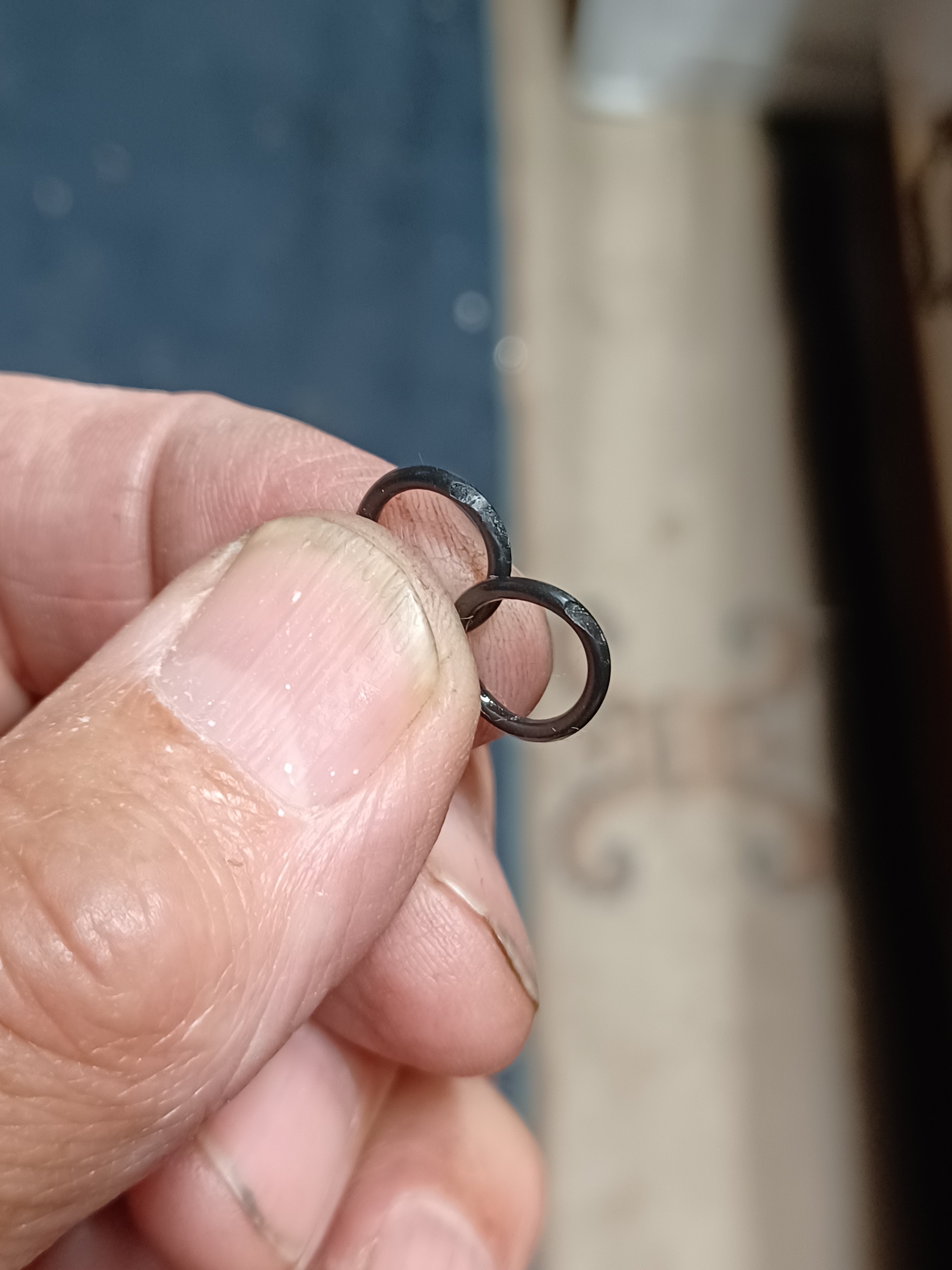

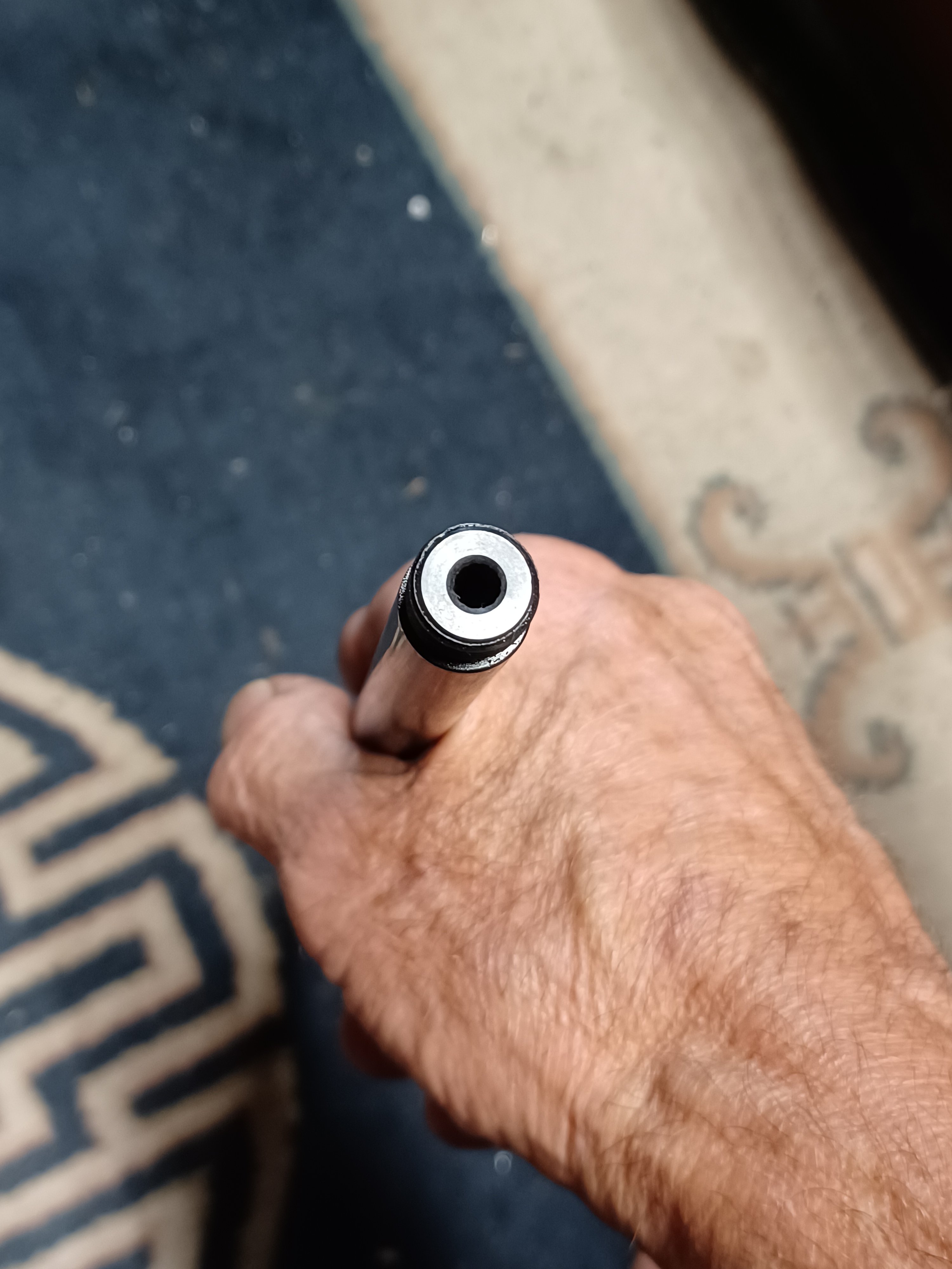

Dug a little deeper into my new akela today, my shooting table wasn't causing any trouble nor my plastic rest, i took the barrel off and pushed a slug thru to see what it looks like. The choke was extremely tight , the slug measured .177 and after .173 seems a little much. Also barrel o-rings chopped up, and crown looks off center, take a look, i thought 300$ was a grat deal maybe not.
Dug a little deeper into my new akela today, my shooting table wasn't causing any trouble nor my plastic rest, i took the barrel off and pushed a slug thru to see what it looks like. The choke was extremely tight , the slug measured .177 and after .173 seems a little much. Also barrel o-rings chopped up, and crown looks off center, take a look, i thought 300$ was a grat deal maybe not.View attachment 291591View attachment 291593
I have noticed the same thing with a tin of Hawk Thunder 13.43 grain straight wall dome. The thinner skirt gets bent in the mag. A similar straight wall pointed pellet is the GAMO Hammer 15.42 grain which has a substantially thicker skirt and does not suffer deformation.
