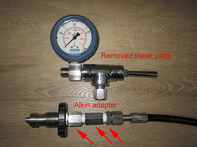

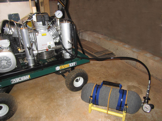

The Alkin home office is very receptive to owner feedback. I called them last week and they sent me an adapter that replaces the 1.75 pound gauge and air bleed lever assembly from the factory fill hose. Most, but not all tanks have valves with gauges and air bleeds. Here is a picture of my Alkin fill hose before and after it was modified to remove parts I don't need since they are also on the tank valve.

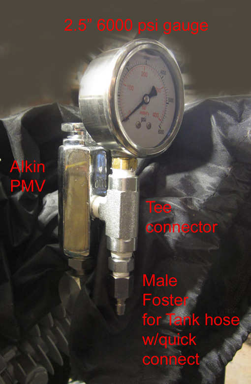

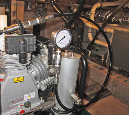

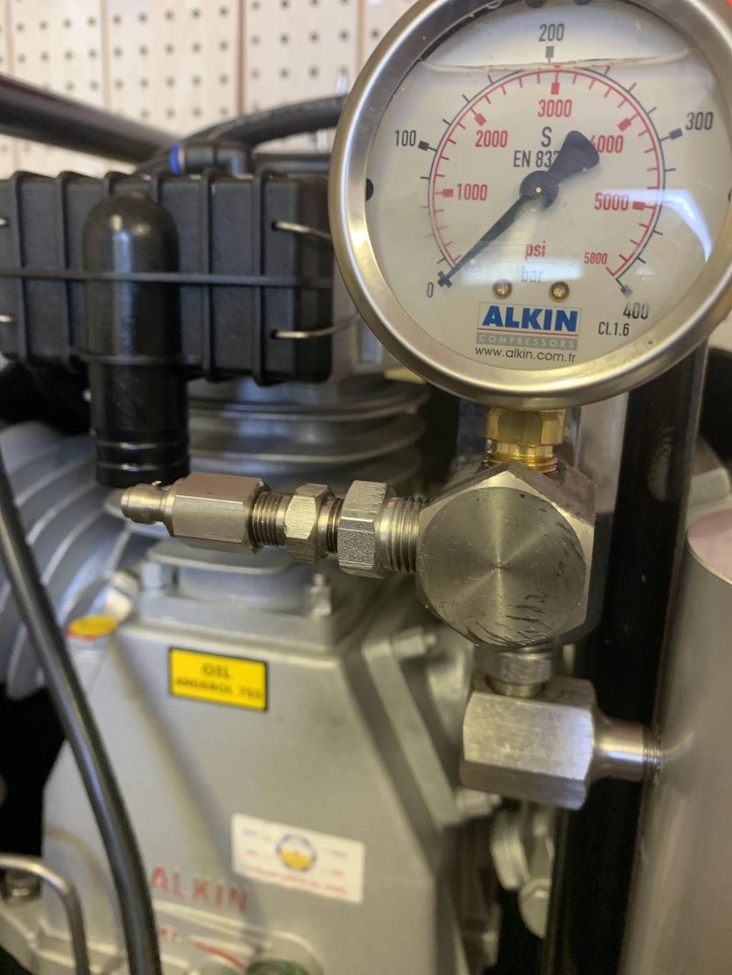

I modified my Alkin by adding a Tee connector and 6000 psi gauge to the PMV. The factory hose attached to the PMV via a male 1/4 NPT threaded adapter. I bought a Tee connector with a male thread 1/4 NPT connection to the PMV. It is mounted vertically with 1/4 NPT female thread on each output side. There is a 2.5" 6000 psi pressure gauge on top of the Tee, and the option of using a 1/4 NPT to 1/8 NPT reduction fitting to a Male Foster, or the factory hose can be threaded on the bottom of the Tee.
The photos below show the compressor in both Foster connector or factory hose configurations. The advantage of the male Foster is that any tank hose with a quick connect can snap on directly to the compressor for a fill. The advantage of the factory hose is that the DIN 300 connection is more secure than a Foster. With either connector I now look up at the compressor gauge to see fill pressure and now have a much lighter hose assembly. The compressor gauge and tank gauge both show the same pressure so both are calibrated correctly.
The Tee connector is $10.50 delivered on Ebay and the pressure gauge is $13.68 delivered on Amazon.

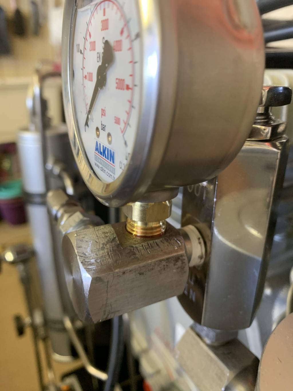

This is said as friendly joking, ribbing, and not intended to insult:
Those are some nice cosmetic wrench marks on those five fittings to neck down to Foster fittings. Maybe the person who spun it on was an amateur watch maker trying to turn the front face into a clock with the chatter marks :) :p
Edit: Does your Alkin still knock on start up?
That one large piece is marked up pretty badly. I don’t see much else . I noticed that and figured that it was held in a vise and clamped pretty hard. I’m as anal as the next guy and actually considered cleaning that up but decided I needed to show some self control over my impulses . I’m reasonably confident that at my advanced age I will in short order forget that those defects exist .
