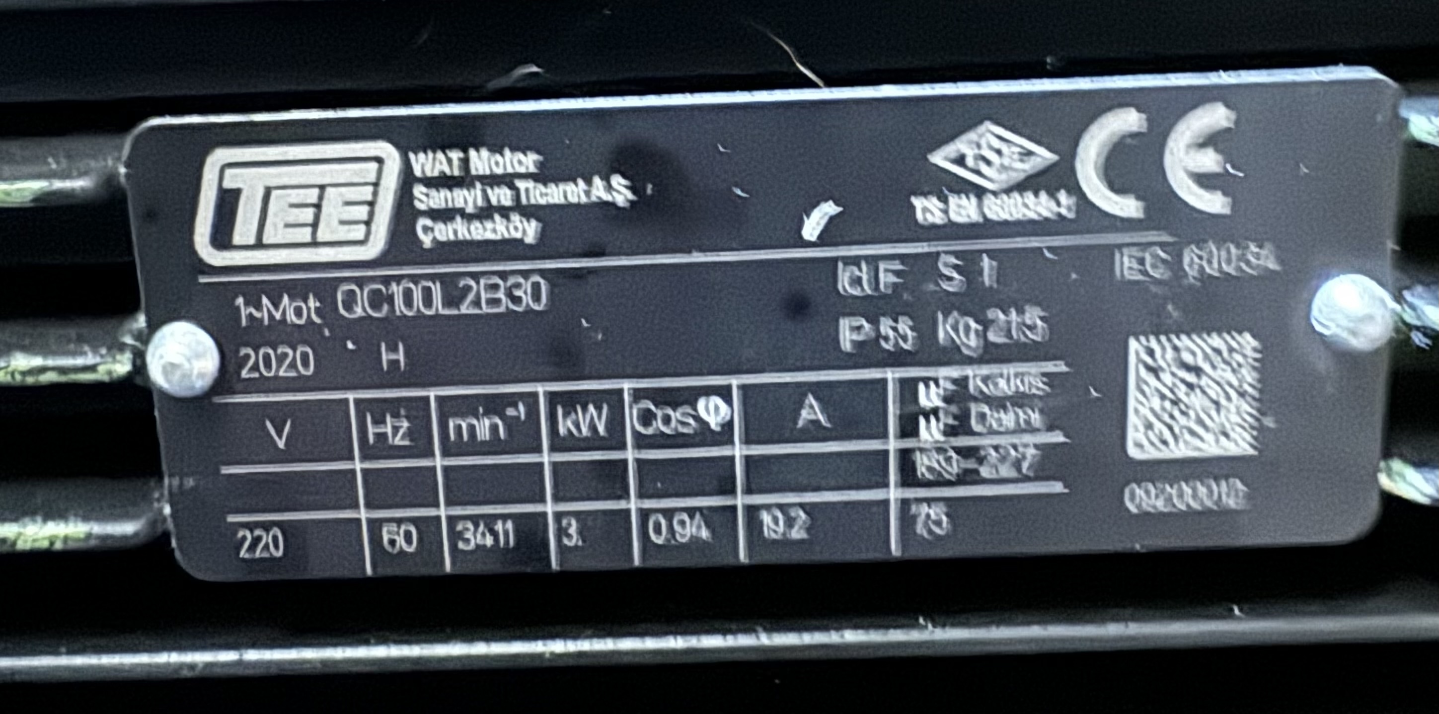

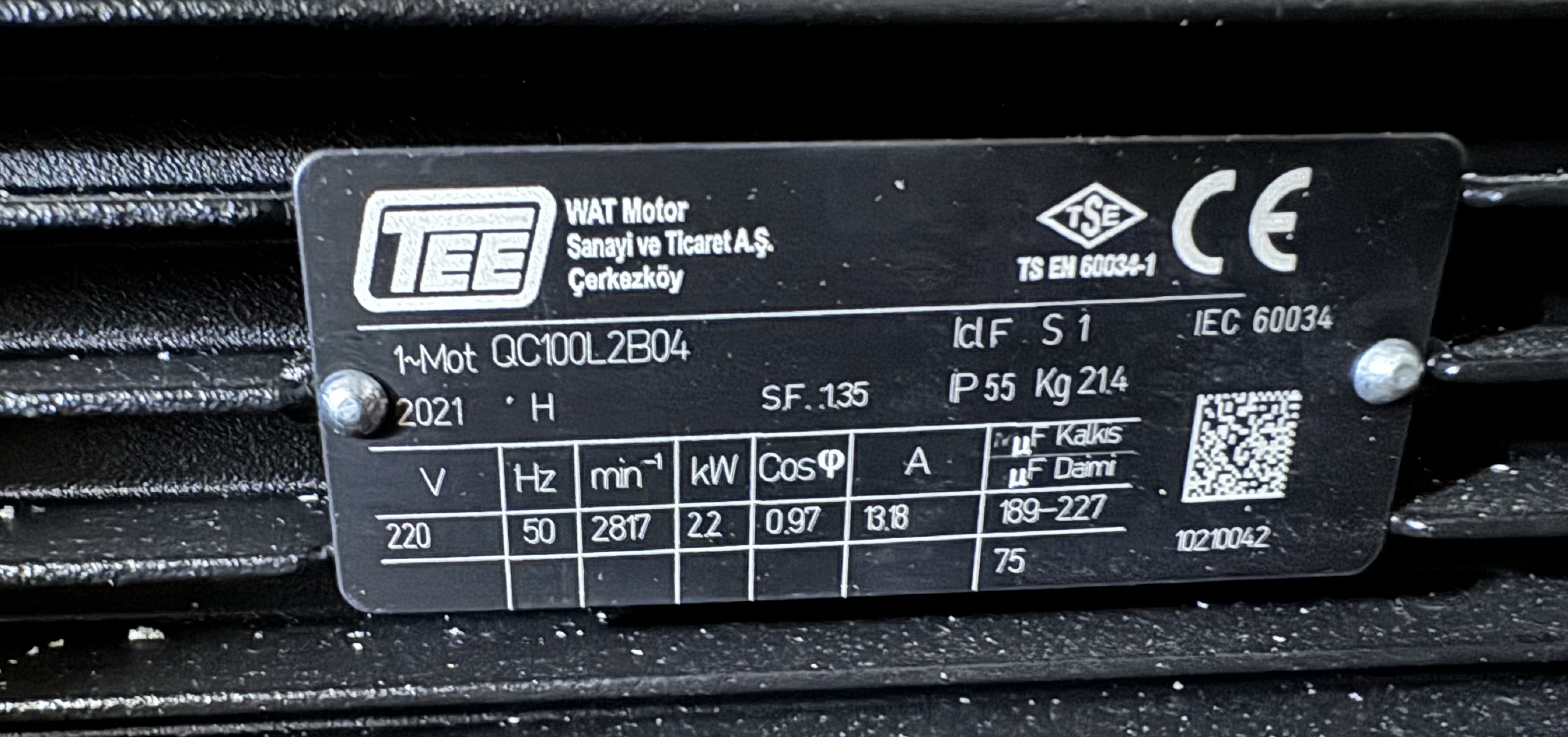

Guys i need your help i own an Alkin W31 4.9cfm compressor. Recently the electric motor blew up and i purchased a new one from Alkin. The oem motor was a 3kw 60hz motor and the one they sent me is a 2.2kw 50hz motor i called them and they told me that this motor will work the same as the 3kw motor and honestly i doubt that since this is a weaker motor and on top of that the motor they sent me is from 2021 its not even new. What can i do about this?

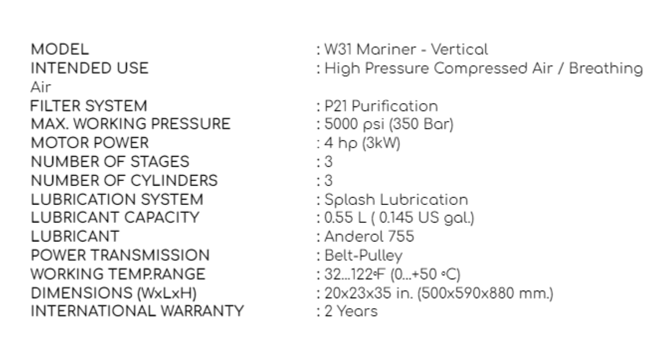

edit: The "Data Sheet" for the W31 Mariner Vertical says its a 4hp (3kW) motor. I'd also refer to the owner's manual and request what's printed there as well as what is printed below.

Running the motor @ 60Hz will push it closer to the original motors Kw. You will probably be ok. It would be more of an issue the other way around. Since this is a single phase motor, it uses capacitors that are usually rated for both frequencies. Do you still have the old motor. Its possible the caps took a dump. If so, that's a easy fix.
