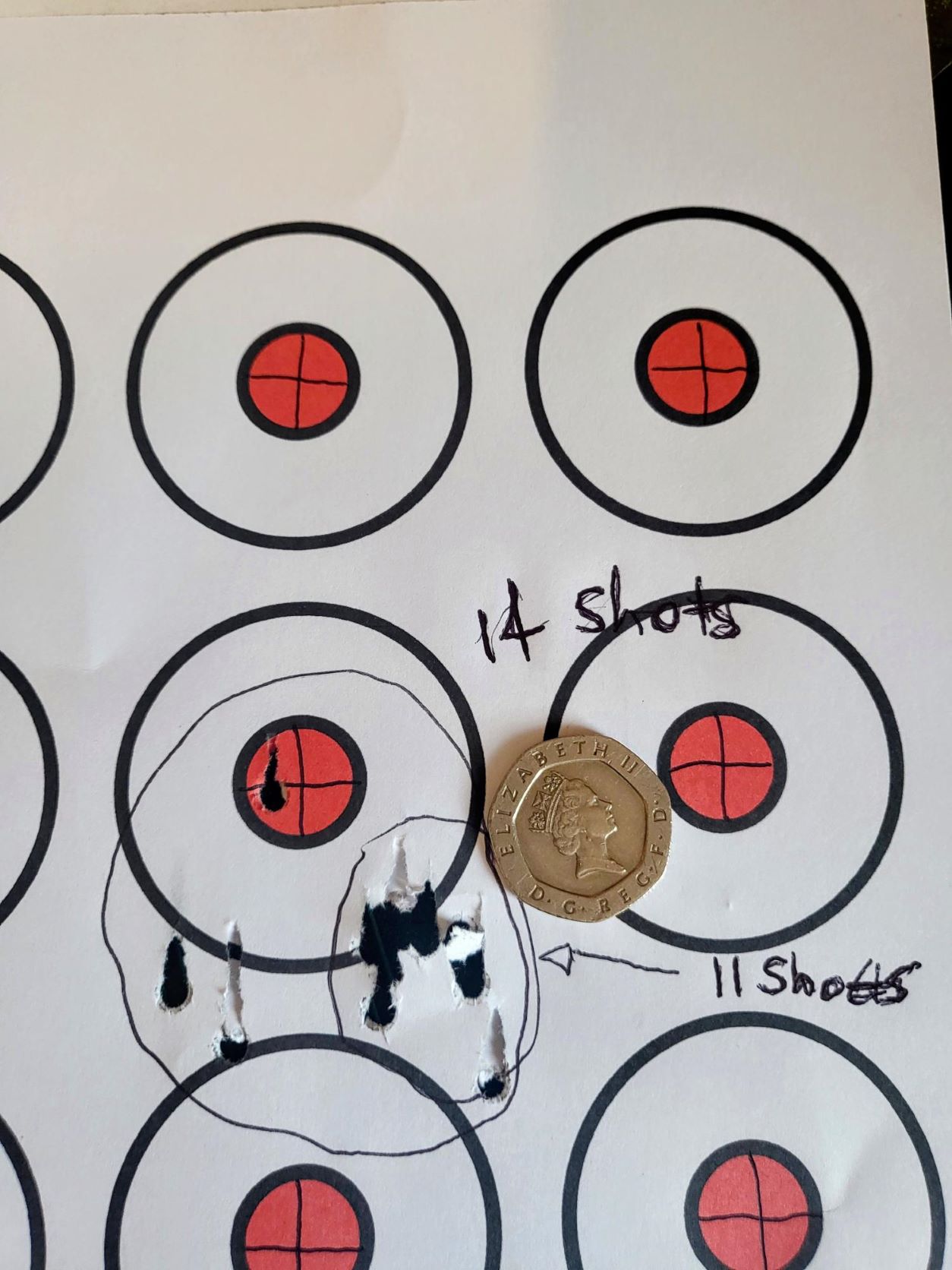

re-tried the hades in my hatsan NovaStar nope just not happening, Wadcutters fire better over 30m!
Air Arms Diablo seems to group well and i had decided to stay on those,
But I've just taken delivery of some ZAN .177 slugs 10gr, and wow a quick couple of mags and I'm seriously impressed especially on a sub 12ft especially when the air pressure was low.
looking forward to trying it after a refill....
So this was 30m low air, lying on the floor no bean bags or tripod so that's 14 shots within 1.75" / 45mm although the most surprising thing is 11 of those shots landed within 20mm think I've found something my rifle likes.:)
