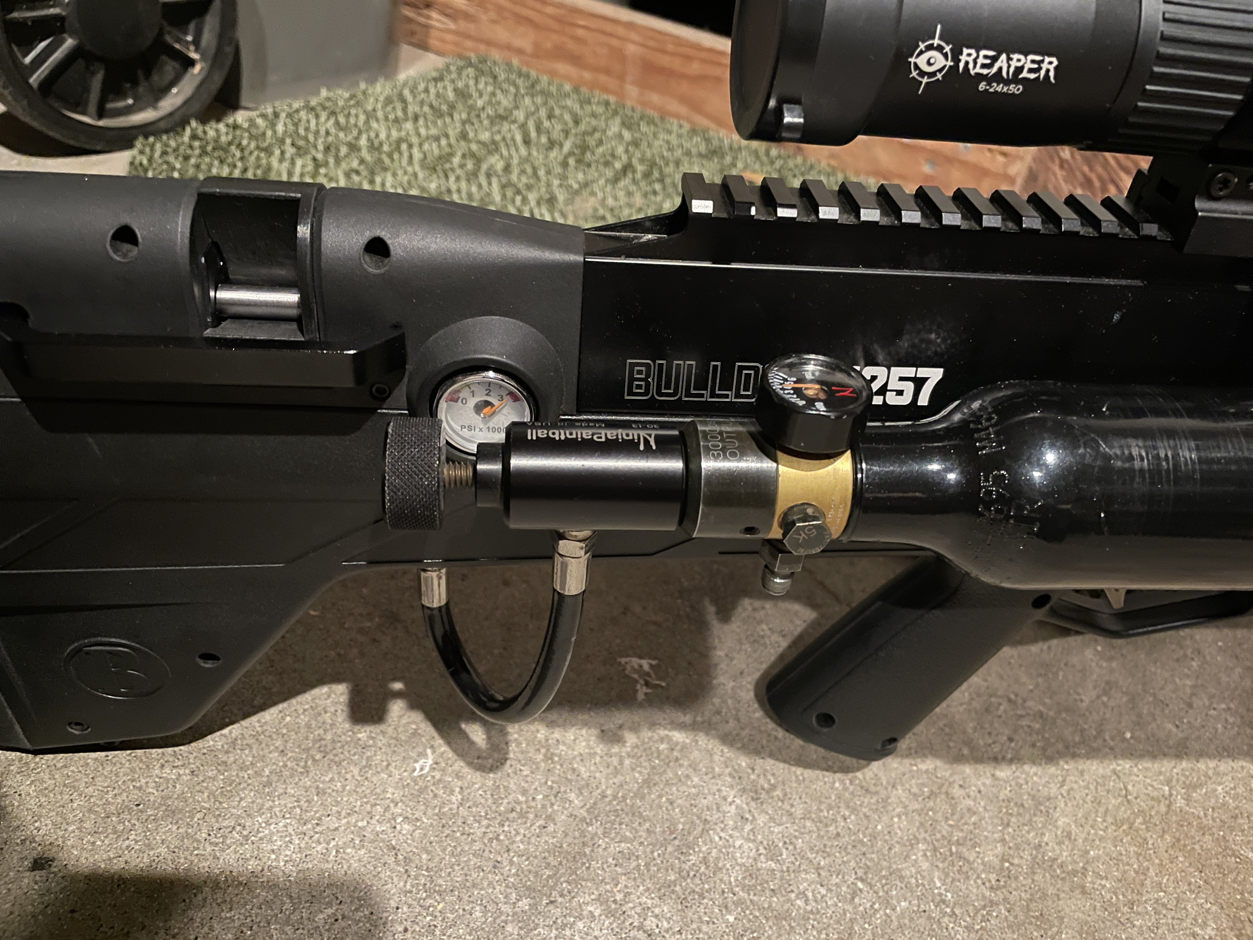

I reoriented the bottle and hooked it up to the fill port threads (rather than make a front connection). It’s a 400cc bottle from a Gauntlet 2. It can go to 4500psi, but 4000psi is a more practical fill pressure while at the range. Even if I take a purge shot, it looks like I’ll get 5 good shots for target shooting at a match while untethered.
The old Ninja bottle reg needs some attention as it is inconsistent and creeping some. Pressure readings are approx psi with small gauges.
Arsenal .308, 171gr BT
Bottle(psi), plenum(psi), FPS
4000psi, 3100psi, 943fps
3900psi, 2900psi, 932fps
3700psi, 2900psi, 910fps
3500psi, 2900psi, 911fps
3200psi, 2800psi, 940fps
3000psi, 2750psi, 916fps
2900psi, 2600psi, 897fps
2800psi, 2500psi, 881fps
This thing is light enough and kicks hard enough to make it hold sensitive. I managed some decent 5 shot groups, using a bipod, on a bench, at 100yds. 3/5 inside the 10 ring on the first group (some good luck).

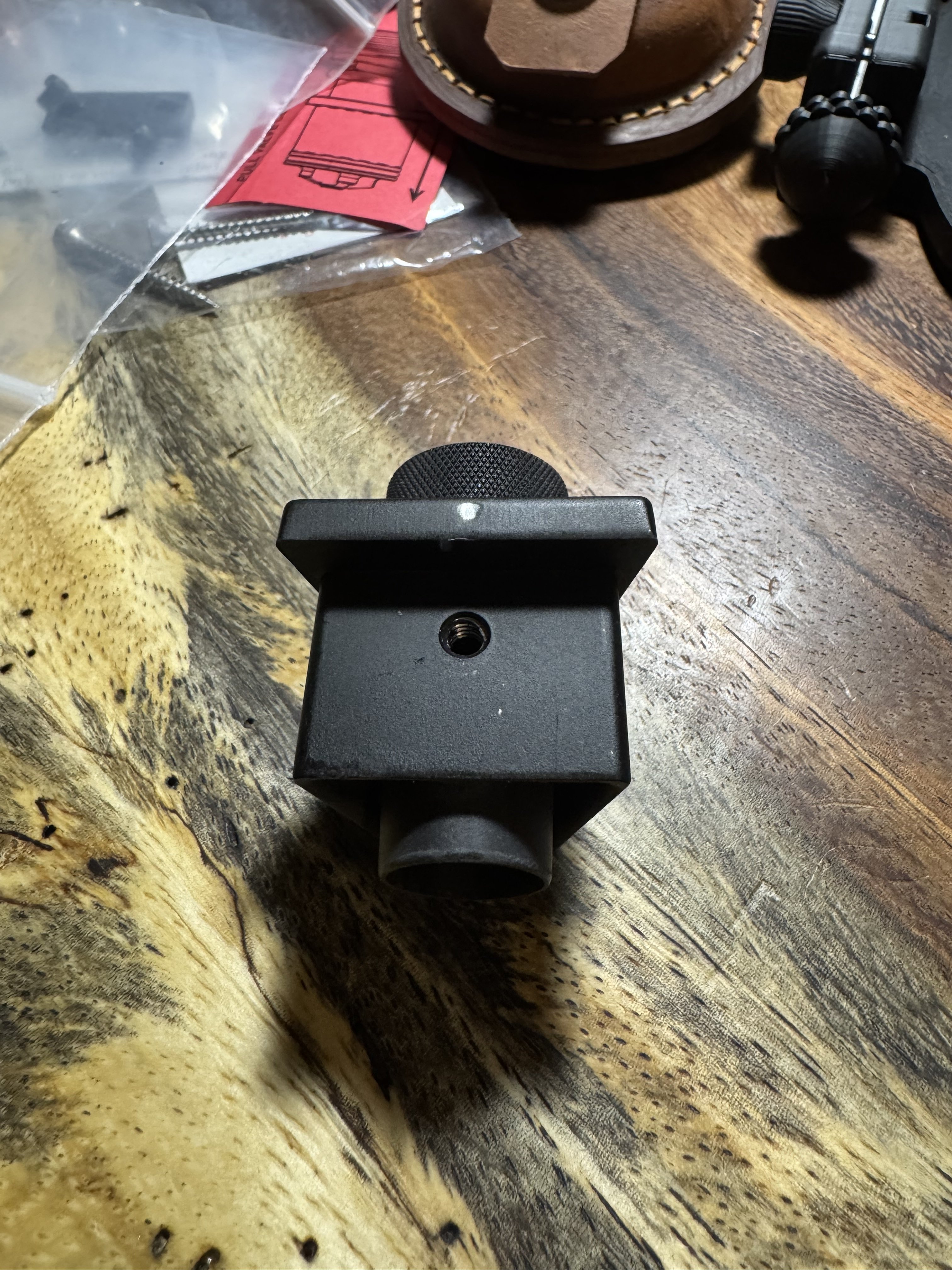

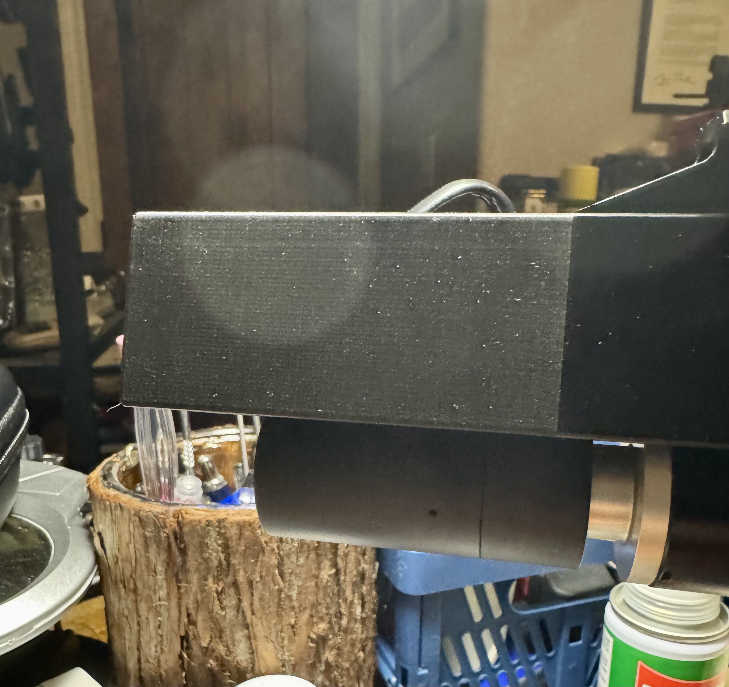

FYI for those considering installing a Huma regulator and extra gauge assembly.
A stock M357 doesn’t allow for the installation of the gauge/fill probe assembly with the stock endcap-see the mark where paint was removed:
So, I ordered the long moderator with cutout for air tube extension from Pitbull. It fits perfectly with the extended Huma gauge and probe assembly:
So now, the stock gauge only shows the regulator setting (mine is 140 bar/2000 psi) with the front gauge showing tube pressure.
Moderator performance/noise reduction is comparable to the Donny Ronin.
Hope this saves someone else the a$$pain I went through to figure this out.
