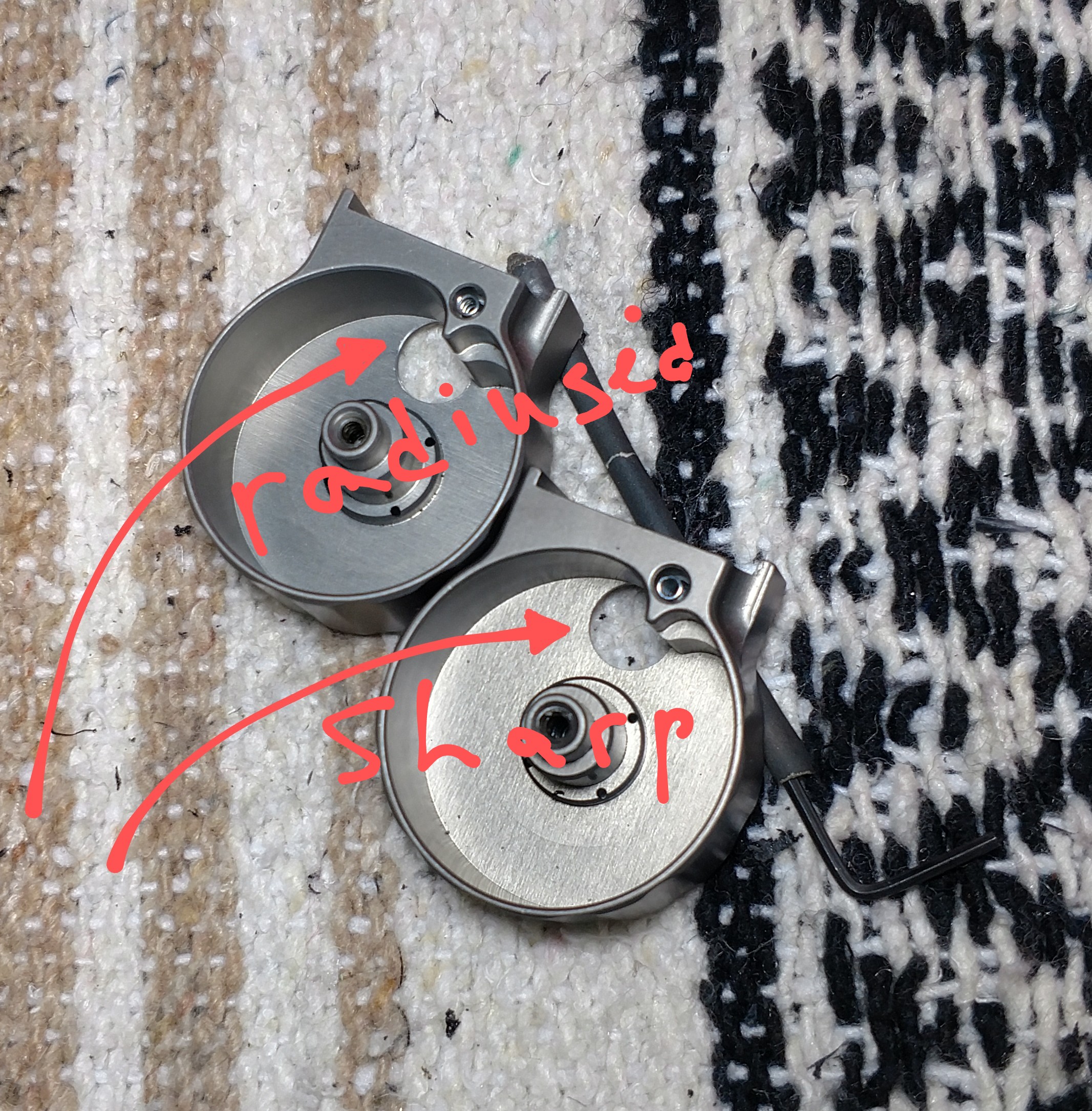

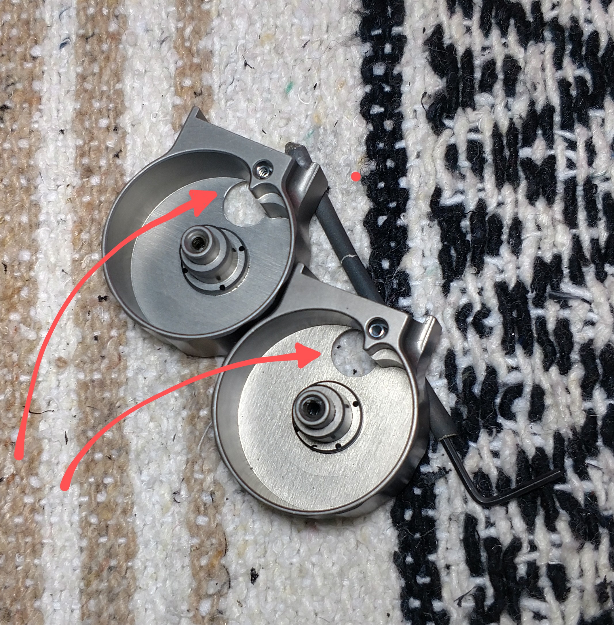

I have had this happen to me a couple of times with pellets as well. Aside from now carrying a fiberglass rod in my case now to tap the jammed pellet back into the magazine, I also did some experimenting with the different magazines to figure out why it happens and completed the fix for it.
What happens is the very edge of a pellet head will catch this sharp edge of the magazine as it begins to exit. (Check out the difference in the two magazine holes, before and after.) This sharp edge is sometimes catching/dragging the edge of the pellet's head, which allows the pellet to want to move sideways in the magazine. Then, the extra force we apply with the cocking lever jams things up. Through testing, the solution was to cut, radius and polish the leading edge of the hole in the magazine. I haven't had a jam since, and can feel that there's no catching issues anymore.

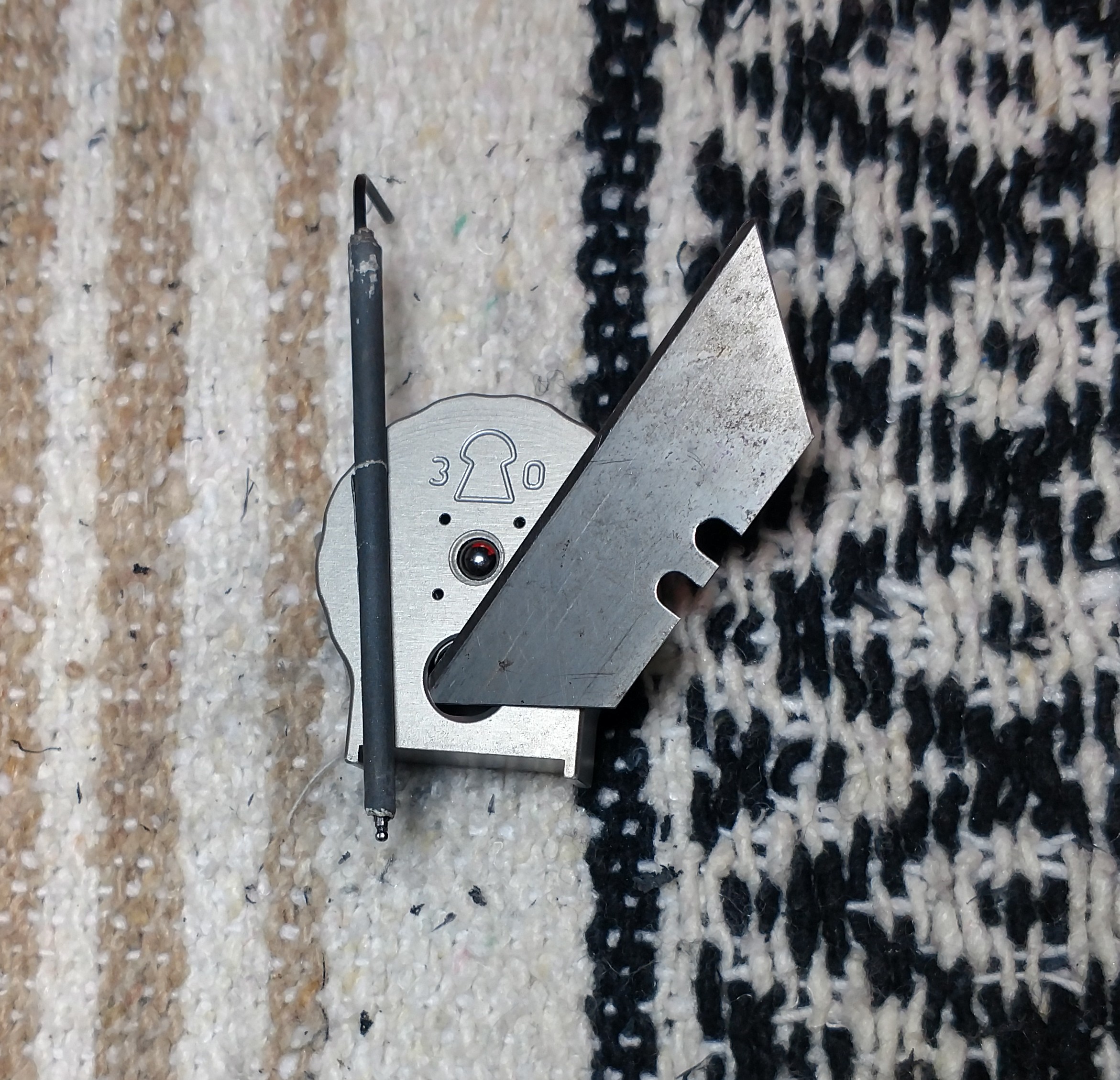

Cleaning and polishing up the inside edge of the hole was easy enough with these steps: (1) Disassemble the magazine. (2) Working from the outside to reach the inside corner of the hole at an angle, take a razor blade and lightly cut the sharp corner off the hole. One or two light cutting swipes all the way around the hole worked. (3) Polish the cut edge into a smooth round radius with 400-600 grit sandpaper (I rolled sandpaper tightly around a small .050" Allen wrench to work the close corners and add pressure to the paper.) (4) Reassemble, tightening the screw so the magazine lid is closed on all sides and rotates with a little bit of resistance.
View attachment 358534View attachment 358535
@madeintheuk Here's instructions (above, from post #75) on how to modify the magazine port hole to stop pellets from snagging and or shaving on the way through to the breech. It works great and only takes about five minutes time. Alternatively, I think that the AAA authorized warranty dealer is Airguns of Arizona, who should be able to answer those questions.

While I think I'm going to try this and appreciate it, i do believe at $100.00 per mag we shouldn't have to change the product we have in hand though.

Totally agree!

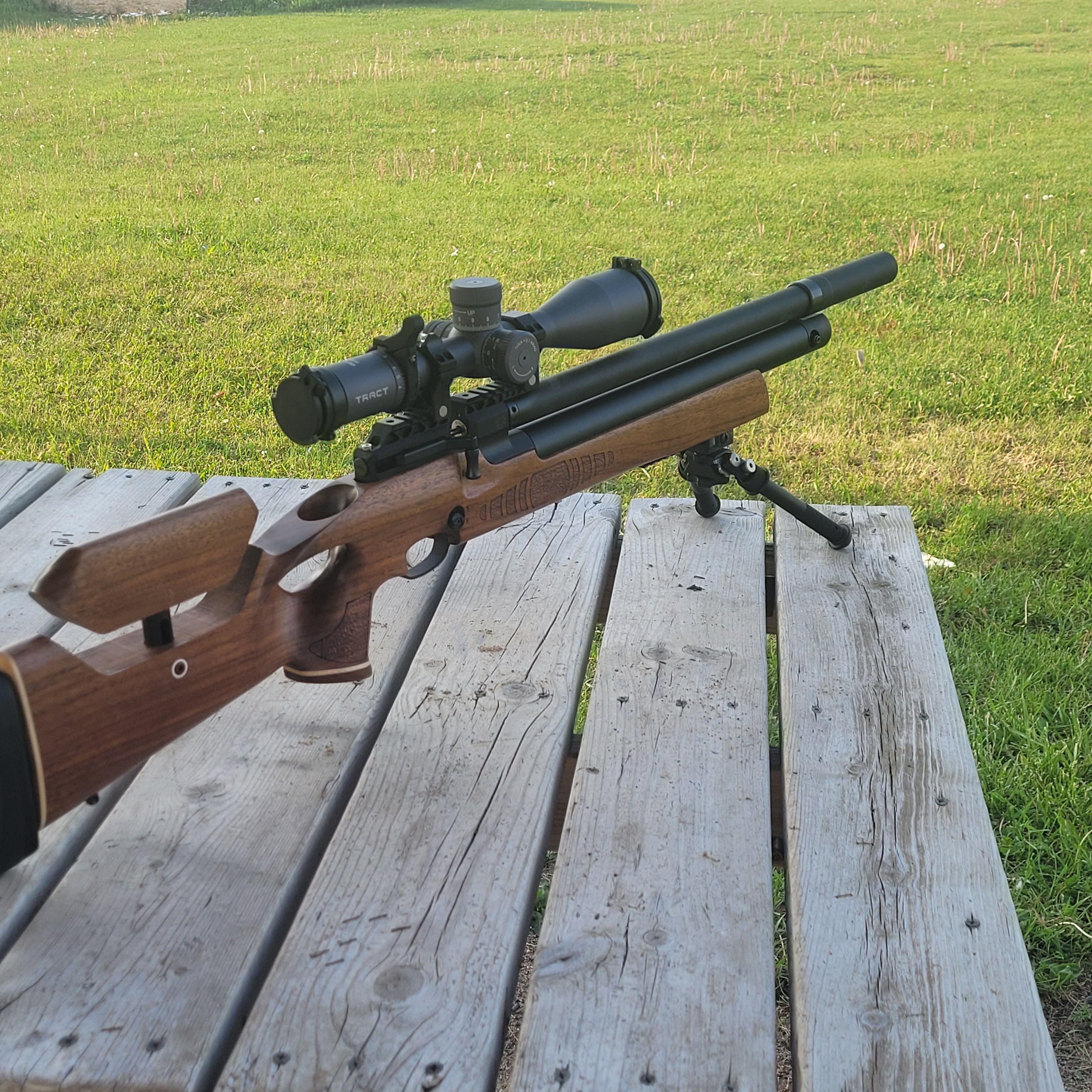

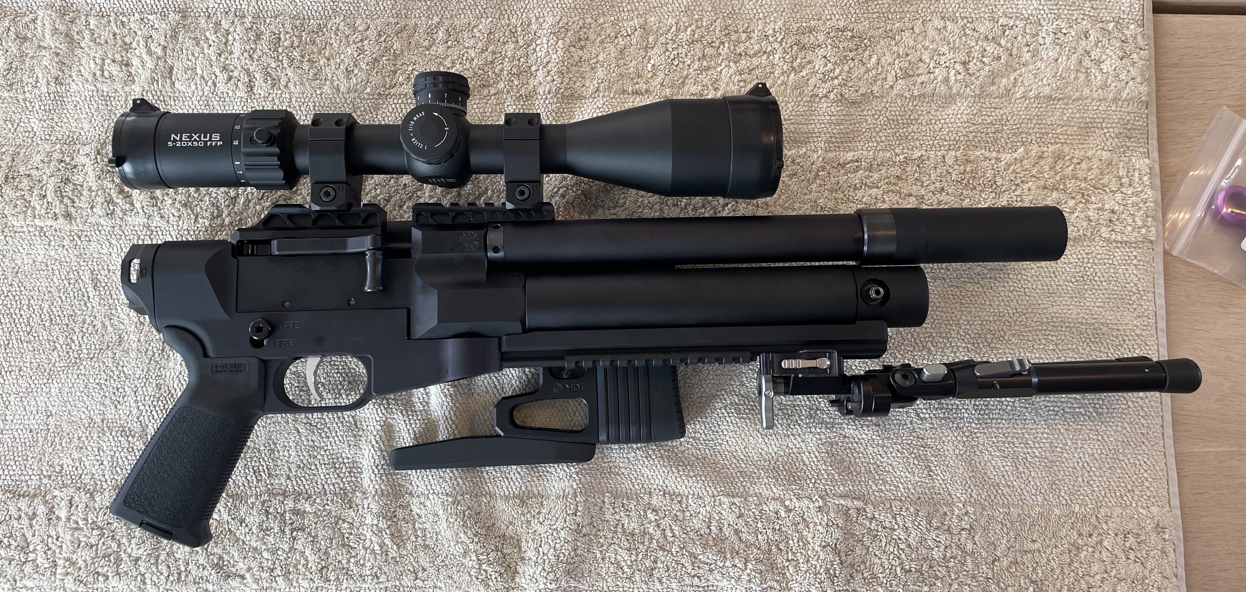

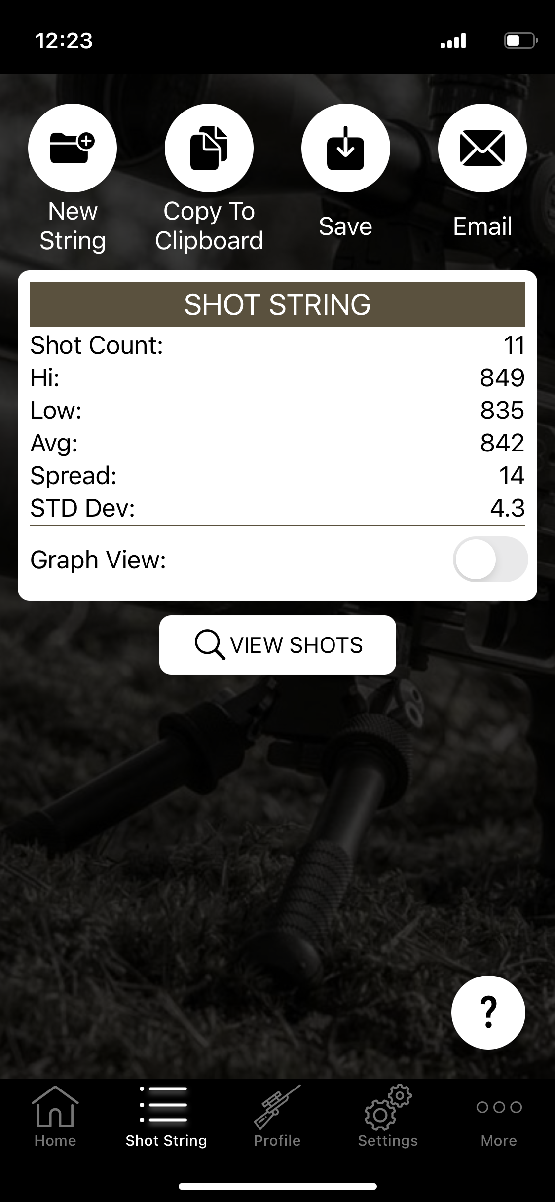

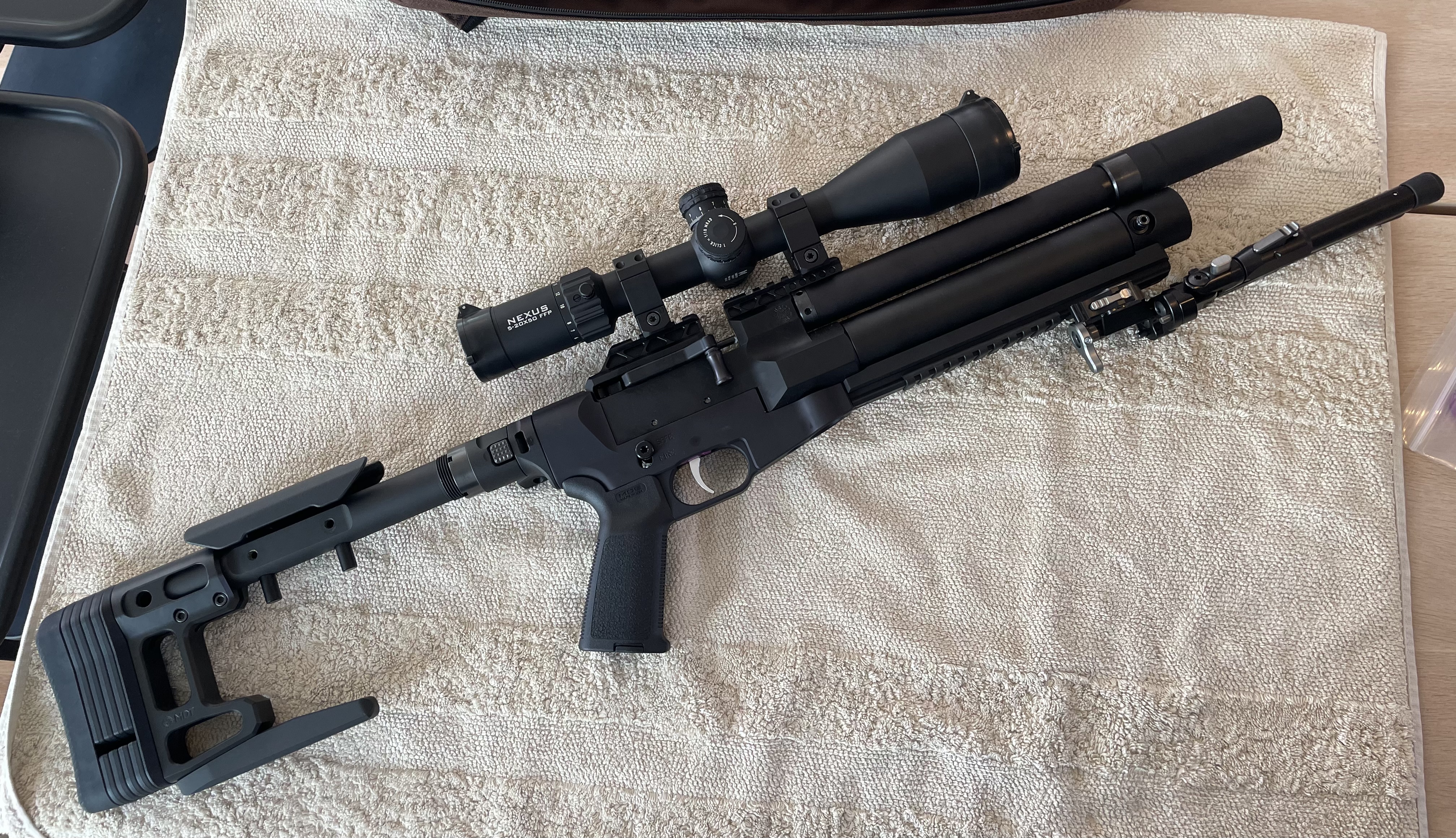

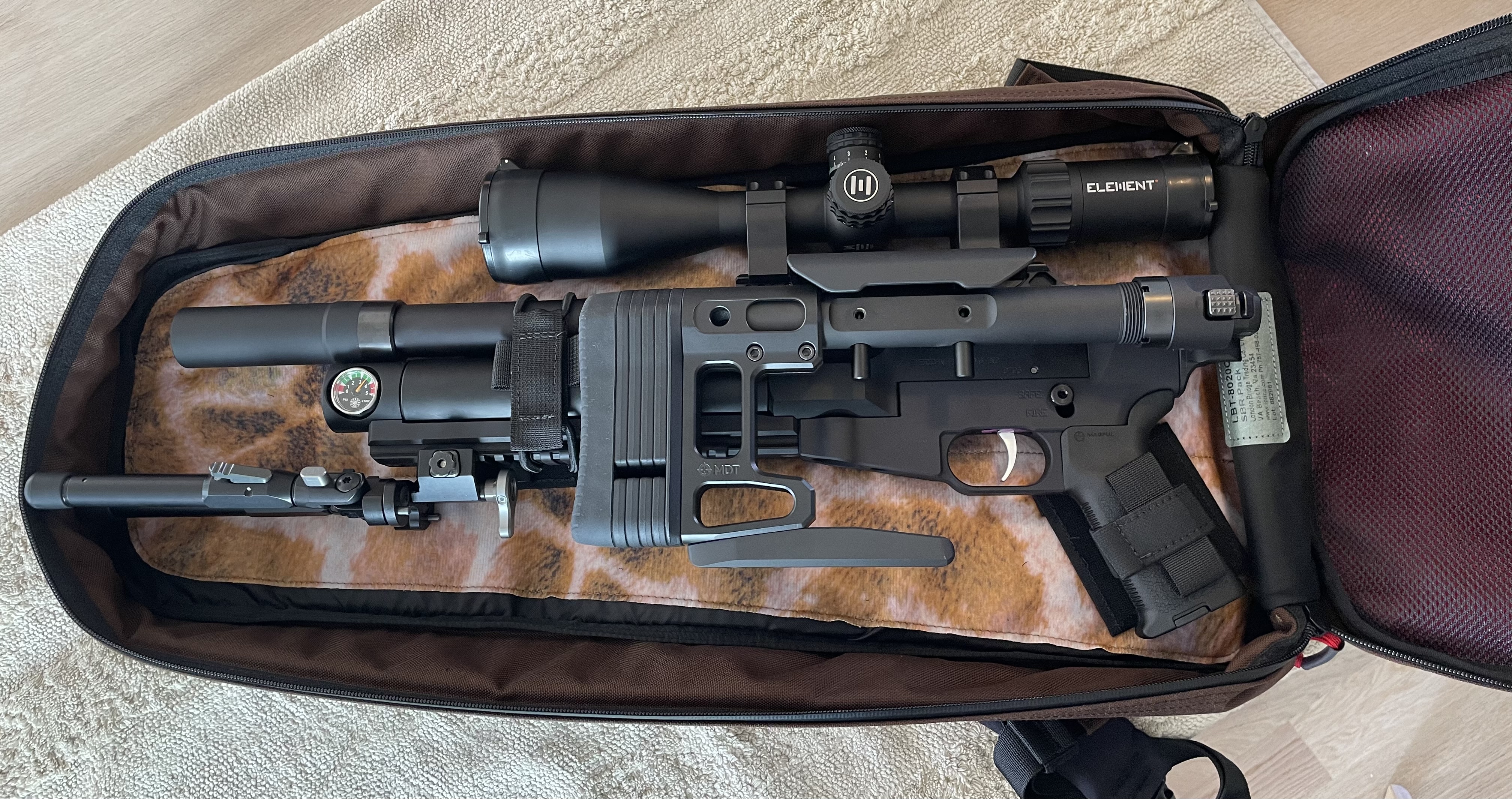

Latest version Evol Mini .22. Came with a very nice bag - but I already had a backpack and some upgrades waiting for it. 😅 First 11 shots over the chrono looks very promising (JSB 18,1gr).

Also, love the MDT Carbine stock on there!!!!! Hell yes brother! That seals the deal for what I want to do to my mini, my mini is my favorite rifle to date, hands down!
Mine is shooting 18.13 around 820 fps but the reg on mine is turned down a bit, shooting hades at 865-870.

Not sure it’s worth the international shipping charge? It’s this bag: https://www.saviorequipment.com/collections/specialist/products/specialist-covert-single-rifle-case
How does it feel once in the unfolded position? is it solid? any wiggle or shakes?
The MDT SCS is rock solid when unfolded. The adapter has some composite inserts that locks it in place. Makes it a little hard to fold (I’m used to the L2 that swings open with no force). Leaps ahead the rattling Magpul stock it came with.
My mini has the magpul stock and I actually love the stock itself, if possible, would you measure the total length of your adapter combined with the mdt carbine stock lite you have mounted there? No rush, at your liesure but it would be much appreciated.
