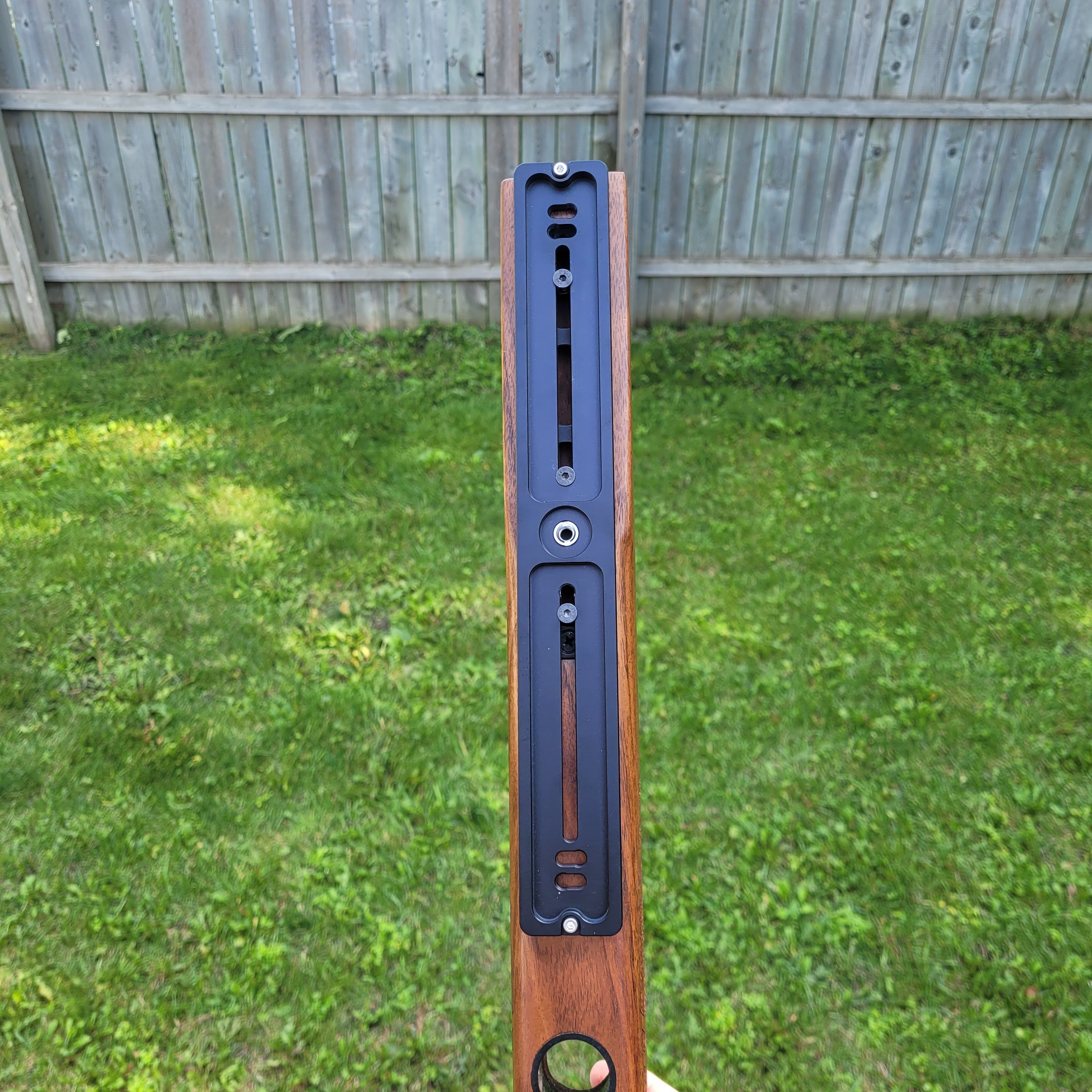

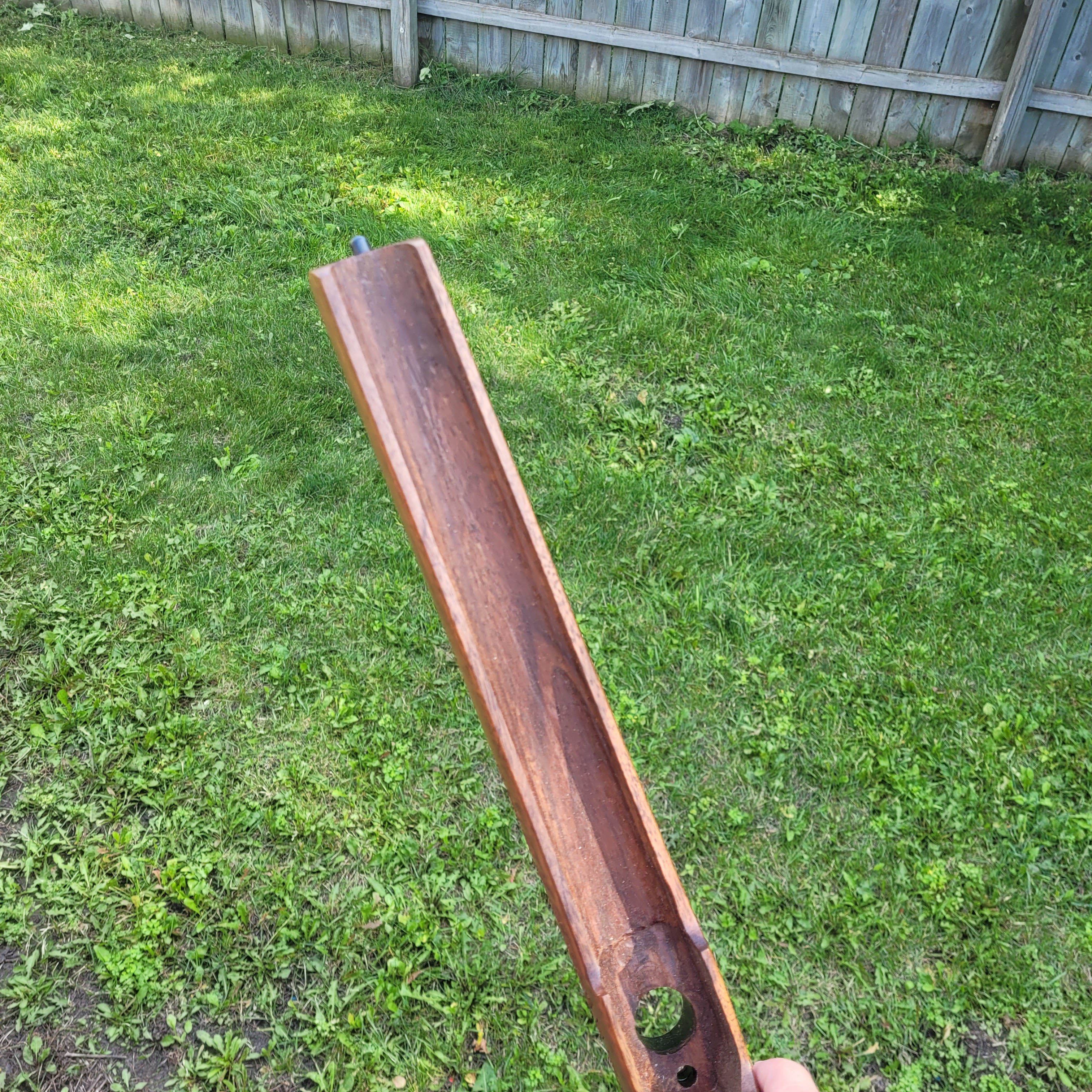

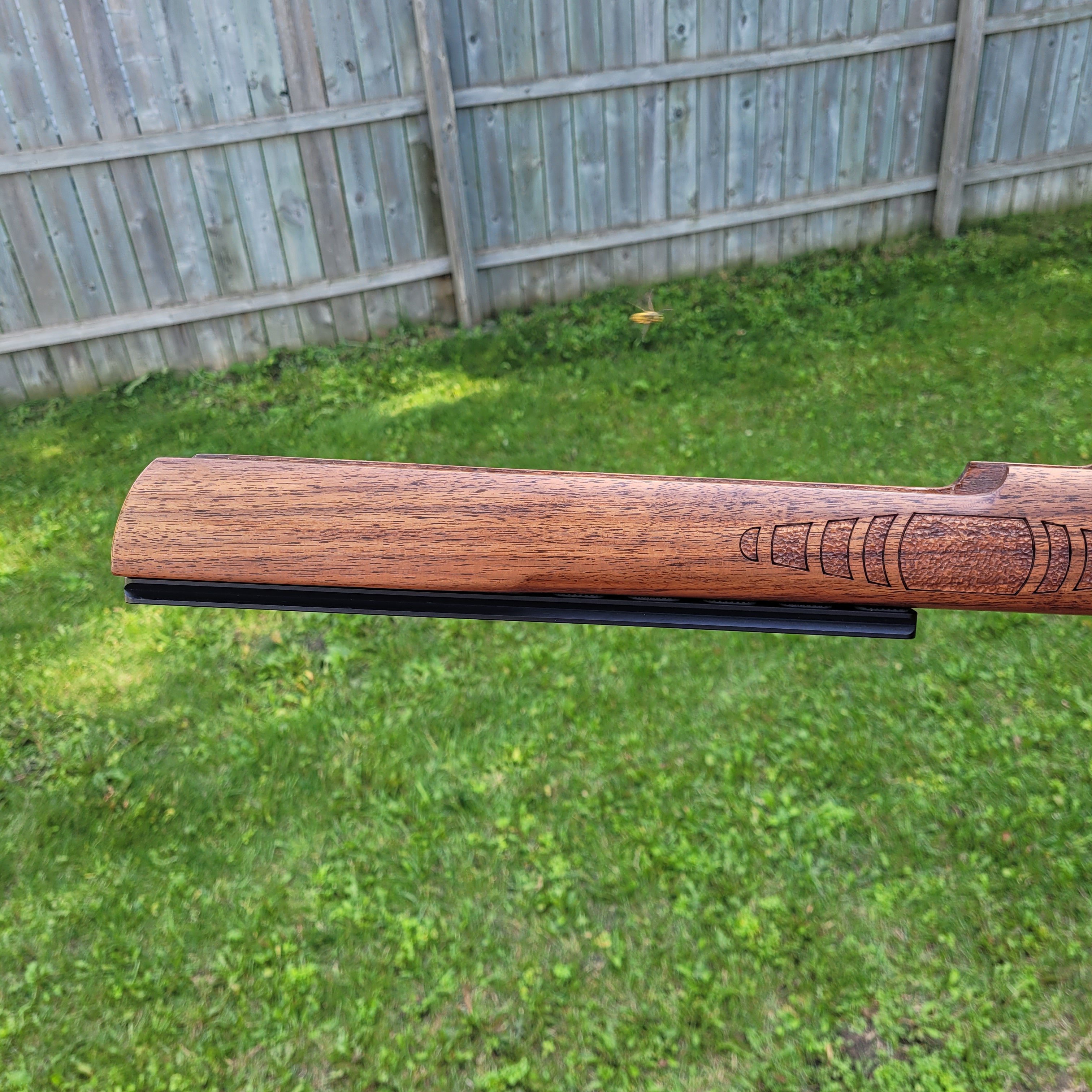

I have been talking about putting an Arca rail on the Paradigm, and I think I found a solution. While looking around Amazon a while ago I bought a length of Arca for another project and promptly forgot about it. The Paradigm has a section of inleted rail that I was able to utilize.
Over all it looks great and it is stable. This should help prevent any kind of scratches or dents to the forend.
Just to show that no drilling of the stock is needed.

This is what I was suggesting!!!
I like this!!
