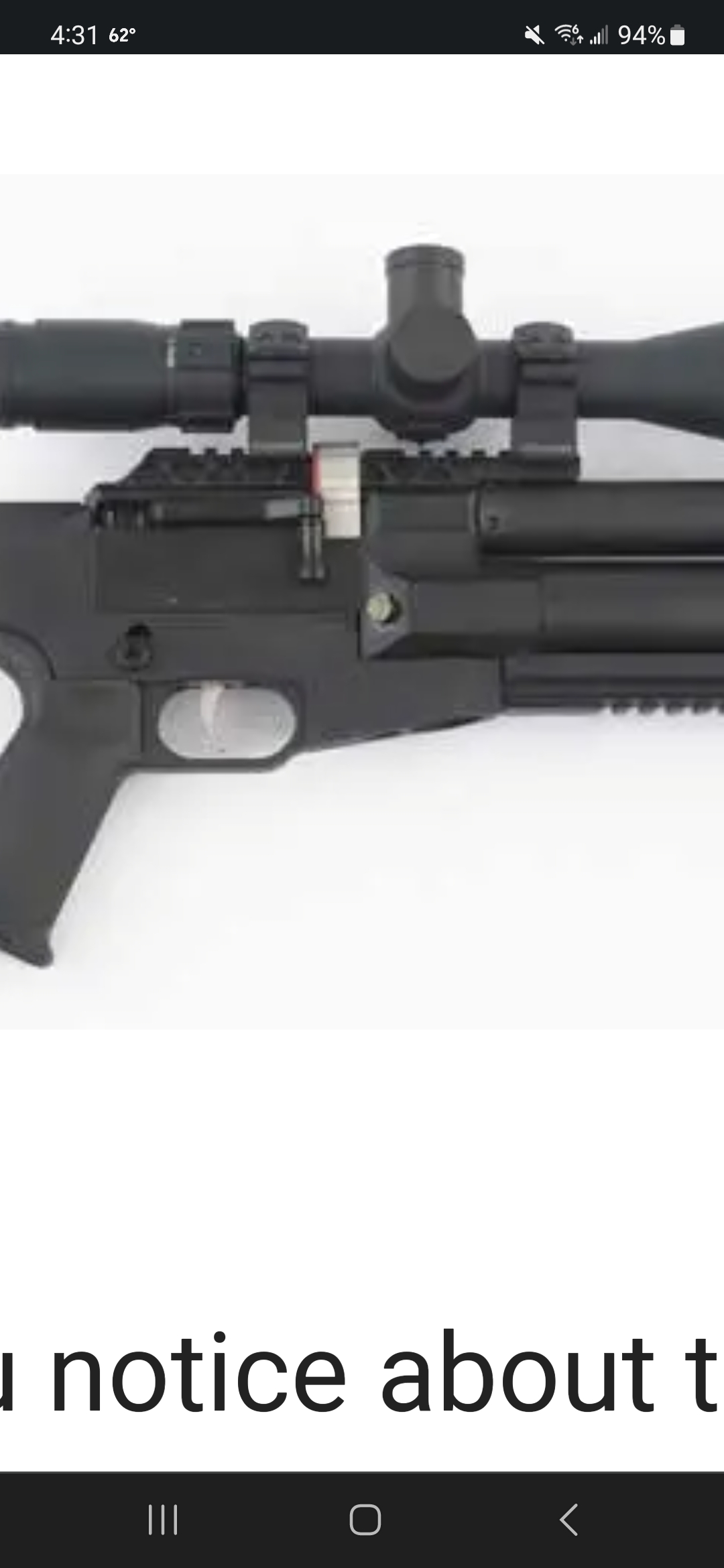

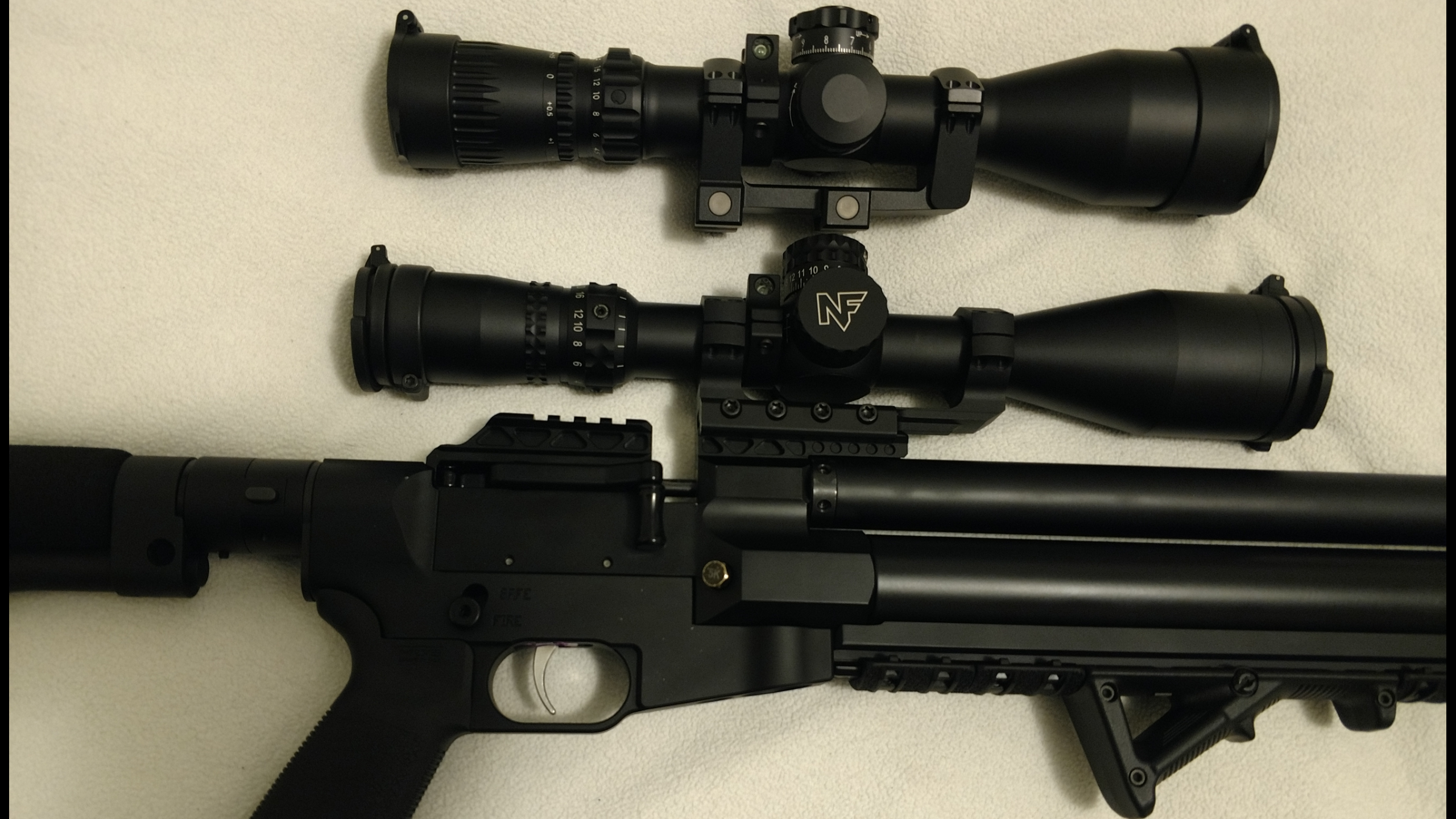

Here's my solution to get a solid and repeatable (off and back on) one piece cantilever scope mount on the Evol. To fit the front rail, only a cantilever mount that spans just four slots of a picatinny rail will work. A lot of mounts are made to fit 5 slots of a rail. The mount on the Evol in the image is a Leupold Mark AR. It needs modified to remove about 1/2" of metal off the back, because it fits five slots as designed. Removing the extra metal was done easy enough with a hack saw and flat file to clean it up nice. The other mount shown is a Nightforce Unimount with 0-moa built in. It fits perfectly.
Because the Evol is engineered with a perfect amount of moa built into the picatinny rail, an additional 20 moa built into some cantilever mounts doesn't allow scope turrets to get low enough to zero at close range, that is unless you are going to shoot long range targets.

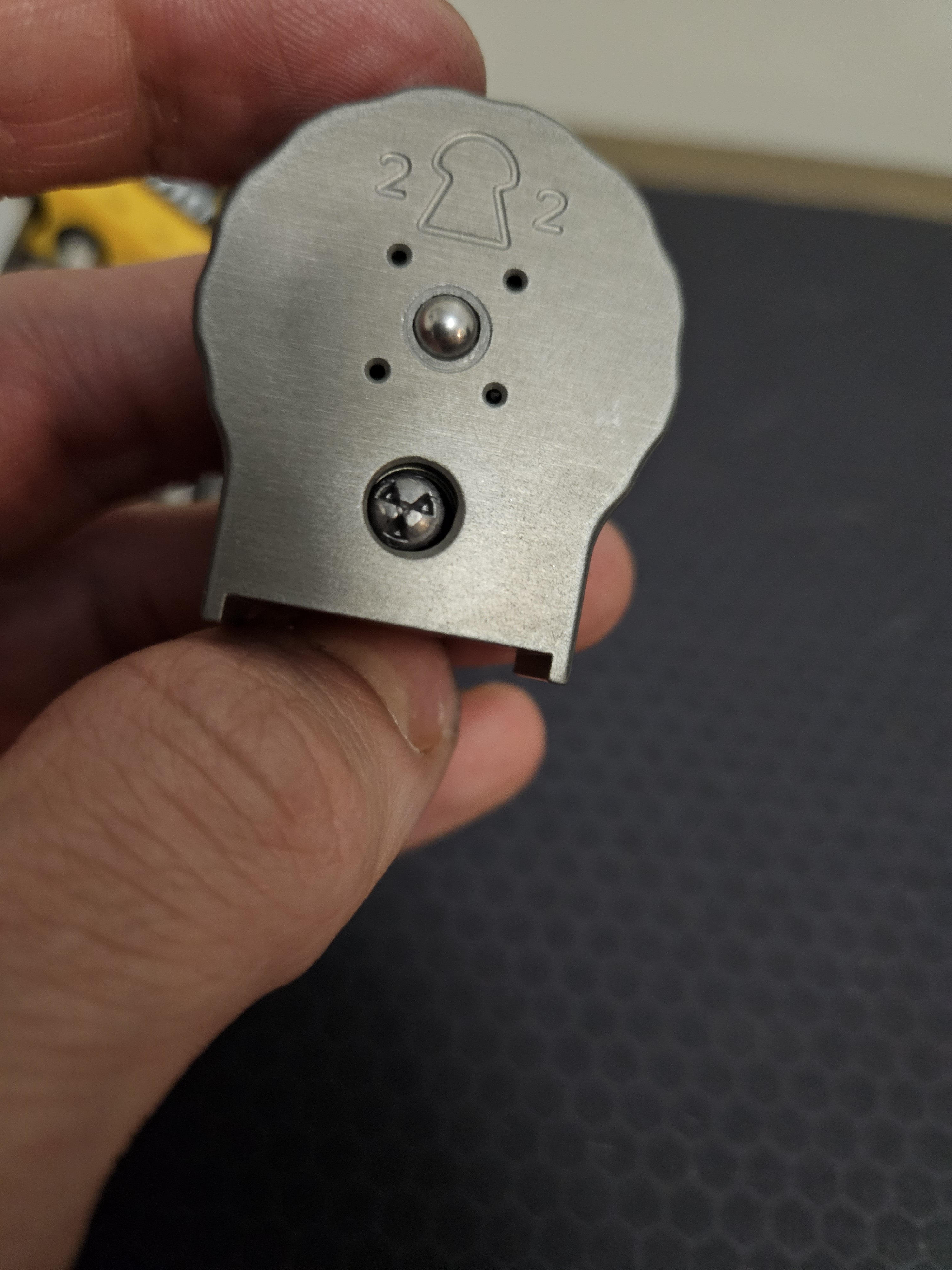

Anyone have issues with magazines? Sometimes they jam up pretty bad on occasion. I've tried loosening up the center screw and playing with that but doesn't change anything , the 15.89 hades kinda fall in at an angle as the mag cycles
I was having a bit of an issue once the magazine got a little dirty from use. (I was lubing the pellets and slugs with silicone oil.) I took it apart and cleaned the gunk out and put it back together, trying it out dry instead of lubed. Lube collects dirt and grit, where dry won't. Loosening the screw seemed to allow the inner portion to not rotate as true, kind of sloppy, so I put purple Loctite on the screw to where the lid was flush and slightly snug but rotated smooth and haven't had any issue since.
