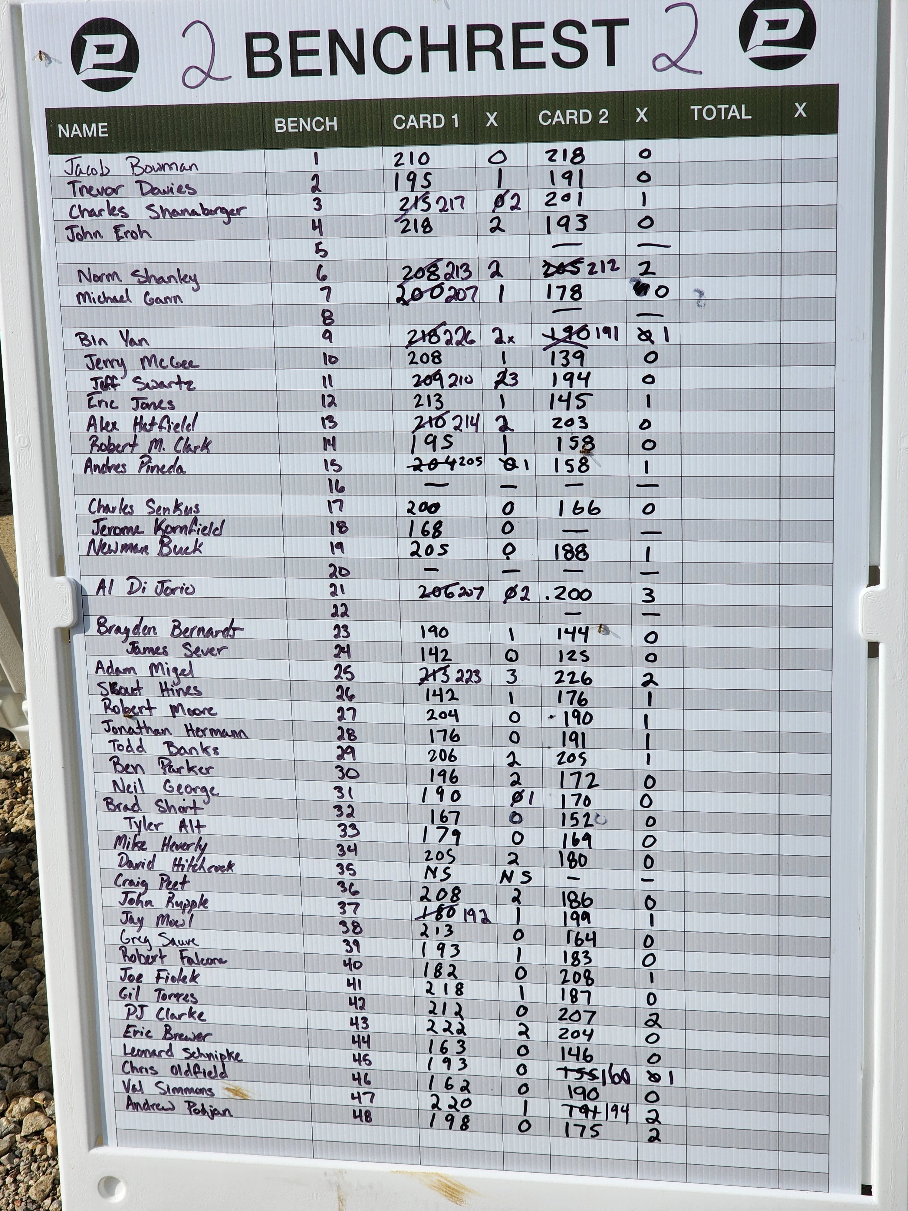

Hi Tom,
I think he was shooting on bench 31 in Relay 2 and he might not of shot a high enough aggregate score in qualifiers to make it into the finals on Saturday.
Hi Tom,
Thanks Tim.
Can’t draw any conclusions from his scores, and I don’t know the background. Lots of variables.
I would have hoped any other Paradigm .30 caliber at PAC would have placed in a higher score position, given the potential.
I am tracking CLOSELY the Paradigm at these 100 yard bench rest events.
I am not convinced it’s a 100 yard competition Benchrest gun.
