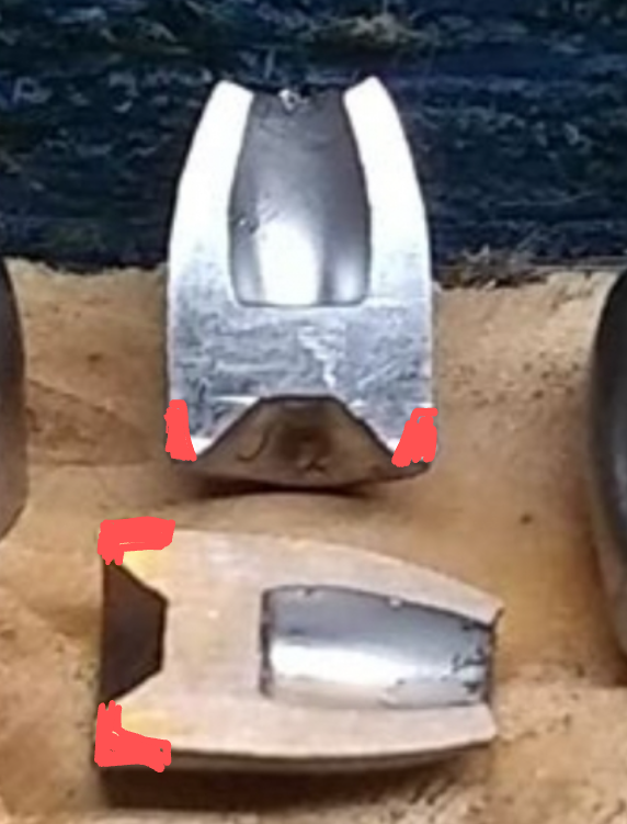

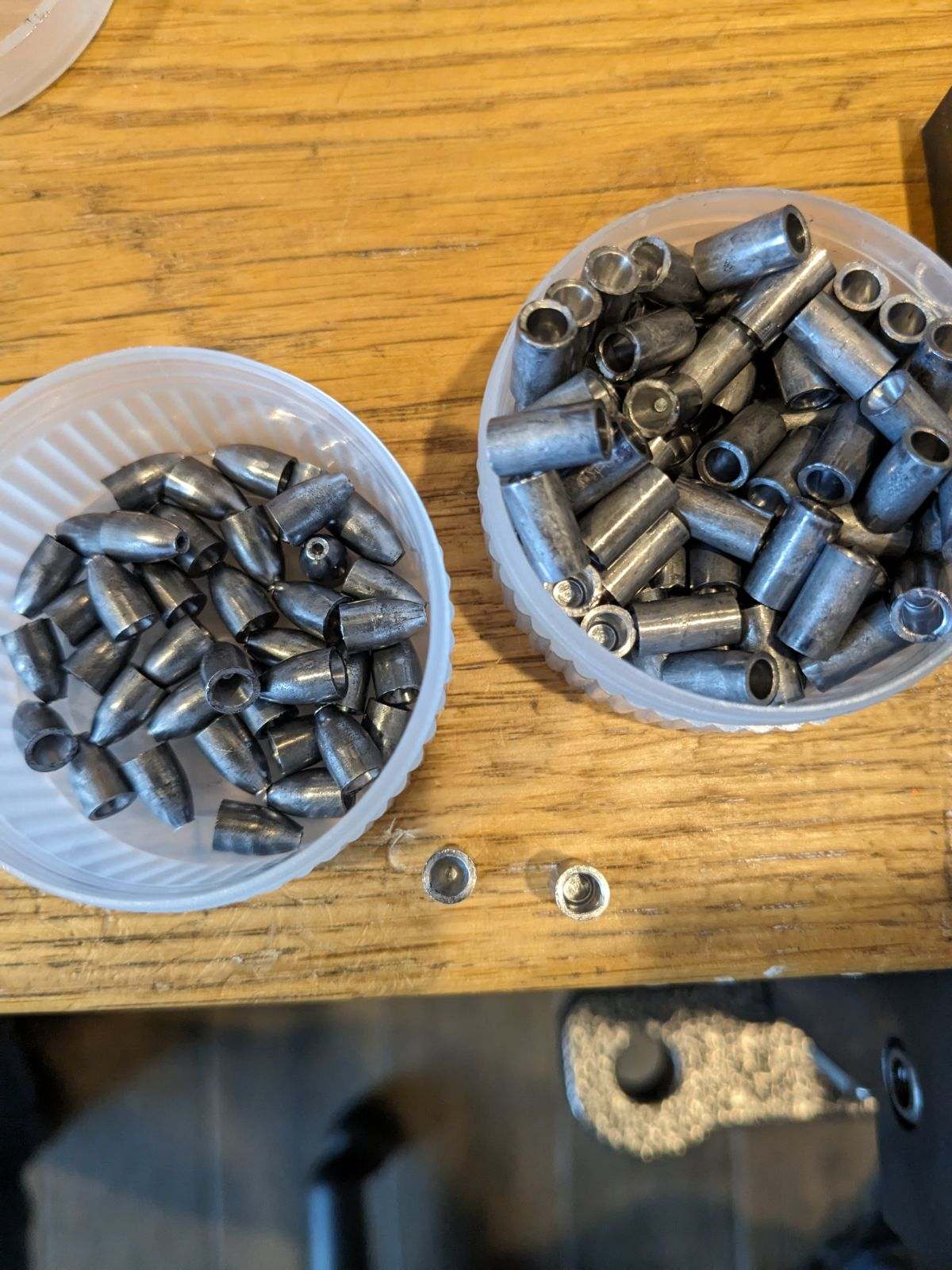

@woogie_man As many know and other's will come to find out, the original Evol's are awesome pellet rifles. They were designed to shoot pellets extremely well. I've been down the slug rabbit hole with these guns for thousands of rounds, and have also been told by Tom that slugs will work if they are short and similar in weight to pellets. The short light slugs group/shoot well in my .30 caliber Evol.
That said, the barrel and rifling (in pellet rifles in general) may be "tricked" into spinning up a slug to stability for long range shooting (over apogee where it matters) with a short shanked slug like the rebated boat tail. The FX Hybrids a lot of times will work in pellet barrels because of their unconventional and hollow design. The Hybrids' hollow design puts centrifugal force and center of gravity towards the outside and back a little, so even slow twist rate barrels works in the slug's favor, (and because they are of similar weight as common pellets).
So... a combination of a hollowed slug with a short shanked rebated boat tail should be the hot ticket to accuracy.

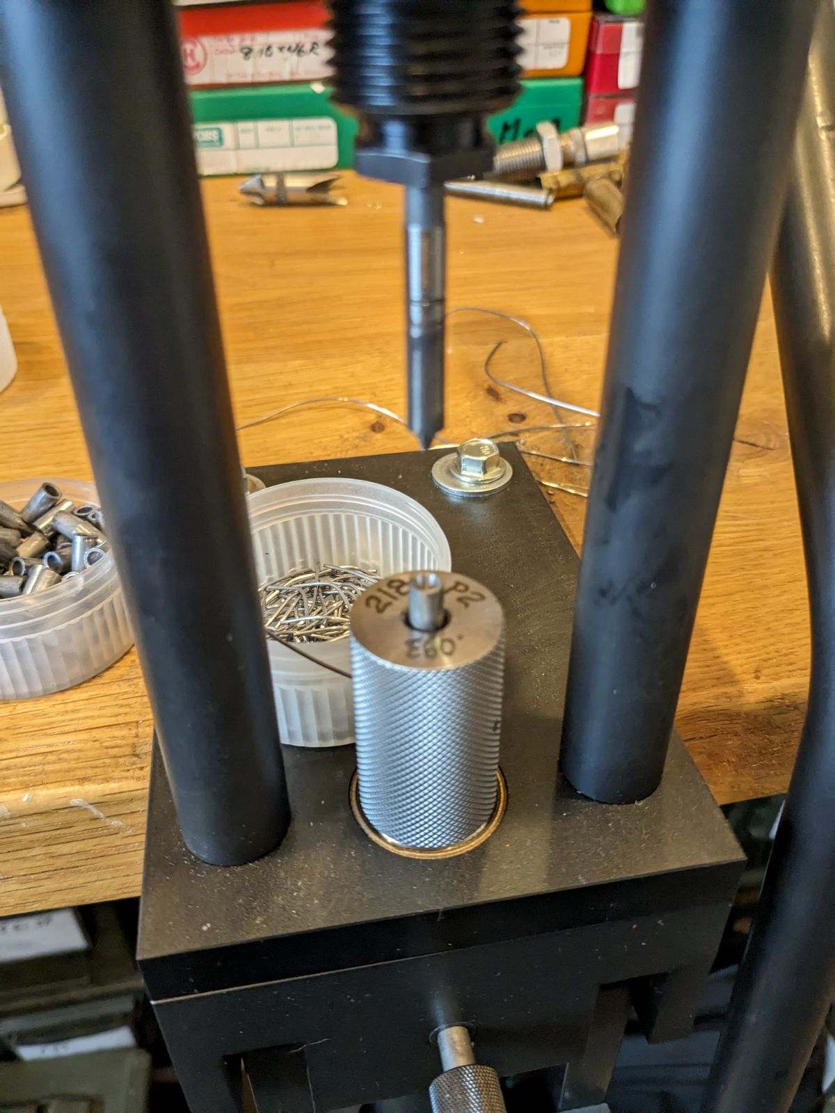

@woogie_man, does that Corbin die set have a rebated boat tail base to try? Here's my example of a modified hollow hybrid slug with a rebated boat tail base
