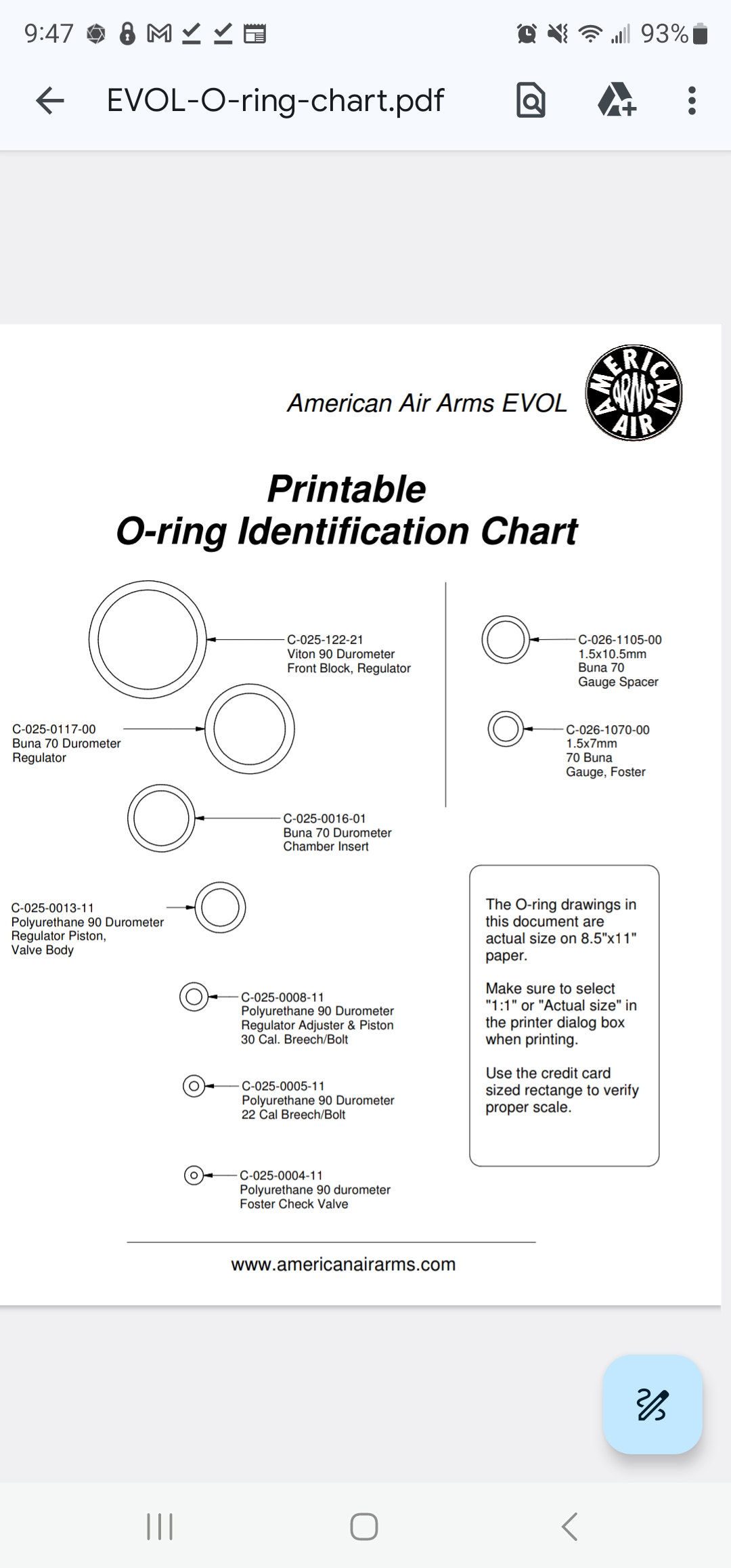

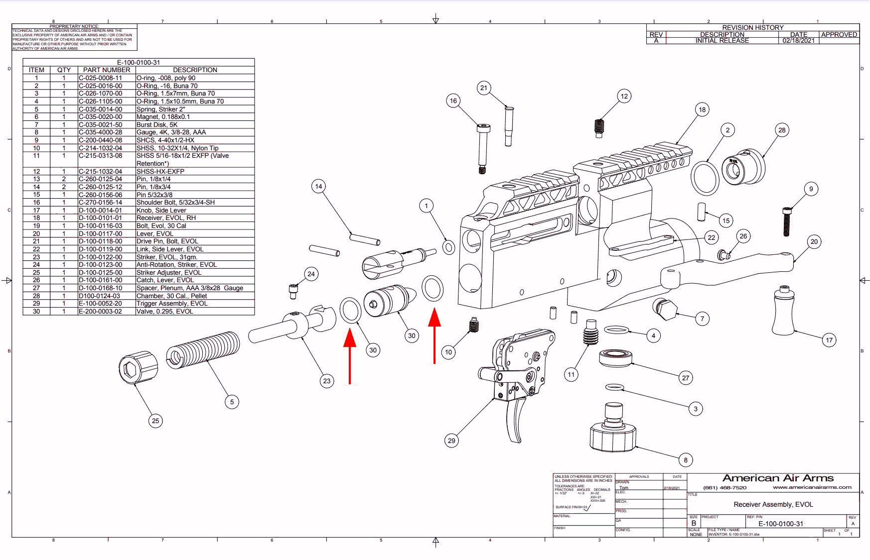

How does one go about replacing the probe o-ring? Also, I need the nomenclature of the 2 o-rings with arrows. THX
It is not an o-ring that fails under normal conditions. Why do you want to change it out? Best to use a hard plastic and carefully work it under the edge to pop it off. Alternatively, you can use a piece of dental floss like a bow saw and cut it without hurting the metal probe.

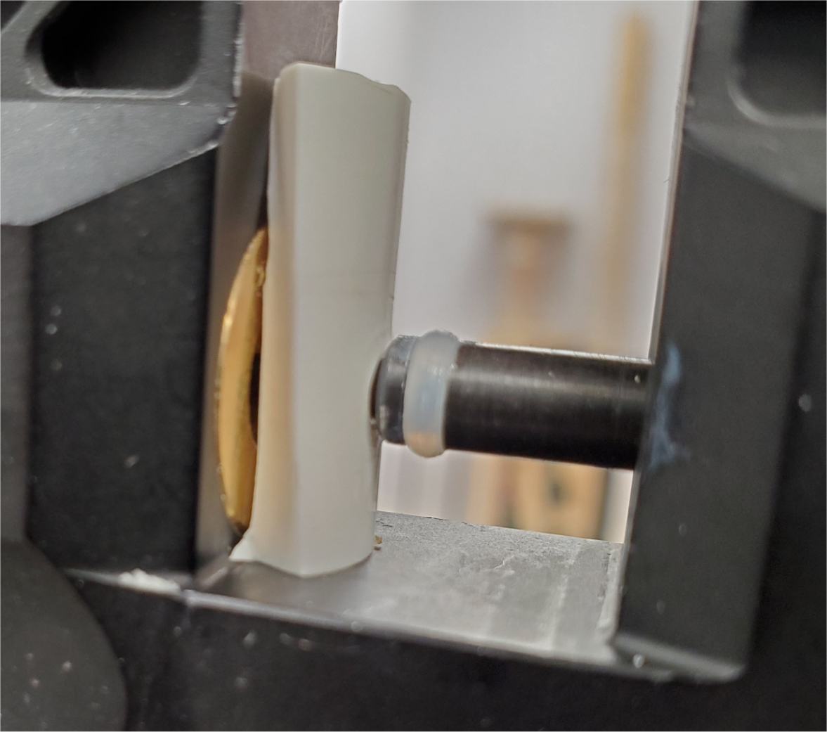

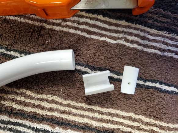

Changing the probe o-ring on a EVOL .22 ...
The tubing I used is 3/8in ID x 5/8in OD tubing for water cooled PC builds. Other tubing would certainly work or possibly even a piece of 1/4in thick wood. The piece I cut out is 7/8in x 1/2in, but 1 1/2in x 3/4in would be easier to handle. Lube the face of the probe shoulder that the o-ring has to go over. Slide the new o-ring onto the probe and line up the probe with hole you drilled in the tubing and with the convex side of the tubing towards the probe. Push the probe forward until the o-ring goes over the shoulder and seats in the groove. Once you have all the pieces in place it only takes a couple of seconds to place the o-ring.
I wasn't getting anywhere with floss in trying to remove the old o-ring, so I resorted to an X-ACTO knife. I cut part way through the o-ring and then used a blunt tipped dental tool to pop it off.
New test o-ring fully on the probe shoulder. If the old o-ring wasn't there another push on the cocking lever would seat the o-ring. I used 2 new o-rings in testing

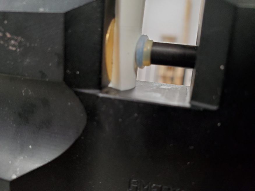

This is a new o-ring that wasn't used for any testing. Test fires were fine, the seal is good. A bit of cleaning up and I'm done. I am now down to only 37 probe o-rings. :)
Thanks to @Airgun-hobbyist for assistance in ways as to how to get this tough little 90 Duro o-ring onto the probe. A combination of one of his ideas and my use of a section of PC waterline tubing and sufficient lube did the trick. Initially I thought I might be able to heat up the o-ring with hot water and by doing so expand it and make it more flexible, allowing it to pushed into place. Nope, the little guy wasn't cooperative at all. Then there was putting the o-ring on the probe and pushing the probe forward through the tines of a plastic fork that was against the breech. This only resulted in the needless destruction of a plastic fork and the flattening of the o-ring. I needed something both strong enough to withstand the pressure of the probe, yet flexible enough to push the o-ring over the probe's shoulder without damage. I build water cooled gaming PCs, or I used to anyway. I now only build for myself. Anyway, I have a number of pieces of leftover waterline tubing, so I thought I'd give it a try. It worked like a charm when used with some Ultimox 226 on the probe shoulder face.
