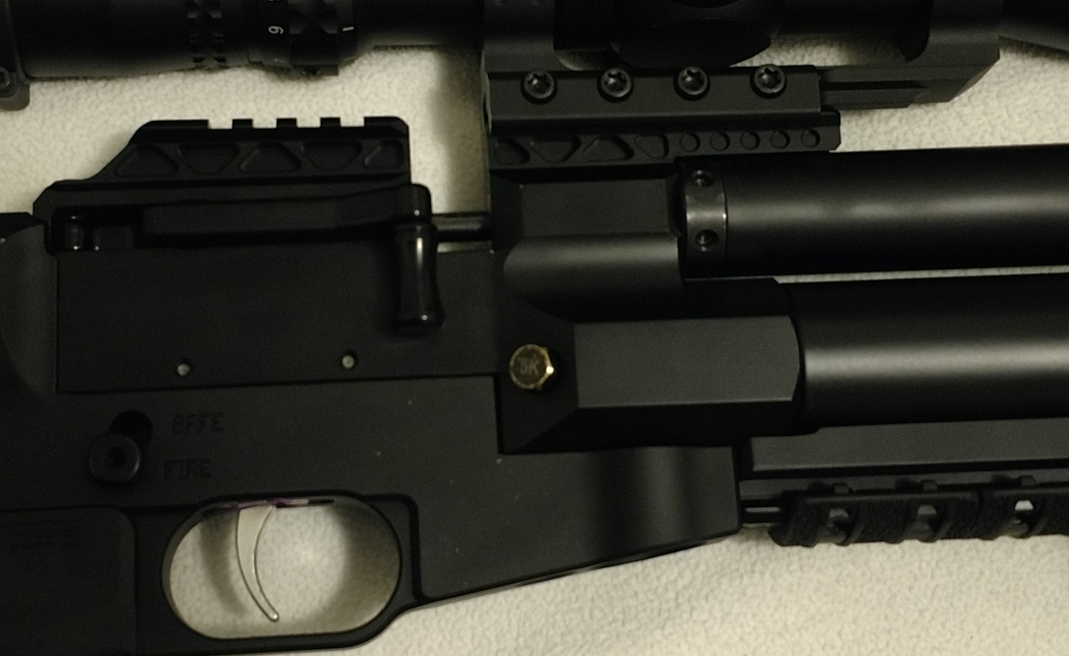

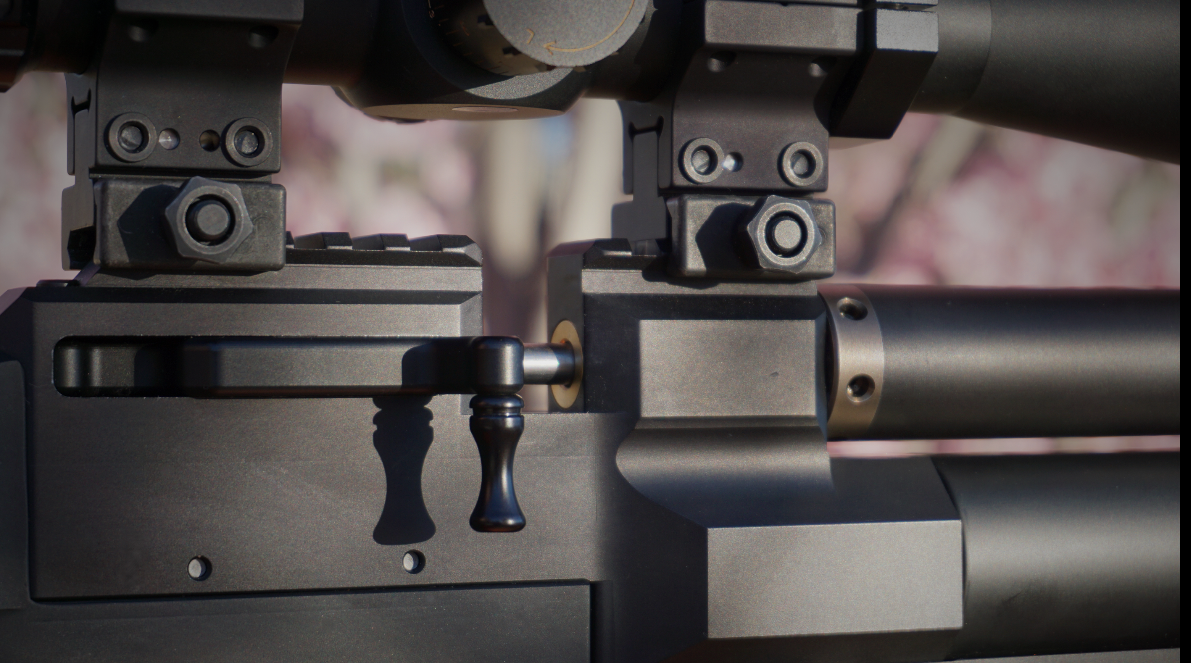

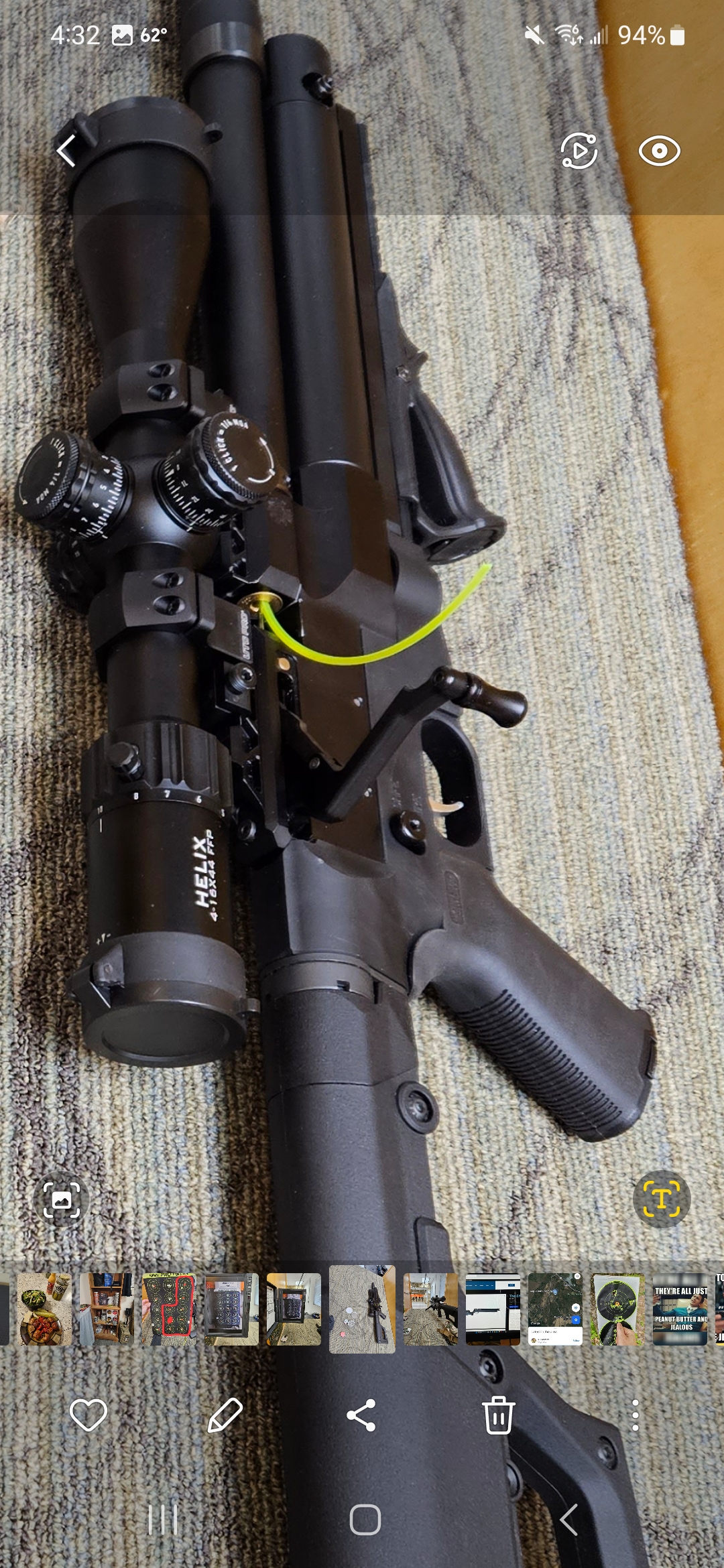

What are distinguishing features between first run evols and the later produced models?
I have seen evols with burst disc visible and then mine is not.
They are Evolving. The first version had a shorter front picatinny rail, flush with the barrel lug. The later version has an extended picatinny rail over the barrel, with burst disk on the side. The latest version has the extended picatinny rail and American Air Arms logo by the barrel lug, with the burst disk underneath the chassis. The latest are now offered with M-LOK chassis for coupling attachments.
View attachment 358189View attachment 358190
Just checked mine. Mini, Magnon, and HPS are all later versions. From what I understand the air stripper is actually different on the later models as well. This is what I was told from Kip down at AoA. I personally am running DonnyFLs on all of mine. Im really curious how much the effect the performance compared to the stripper that comes with the EvoLs. The Donnys seem to work well and it brings the bark down a good amount compared to having the stock air stripper.
Seems I read that the earliest versions of the Evol moderator were the same metal machined cone stripper versions like the Slayer has. Then I read the newer version was designed by STO, but possibly only in the .22 version. So who knows... They all work well for their intended purpose. With the newer stripper, my .30 changes tone noticably when I am running different weight slugs versus the amount of air I am waisting for speed and power with very little change in POI. It gets pretty quiet with pellets and turned down.

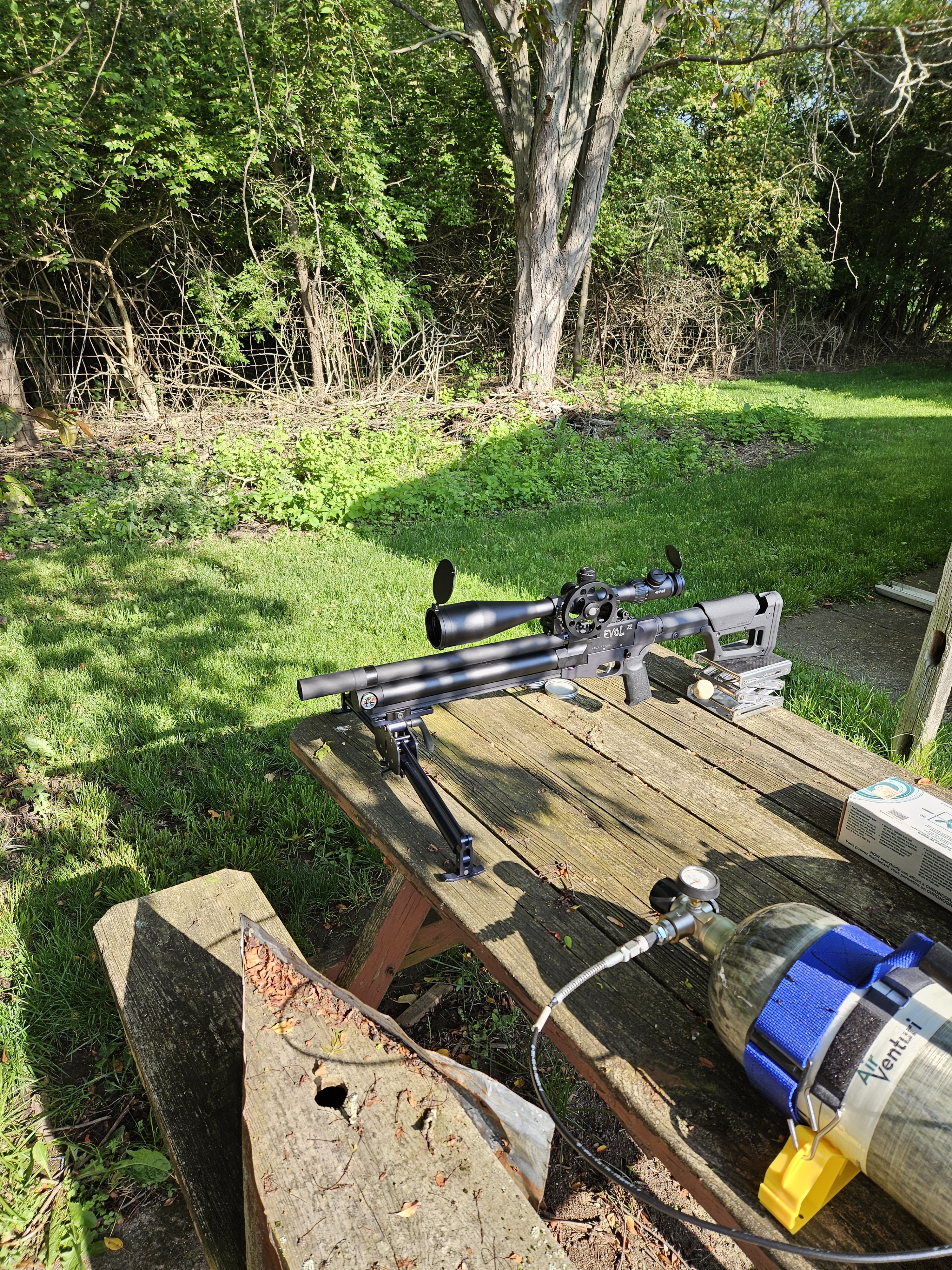

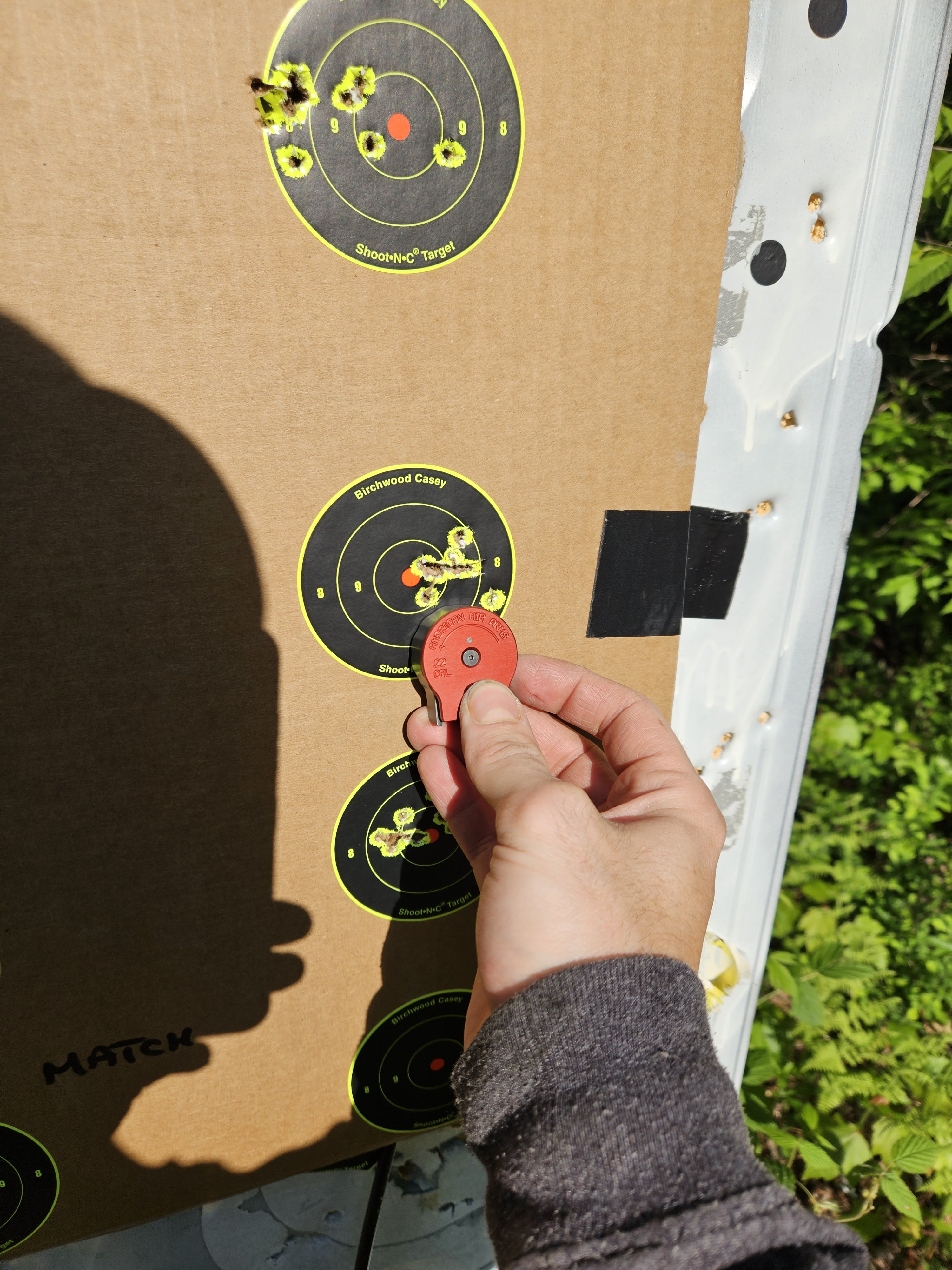

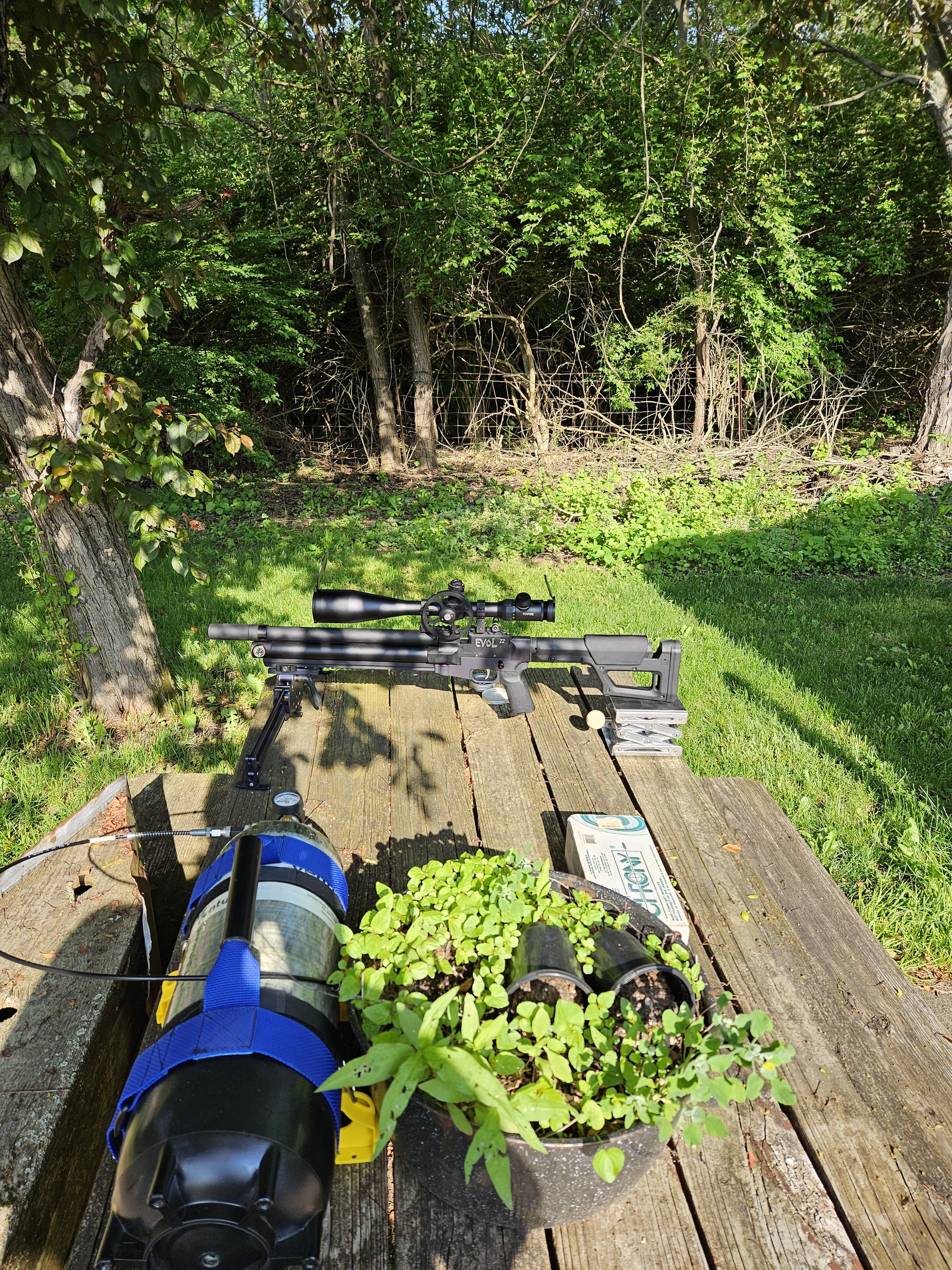

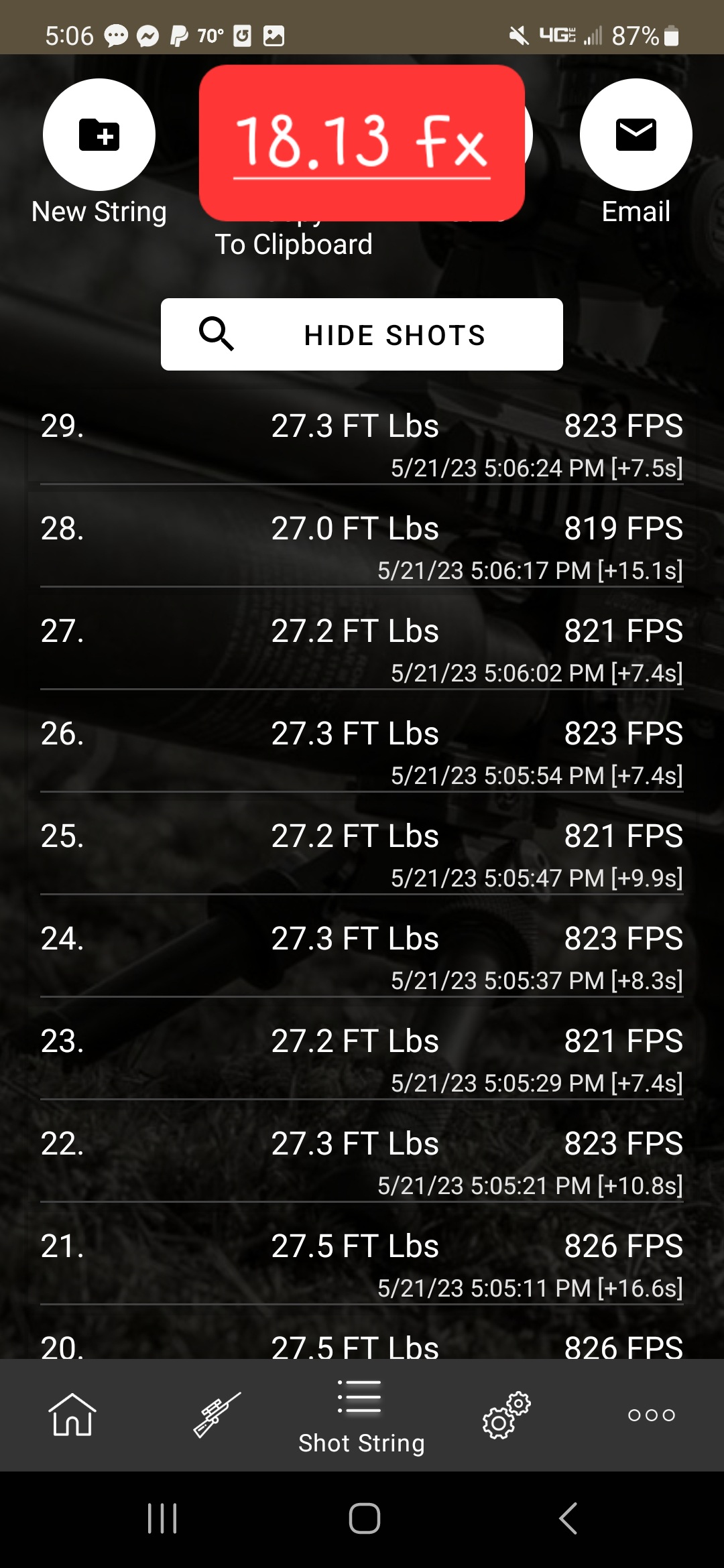

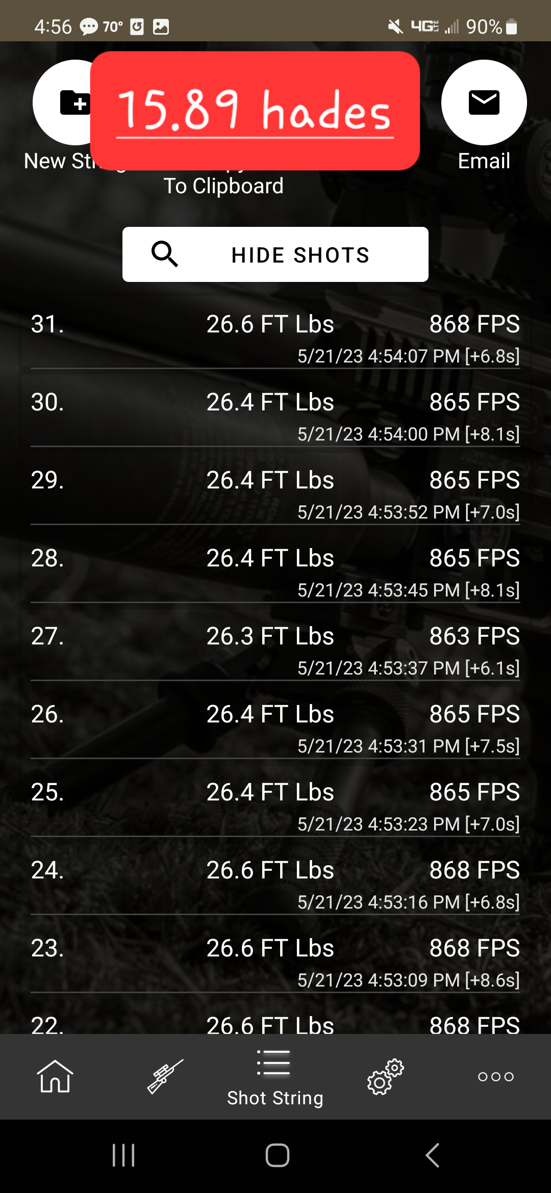

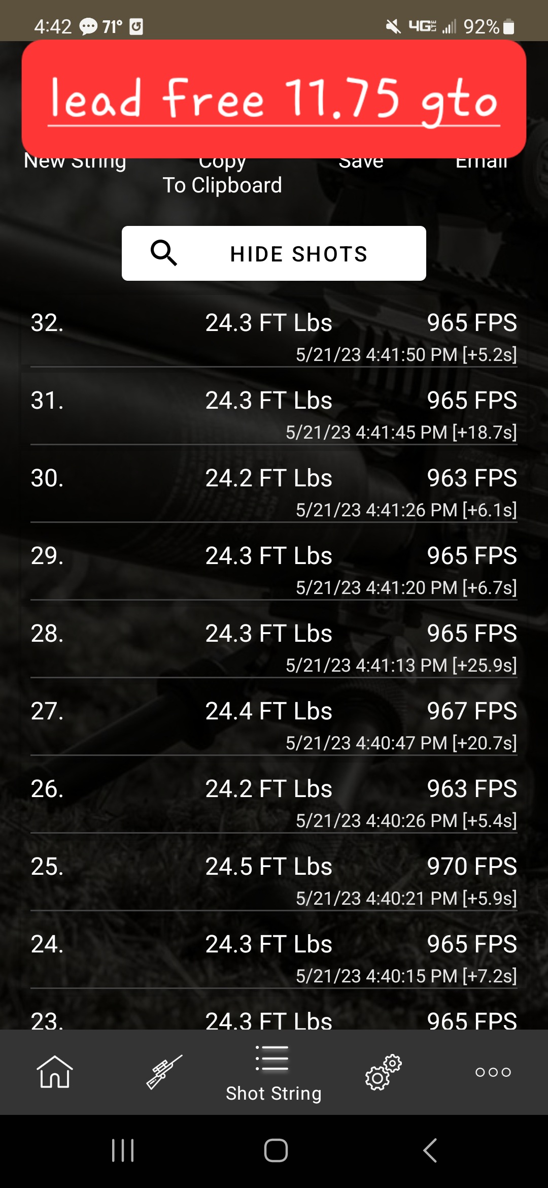

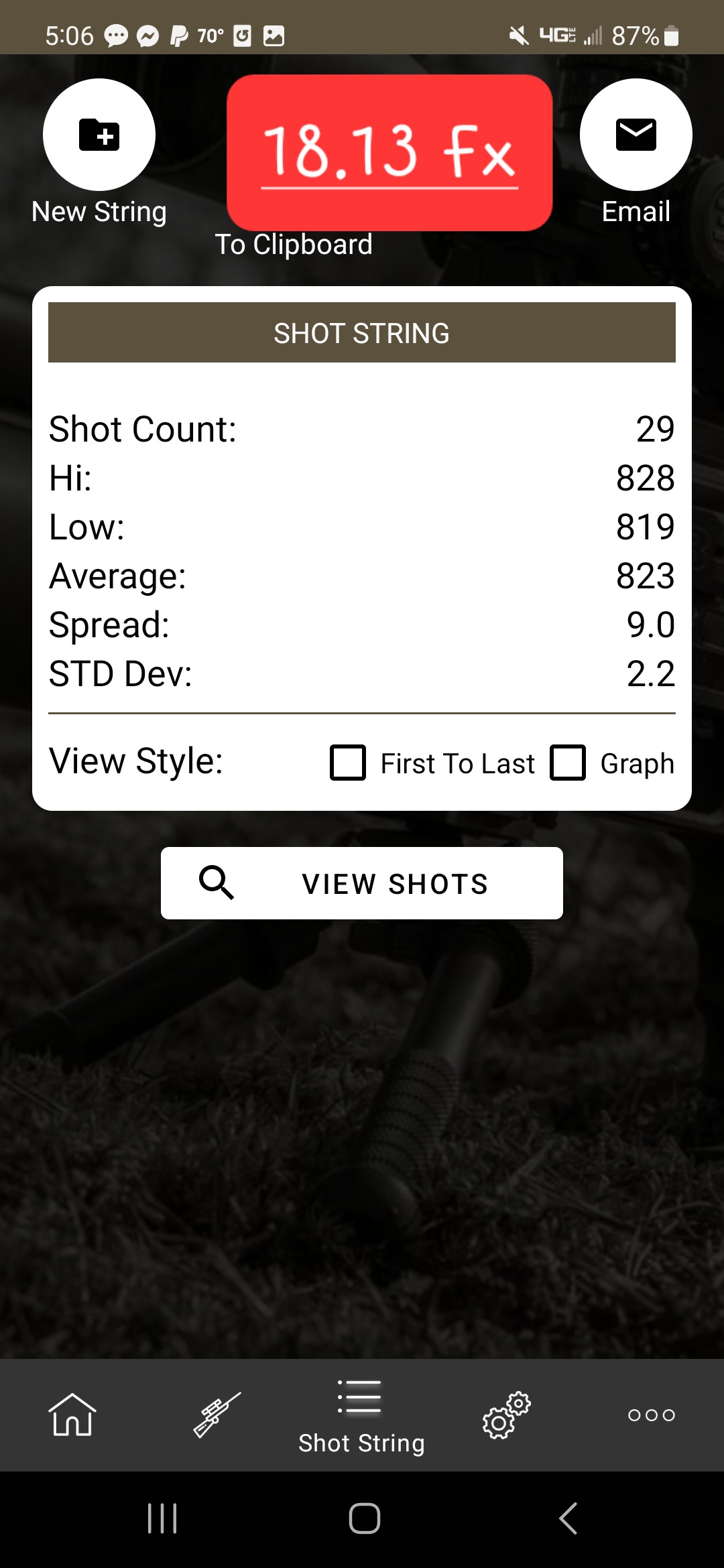

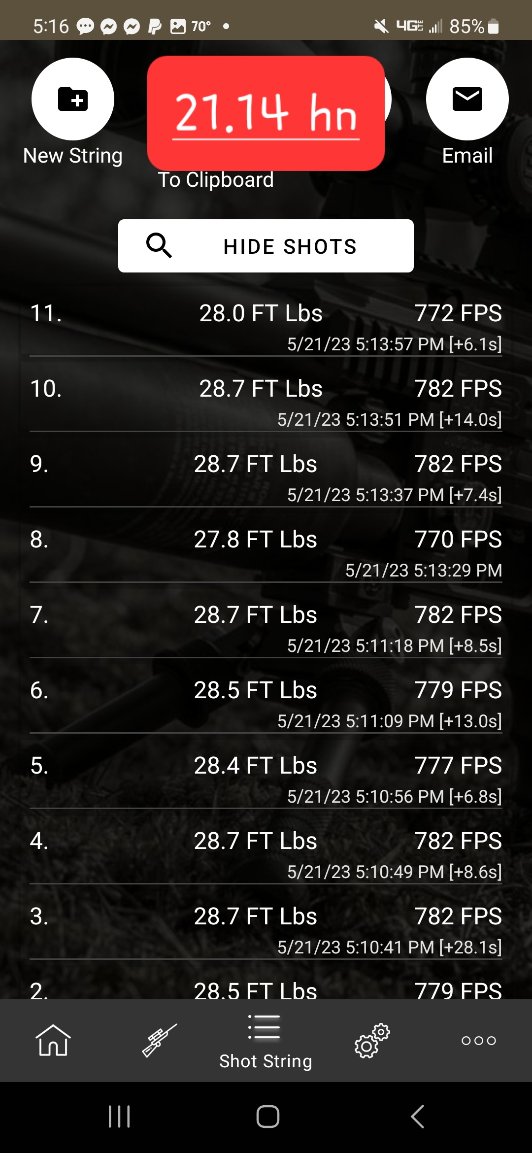

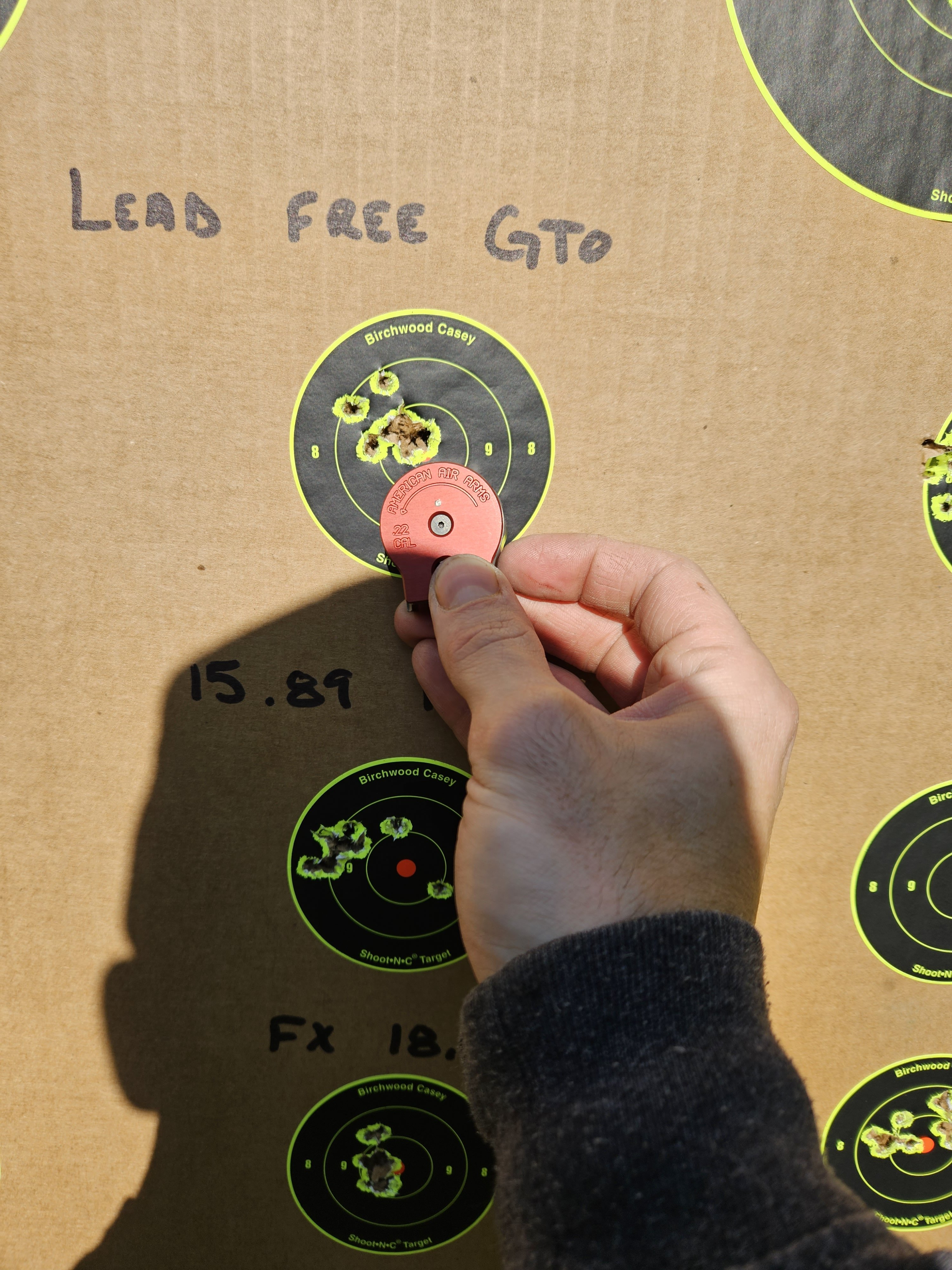

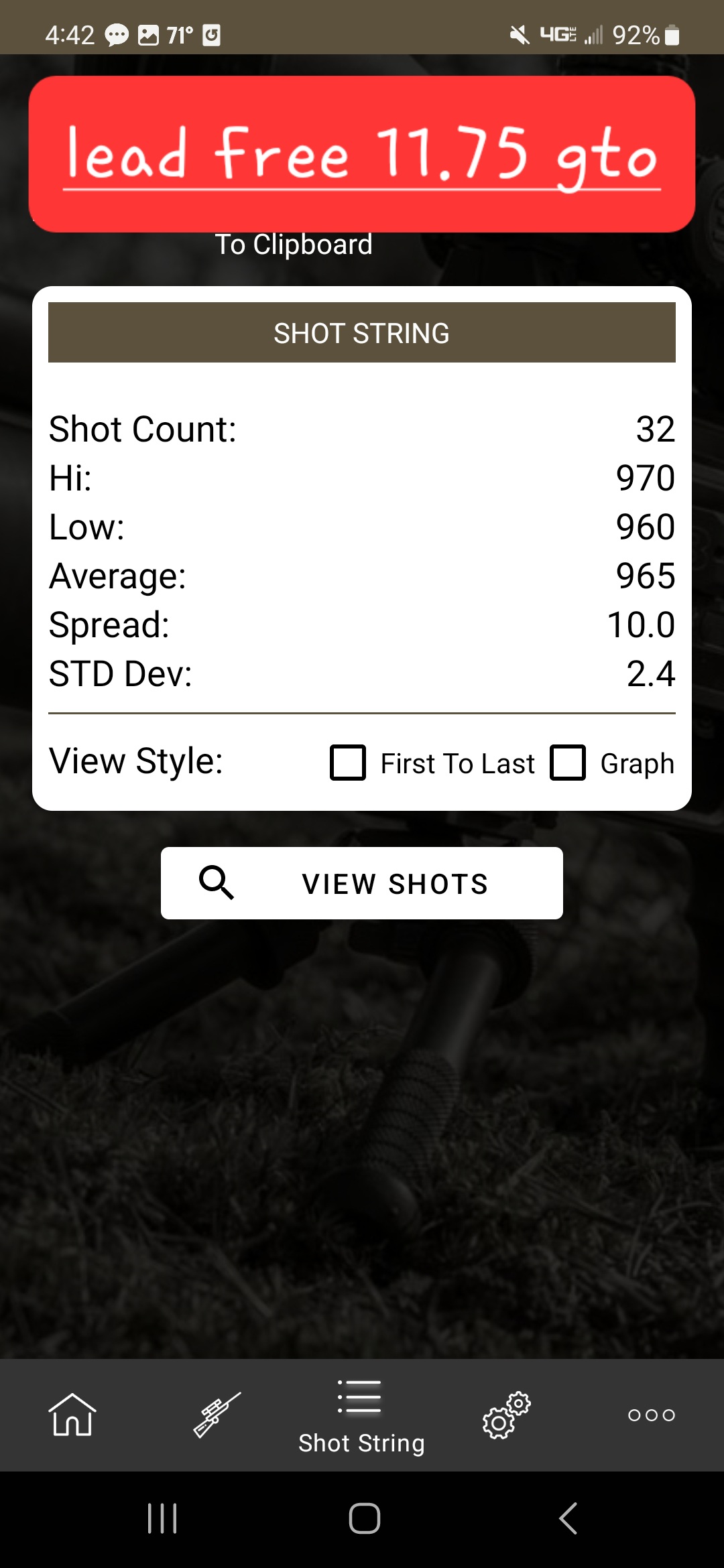

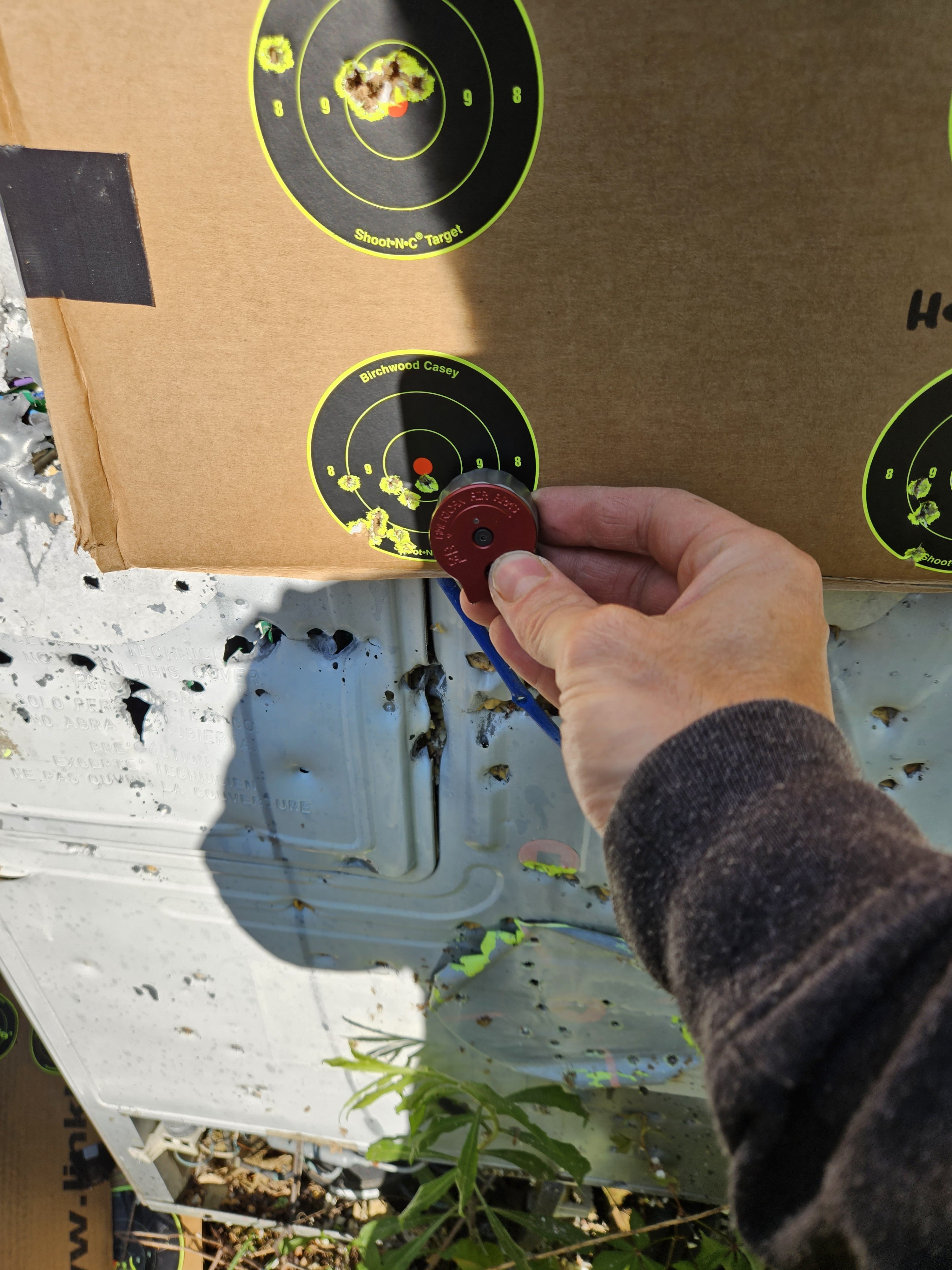

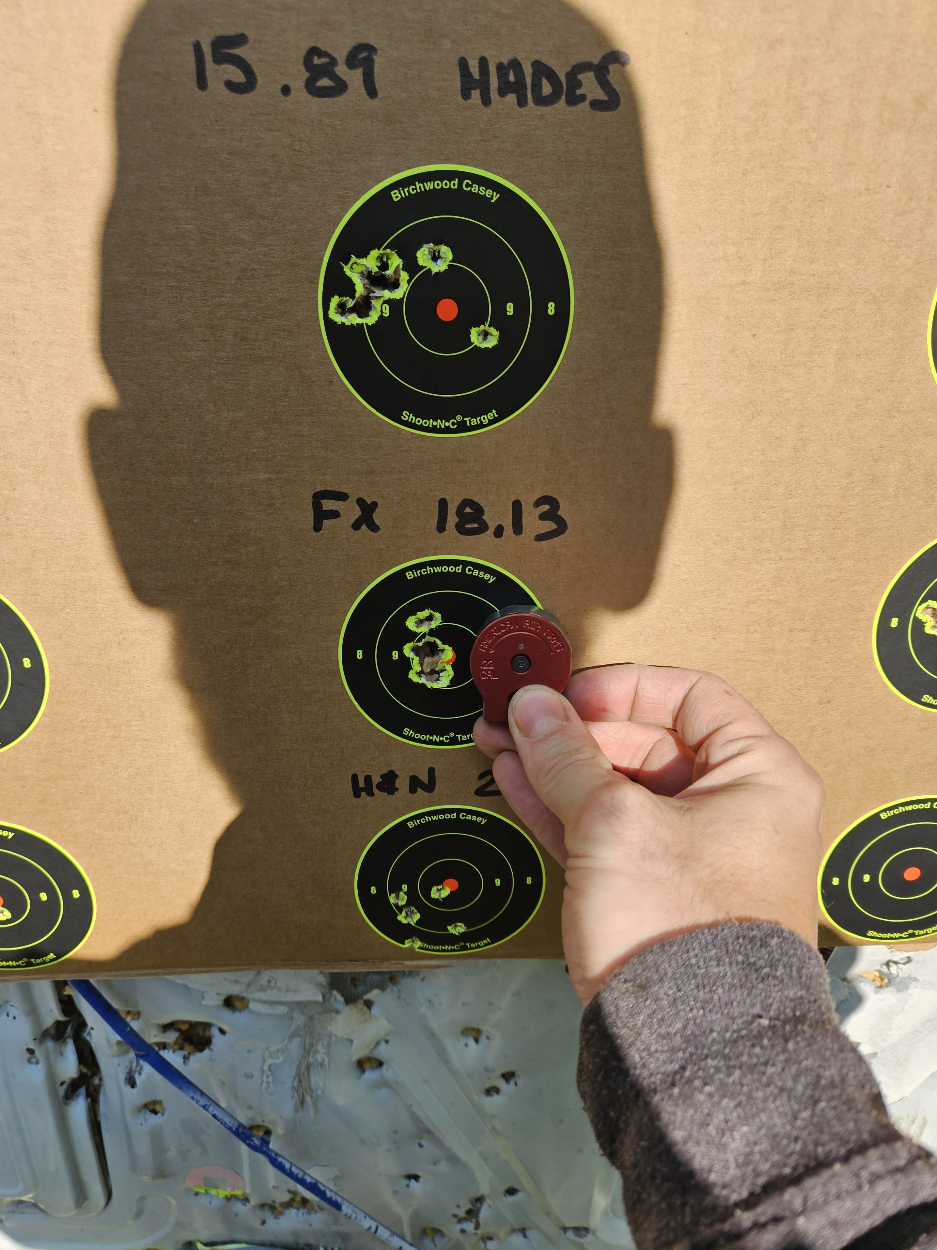

Well, horrible day for testing, 8mph steady with 15 to 17mph gusts , my lanes are home are wind tunnels in a small valley.
The two reign energy drinks today didn't help (God those are addicting) and then, the probe oring blew in the middle of the h&n tests.

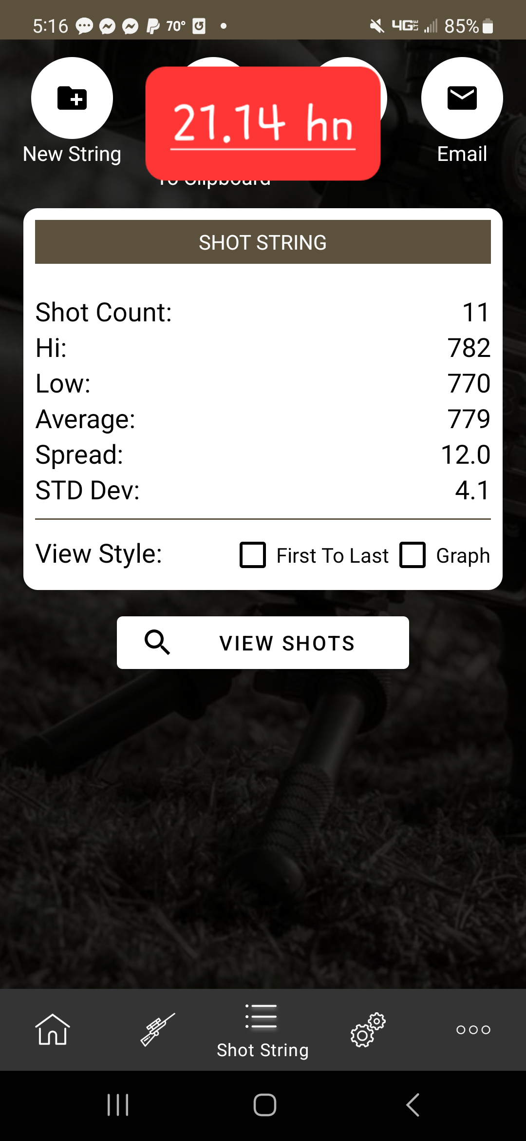

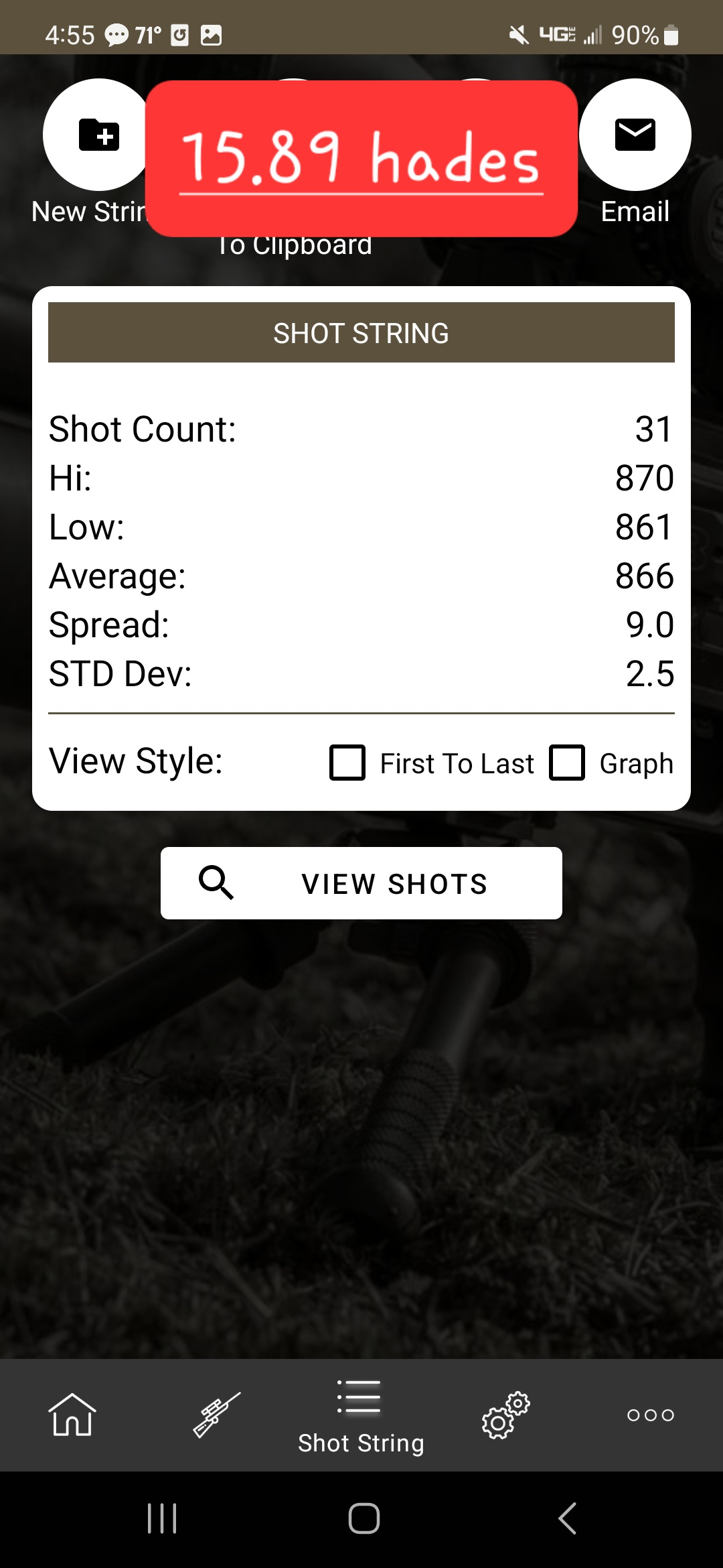

Anyways, it really didn't like the hn anyway, but it did shoot the 11.75 gto, 15.89 hades, and 18.13 fx very well on the same exact tune.
I always forgot how much wind can play a role in shot placement with such light projectiles .

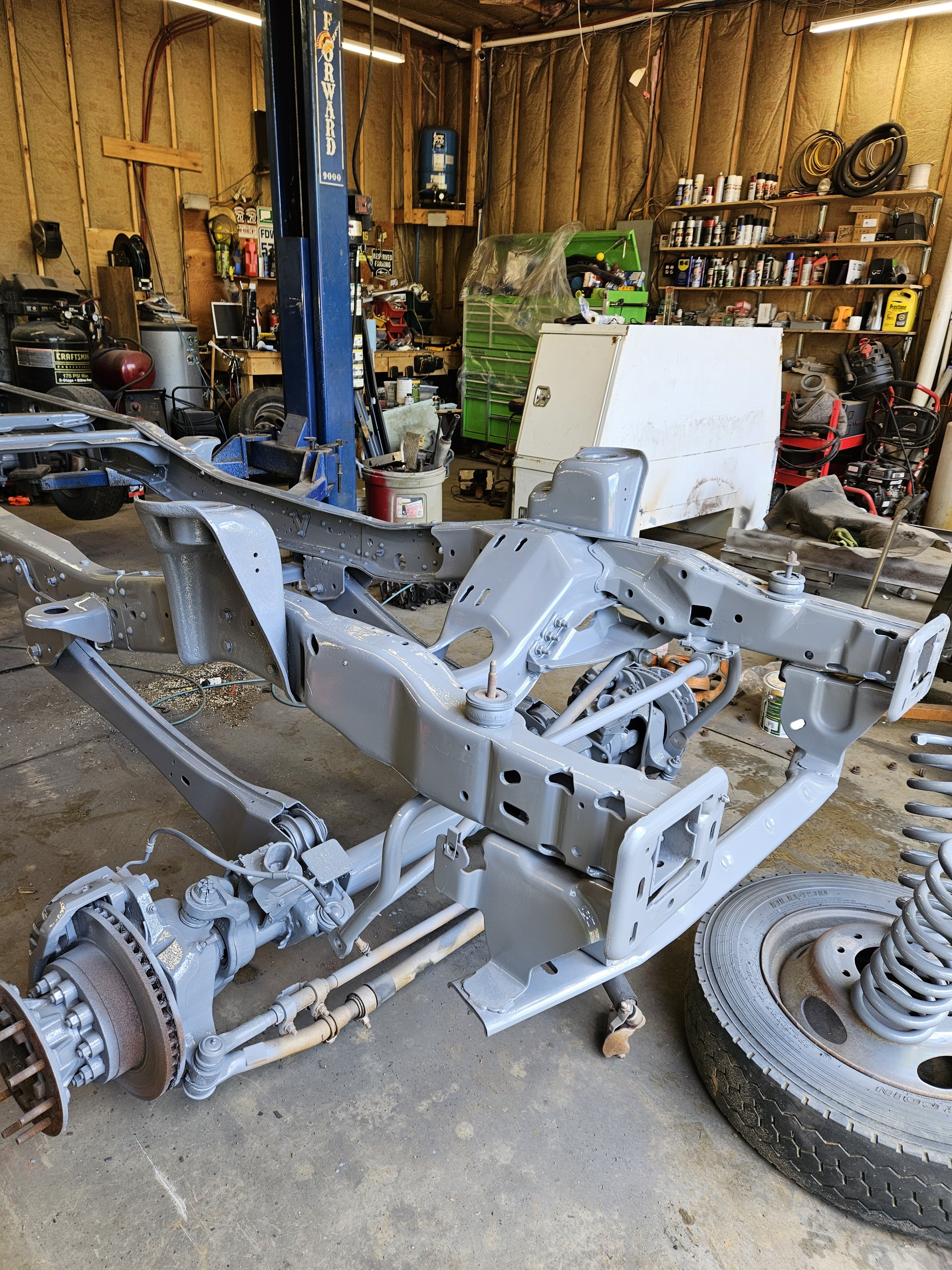

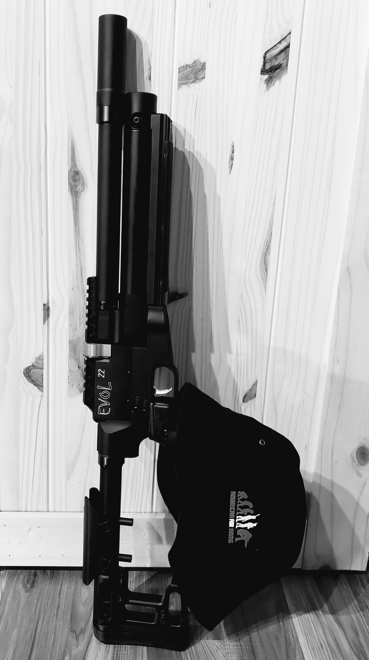

Oh last pic is a pic of the f550 frame I just got done priming moments before heading down to my range.

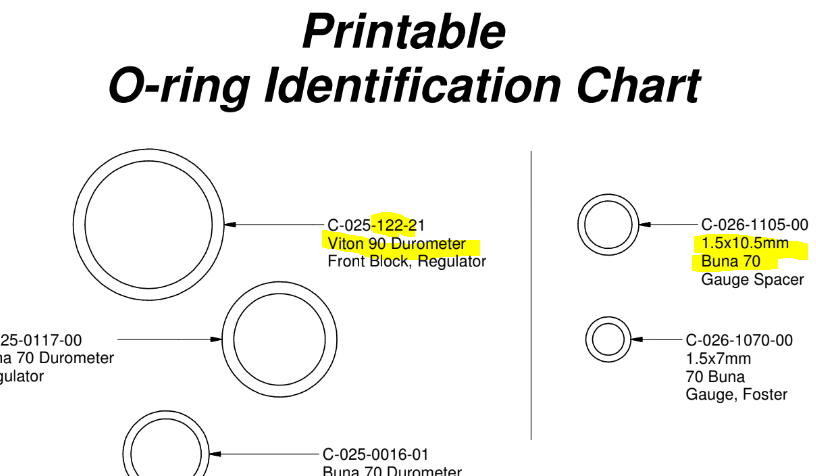

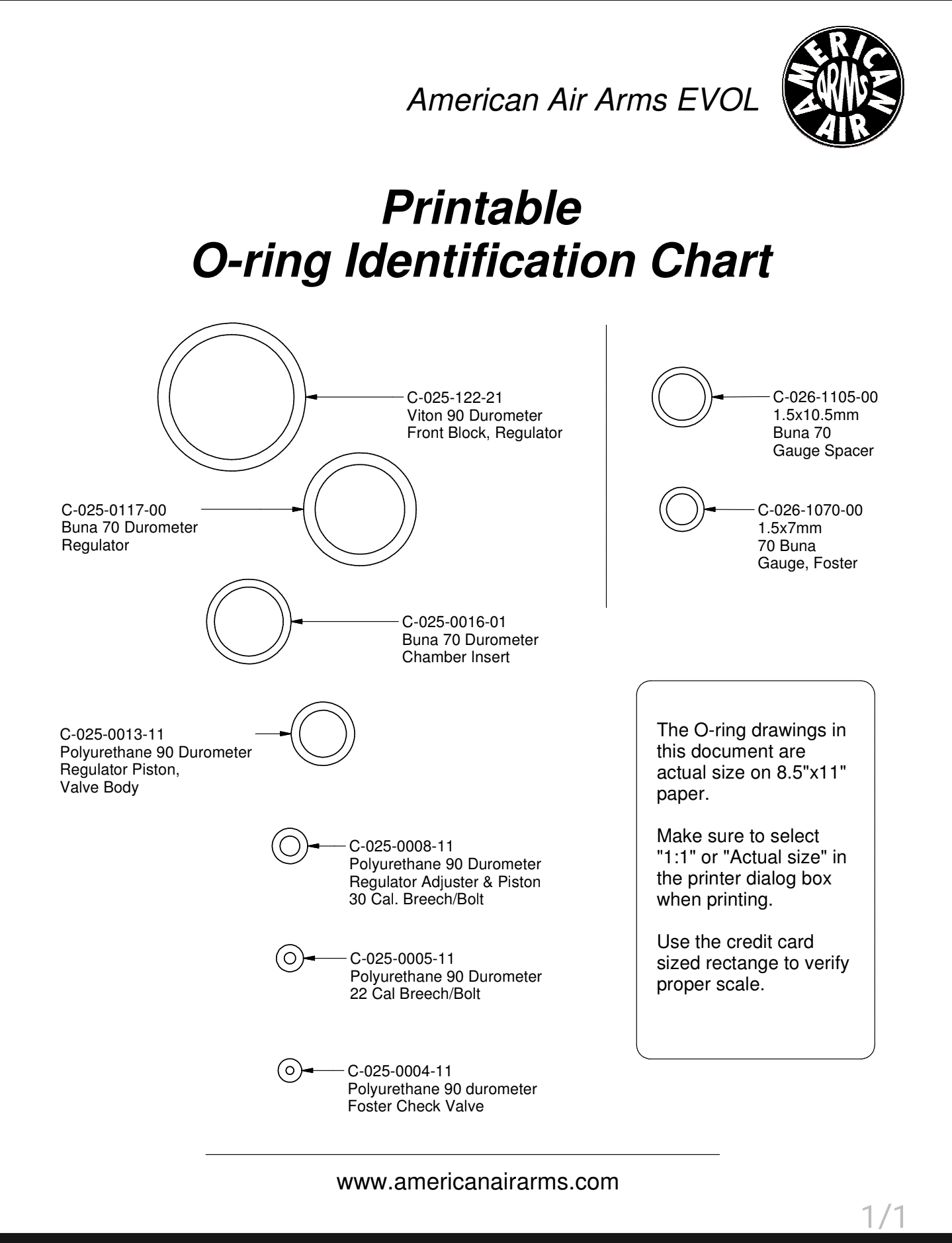

I wish we had a part number list for the orings, Captain Oring has a slayer kit but no evol kit and Id like to have a few of each on hand, looks like I am gunna go oring hunting.
AAA website has all the info. There's also a PDF o-ring chart you can print out towards the bottom to match up the sizes to scale. Click on the link below.
Reactions: Elbowgrease
I ran them all over google , maybe im a dumbass but those numbers on the breakdown don't jive with anything I have searched.
That ID chart is more for matching the o rings up by eyeball.
If you examine the detailed schematics of the sub assemblies on the AAA site, all the o rings are called out by size.
O-rings on the left side are are standard Dash Numbers so you can use the middle set of numbers and material to identify. O-rings on the right side are metric. There are no real standards in metric o-rings other than they are called out by their cross section, inner diameter and material.
Thanks you for the info Tom, very helpful!

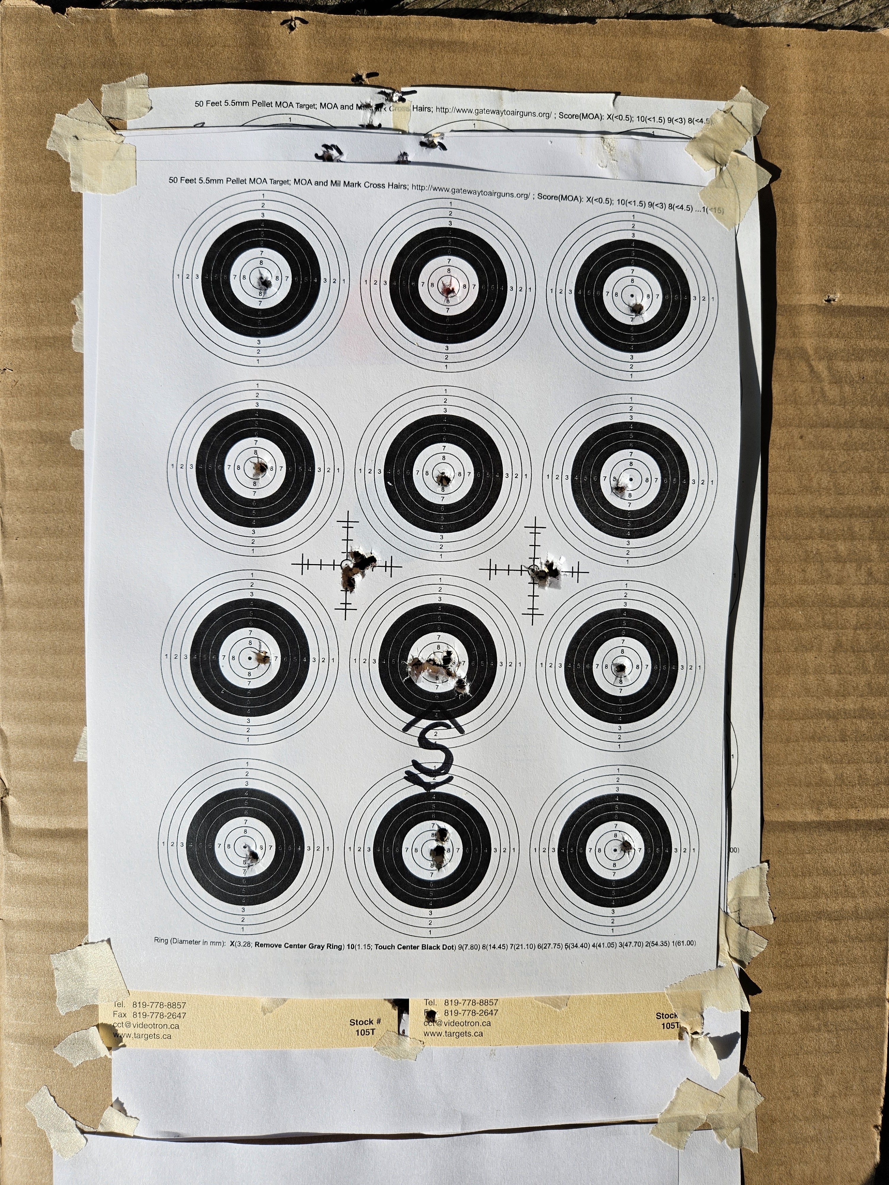

Spent some time with my 15" .22 this AM.
Basically just verifying everything in anticipation of an N50 match this coming weekend.
Wind was light and variable at 3-5 mph, and I was twitching about like a palsied meth head.
I was OK with it at 50 yards, but the wind on Saturday will likely foil all of my plans......
10 record shots that would have scored 10s an an official target maybe.
