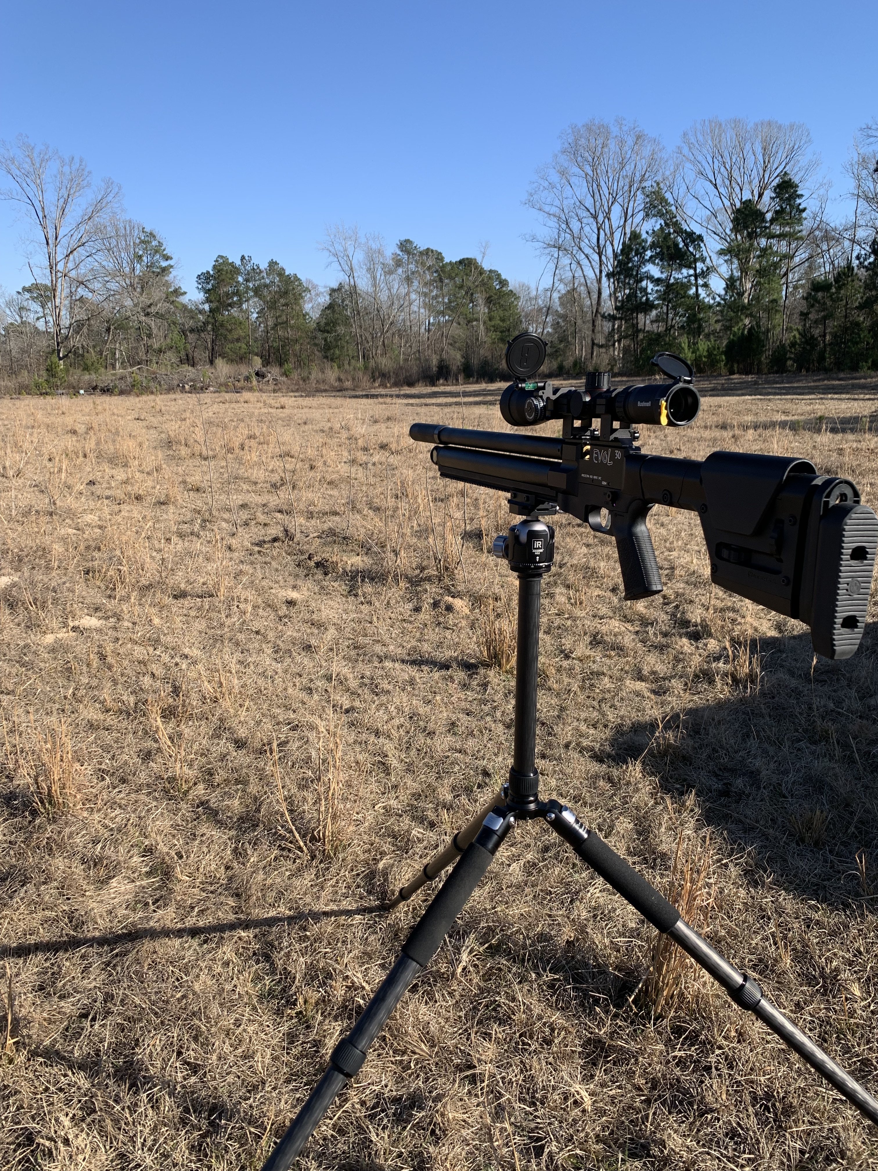

Here's my Evol .30 set up to shoot at 100 yards off of a tripod.

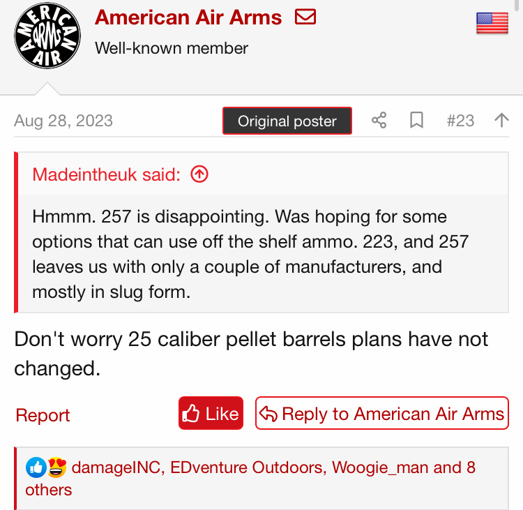

Please tell me that there is a .25 in the new line up?

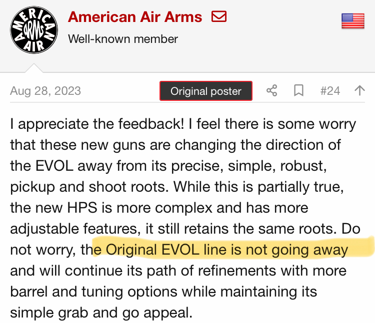

See pic. Original thread is about the new HPS line
Not sure I’m reading it right but does anyone know if the non-hps models will go back into production? I wouldn’t mind buying an original mini.
@RicL What I gather from the above pictured post is that he is going to continue to refine/improve upon the original Evol line. In short, yes it appears AAA will continue to produce the original Evol but with more accessory/customization options.
