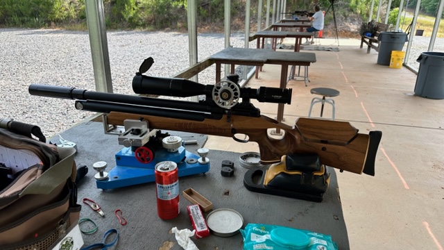

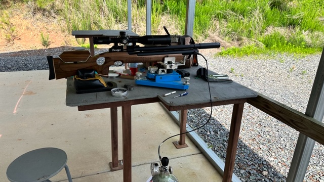

I went to my local outdoor range today to Chrony my new EVOL .30 Paradigm for the first time. Perfect!
At range - first Chrony run
Paradigm at 50 yards
JSB 44.75g
Shot count: 8
Low: 870
Hi: 881
Avg: 876
Spread: 11
STD Dev: 4.0
870
881
877
879
875
872
872
879
Then I wanted to shoot some 50Y groups with JSB 44.75g. Wind was a bit breezy at 3-6mph, with a strong head wind. Shot 8 (5) shot groups at 50 yards for a CTC average of .67" CTC. I do believe on a quiet wind day, I could have had sub-MOA with the same situation. Also, shot (2) N50 cards. One was terrible, but one was pretty good. Shot a 215 ( worst ever N50 card ) and a 237. The 237 card had two bad bulls, which I circled. #16 and #3 bulls were me missing the wind call, I think. Had I shot two (9)'s instead, I would have broken into the low 240's. Next time..
Just a side note for the 'bench rest junkies.' I have used a good Accu-Tac bi-Pod from the bench, but the Randolph front rest is perfect for the flat fore end stock on the Paradigm. Very stable, and I can't detect much recoil. Also had a Sumo .30 caliber suppressor on the end, and it is very quiet.
At some point, I may pick up a FALX high flow STO moderator, but not really needed since this is BR only for me.

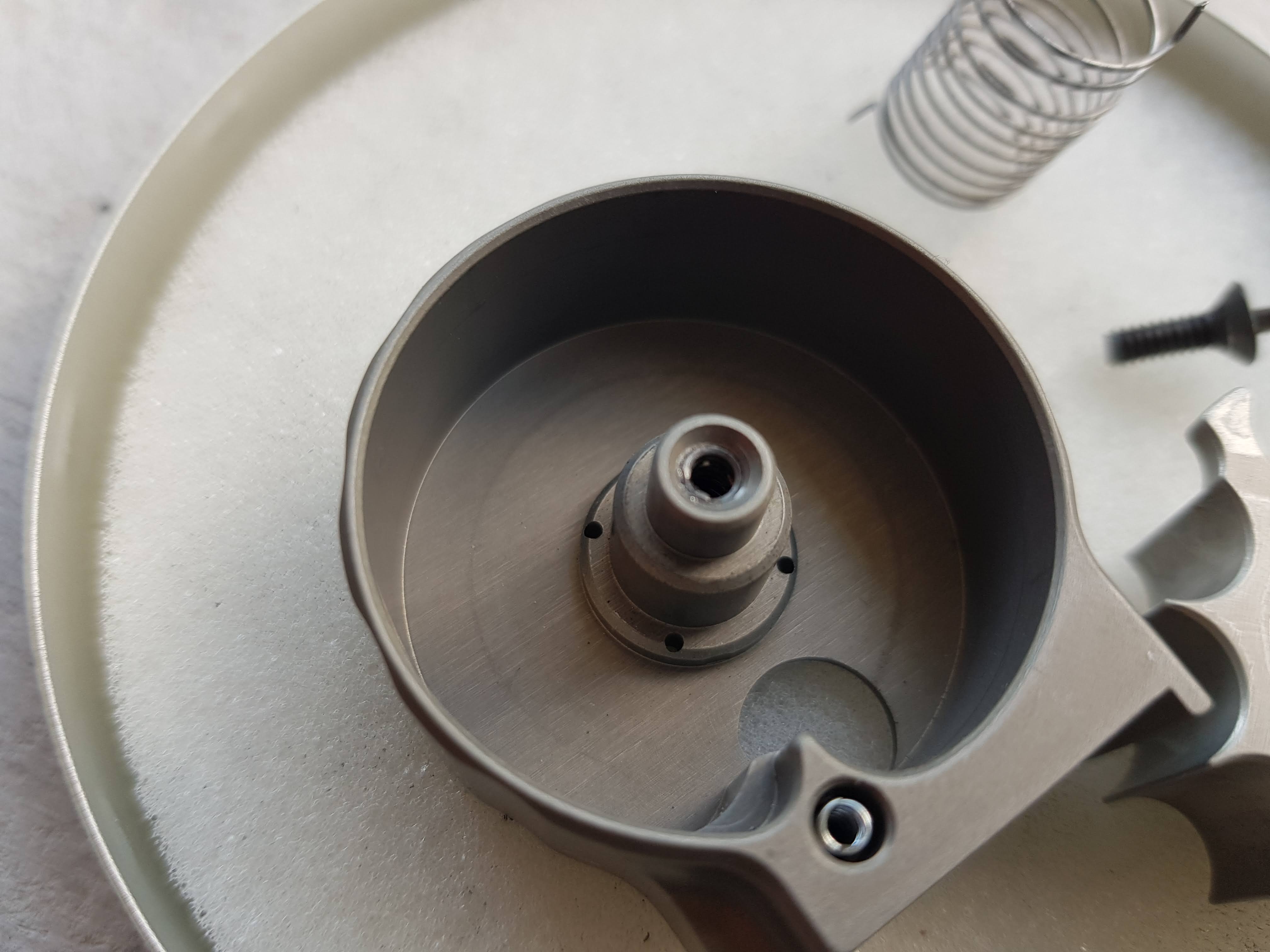

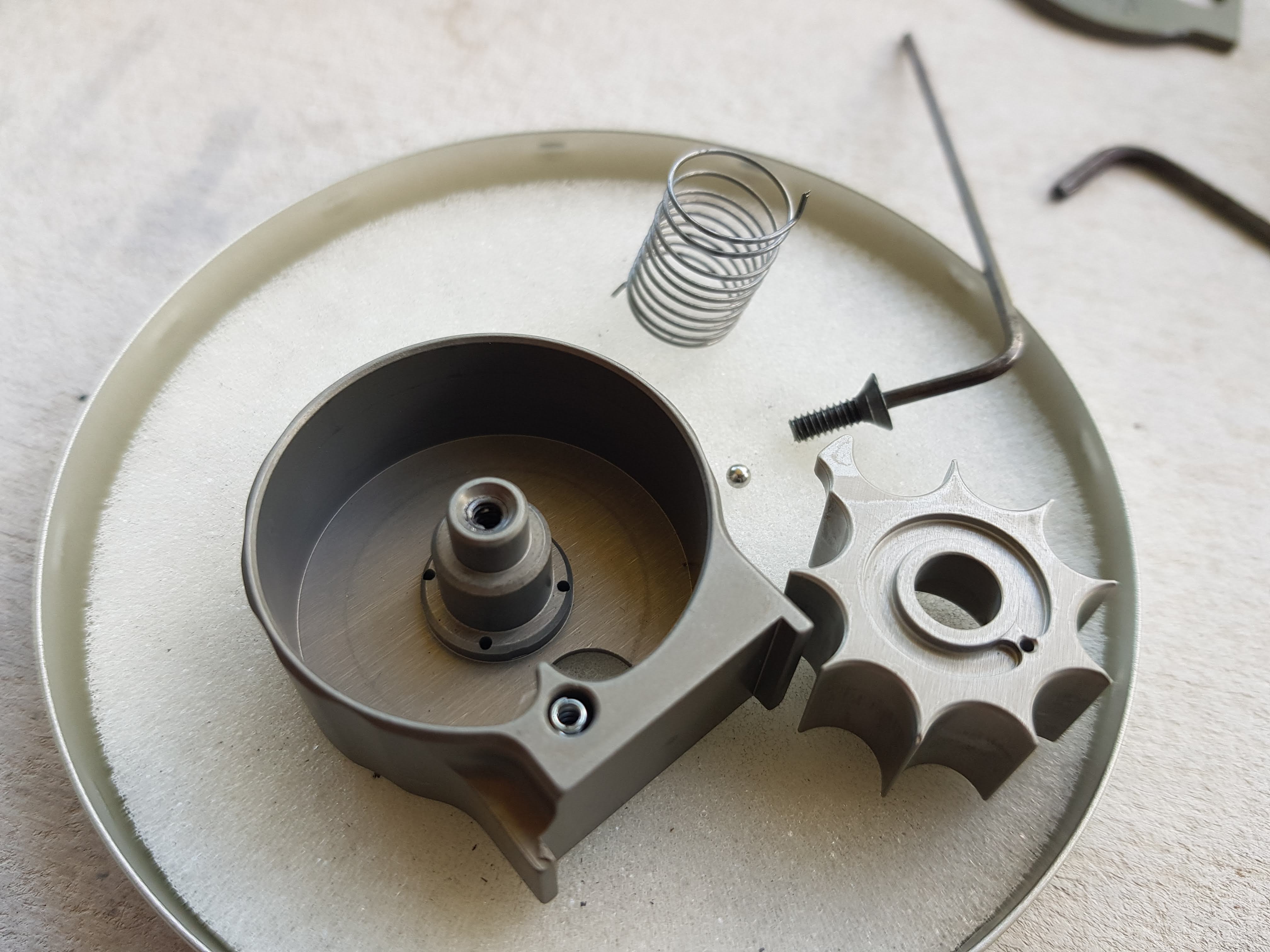

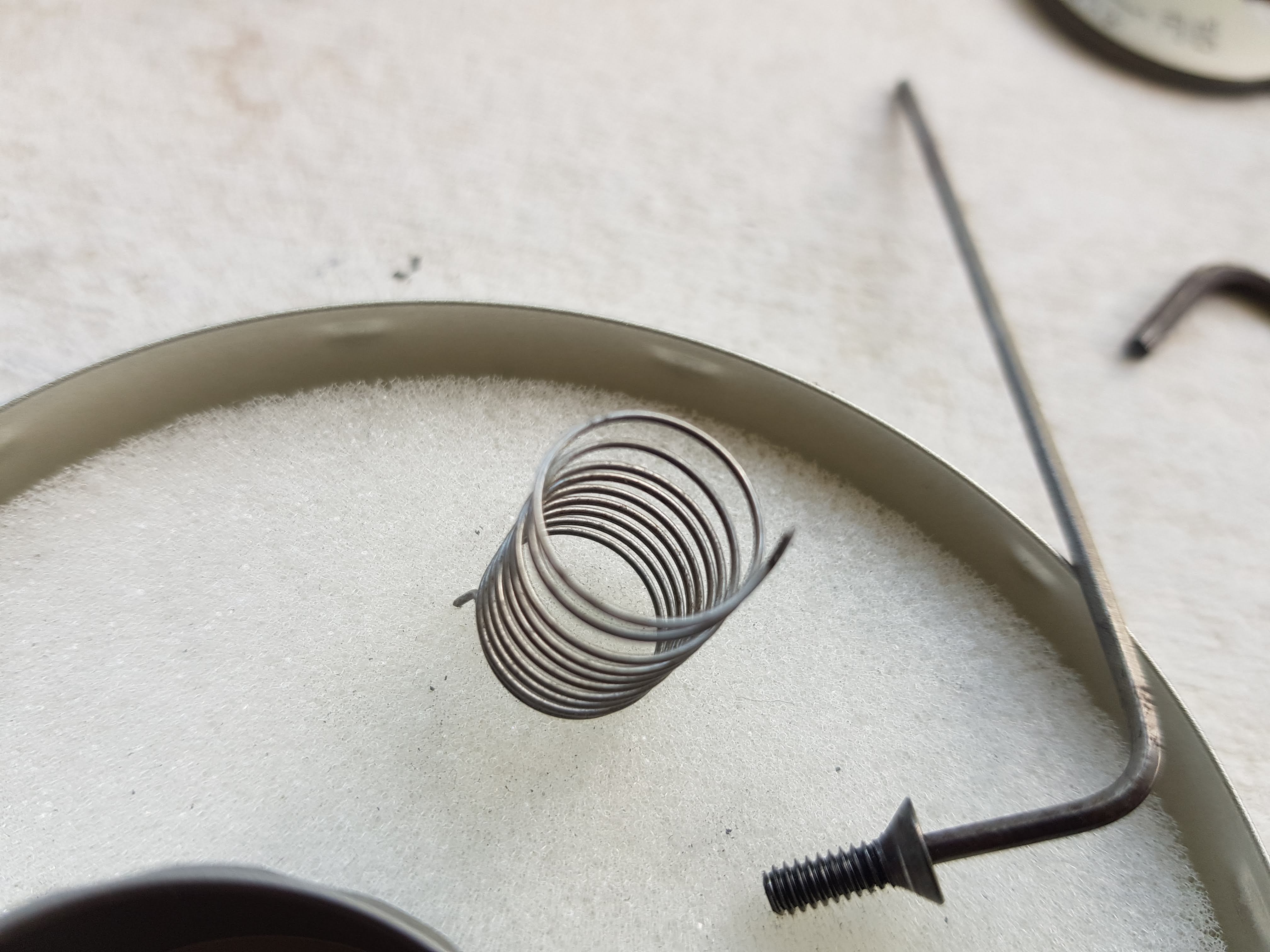

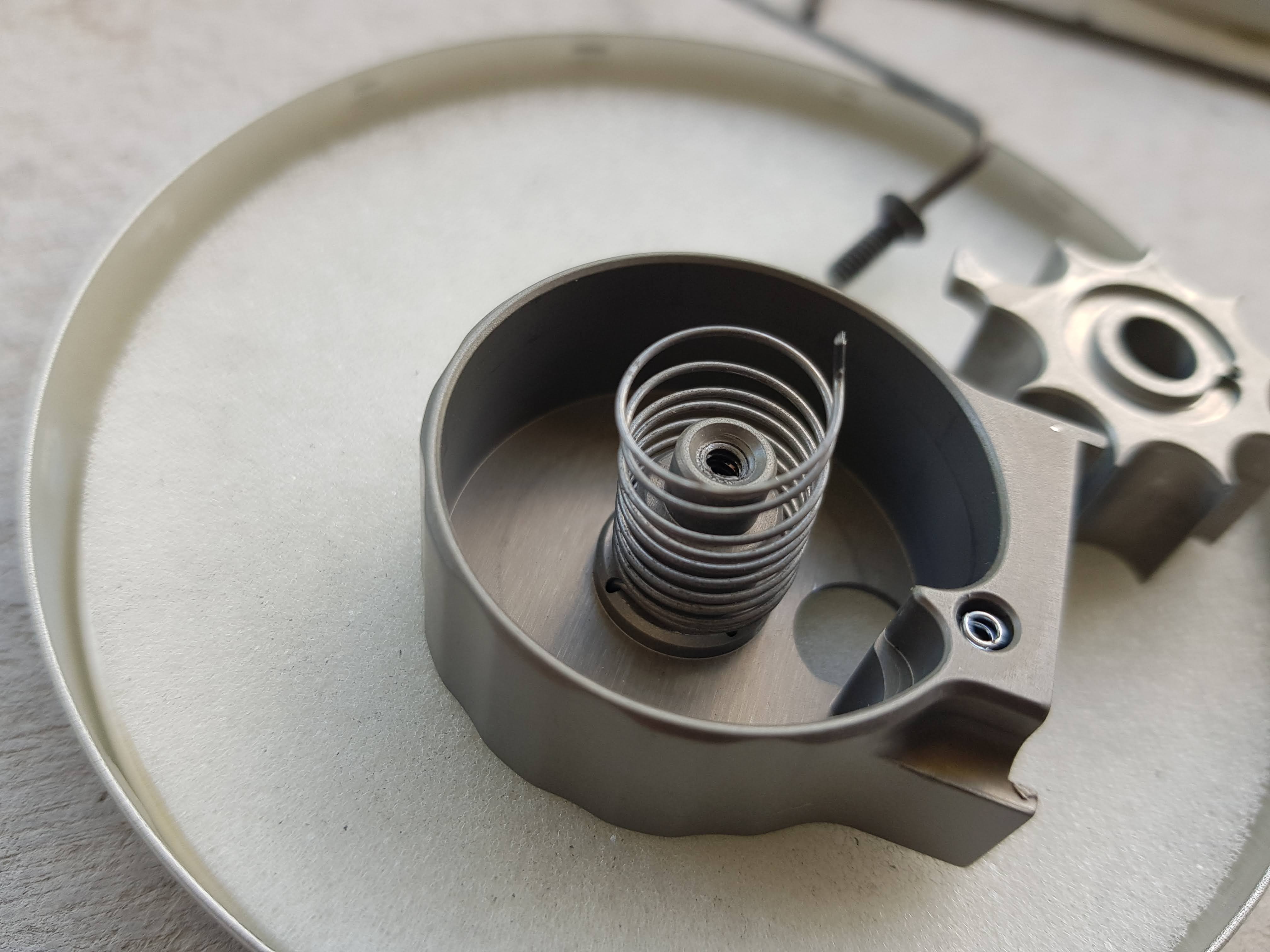

In regards to magazine indexing issues, it was a simple fix. I had magazine indexing issues on both my Evol 30 and 22 when it was brand new out of the box. All you got to do is open the magazine up and reset the coil spring in one of the 4 holes for the right amount of tension.

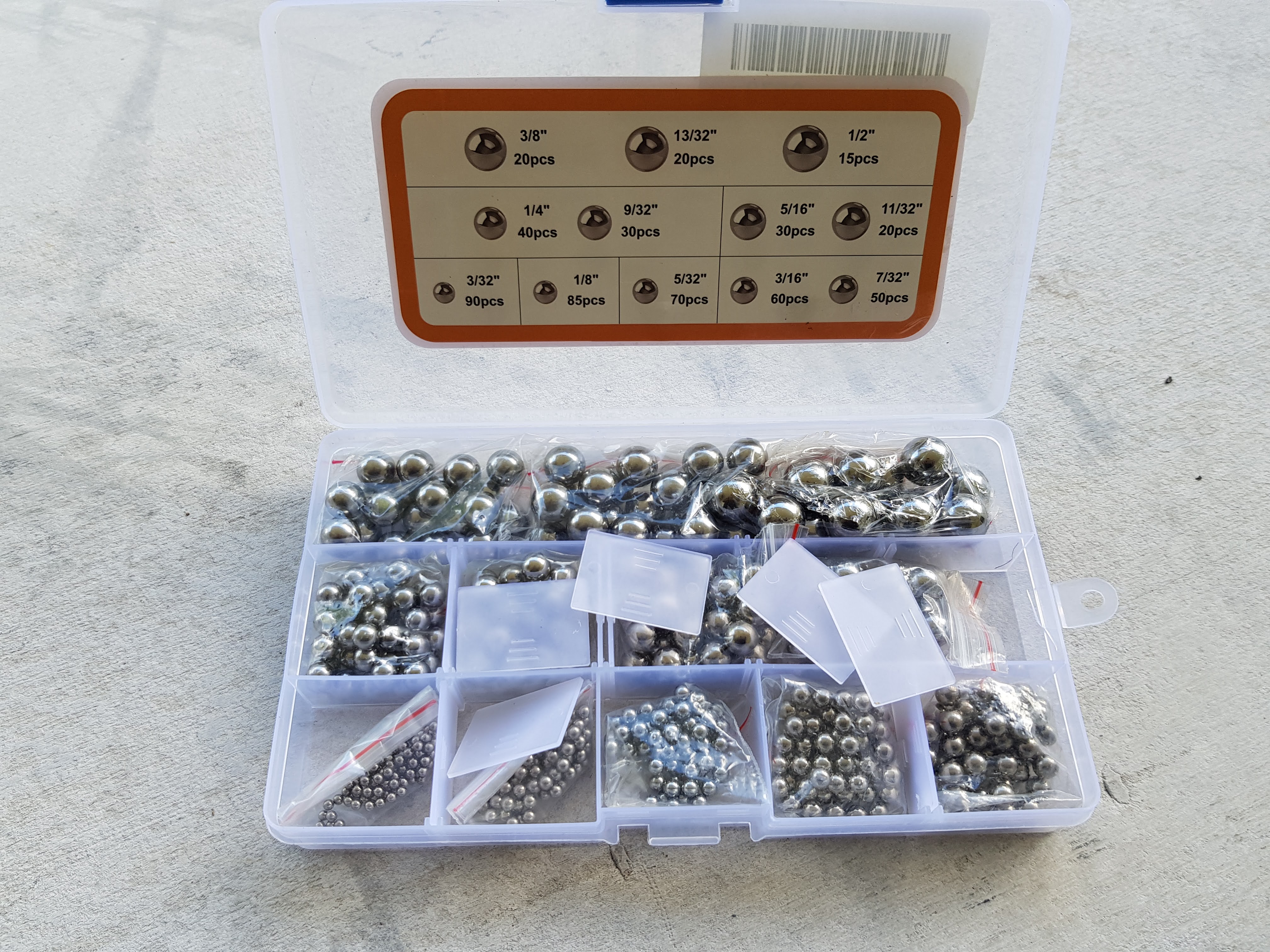

Test by loading the magazine and push the pellets out with a pointy object by hand to make sure it indexes properly. Just a word of caution. When you disassemble and assemble the magazine, just make sure not to lose the ball bearing. Ask me how I know lol. Also, the magazine schematics list the ball bearing size as 3/32". IIRC, it's actually a size up. I believe 1/8" but I have to verify that again.
It's also good to have an assortment of ball bearings in case you lose any.

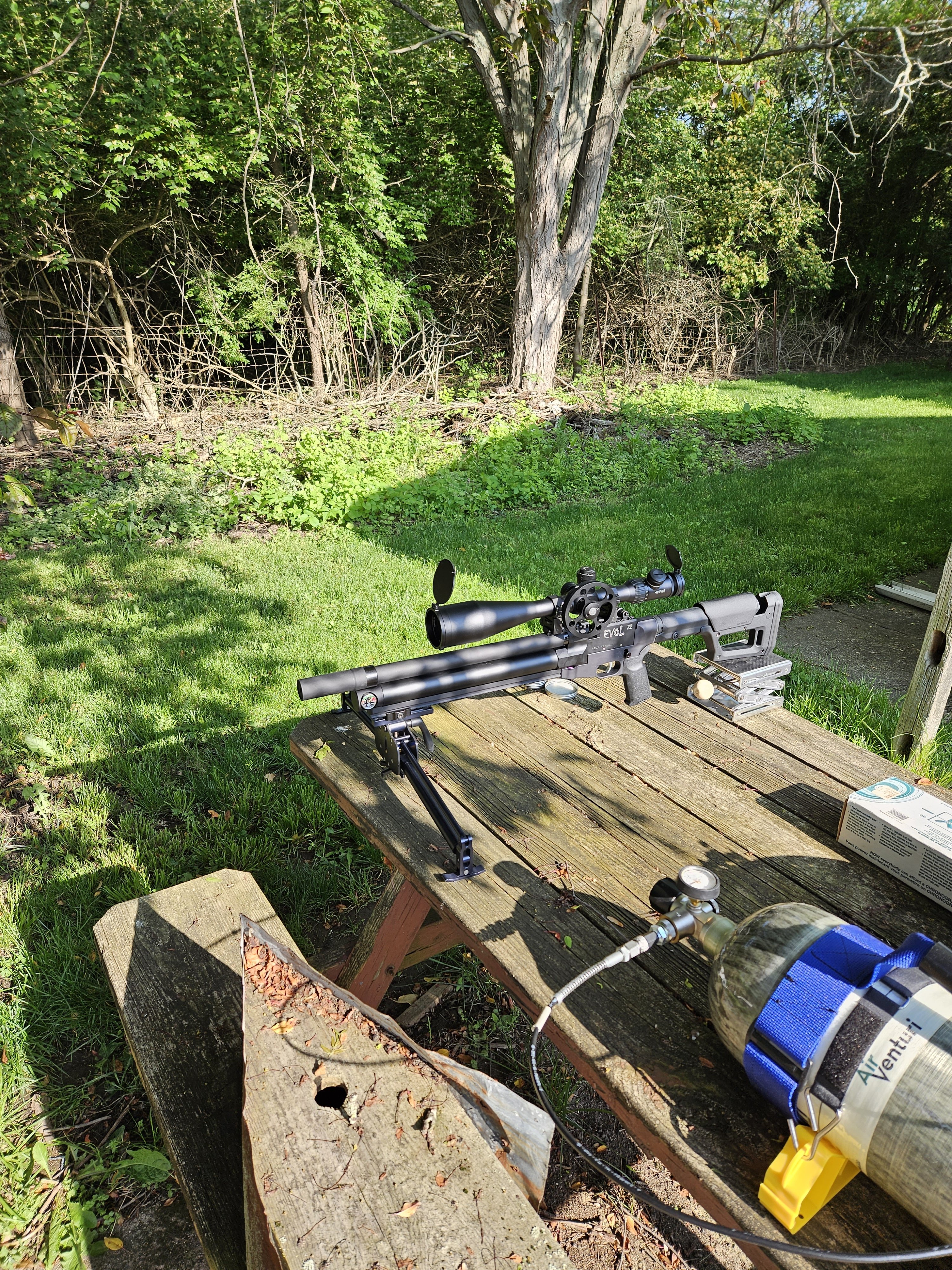

Spent some time with my 15" .22 this AM.
Basically just verifying everything in anticipation of an N50 match this coming weekend.
Wind was light and variable at 3-5 mph, and I was twitching about like a palsied meth head.
I was OK with it at 50 yards, but the wind on Saturday will likely foil all of my plans......
10 record shots that would have scored 10s an an official target maybe.

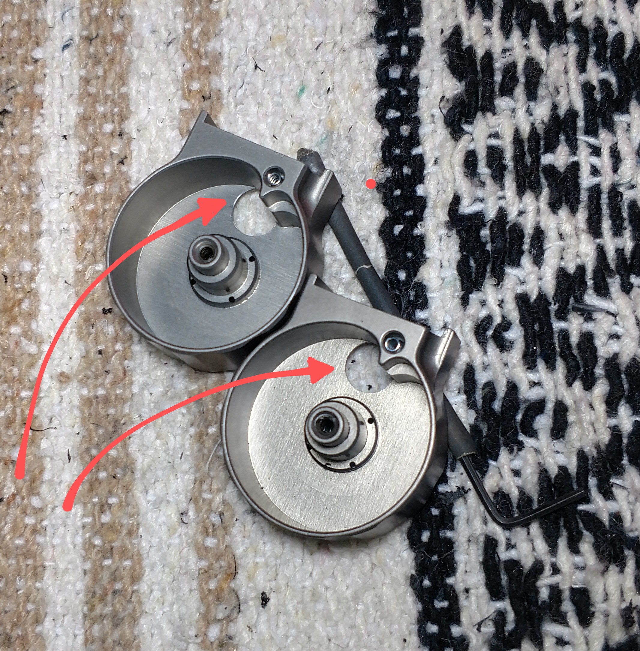

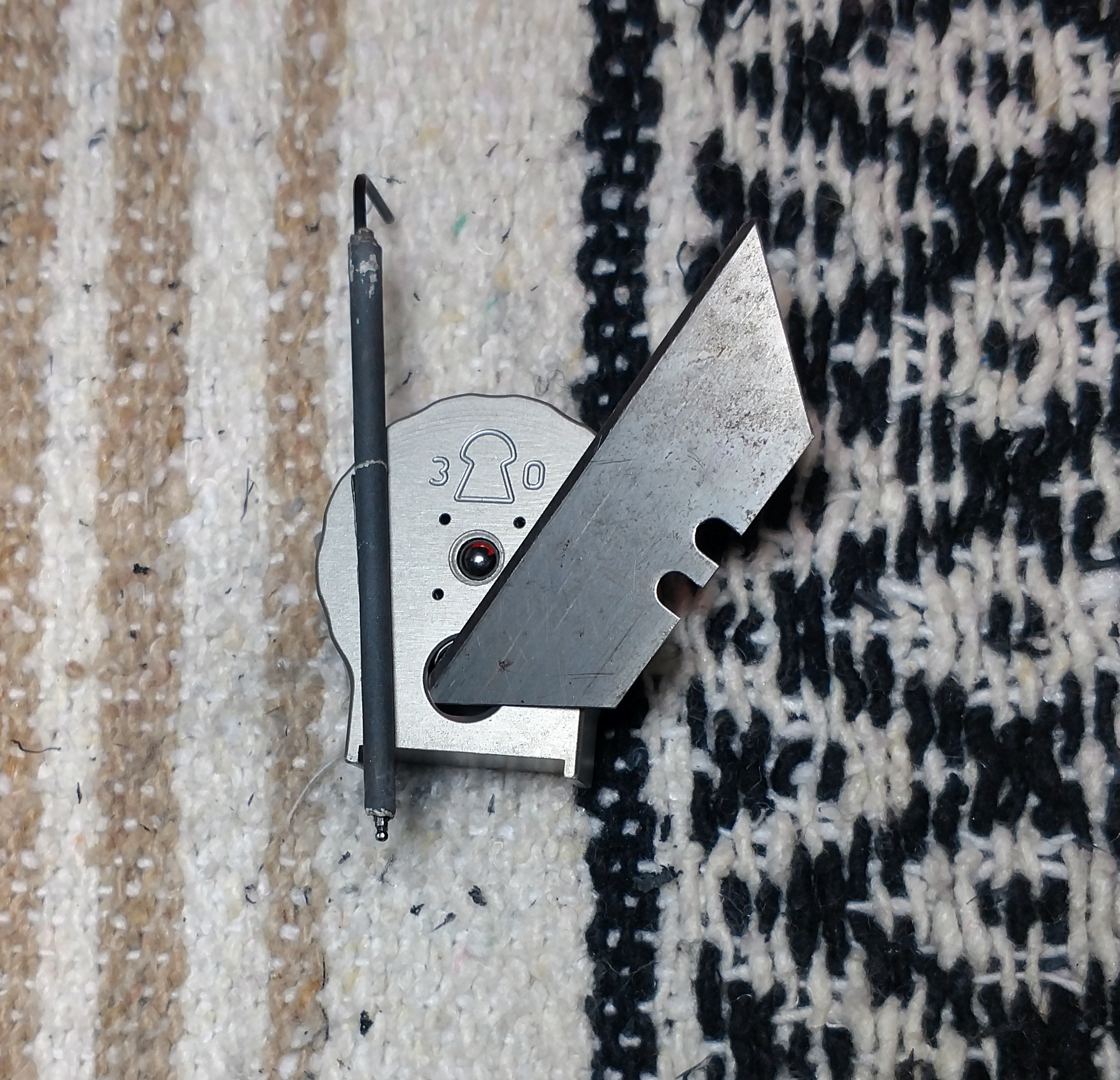

I have had this happen to me a couple of times with pellets as well. Aside from now carrying a fiberglass rod in my case now to tap the jammed pellet back into the magazine, I also did some experimenting with the different magazines to figure out why it happens and completed the fix for it.
What happens is the very edge of a pellet head will catch this sharp edge of the magazine as it begins to exit. (Check out the difference in the two magazine holes, before and after.) This sharp edge is sometimes catching/dragging the edge of the pellet's head, which allows the pellet to want to move sideways in the magazine. Then, the extra force we apply with the cocking lever jams things up. Through testing, the solution was to cut, radius and polish the leading edge of the hole in the magazine. I haven't had a jam since, and can feel that there's no catching issues anymore.
Cleaning and polishing up the inside edge of the hole was easy enough with these steps: (1) Disassemble the magazine. (2) Working from the outside to reach the inside corner of the hole at an angle, take a razor blade and lightly cut the sharp corner off the hole. One or two light cutting swipes all the way around the hole worked. (3) Polish the cut edge into a smooth round radius with 400-600 grit sandpaper (I rolled sandpaper tightly around a small .050" Allen wrench to work the close corners and add pressure to the paper.) (4) Reassemble, tightening the screw so the magazine lid is closed on all sides and rotates with a little bit of resistance.
