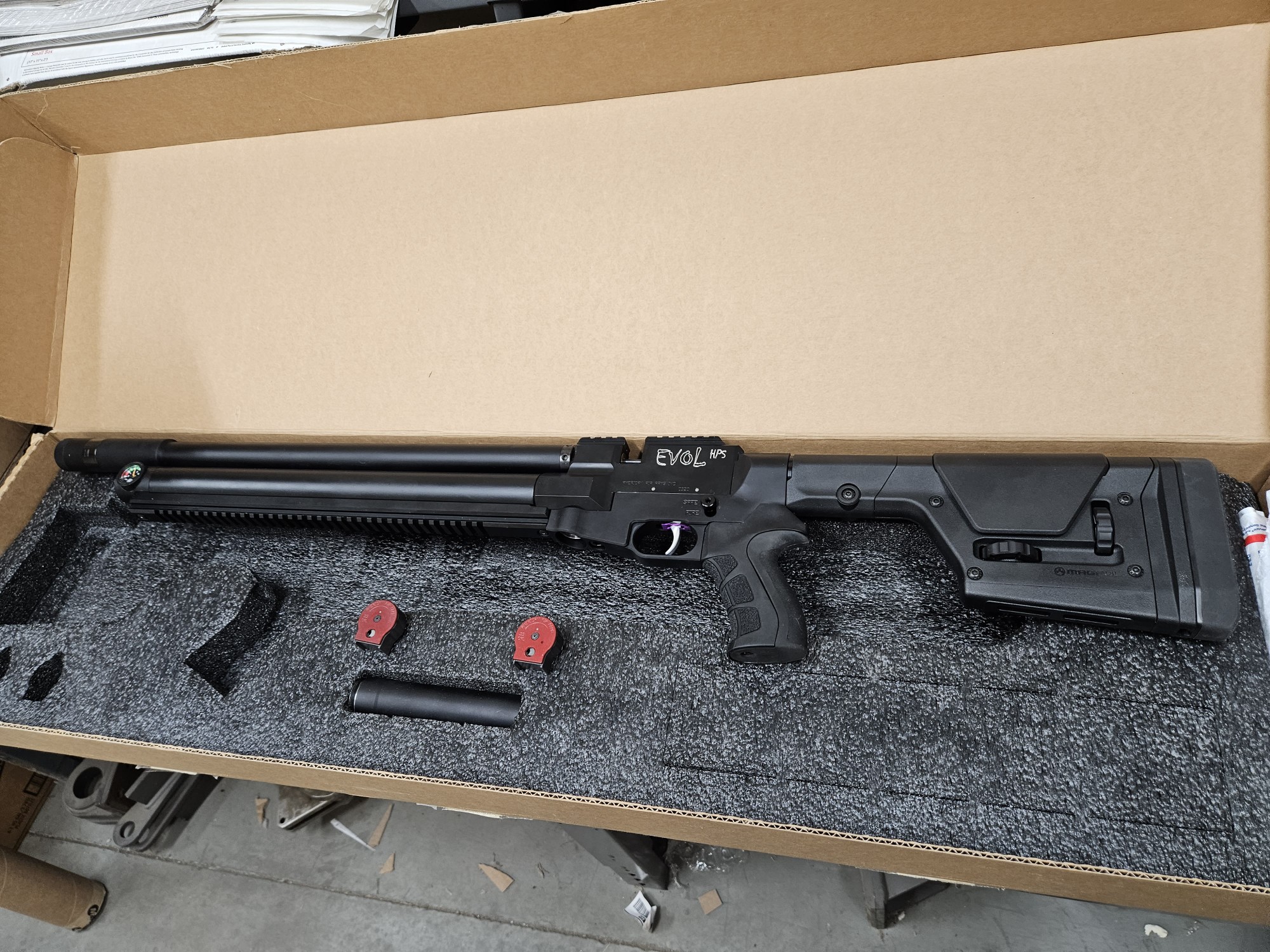

I'm looking at getting one of these to set up for bench rest. I have a buddy that has a couple coming in HPS. One set up for slugs and the other set up for pellets, so I'm waiting patiently to see them and how the pellet version performs specifically.
Where is he getting HPS from? new old stock?
