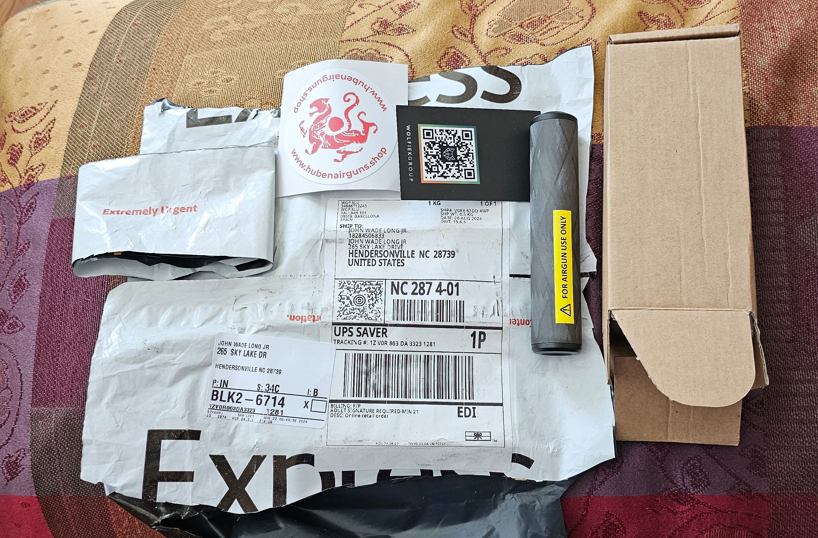

BUT, GREAT NEWS about the Huben website. They got an employee, Lucia, right on it when I emailed, and they sent another UPS EXPRESS URGENT on 20th August and it arrived on the 22nd at NO EXTRA CHARGE. WOW! Now THAT, my friends, "you can't beat with a stick!" They are not, of course, responsible for the delay at US Customs in Atlanta, have never had that problem with DHL, and, wrote that it is unlikely that they can recover the can (stolen?) So, Hubenairgunsshop.com is a SUPER company with Huben OEM parts - and great people! From now on, ask specifically for UPS vs. DHL. We worked in East Africa for 15 years, then England for six, and DHL's service was AWFUL! - LongJnSilver from Hendersonville, NC

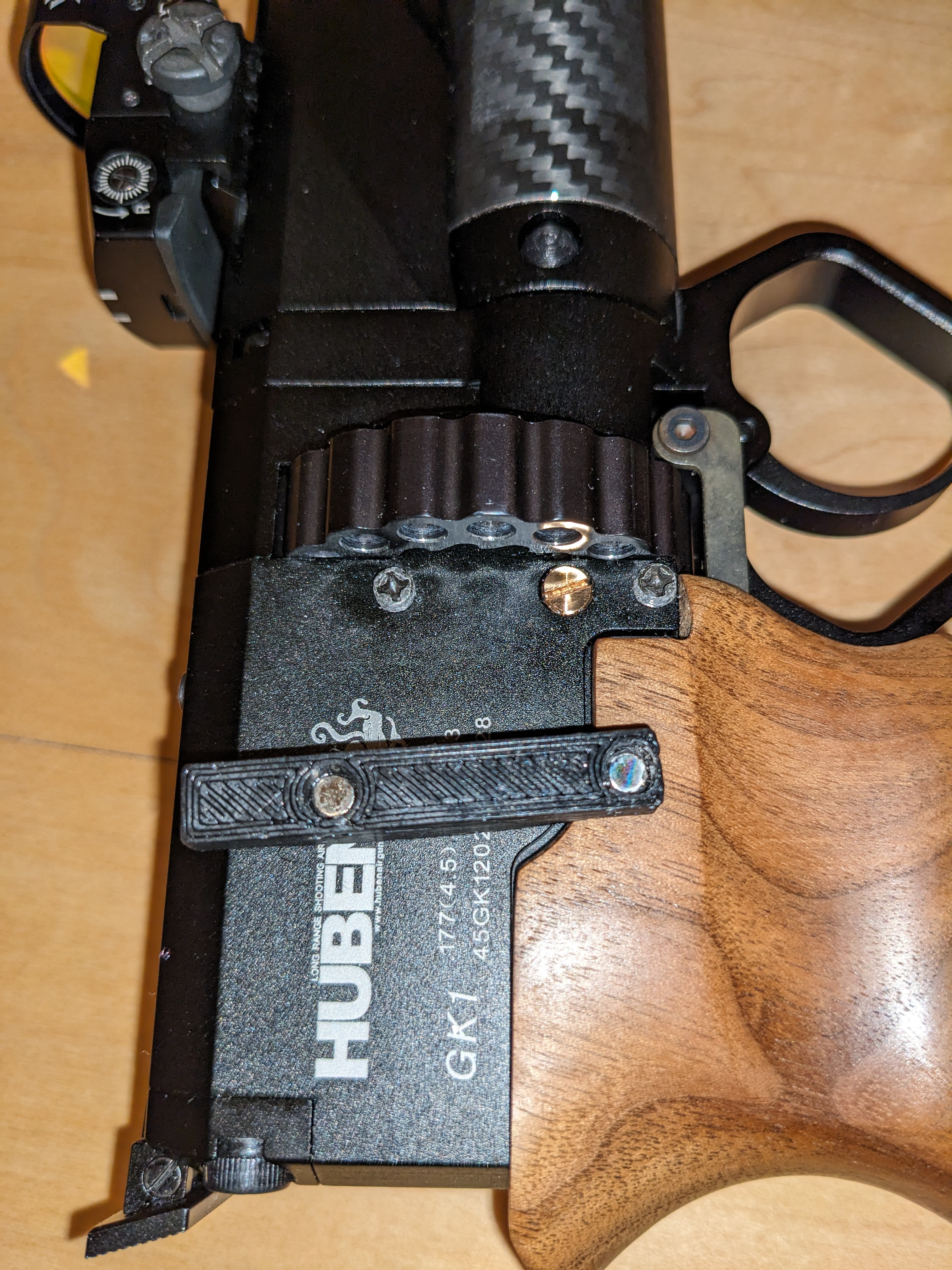

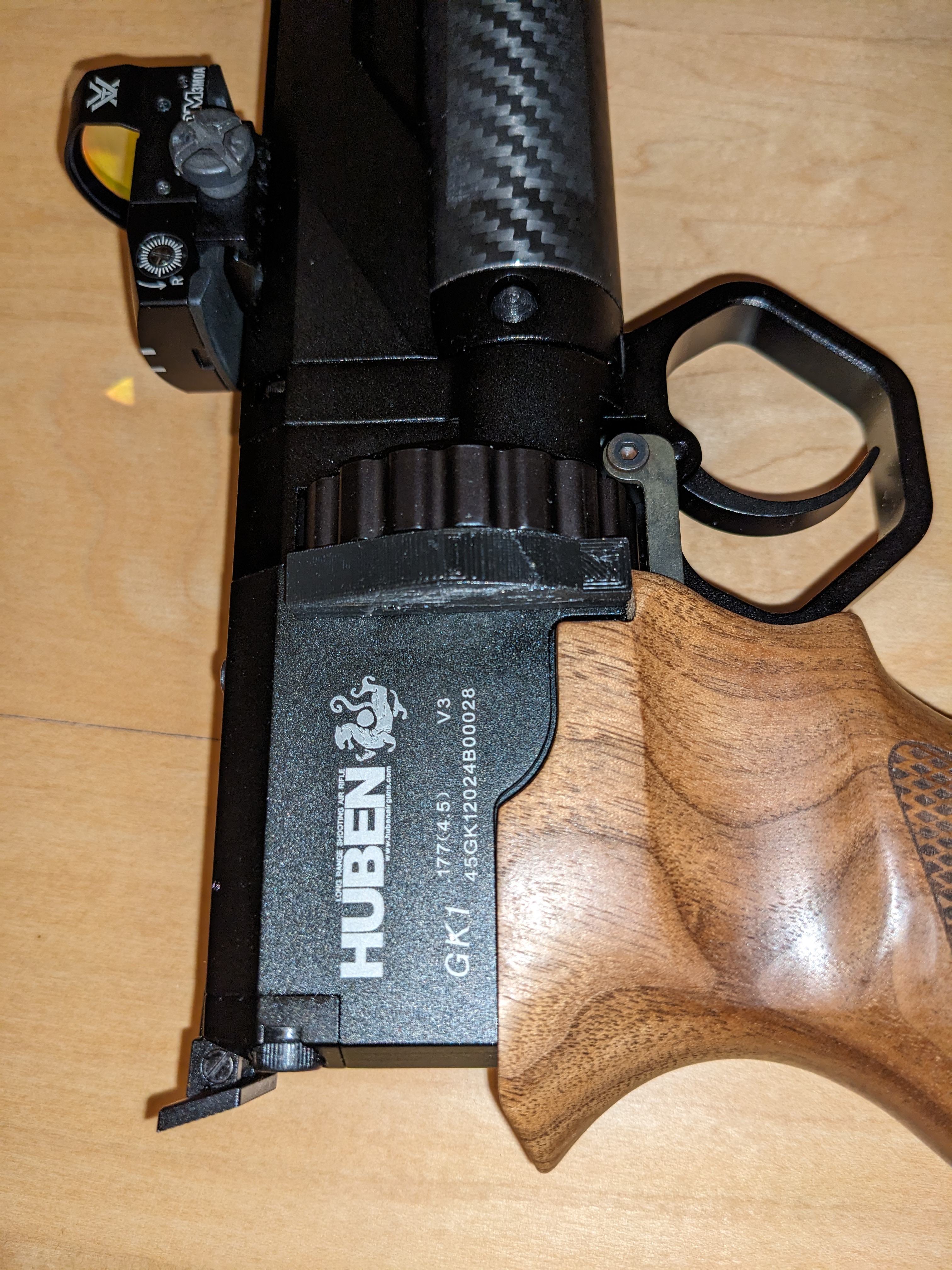

I can't find the original post on this type of loading gate, but someone made one from aluminum, but countersunk the receiver to use flathead screws. I didn't want to drill the receiver so I used some screws for PCs that I ground the head to a smaller diameter. Then 3D printed a part that is retained by 4mm x 2 magnets and blocks the pellets from coming out. Downsides of using protruding screws are the access to 2 of the 5 pellet positions is somewhat hindered. Not a big problem for a 0.177 but might only be able to load 3 with a 22 or 25.
