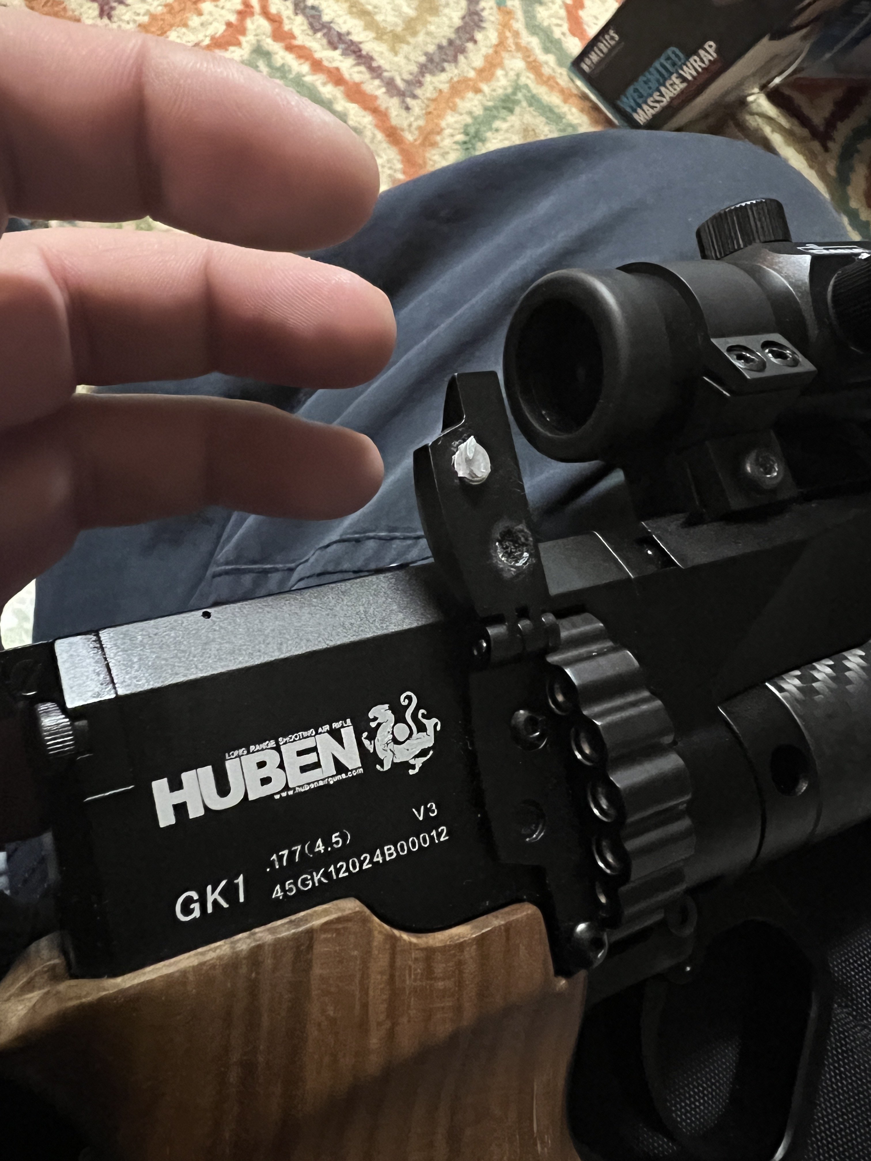

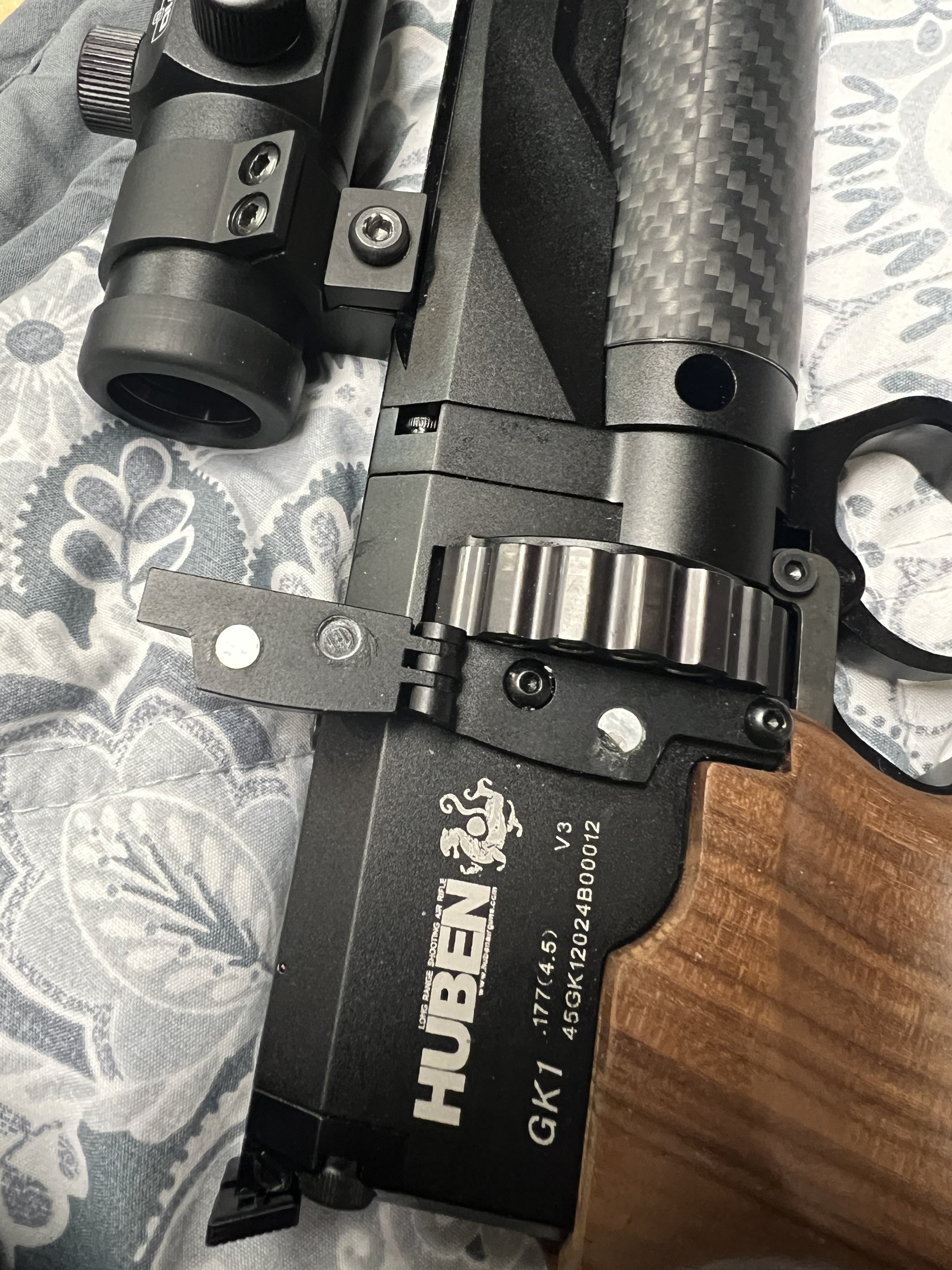

now the freaking lower magnet came off!!!
broke a little chick off it too by itself!!!
Had to re-glue the little magnet
What a poor quality control by
ares-air-gun people….
very frustrated man …
View attachment 515150View attachment 515149
I can understand your frustration, but stuff happens. FYI you can buy the magnets at Amazon probably, or AliExpress and have a dozen of them for not much. As for falling out, a dab of glue will fix the problem.
These problems shouldn't happen, but sometimes they do. I suppose you can contact them and let them know there seems to be a workmanship issue with the part. Show them pictures and let them know that you are disappointed. Perhaps they will respond favorably. At the very least you can fix it yourself.
For myself, I'm fine with the stock gate. It works and is simple.
Slapping rare earth magnets will lead to their early demise, as they are brittle. Definitely have to be gentle with them, at least that's my experience. I've busted a few on other projects. Had a pair leap into the air and stick to each other in a fraction of a second. That caused one of them to crack.
Reactions: .177Guy
If you have a 3d printer make you own. If you recess the magnets just enough they will not impact anything thus will not shatter. With this design on a 177 you can load up to 5 at a time!
