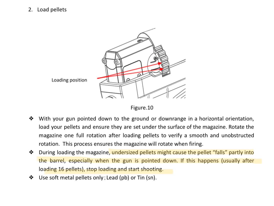

@SundanceKid You quoted the post correctly.The linked list looks familiar. Here’s what concerns me. I purchased my gun from New England Airguns, an authorized dealer whose owner services them. That sam person re-wrote the Huben user manual (I assume so that it is less confusing to read). In the manual it states the following in regards to loading pellets:
Source: https://www.newenglandairgun.com/uploads/3/4/5/3/34532711/huben_k1_manual__8-25-2021_.pdf
I’m not saying that other cannot be right in their methods. I just would like to hear that the practice is ok from people who successfully work on their own guns or service these guns professionally. I’ve encountered the issue of not being able to rotate the mag before loading all 19 pellets and like the manual says I had to “stop and start shooting.” I had no issues in doing so. I still don’t know exactly what the issue was, but I could not rotate the magazine in either direction. This concerns me, as does pushing a pellet too far forward in attempt to seat them with a tool.
I’d like to know exactly what prevents this from happening when manually seating them with something like an Allen key.

That underlined comment is exactly what happened to me, when this happened to me though I had already fired and what happened was the mag only rotated half way due to the slug already making contact with the ridge before the breech. When fired it pushed the slug into the barrel and chopped the tip of the slug in half lmao oops

Before I began seating my pellets fully into the mag, my mag would jam while rotating it if the gun was pointed upward. There is a ridge in each chamber of the mag that the pellet must be seated into. You will feel it seat.

@SundanceKid Post #10 is what concerns me. Once you do that the only way I know to correct the issue is to shoot. This is annoying.
